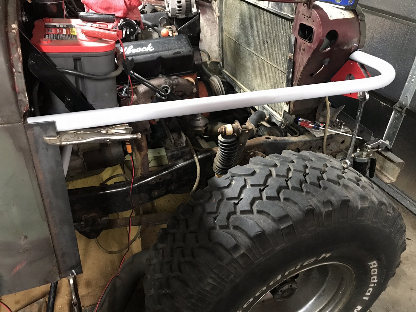

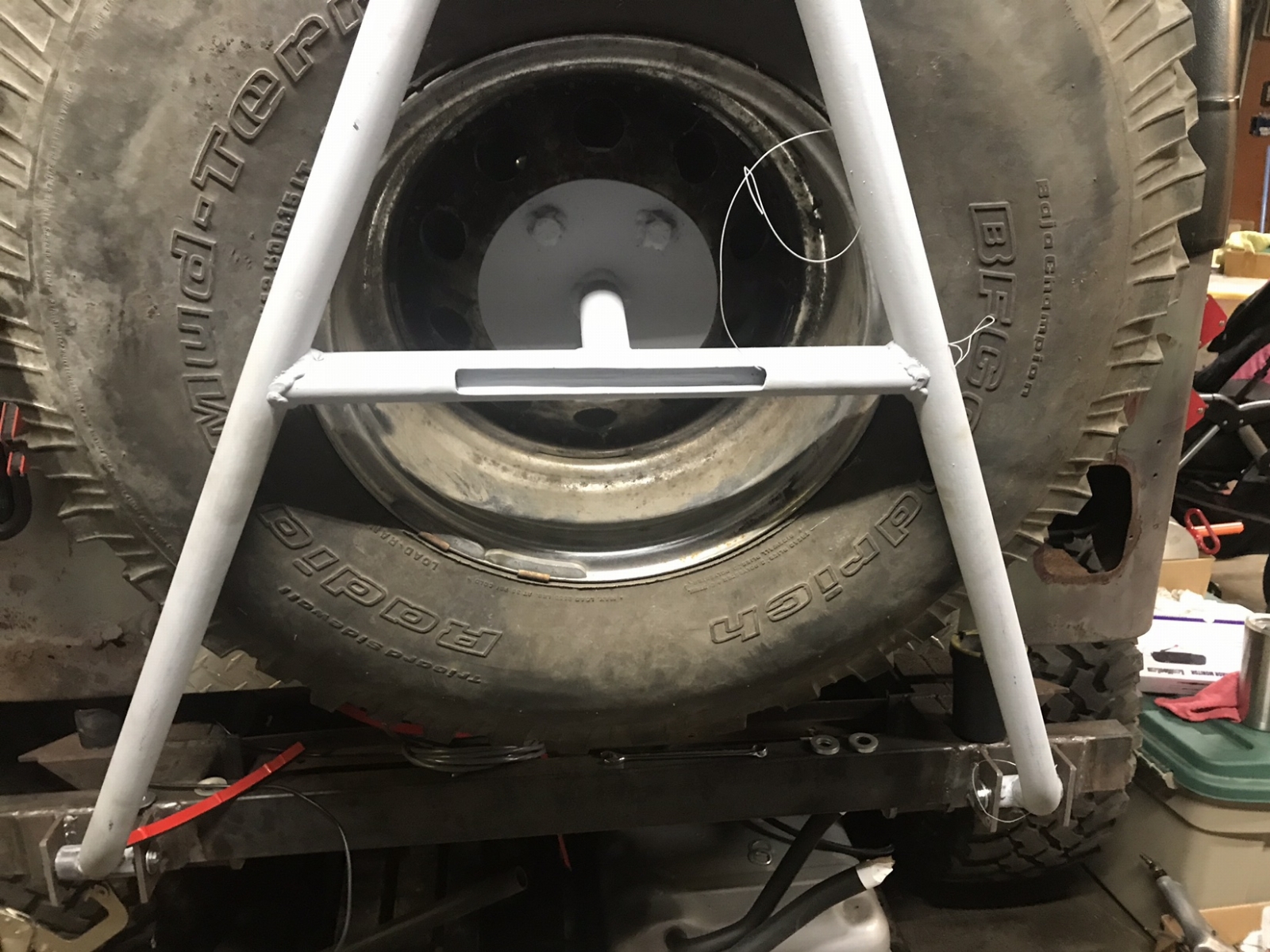

Thanks. Yep, simple quick and effective. That’s all I needed. Had to make a tire carrier for a CJ7 and need to bend some flat stock. Quick peak
Also put a 355 sbc in this heep. Still working on some rust repair and a full cage for it along with tube fenders. I have too many projects going on.

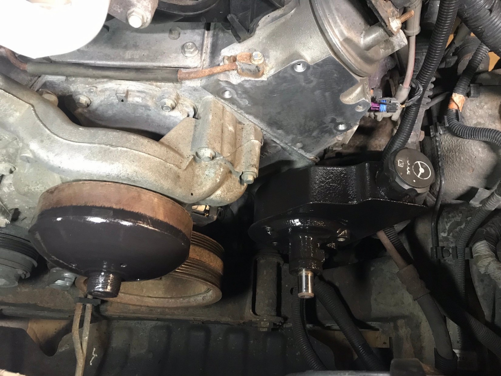

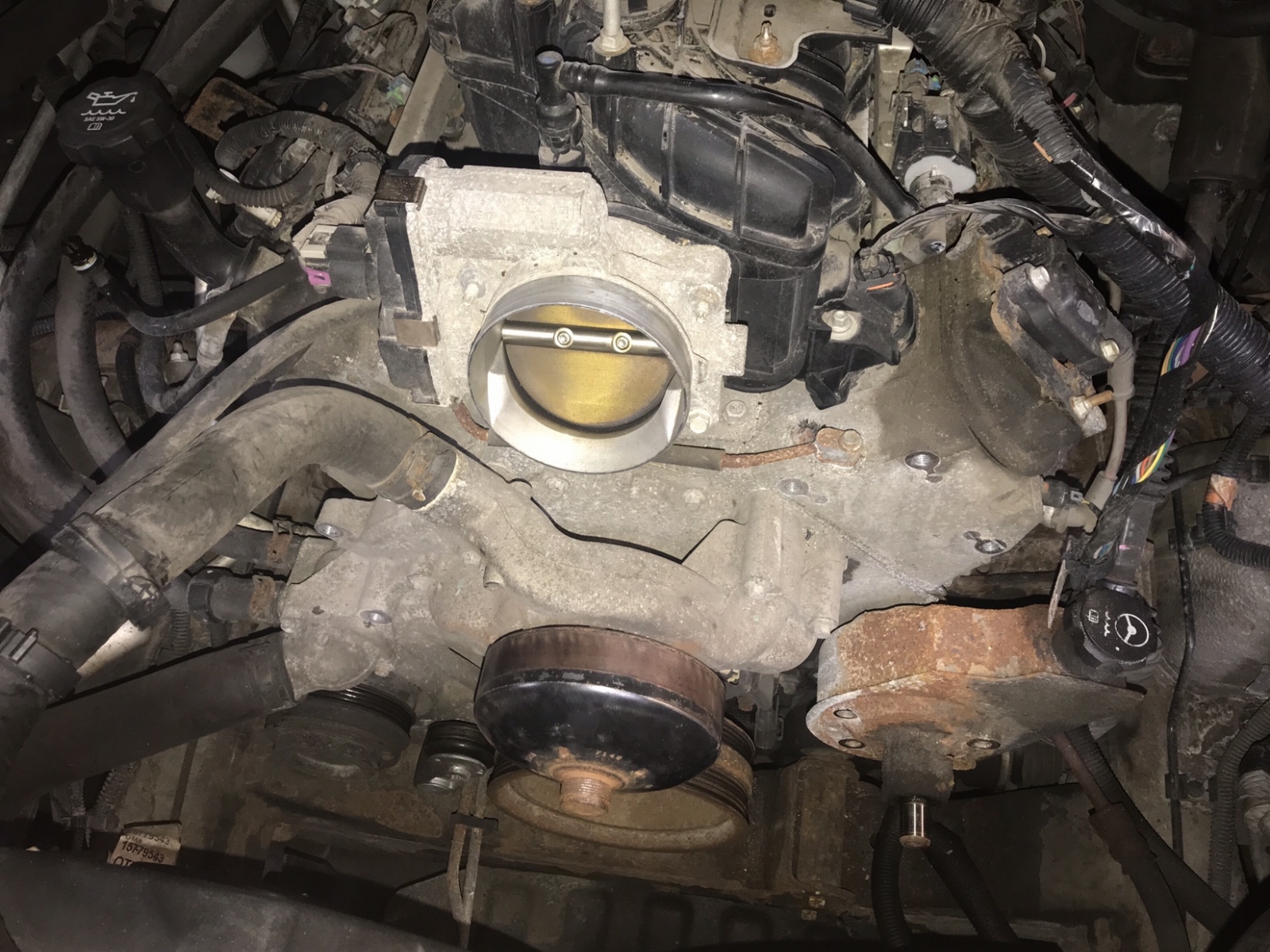

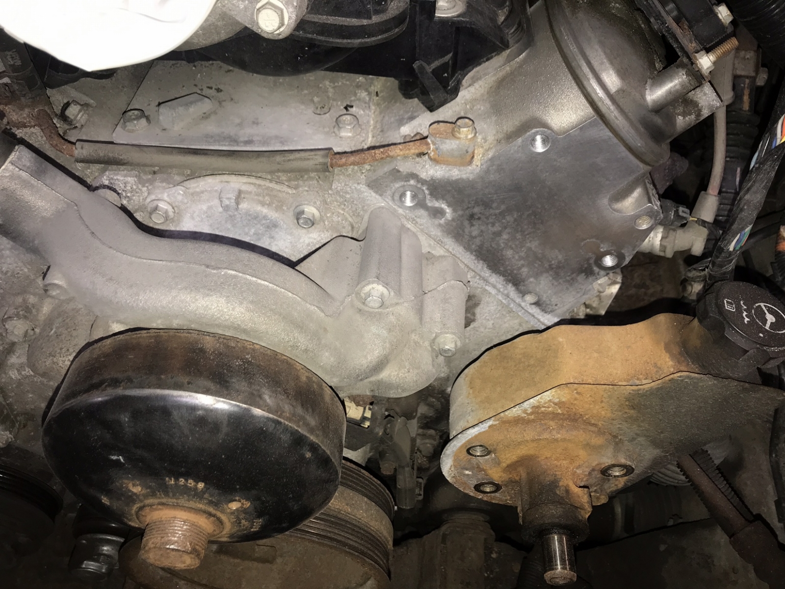

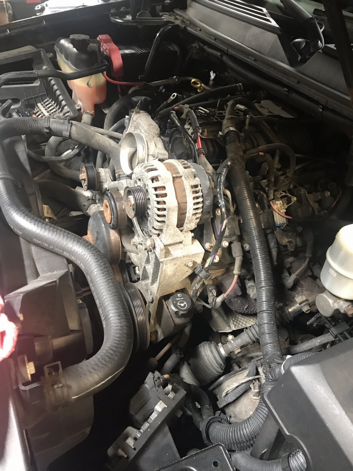

I gotta get the alternator off and then the P/S pulley so I can swap this nasty looking bracket. I can’t stand the oxidation.
The belt tensioner wouldn’t move. The pulley bolt was turning, most likely stripped now. I had to use my big channel locks and grab the tensioner body to rotate it. When I did, it stayed in place. This is why I do this stuff. Little preventative maintenance goes a long ways.
I cleaned up the water pump pulley with wire wheel on die grinder and also hit the center of P/S pulley. Looks ugly but I’ll get it.
I always put some WD40 on the threads of my puller. It keeps from messing up the threads.
Let’s get this pulley off.
Now I can get the bracket off.
I have a lot of cleaning ahead of me. I’m gonna wire wheel, wire brush, scotch brute pad and maybe even some 1800 grit sandpaper to get this crap cleaned up. I’m not sure yet, but I may just go get a new water pump while I’m here. Wish I had time to blast and paint all this, but I don’t. Gotta get busy.

Wonder why it's so crusty. I'm in Jersey and I don't think mine looks that bad, or rusty.
I’m not sure, the chassis on this rig is pretty clean. But I see this a lot on these LS engines. My LT1 in my 94 Formula has these lines on the back of the heads and they were bad but didn’t look like this. One of those things that make you go hmmmm.

I spent some time with a brass brush and scotch brite pad cleaning up the oxidized aluminum. Also hit the power steering pump with wire wheel and wire brush.
I painted the P/S pump and water pump pulley with some POR15. P/S pump painted all the way around even the back and bottom. Made sure I got it cleaned and coated really well.

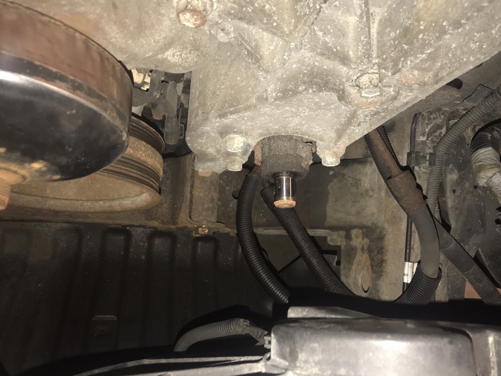

Went to put P/S pulley on and the threads inside the shaft were cruddy and rusty so I sprayed it with some brake cleaner and blew it out. Then I chased it with a 3/8-16 tap. Put my installer on and it went about an 1/8” and pulled the threads out of the shaft. I used a mirror and could see some threads still there that I didn’t hit with the tap or the installer bolt. For some reason my bottom tap was missing and my 3/8-16 thread chaser is broken so I had to cut my regular tap so it would bottom out and clean the threads. That was a *****!! You don’t want to put a lot of heat in it or it will get brittle so I used a hack saw.
I get the hole tapped and it looks good. Get installer back on and start cranking to push pulley on and it pulls all the threads out of it. At this point is when I’m ready to just pour gas on this thing and set it on fire and go to bed. I had to take the pump off again and I drilled out the shaft out which was another PITA cuz I have to hold the shaft with a pair of hog jaw pliers while trying to drill straight. Then I started tapping it for a heli-coil and the tap broke off in the shaft. It’s too late to go get another pump (9-9:30) so I spent a good hour chipping at the tap and trying to back it out with needle nose, snap ring pliers, screw driver, a big f-ing hammer, I’m beyond aggravated now.
I get it out and use another tap but went really slow, in 1/4 turn, back it out, spray it with lube, in 1/4 turn, back out and repeat until I get it threaded. Install heli-coils and try again. Install pump back onto bracket and tighten bracket.
This time it went but it wasn’t going on without a fight. By the time I got it on, put on the alternator and tensioner it was 11:15. I threw my tools on the bench and went in to eat something, shower and get in bed. Got about 2.5 hrs of sleep then off to work I went.

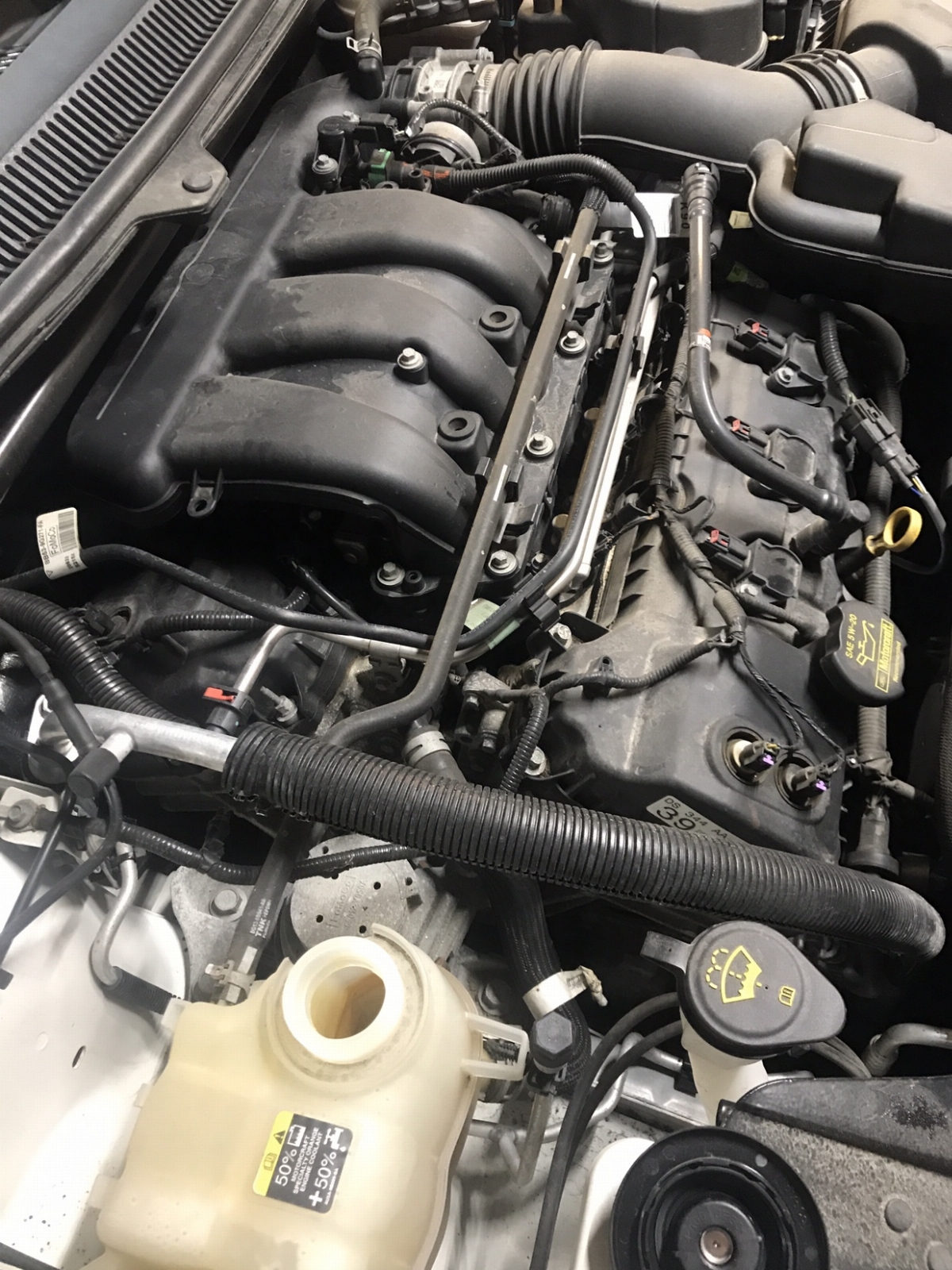

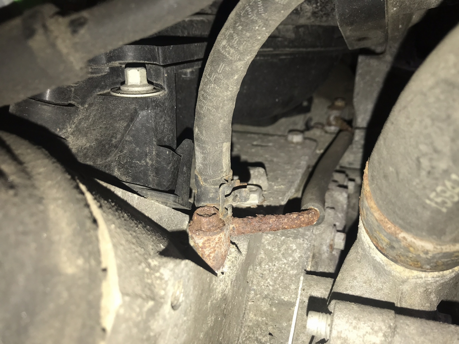

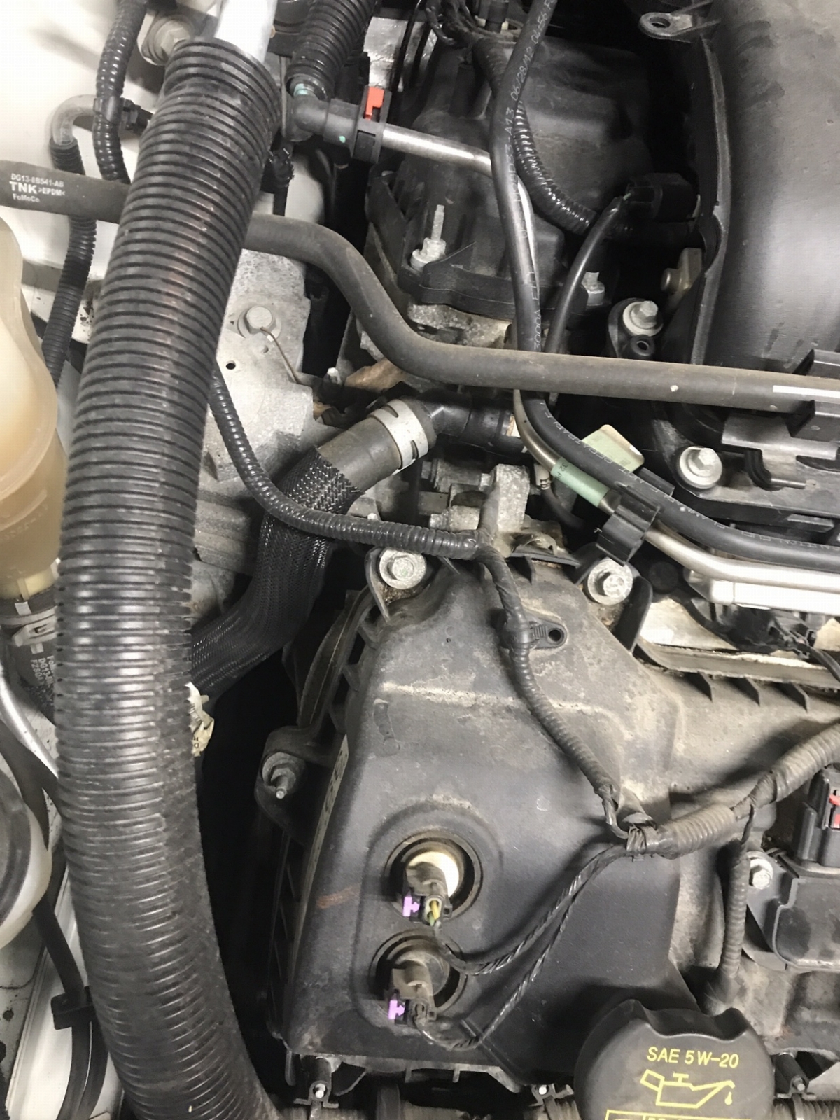

Came home and finished off the passenger side plugs and wires, cleaned the throttle body and MAF sensor and put the air intake back on. Bout that time I had another vehicle come in. ‘13 Ford Flex with a complaint of no heat. It was low on coolant and water pump was sleeping out weep hole. No way I’m getting into this one. It’s a 3.5 with dual overhead cam and the water pump is behind the front cover and driven off the timing chain. Book time is 14 hrs. Filled it up, bled it out and sent it on its way. No thank you.
