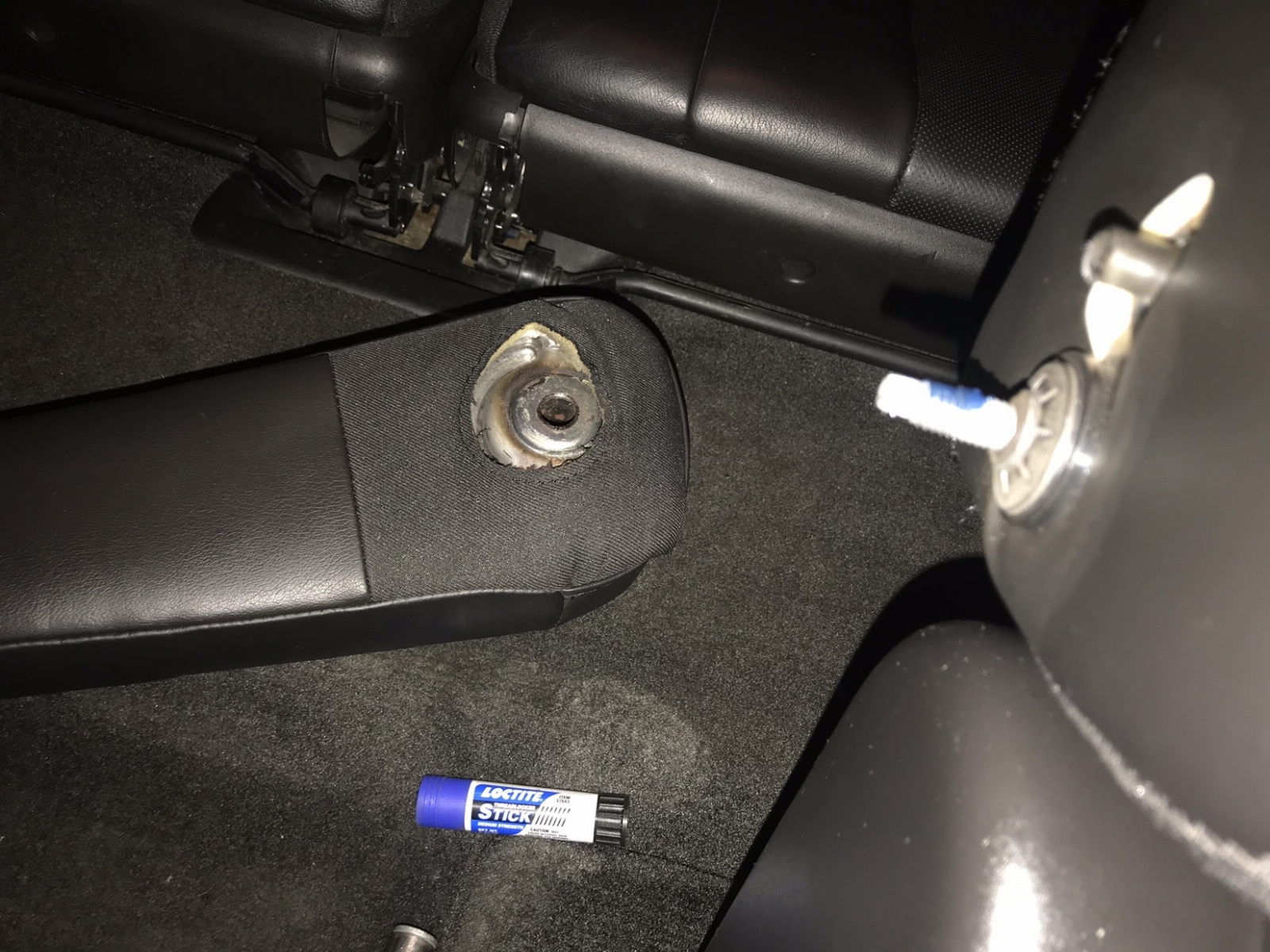

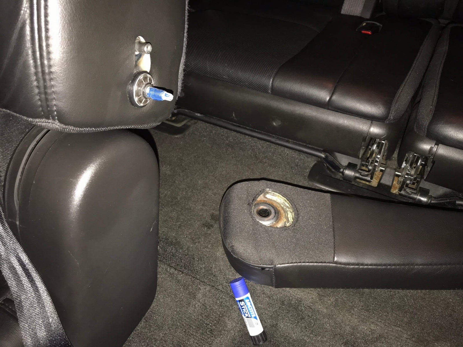

you can fix that drivers rear arm rest with a shim/sleeve, I did mine that way instead of trying to have someone tack a weld on it.
if you take the bolt out you will see what I mean the bolt only goes in so far, so if you put a shim or a sleeve on it inside the hole on the armrest that allows you to tighten it down more and keeps the arm rest where it should be instead of just flopping down. when you put the bolt back in I would use a little blue locktite mine has worked it's way loose a couple times.
Thanks. I was gonna pull it apart tomorrow and see what the issue was. Glad you pointed me in the right direction.

careful with the little black plastic cap that covers the bolt hole they tend to break the tabs easily, if it breaks this guys sells replacements that seem to be less brittle

The nut was just loose. I wiped down the threads and put some blue loctite on and tightened it down. Works great now. And thankfully plastic cap didn’t break.
Figured about time something went right today so I went ahead and did the other side too.
Appreciate the info and the link.

looks like you caught it early, on mine the end of the slotted groove on the armrest is worn so instead of stopping it slides past the where it is supposed to stop unless it is bolted on tighter, the stud tread ends and wont go any tighter unless I put a sleeve inside where the nut goes so it gives me extra thread to tighten, couldn't really find a washer that would fit in the hole so a sleeve worked just right
