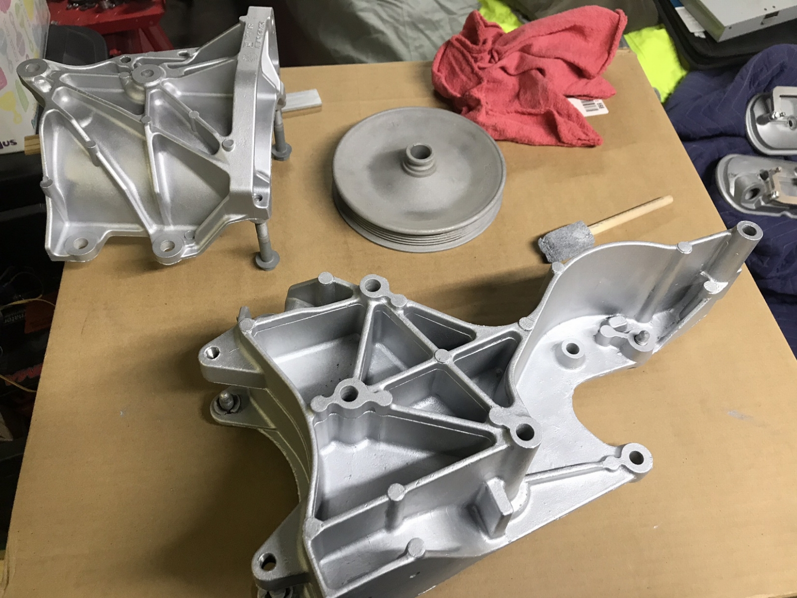

Parts are starting to trickle in. I cleaned up a spare set of rocker covers and bombed them with some high heat aluminum engine paint. New ICT coil brackets, new AC Delco tensioners and blasted my spare accessory brackets and slapped on some POR15 high heat aluminum paint. Power steering pulley blasted and I’ll use some POR15 high heat in black on that. All mounting bolts are blasted but still need some black engine paint sprayed on them.

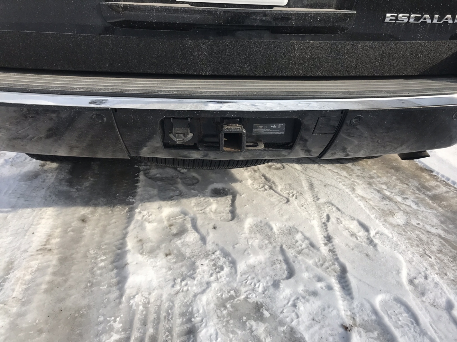

I bought a new hitch cover. Didn’t get one with the truck. Gotta get it painted before I install but I did test fit.

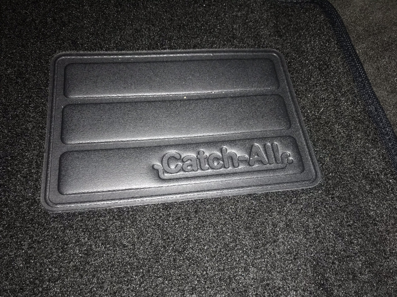

Then I bought some floor mats. I have weathertech in my truck but I really liked my Lund- Nifty Catchall mats I had in my Denali. I bought a set for this because I think the carpeted floor mats just look better than some molded plastic looking ones. These still have a raised edge to catch all the snow/water and such. But to my surprise, they don’t have full coverage like they used to. Maybe that’s why they came down some on price.
Still have to figure out why the 3rd row is really narrow and doesn’t sit correctly. Maybe I got the wrong set for the back, if that’s the case I’ll get the correct ones and return these. No pics because it’s just thrown in the back for now.

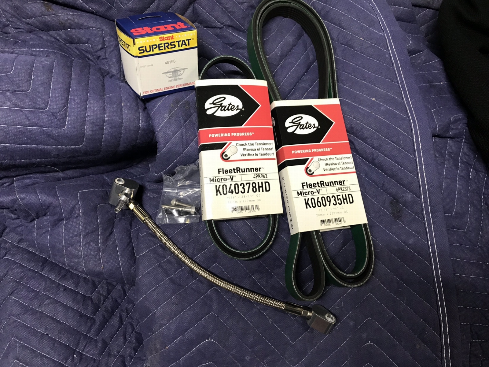

Both HD belts, thermostat and braided steam crossover line with fittings. I don’t like the stock vent line, they rust and clog up then break. I’ll run -3an fitting and braided line from passenger head back to radiator and not use the barbed fitting.

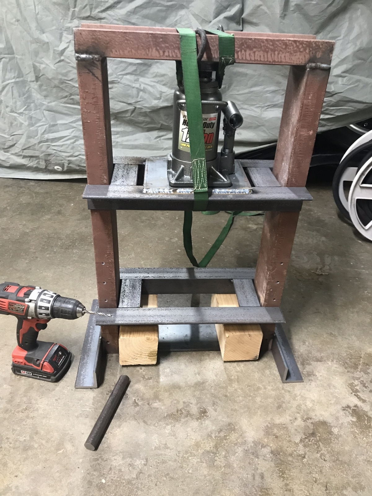

Tomorrow I’m gonna tackle the plugs, wires, coolant flush, thermostat, crossover line, oil change, belts, tensioners, idler and valve covers. Was gonna start on it today but I got busy making some brackets for another project. Figured I’d share it. I need a shop press and brake to bend some 1/4” flat stock but I don’t have the room to have it sitting around. So I decided to make my own out of stuff I’ve been hoarding.
I wanted to be able to store it under my bench when I don’t need it so I made it 28” tall and out of some 4” C-channel and 1/4” thick angle iron. I picked up a 12 ton low profile bottle jack from Harbor Freight for $30. Still need to finish drilling the holes in side channels and find some return springs.
I made the brake yesterday and took it to work and tried it on our shop press. I didn’t get any pics but I do have a video of it bending some flat stock. Not sure how I can load it here. I painted it last night and it wasn’t dry so I left it there. Not sure if I can upload to YouTube but I’ll try and then link it.

Great job. Just download the vid to youtube and post it. You could show the vid by hitting the share link, get the link, then by hitting the film looking icon --2nd from the smiley face icon, it'll say embed--or something similar--paste the link and there you go.
45,016
I don't know why I've never made myself a brake. As I watched your vids, I recalled a handful of instances where it would've made a project much faster and easier.
Well, I gotta get a press first. :(
