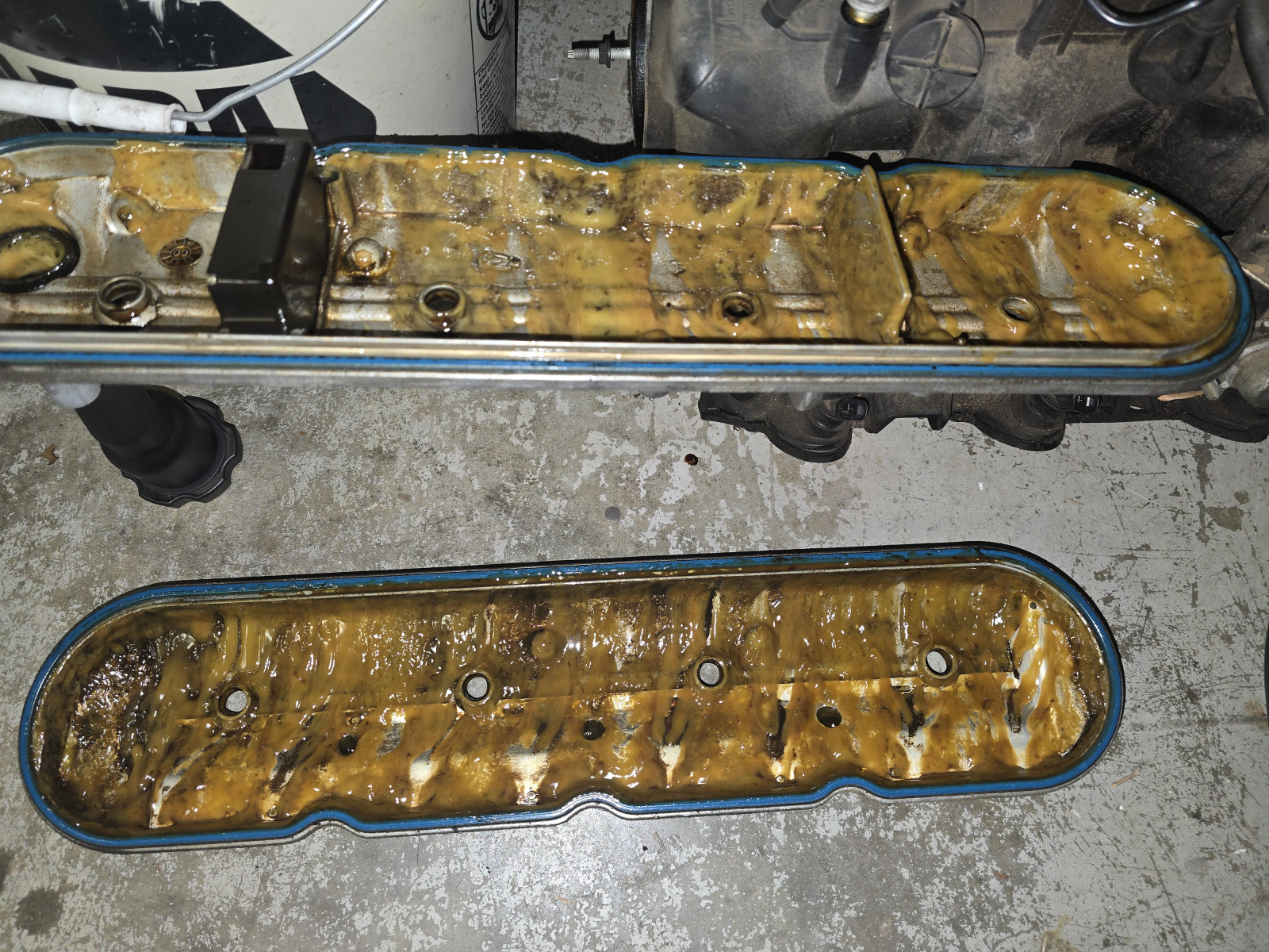

So is it determined that you have a cracked head??? Sure looks like it. Not much can put that much coolant into the oil. Bummer.
Not sure how many miles you have on this truck or how long you plan to keep it? If you are only looking for another 75-100K before moving it on the factory replacement head bolts work just fine and are far less expensive but they are One time use compared to the ARP. I have used the Fel Pro supplied Head Bolts which are all torque to yield on all the 5.3 and 6.2L engines I have played with so far. I like ARP, just could not justify the cost increase for engines that will be retired before they need another rebuild.
If you are racing, adding a turbo, running Nitros etc I fully understand the need and advantage of the ARP upgrade but factory bolts are not expensive.

Yes, I do, @Doubeleive... Any suggestions on a good cleaning solution? I'm thinking of trying to find a local place I can take all the old oily stuff to have it cleaned off professionally.
Well, @West 1, it turns out that it was just a blown gasket. The head looks fine. Still, I purchased a replacement set of 799's that have been resurfaced and tested. Those will be in Thursday. I also bought a top end rebuild kit from BTR with the Truck Norris cam, high volume oil pump and new timing chain. The bolts that come with the kit are not ARP, but that's ok. I have all those parts and now just kind of taking my time disassembling and clean up as I go. This is another fun project, so I'm really in no rush. :)

The parts you have removed could be very quickly cleaned. I use Diesel Fuel now, solvent has become very expensive and hard to find. Diesel fuel works equally well and is available at most gas stations for $5 per gallon or less. After cleaning with diesel fuel I wash with a light soap and water using dish soap. Dawn works great.
You will have a lot of the mess still inside your engine. For your first start up I wouild grab some very cheap 5-30W at walmart. Non Synthetic cheap oil. Use a cheap filter for this also. Fire it up on the cheap oil. Set your engine at a fast idle, maybe 1,500 RPM. Let it get to full temperature and run it another 1/2 hour.
Drain that mix out while hot. You will have a good idea what is inside the engine when you drain this stuff out. If it looks like good oil you are done. I would not drive it or put a load on the engine till I knew the oil inside is clean and not dilluted with coolant.
Install your good oil filter and good quality oil. Should be good to go.

Thank you @West 1 ! I had purchased cheap oil from Walmart to do this, but I bought synthetic. I'll return it and get the real stuff. I also didn't know how long to run the engine to clean it out, so thanks. Would you add Seafoam or ATF into it since those have detergents?
Also, thanks for the cleaning tips! Although, I'm not going to use the heads again, do you think this cleaning method will work on them? I might clean them up and sell them as they do look like they're in good shape...just dirty.

Synthetic will work the same, just costs more. I would save synthetic for the actual install of oil to run. Seafoam and Trans fluid both work to clean. That is your choice. Your engine is not dirty, it just has coolant mixed in. If you get that amount of coolant lowered you will be OK. Both ATF and Seafood reduce the ability to lubricate. Coolant also reduces the ability to lubricate so I would be cautious on your first start up but it is your engine. Your choice.
