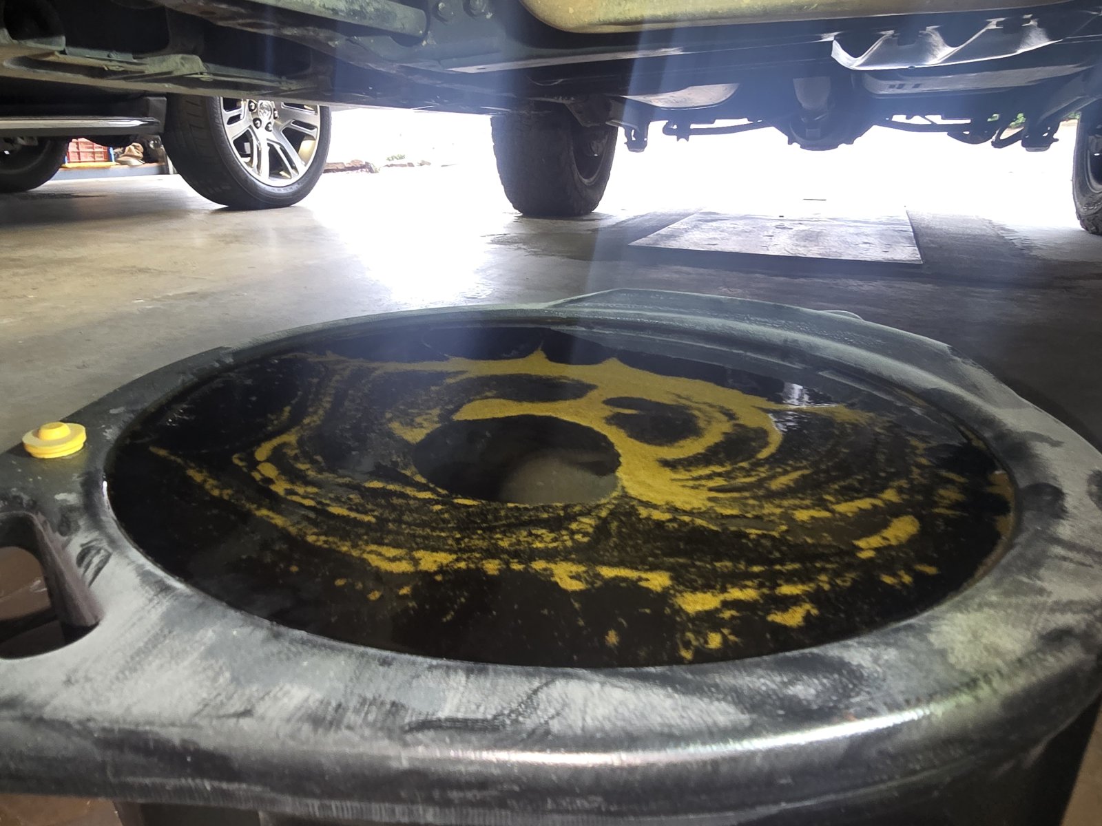

Howdy, Peps!
Thoughts on this ugly sight? I drained my oil, and it looks contaminated. It initially came out a little lumpy. Antifreeze? I'm wondering if I've got a blown head gasket. If so, I'm looking at this as an opportunity to upgrade my cam, lifters, timing chain, water pump, etc...

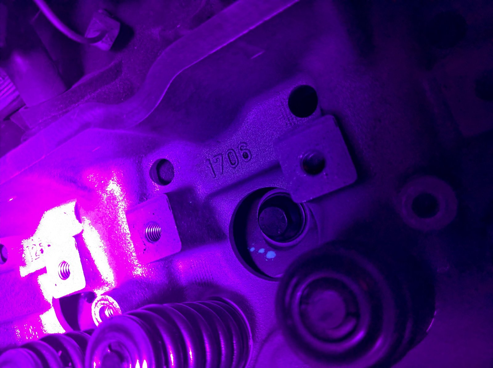

I do like windows of opportunity. Any compression test readings? You can also check for Castech logo markings on the head(s) when one pulls the valve cover. Others should jump in soon with solid advice.

If the heads are 706, pull the valve covers and the rocker tray and look for the castech logo. If so, you likely have cracked heads and not a gasket problem. Mine didn't crack until ~162k miles. Then a refurb set cracked in <500 miles. Avoid the battery logo and good luck!

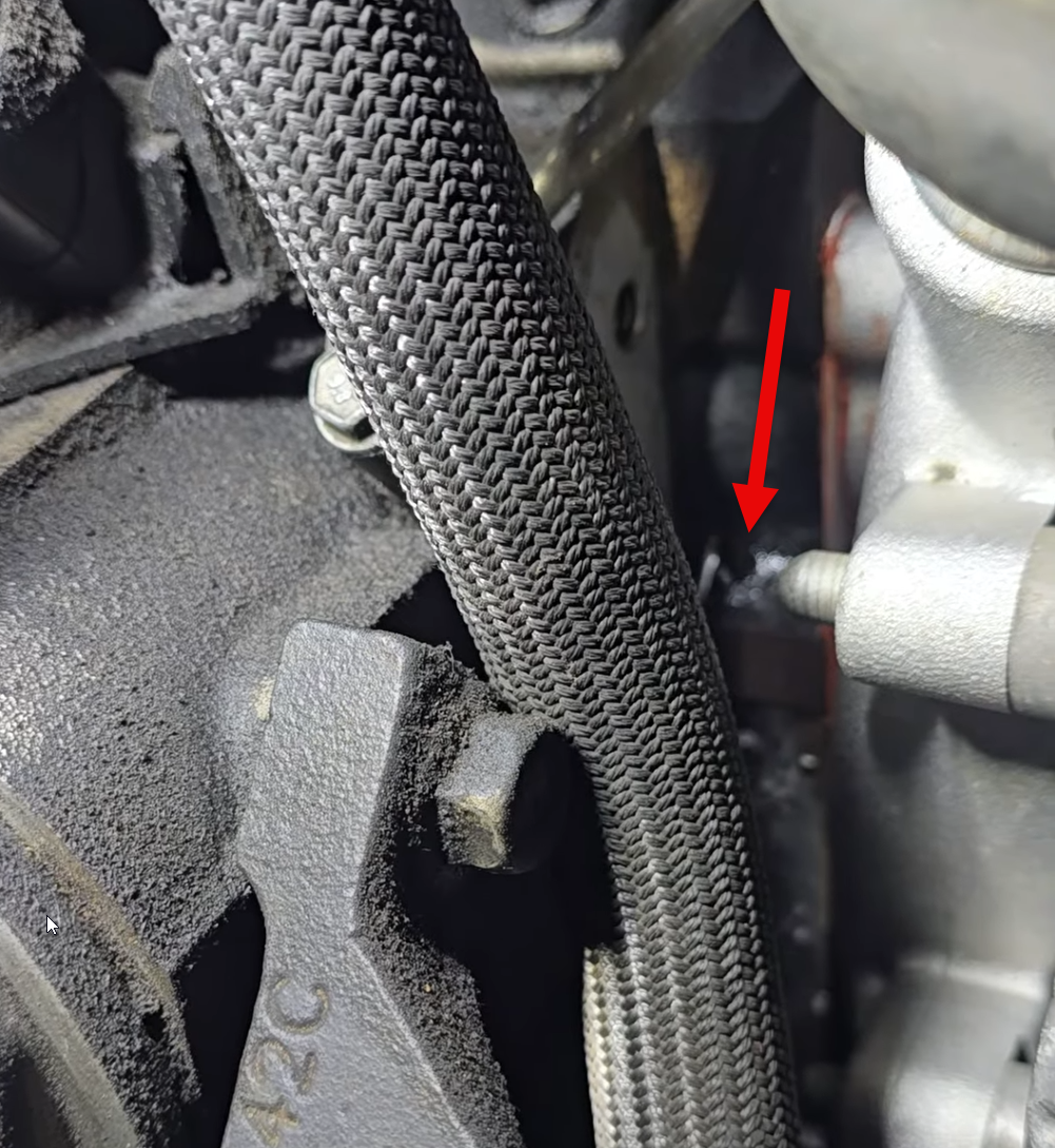

I rented a pressure tester kit and put about 15lbs of pressure and see exactly where it's leaking. It's squeezing out right above where the heater core hoses attach.
I'm hoping I don't have a cracked head. When I get my valve covers off, I'll defiantly look to see what I've got. Thank you for that! ** I just went and looked and my heads are 862, so hopefully I'm safe.
I've put in an order for a BTR Truck Norris with the top end rebuild kit. Also added a new timing chain and high pressure oil pump since I'm going to be pulling the cover off.

blown gaskets are extremely rare on these engines, cracked head is much more likely, you can pull them off and find the local shop that resurfaces and checks them. probably run you $150 or so. then you know for sure if you need a replacement or not

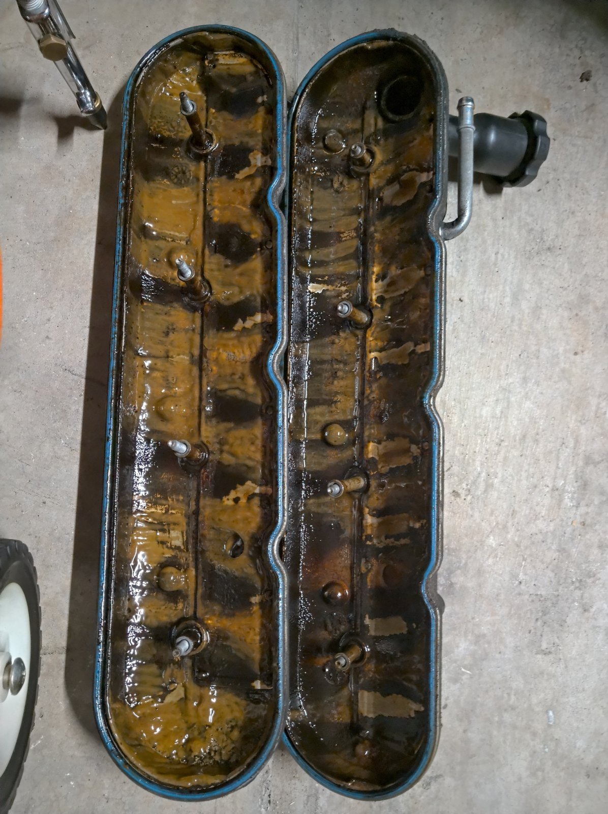

Question, new head bolts being used or the same ones? Just a question. Lol
OEM bolts are torque-to-yield (TTY) so they need replacing. I went with ARP bolts (there are two styles of OEM, be sure to check) as my pic shows. These have an easier torque sequence (values vs angles), as well as being reusable. If you're doing a build, might go with studs.
