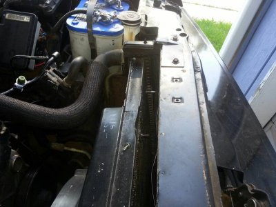

I did mine a little different. I bought the one piece adjustable fan controller for 40 bucks and had no problems with overheating or ac. I am running a 180 thermostat and it stays around 180 185.

Yea I did my set up the way I did bcuz I went through 2 O'riley and 1 AutoZone temp controllers... The relays kept burning up... Lead to a cracked rad and failed water pump... The fan draws as high as 60 amps... But if u got 1 that works 4 u great...

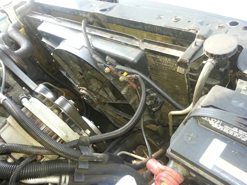

For one that is not my fan controller you circled on the fan that is the factory chevy waffer fuse. The fuse blew when I put my second battery in(positive cable hit the bottom of the battery tray).That's why it looks that way. Pic was took before I chanced it.
Secondly the truck stays cool 180-185 degrees even with air on. Guarante what you know not what you guess.
Also the fans job is to push or pull outside cool air through the radiator ( depending on where the fan is mounted). If my fan is pulling enough cfm to cool the coolant before it reenter the engine than its doing a damn good job.

The picture I was asking about that part because I couldn't find in mine! Nothing like it is install and is it a must?

That thing in the picture is on our stock fan shroud... Its something to do with the battery... I can't remember the name off the top of my head at the moment...
