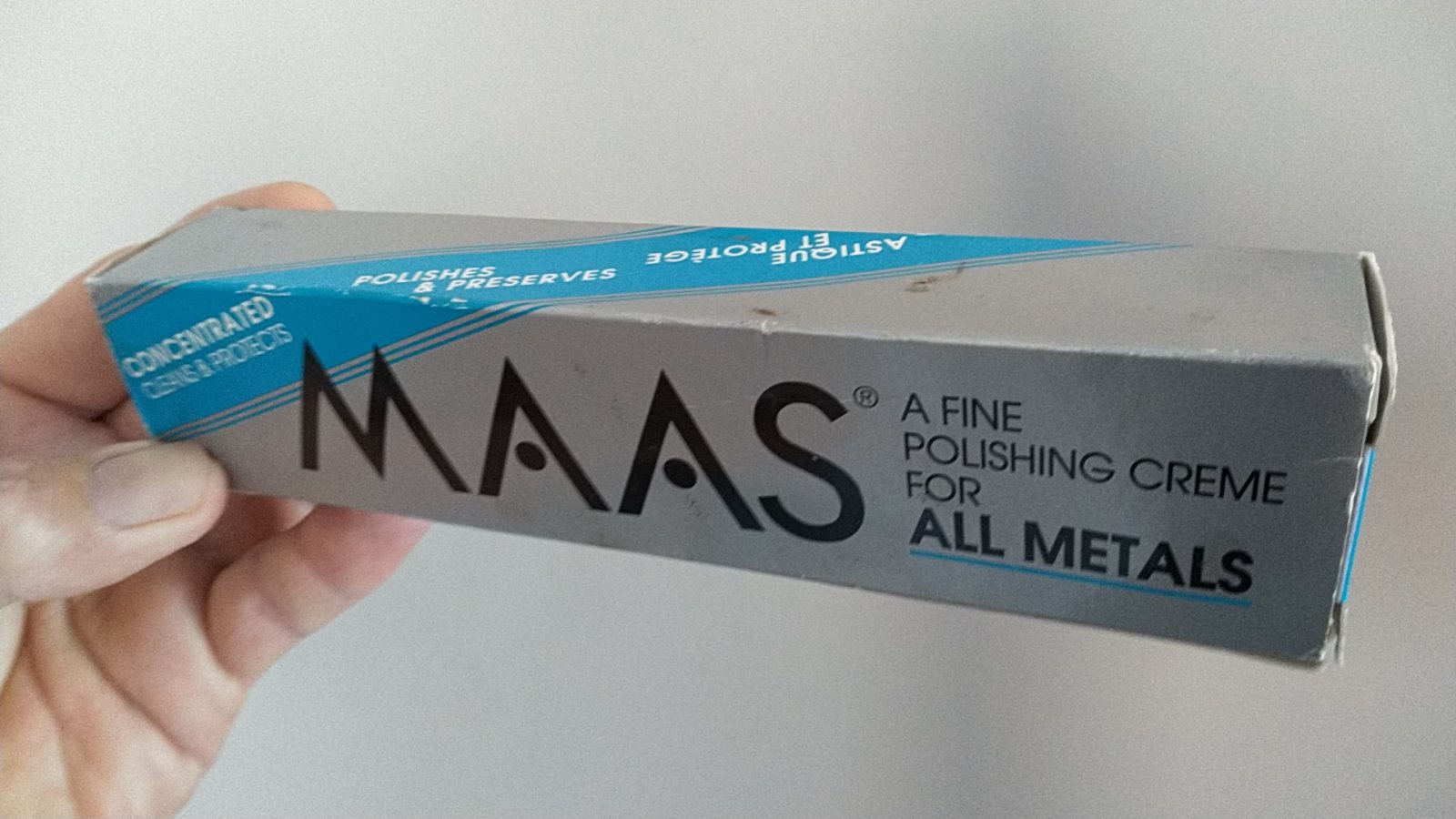

From my experience.... REAL chrome plating can be cleaned without surface damage by using soft brass brushes..... ( I don't know if there is such a thing as 'brass wool"?? ).... THEN polish. ( You know "science".... use a material that is weaker than the surface to be cleaned)
As for a plastic "chrome" finish..... That is a tough one..... But a non-abrasive polish ( like for silver cleaning?)...... Like 'SemiChrome' cleaners you can fine at a Harley Davidson shop??
Or find a tube of "MAAS Fine polish". The best stuff to clean without scratches.
The alternative if the chrome coating is just bad, you can actually get spray can-kit of actual Chrome finish....Similar to the chrome coating on the plastic.
( I saw Chip Foose use it )
(( There is always Ebay to buy a new grill..... Something I didn't have to mention )
