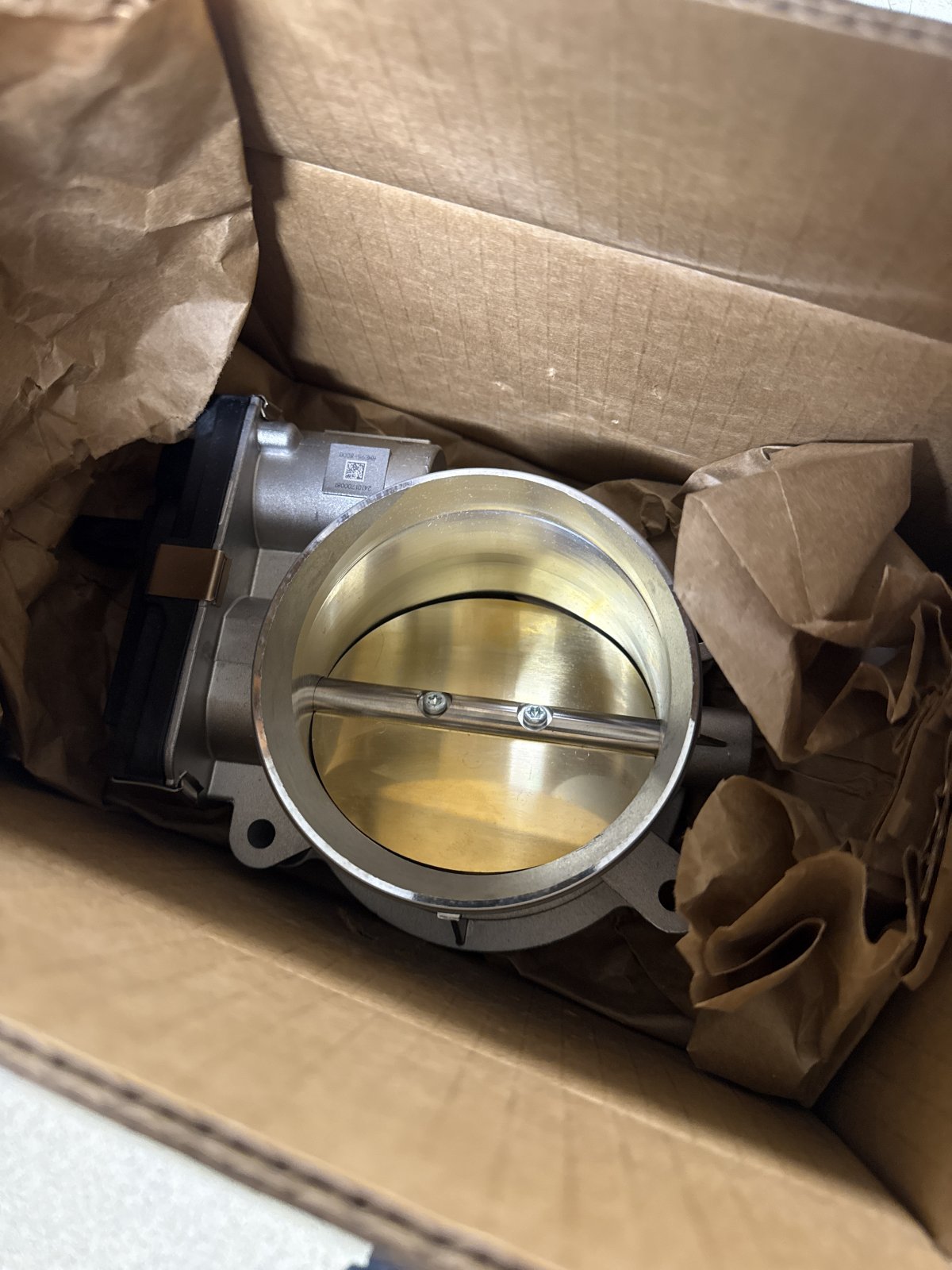

just a little update- parts are rolling in, got the btr stage 2 truck cam but think i might return it for the truck norris nsr. afe magnum force stage 2 Cai, little misc. shit like fuel pressure sensor, harness. found out the l8t throttle body is not compatible with the ECU so i was forced to buy a 95mm LT5 tb out of a 2019 corvette zr1. i don’t know how i found this website down the rabbit hole but it may be handy for anyone wanting to dress up the engine bay - siliconeintakes.com

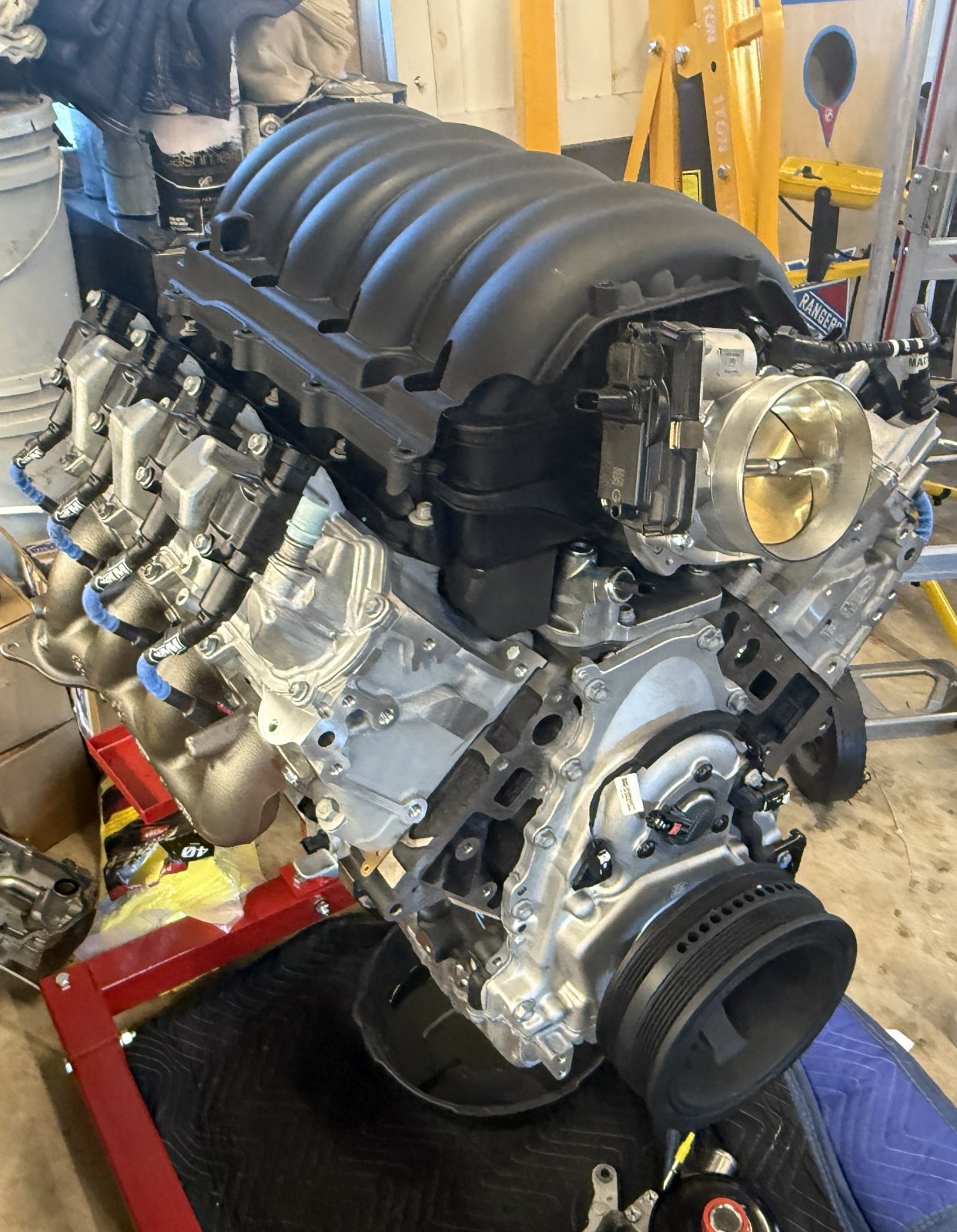

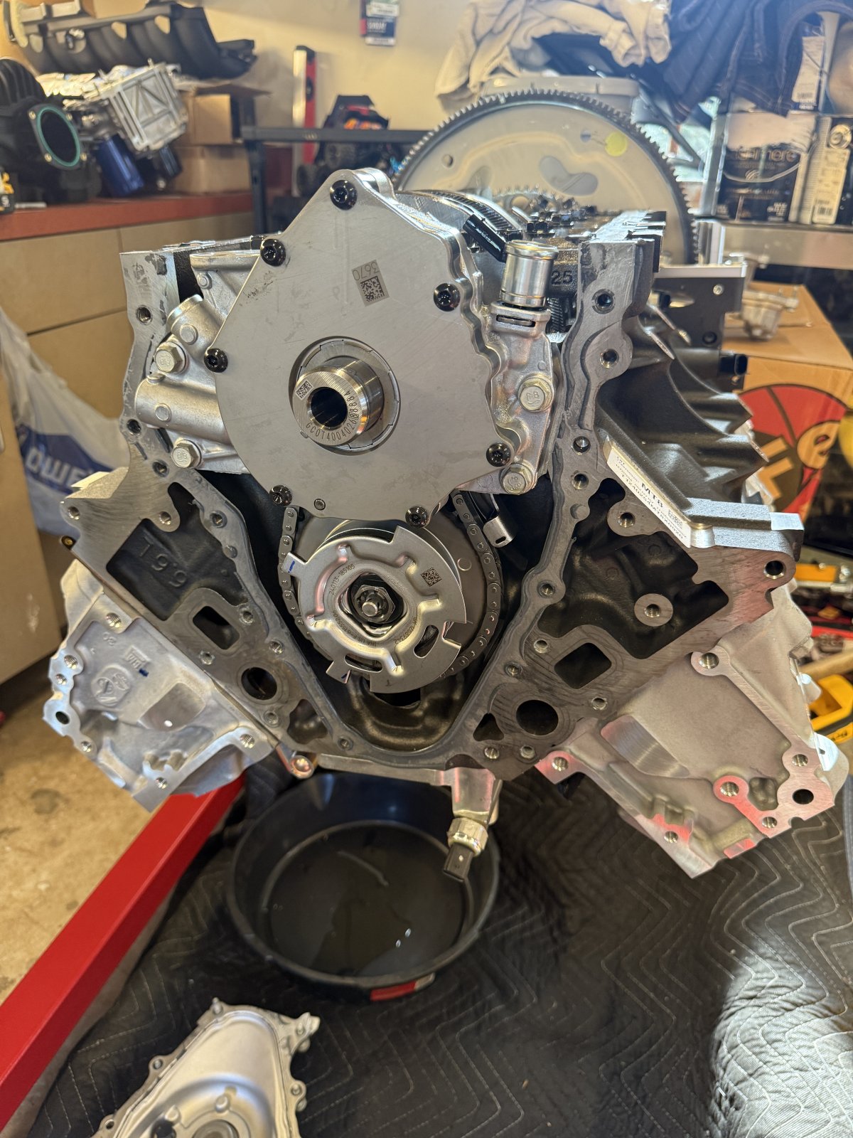

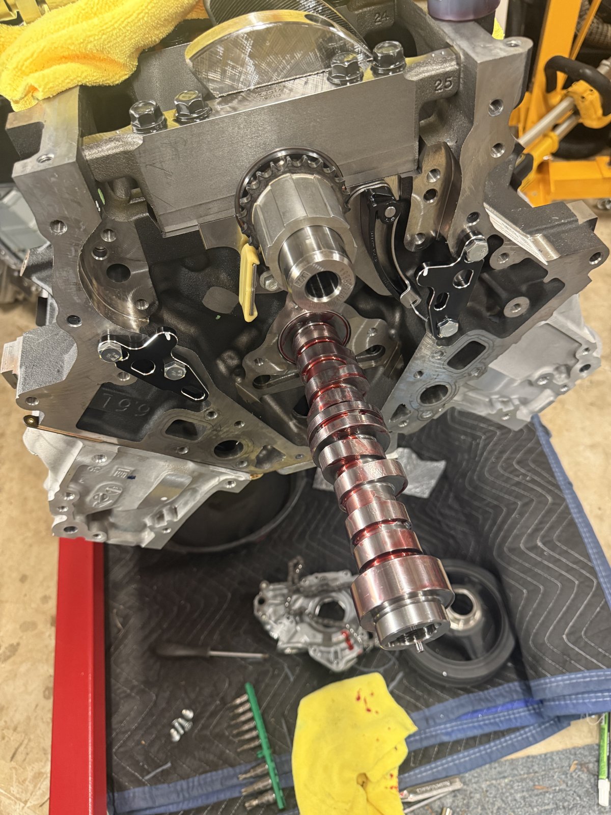

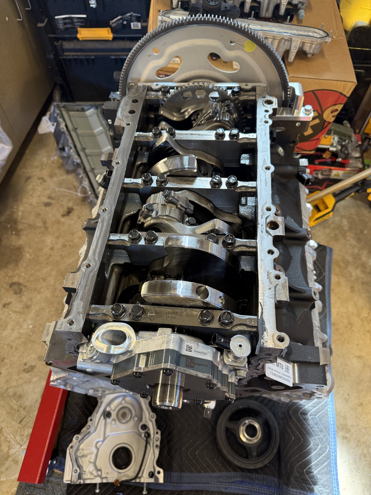

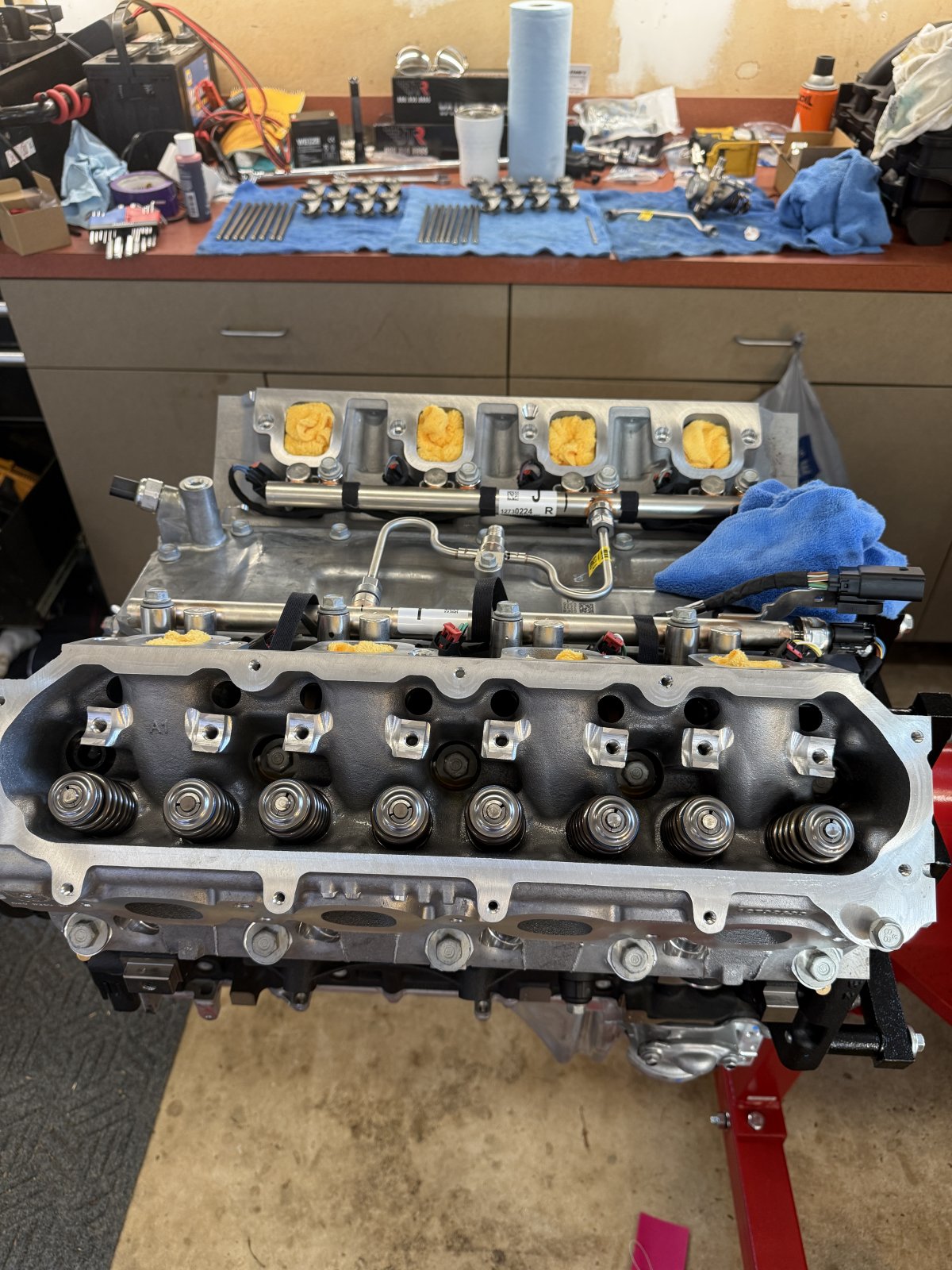

Update on the build:
Got the cam and springs swapped out, CAI, throttle body, motor mounts, basically every other peripheral is in hand ready. Even though the transmission was just rebuild with a new converter ill probably be getting a new circle d with a higher stall - 2400-2600. Just picking at it here and there after the kids go to bed etc. Will be putting the cam limiter in tomorrow and reassembling the front of the motor. and the oil pan and flippin her back over. IMG_6534.jpegIMG_6530.jpegIMG_6533.jpegIMG_6676.jpegIMG_6693.jpeg

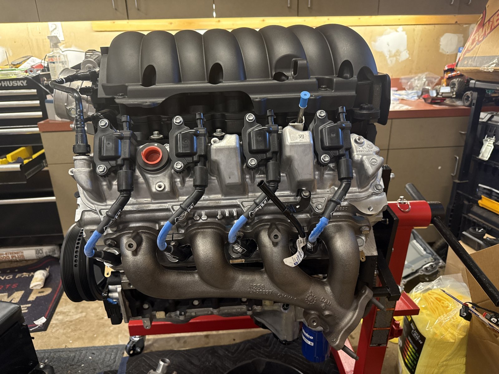

Shes all back together and ready to be dropped in, its going to kill me to wait until January but it is what it is. Just dont have the time right now and will wait for Christmas bonus to get a few other things like a circle d TQ with a higher stall and MAYBE some kooks long tubes.
