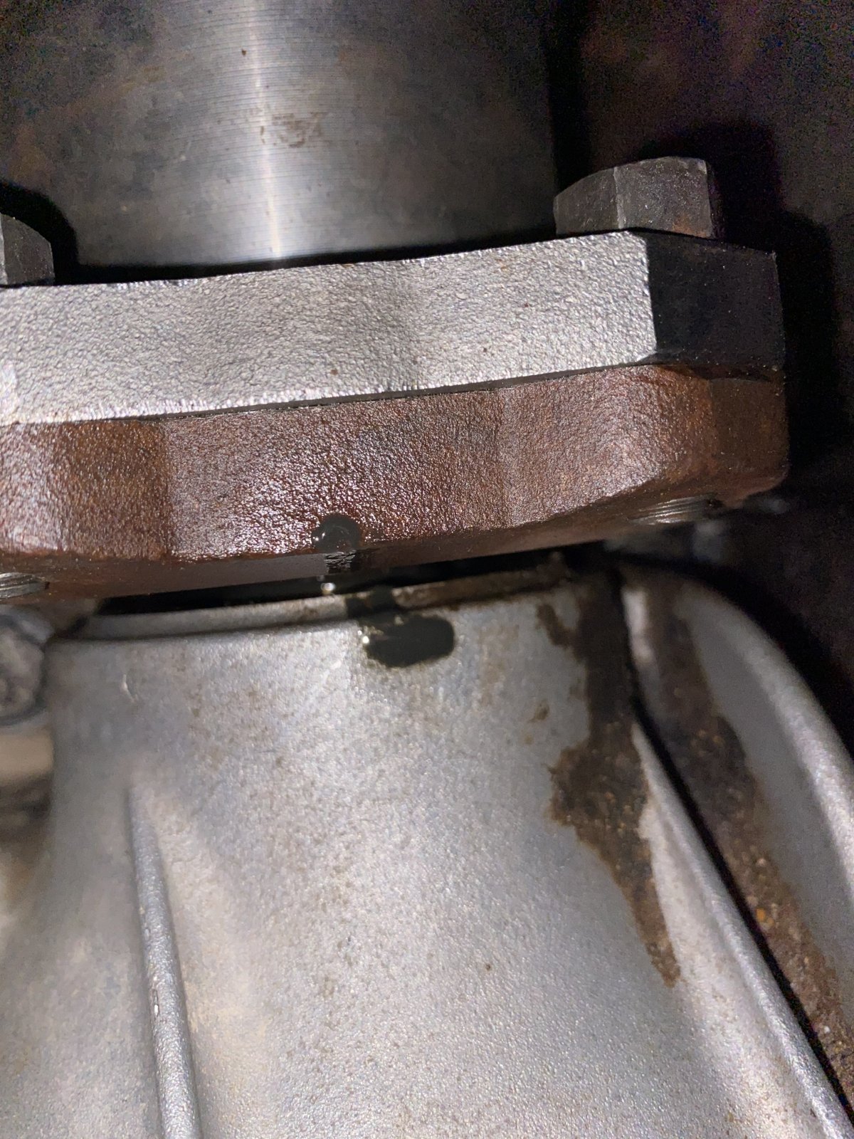

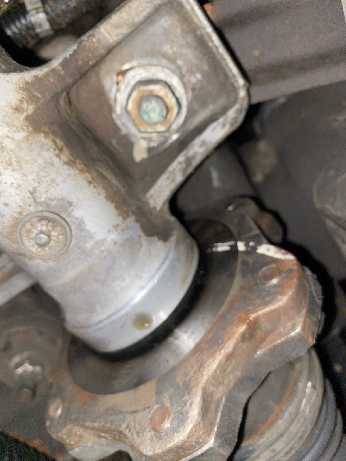

update: day after I got the Tahoe back I had a pancake size PS leak under the car. The shop put another new rack in it which solved the issue at no charge.
honestly the truck runs better than ever with the new rack, ujoints, and new exhaust manifolds.
THAT SAID, it appears my front axles are still leaking (they replaced the seals). Anyone have thoughts on if maybe they did something wrong or if their are worse seals than others? Or maybe my axles are worn down? I am dropping it back off this afternoon for the axles seals to be investigated.

I don't recall if you had a full rebuild of the front axle or not, however if the bearings behind the seals are sloppy, it would quickly wipe out the new seals.
While trying to nurse my S10 along, while replacing the seals i noticed a ton of slop.
ended up replacing the bearings that i could extract WO full disassembly of the axle, I ran it for years like that. Still to this day no leaks. :D
it also cured vibration that would only occur once in a while at freeway speeds.
Now if you did have the bearings replaced with the seals, then it's possible the seal was "rolled" a little when installing.
That would prevent the seal from doing it's job.
I also learned to take something like 800 grit on the shaft surface prior to fully reinstalling.
Usually i'll do it dry for the first few light swipes, and then finish it up with some oil (like WD-40), or even water will work.
Gives it a nice smooth shiny surface.
Idea is to pretty much knock off some of the rut that forms from the original seal, i like to work a nice (light) crosshatch into the surface.
I don't go crazy, just smoothing it out a little.
I have even used 600 and 1000 grit, pretty much what ever i have laying around, but i don't like to go below 600 grit.
I don't know if it's correct or not, however i have had very good luck doing it. ;)

Also, there is a spec for the shaft.
at some point you may need to just replace the shaft.
However, doing the above method, i have reused shafts that had a pretty good rut formed from the seal...

Thanks for the tip, they only replaced the seals. Maybe they need to do the bearings. Ill ask them about it. Thanks!

Got the Tahoe back, they say they installed delco seals the first time and this time was something from nappa. So far no leaks and the shop says the front axles are fine. I tried moving them myself but i mean, i dont even think a micrometer could measure the little movement I got out of either side of the Front axles.
i am going to put some miles on it and see how everything holds up then report back.
