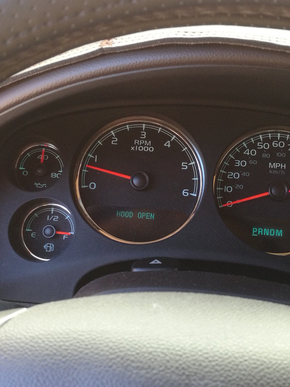

The truck is 2012 Yukon Denali XL with 90k miles.
This happened since yesterday. I did an oil change and it didn't help.
Please help to diagnose if this is because of the sensor, oil pump, o-ring or something else.
This is my only car. I can work on it during weekend. Just want to make sure I work on the correct path.

Well, I didn't hear any knocking when it was a zero for awhile. I'm going to speculate that you have a flakey pressure sender. That would be the easiest, cost effective solution to try on a weekend, or week night. Just look up past threads for input on how to replace it w/o a lot of hassle if you are mechanically inclined and don't mind some scuffed up hands.
Does the engine change sounds at all while this is happening?

wow doing that at idle, looks like a sender to me.
look at the wiring the best you can while doing it, make sure you don't have a short or dirty connection.

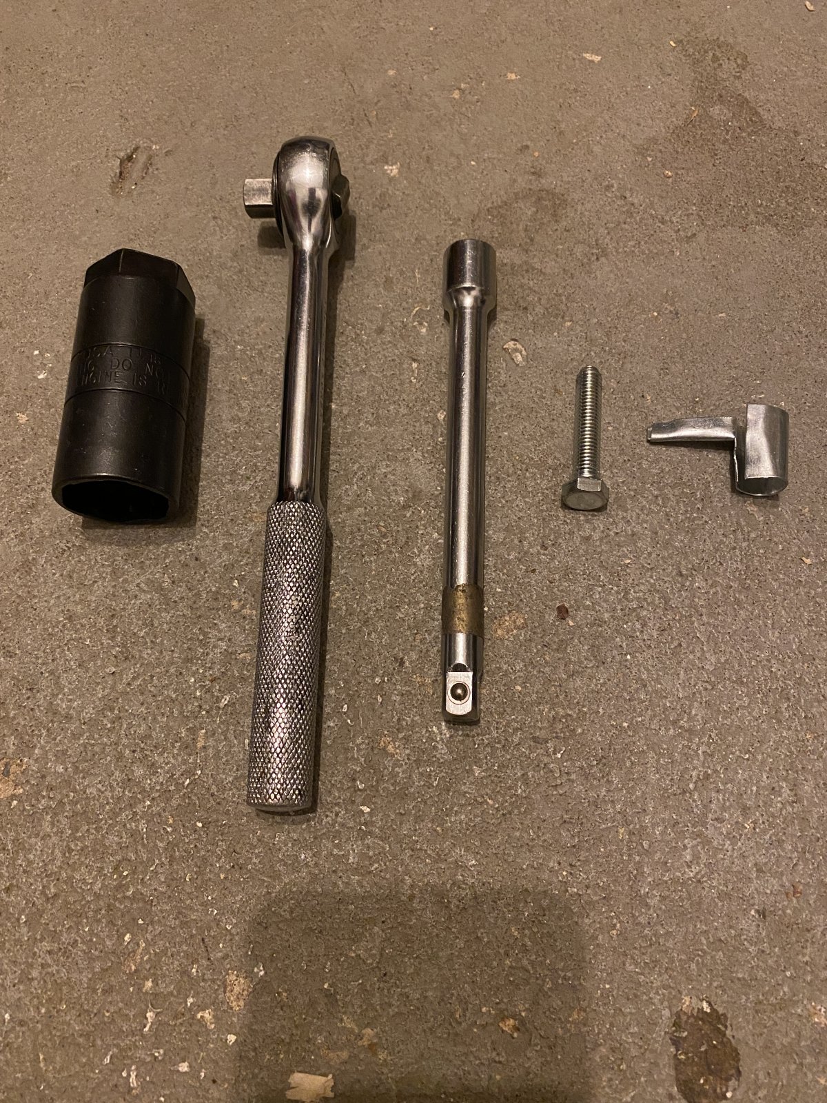

I've read here that it takes a special socket to remove/install pressure sensor
Lisle 13250 is the one.

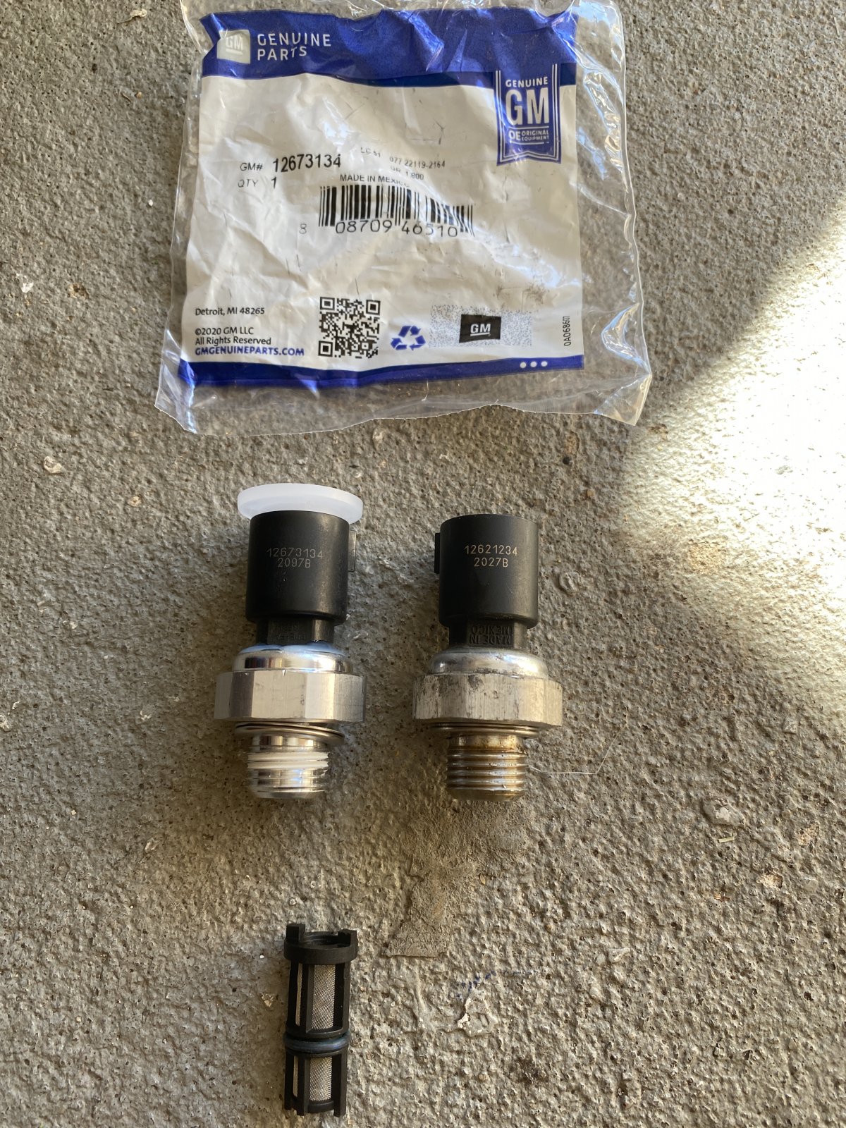

Thank you all for help. I finally had time to work on the problem tonight.
I removed the sensor and screen. They are all clean. The screen was not clogged.
I guessed the problem was from the sensor. Next I will order sensor to replace.
To remove the sensor for me, I had to remove the fuel line connector and brake vacuum hose.
I used a piece of metal sheet to make a small tool to remove the fuel line.
I will report back when I replace the sensor.
Remove brake hose:
Remove fuel line connector:

Report back. I replaced the oil pressure sensor today. The problem was solved.
I bought the sensor from RA and hope it will last for a few years. Can't trust the sellers on Amazon.
Appreciate for the help from all of you guys.
Best regards.
OR VietVet
GMT800 2005 Tahoe Z71
Navy Supporting Member
Oct 8, 2014
23,915
44,622
Willamette Valley
Best regards.
Did the screen come with it or did you buy that seperately?
