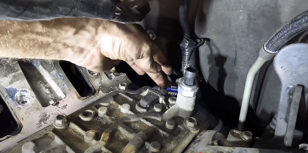

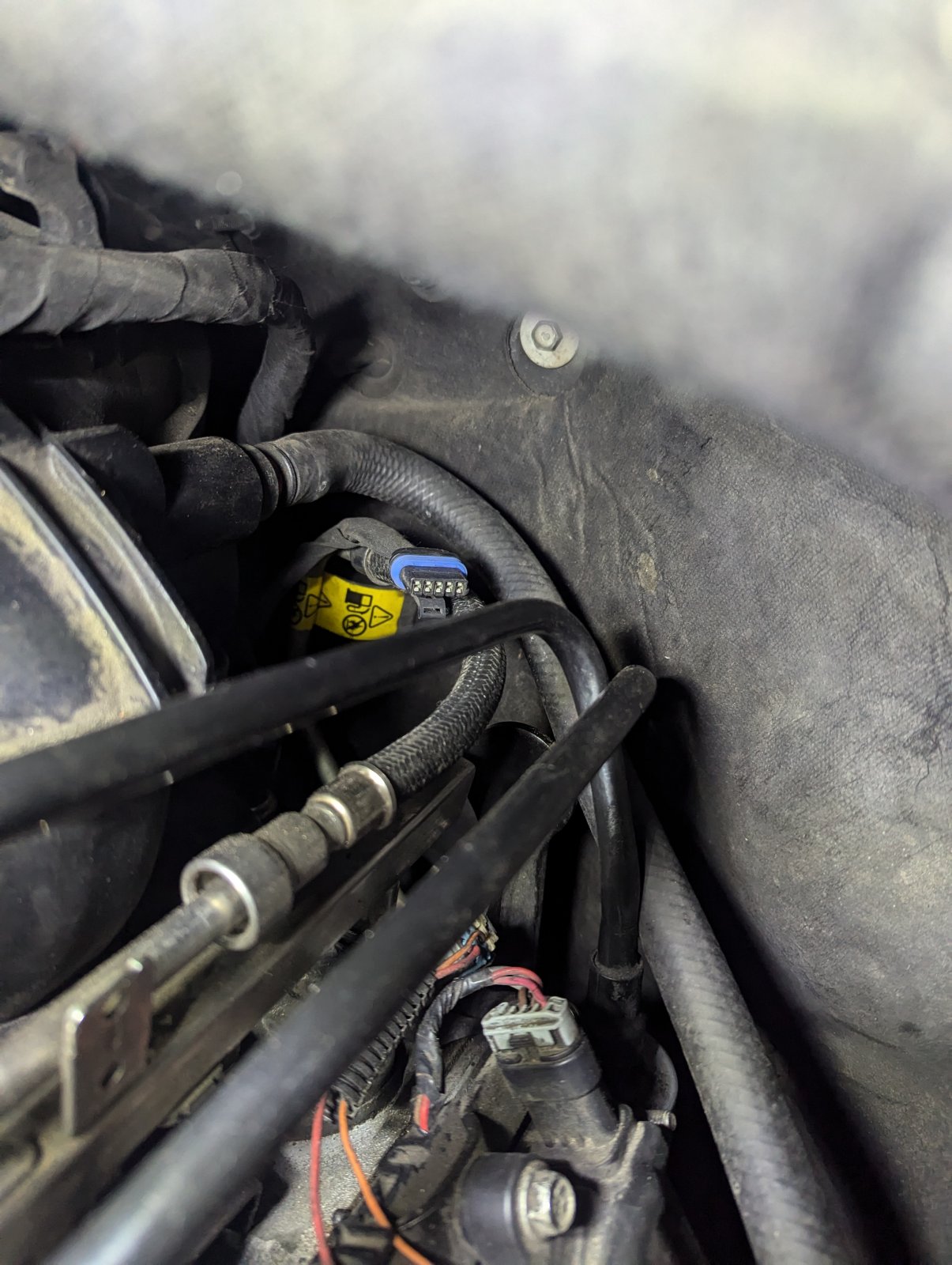

Hey y'all. I would really appreciate some help. I can't seem to identify this wire by the back of the manifold. It's part of a harness coming out by the firewall. I've included a picture.
Recent history of the situation : Yukon is throwing evap codes. I had it at a garage about a week and a half ago. The codes started after that along with a ticking noise that sounded like a lifter.
This particular garage is a ways away from where I am now, so I wasn't bringing it back. I started investigating the evap system. They left the hose coming from the purge valve disconnected in the back of the engine. I reconnected that. While I was back there I noticed this wire that was disconnected. I've looked at diagrams, I've been fishing around looking for the mail connecting piece. Can't find it. Any help would be appreciated, thanks in advance.

weird I personally can only guess it is supposed to be connected to something down lower, normally right there is where the oil pressure sensor is but that connector is a 3 pin
what kind of work did you have done? i wonder if that harness goes down under somewhere....

Looks like the VLOM connector
Do you have your afm/dod disabled ????

At first I thought it plugged in next to the oil sensor, the clip looked like it had a spot for it, but it it doesn't fit next to it.

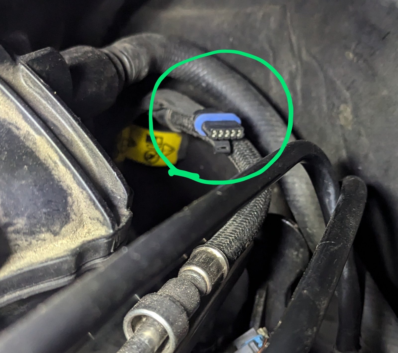

The VLOM contains the deactivation solenoids for the cylinder deactivation
And that's the connector for it at the rear of the intake...
I would think you'd still have it connected as the diablosport just
prevents it from going into the afm/dod mode. And I would think that with
it disconnected, it would throw codes

so did they buy the vlom plate and tell him there was a deactivation solenoid on it that turned afm off?
I'm so confused by this whole thing haha. feels like the shop didn't understand how afm works and just made things up.
but no, once turned off in the ecm, that doesn't need to be plugged in. since with a true delete kit with standard lifters you replace the vlom with a smooth lifter valley plate anyways. there's nothing to plug into.

That would make sense, because that's what was being looked at. And I agree, you would think you'd be throwing codes if it was disconnected. Evap code still hasn't come back, but the catalytic code is still there. Thanks for the reply!
