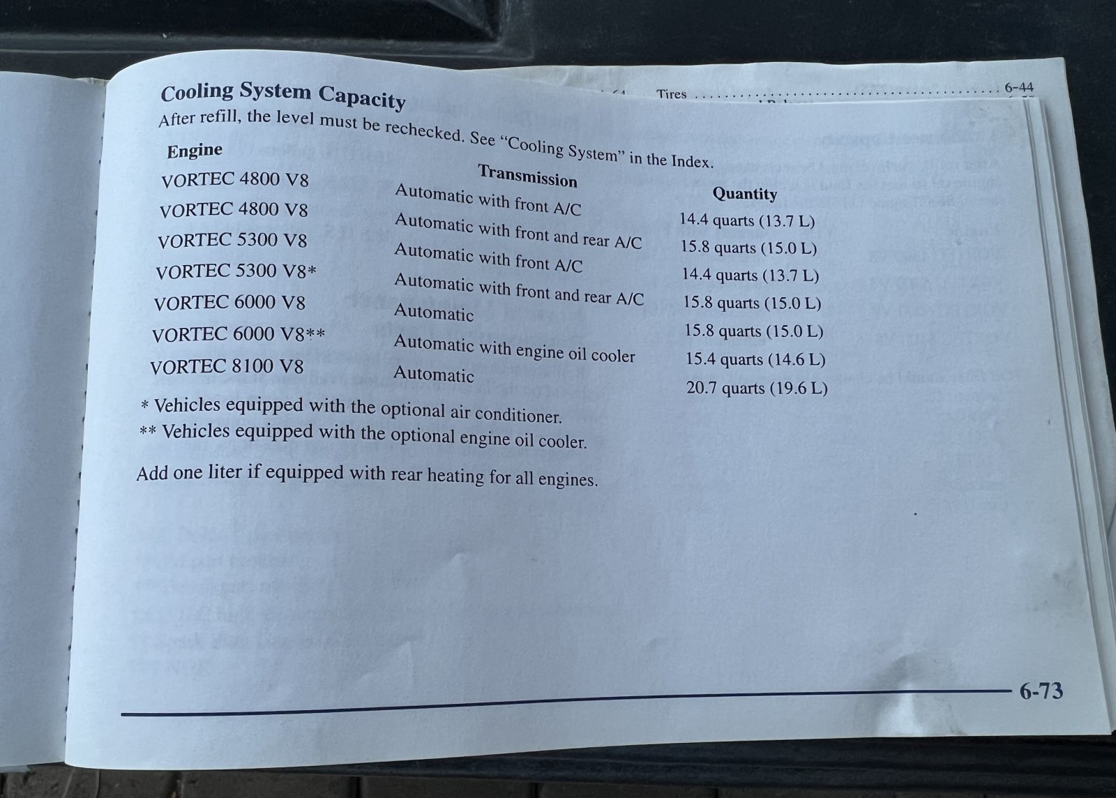

Anyone know cooling system fluid capacity approx?

Mine's an '08 and my notes show approximately 17 quarts. There will always be some coolant in there. I always get two gallons of concentrate and two gallons of the water- makes 16 quarts of coolant at 50/50 mix. There will be plenty left over. I mix it 50/50 and have my own pre-mix ready for topping off of my Tahoe or other vehicles.

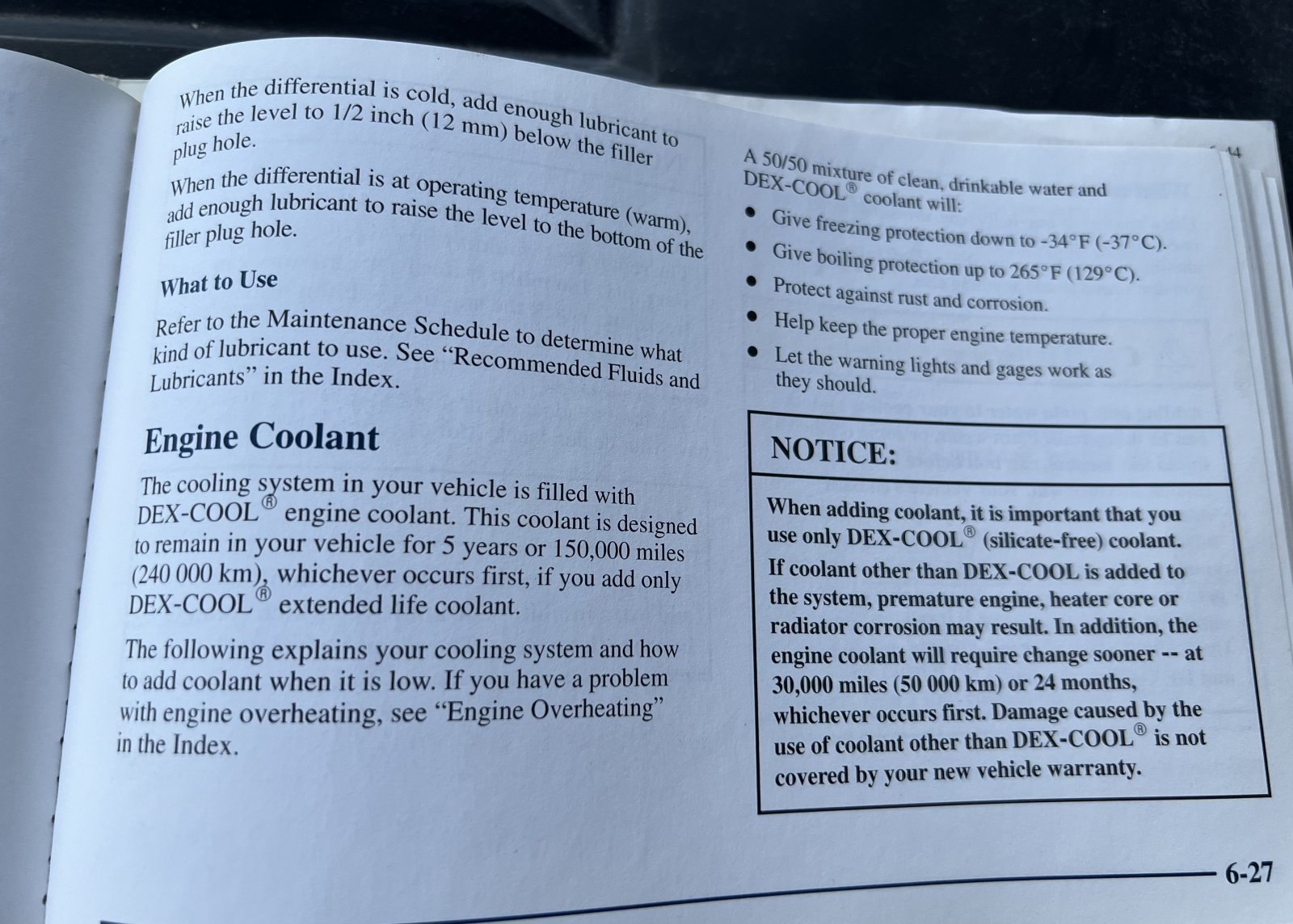

Update - Answering my own question - YES.
I’ll check the owner’s manual, but I believe 2001 GMC Yukon 5.3L 4WD requires Orange Dexcool coolant. Does anyone know the answer to this? (yes)
But wow, there is quite the history on orange Dex Cool coolant, including a class action lawsuit that was settled w a payout. I got over 170,000 miles and 22 years w my original radiator and water pump so am sticking with the Dexcool and Genuine GM water pump and radiator (plastic end caps and all). I guess the key is to ensure Dexcool never gets mixed w Propylene Glycol based coolant.

That's really old news. The problem was mostly people running it low and the air in the system turned it into a corrosive mud. They've long since changed the formula. Also, with the LS having a closed cooling system and much better seal design throughout, there's very little chance of a problem. Any competent shop would flush the system as needed while doing all this work. Besides, you're replacing the critical components most affected. All that's left is to ensure the block is clean and flush the heater core, if necessary.
I've always used the Prestone orange stuff that's compatible with Dex-Cool as well as being mixed with the "green stuff", but have never had any reason to mix it.
