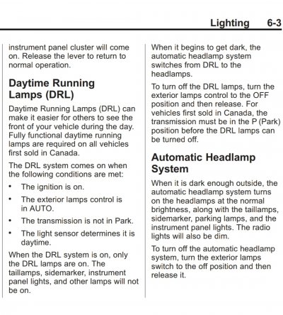

Yukons use the low beam headlights as the daytime running lights.
Directly from my 2012 owners manual

I answered the question in the 2nd post, even posted a screenshot of the owner's manual explaining it. Why is this still in question? Lol
