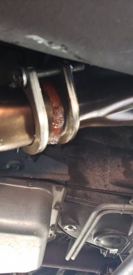

Aha!
Not sure what to do now since RTV didn't hold up. Gonna try rotating the bolts so the bolt is pulling right on the leak and retightening.

Could you use a band clamp? They're about 3 inches wide. Will reform to fit over a joint. Use them on flex pipe to pipe joints all the time. That's how much they clamp down. Seal pretty good.

Don't think a clamp like that will work with this connection.
