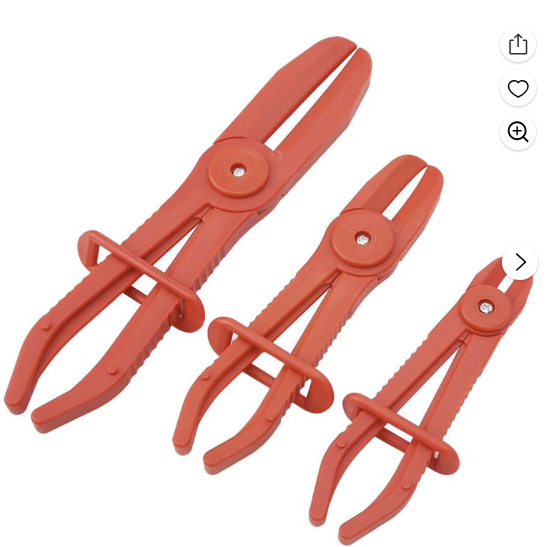

You can just use pliers with soft jaws to temporarily restrict it somewhat to see what happens. Don't collapse the hose but just squeeze it a bit. Hose pinch pliers would be good, or even a small spring clamp.
