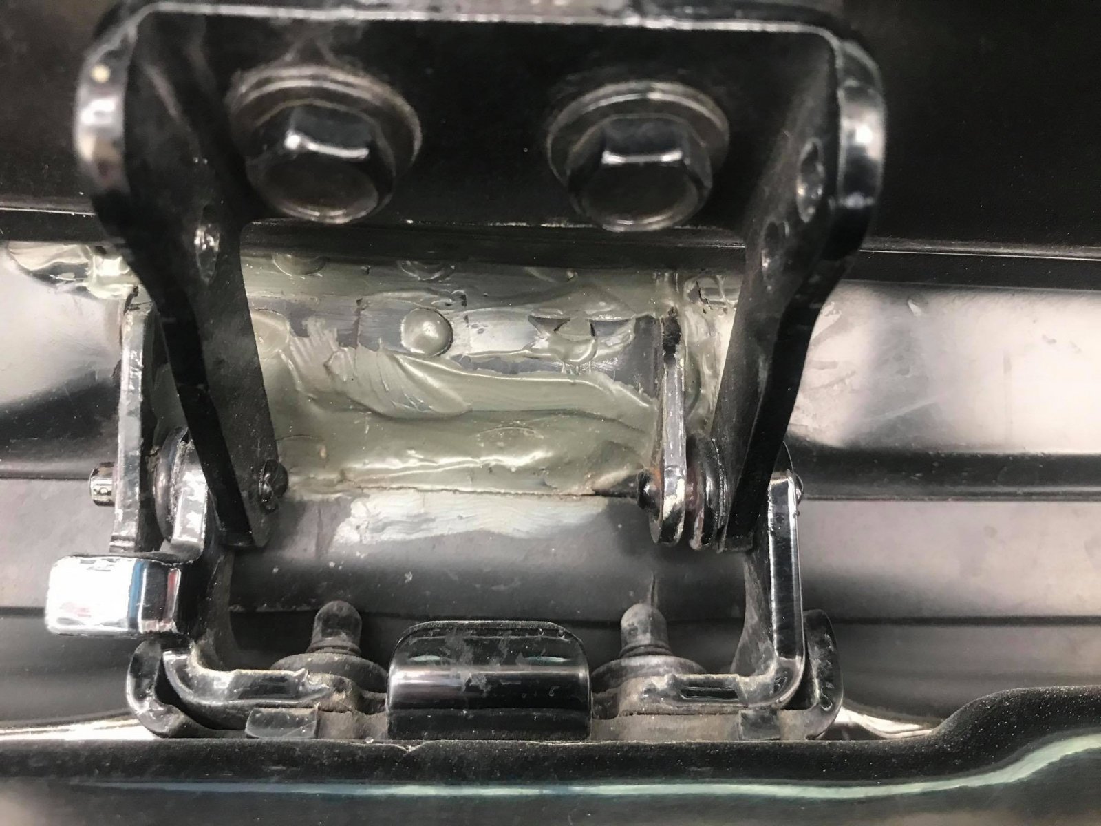

After an extensive google search, I settled on 3M Windo-Weld (08690).
As I removed the old hinge, I noticed that the original adhesive did not actually adhere the metal hinge itself to the glass, even though there was adhesive between the hinge and glass. Yet, this hinge has lasted 17 years. I also noticed that the adhesive completely covered the hinge and was spread out over 12" (a good 6" both sides of the hinge), and was built up at least 1/8" over the hinge. This had lead me to surmise that the adhesive is not relying on adhering the hinge to the glass, but rather, using the adhesive to keep the hinge clamped to the glass. With this in mind, this is what I did:
1) Cleaned off all surfaces as much as I could, reasonably. I used a drum sander on my dremel which made quick work of removing old adhesive, even down to the glass. I did use a rotary brush on the hinge to remove as much old adhesive as I could. I removed enough old adhesive on the glass so that I could build it up again over the hinge, but left enough so that I could easily locate the hinge in its original position.
2) Washed the entire area with water. Because the area being repaired was well sanded, I felt it wasn't necessary to use any detergent or other solvent. In fact, the urethane sealant cures better with a little moisture.
3) Warmed up the tube of 3M 08690 inside a ziplock bag, in a sink of hot water.
4) Applied some painters tape to prevent over covering the area with adhesive.
5) Applied adhesive generously to the glass where the base would be located.
6) Pressed, by hand, the hinge to the glass, and wriggled it into position until I could feel it "lock" into the original position.
7) Applied more adhesive so that I would have a good 1/8" on top of the hinge, and spread it out about 3" past the sides of the hinge. I also smoothed it over as best I could with my gloved hand. The repair doesn't look pretty, but no one will be looking at it.
8) Set up a heater to increase the curing temperature to 90°F. A cure to 150 psi will be achieved between two to four hours, depending on relative humidity.
It is sitting curing right now, so I don't actually know if this is going to work or not. But, judging from what others have done, this repair with this adhesive has lasted several years.

There is something else I noticed about the old hinge mounting. The adhesive from the factory did NOT cover the hinge very well. The hinge has several holes that get filled with the urethane adhesive, and covered over the a good 1/8" of adhesive. The holes of the hinge were visible on this hinge. The holes on the other hinge, which is still holding, are not visible, and still well covered.
What could this mean? If your hinge has not yet separated, you might be able to prevent a hinge failure by examining the hinge. If the adhesive does not adequately cover the hinge base, you could try lightly sanding the adhesive, and applying more on top of the original adhesive. If the original adhesive is urethane, and you use the 3M 08690, it might bond well enough to prevent the hinge from separating.
Just a thought, and could be worth trying.

Well, that repair lasted only a year. In the fall of 2020 the same hinge gave away. As I understand it, there is a primer I should have used on the old urethane sealant to ensure a good bond, or make sure I remove ALL urethane sealant.
I also know that a 2005 hatch also fits, but the hinges are mounted differently and more securely onto the glass. Unfortunately, I've been waiting for 8 months for one of these to show up at the auto recyclers, but none have show up yet. So, it looks like I'll need to do the repair once again, and hope I can make it last a little longer.

Either you never use the hatch, or you are very lucky with the JBWeld. Anyone else who has used it found that the JBWeld is so brittle it cracks away after.
I plan to redo mine this summer, but do a more thorough cleaning up down to bare glass. My only concern is how do I make sure the hinge goes onto the exact right spot. I'm hoping I can remove all the old adhesive except for a small bit at each corner. Also, I believe there is an adhesion promoter you can get for the urethane adhesive.
Note: 3M 08682 seems to be the primer to use.
