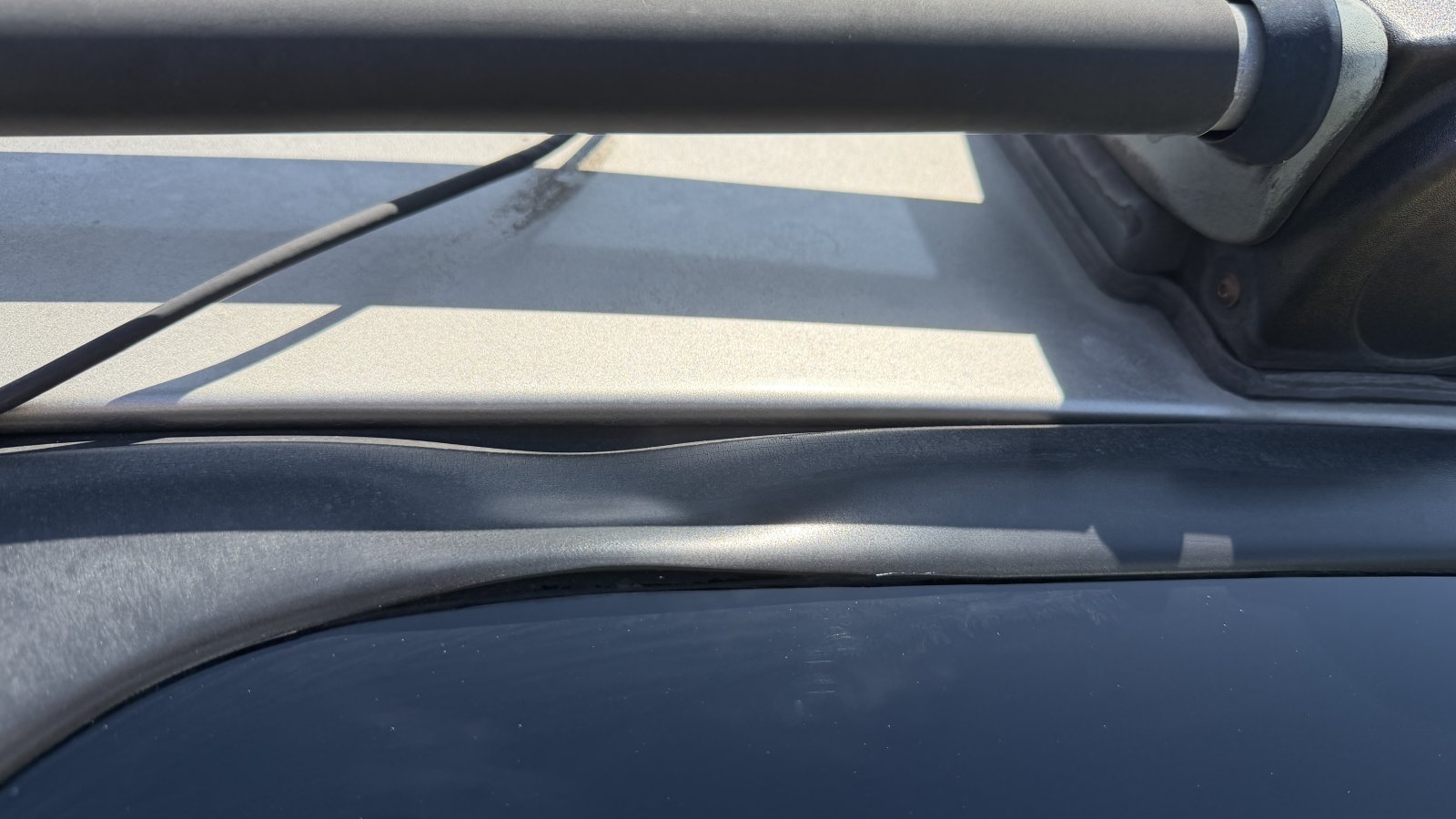

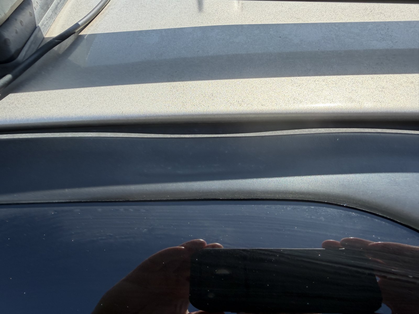

Noticed some warping of the plastic trim on the rear hatch glass. Both sides in the area of the hinges.
Suggestions other than take a heat gun to it and try to restore the shape?
Left Side:
Right Side:
TX heat taking its toll .
Update:
It’s not just plastic warping…
The right side hinge is also loose.

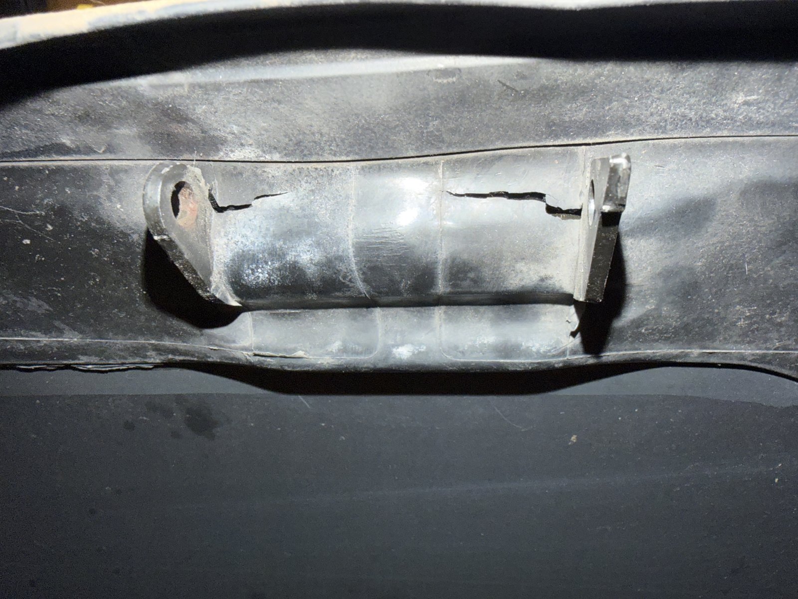

Replaced glass from a local salvage yard.
Broken hinges on original glass
Very loose. Wonder if new stronger strut contributed to its demise…. ?

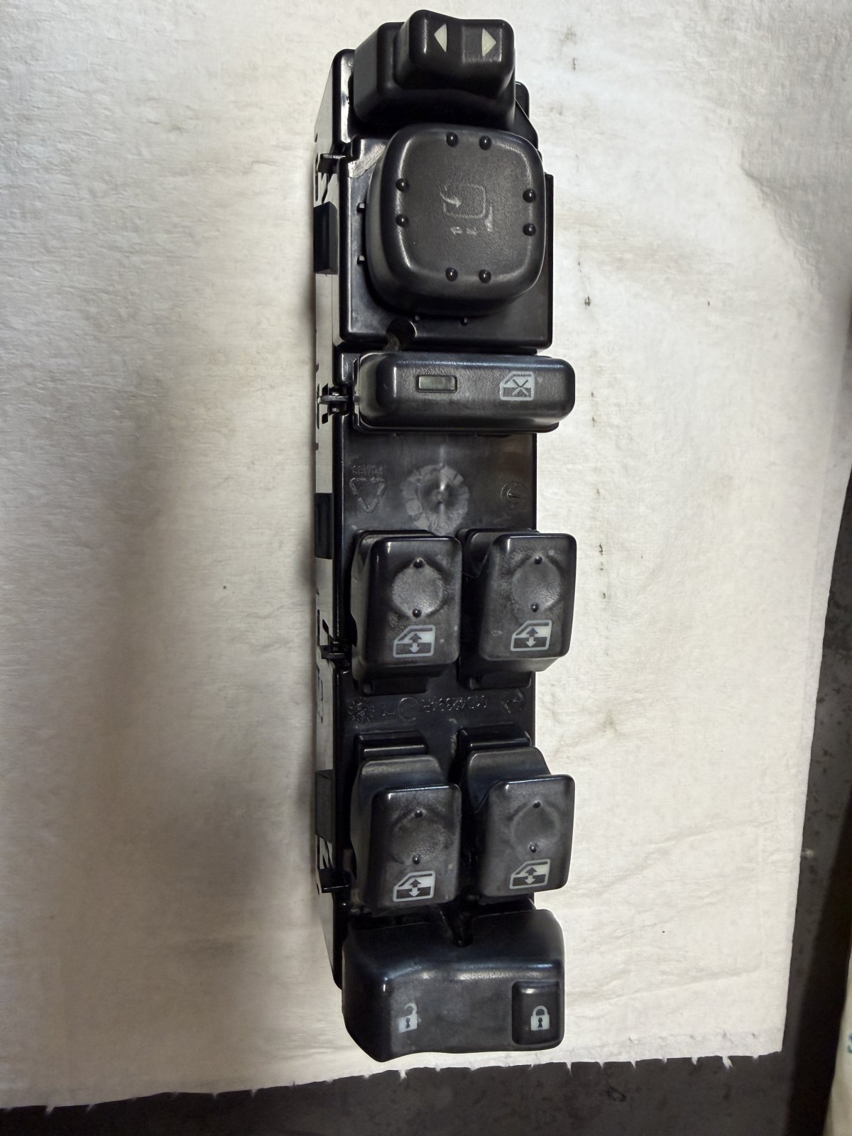

Picked up a DDM while I was there. Will use the electronics of the replacement DDM (if it works) with my original buttons due to fading…

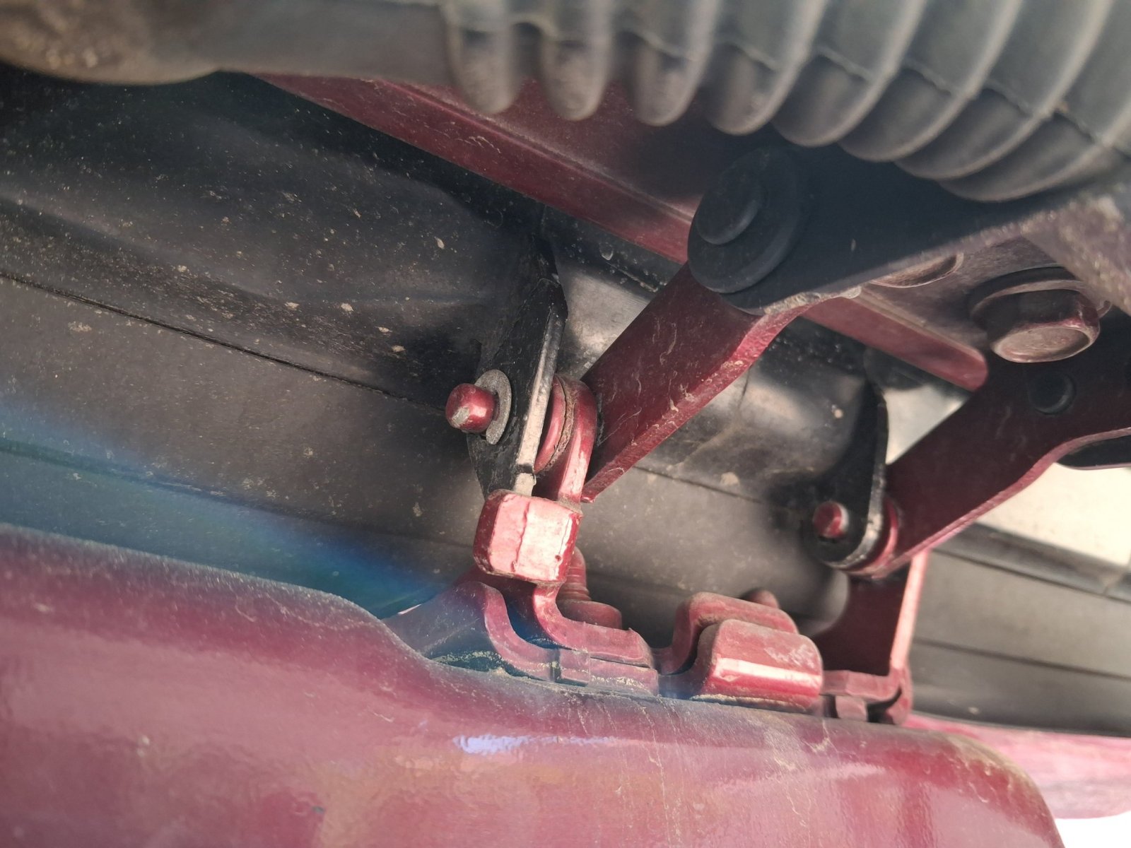

The ones for the glass are definitely e-clips. Lost one of those little ba$****$ when I changed out the glass.

Checked the lift gate hinges on the Z71.
Sure enough, missing the e-clip on the drivers side.
Will replace that when the one for the glass gets replaced. Maybe use a c-clip instead…

E-clips would be easier to remove once they're installed.
