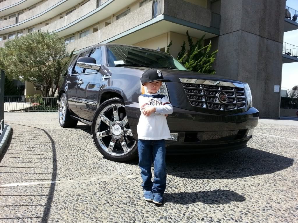

ive been happy wiht hte 2/3-4 kit for autoride i just like this one just a little better, only thing cant tow as much need to get helper bags
my son likes it :)

How did you make it this low with no alignment kit?
Up front he's about 2 5/8
2" Belltech spindles don't do anything to the alignment and the other .5 to .75 will just max out your factory camber specs.

at my level your fine. that 3 inch or more level is where you run into issues. All i know my strut mod works perfect on these trucks
