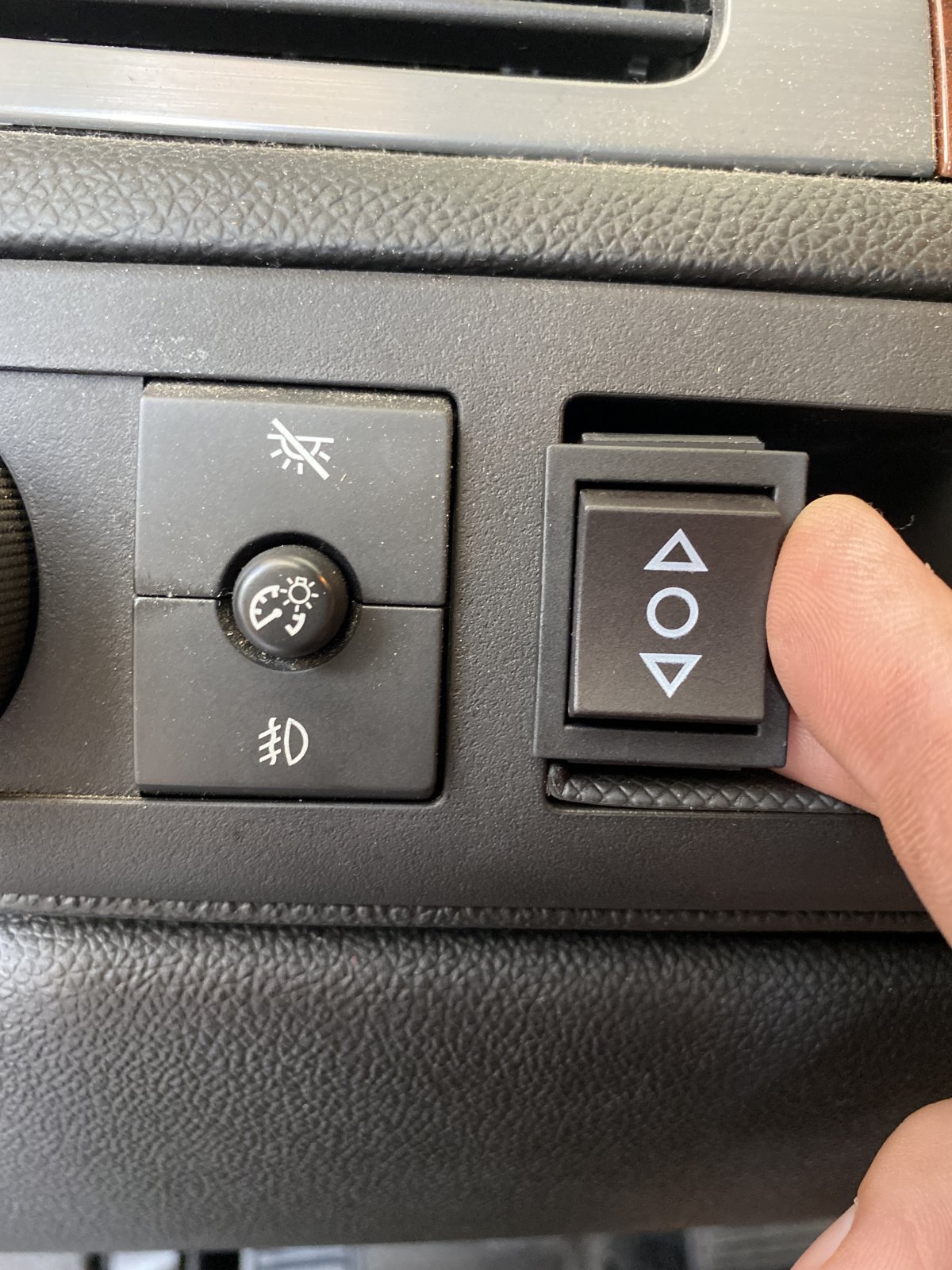

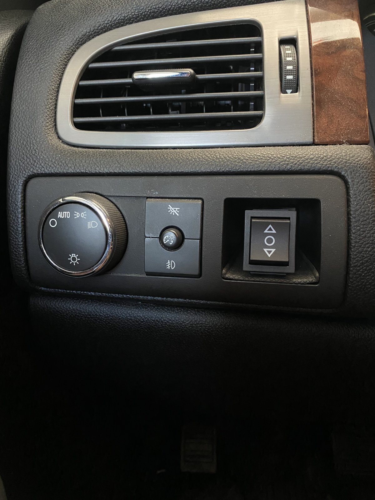

This is the switch I plan to use for my exhaust volume control. I'm pleasantly surprised by how well it'll blend in with the rest of the dash. The color of the plastic is a near-perfect match and the bevel on the surround is more squared instead of the usual bulbous rounded edge:
I'll make up a filler panel to mock the headlight switch panel, but I'll see if starting off with a 4WD switch panel would be easier. I think if the arrows were a bit thinner/less bold, it'd look like a factory switch. Unfortunately, it's not lighted. I'll have it centered like so:

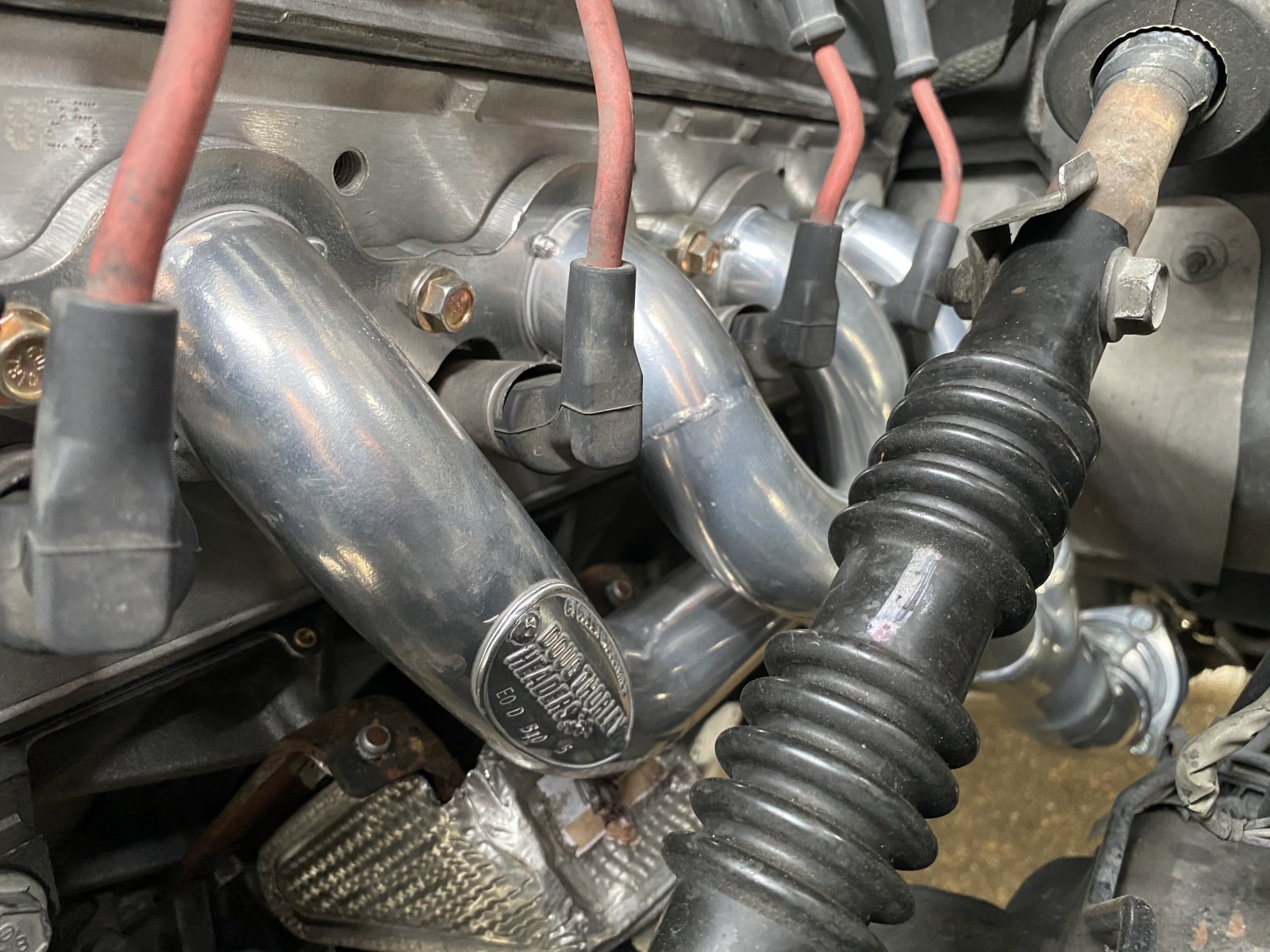

Just because I like the clean metal bits:

I have an 08 ** as well. How do you like those headers so far?
No complaints! I can't speak for any specific power gains since I did a cam and other mods during the time I installed them. After seeing the factory LT4 (wet sump) manifolds, I'd have to say there is proof to the tri-y design. I can say that they're not as "noisy" as most other headers I've heard. They're fairly thick gauge steel (14g, I believe) and ceramic coated. Supposed to have three coats on the inside and four or five on the outside. Longtubes tend to "ping" at the collectors, and thinner gauge and/or uncoated steel makes this louder. These don't have that pinging, maybe the tri-Y design helps to reduce this as well. The build quality is great and they bolted right up with no fitment problems. Flanges are thick and flat. The Y-pipe doesn't appear to be ceramic coated and fitting it required some modification, as I outlined here. Other than that, just know that cats are effective mufflers and without them, you'll hear it!

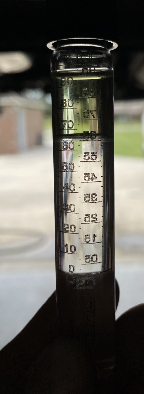

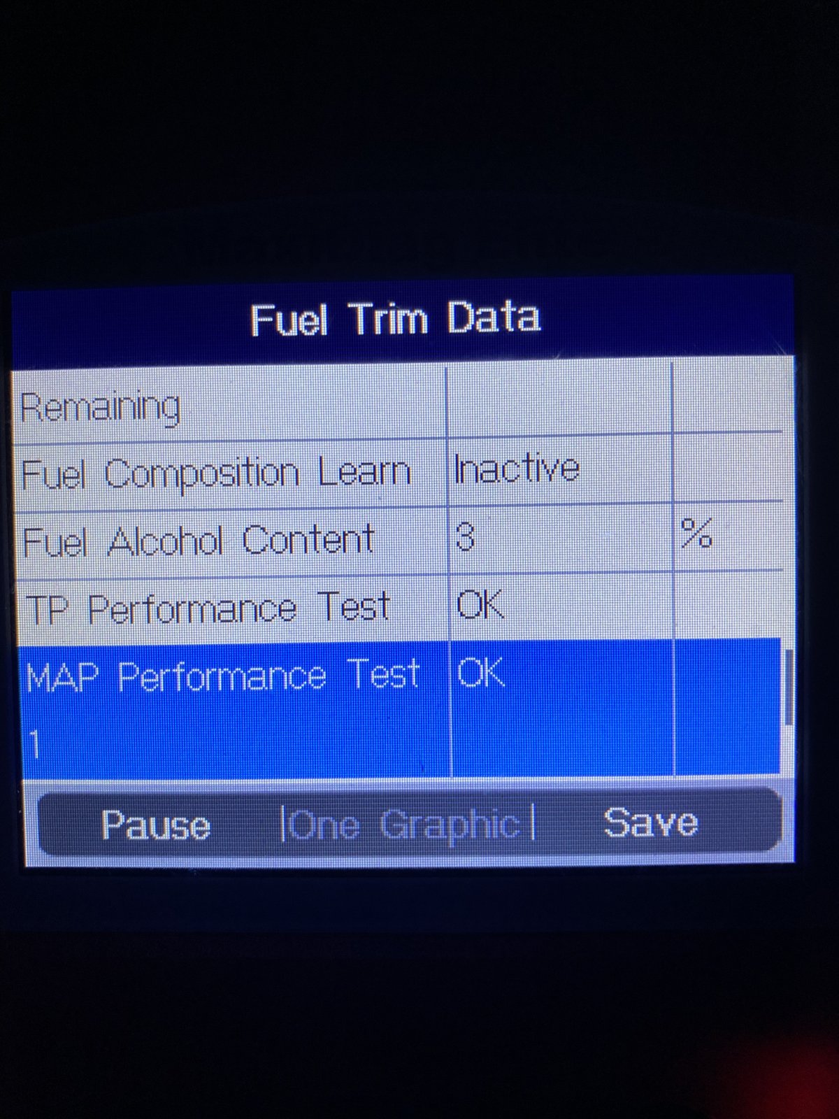

Yesterday, I removed the core from the port on the fuel rail, slipped a piece of 3/8" (or smaller?) fuel hose over it and turned the key on for about half a second to collect a test sample to see what my alcohol content was. My scan tool showed it to be 22-23%, but the tester shows it to be at least 85% but looks a little higher. So, I don't know what is making the Tahoe calculate it so low. I filled up with 93 at Texaco (pretty sure it's E10, but may be E0). After about 15 or so miles, I'm showing a calculated alcohol content of 3%. I don't know...

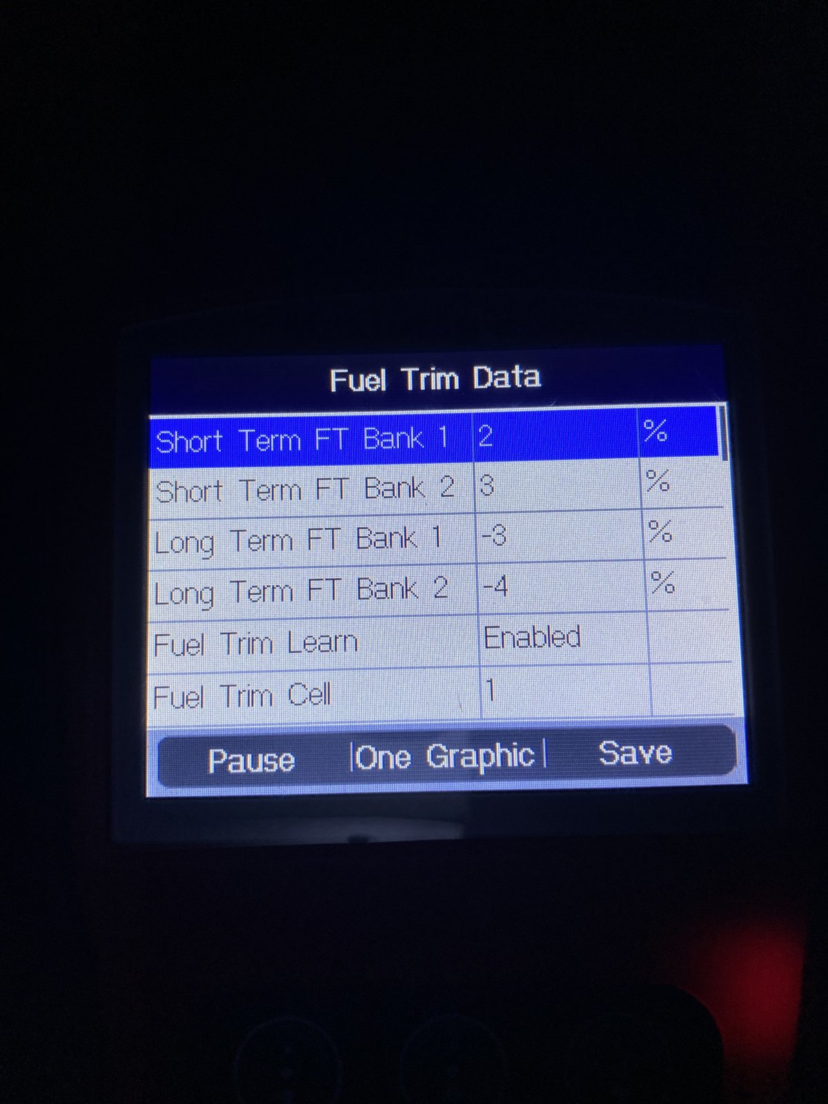

Also, my Long Term Fuel Trims are now about where they should be. Before, they were reading something like +14 and +9 (Banks 1 and 2 respectively) or maybe it was 9 and 14. Anyway, they're now around -3 and -4 and upwards of 0.

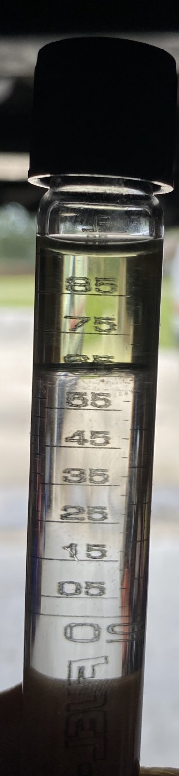

Correction: I didn't let the test fuel sit long enough. It settled out to show it was 65% alcohol:
A little more than what I was expecting, but also far more than what my Tahoe calculated it to be. To me, it seems like a waste to run it if it's only gonna adjust for 22% alcohol even though it's actually almost three times that.
What scanner showed after filling up with Texaco 93 (either E10 or E0- I'll try to remember to confirm next time I pass there):
...And the fuel trims:

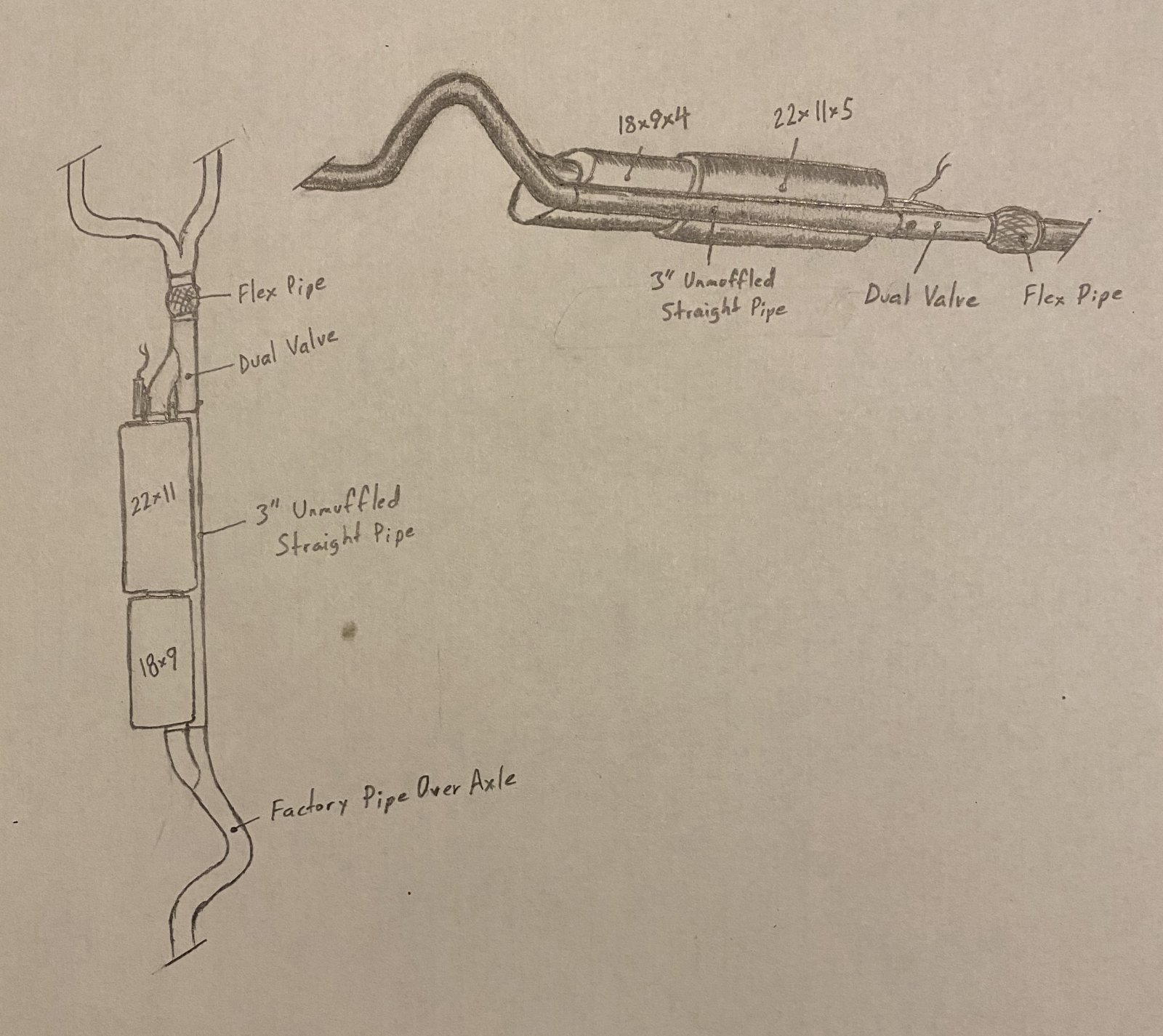

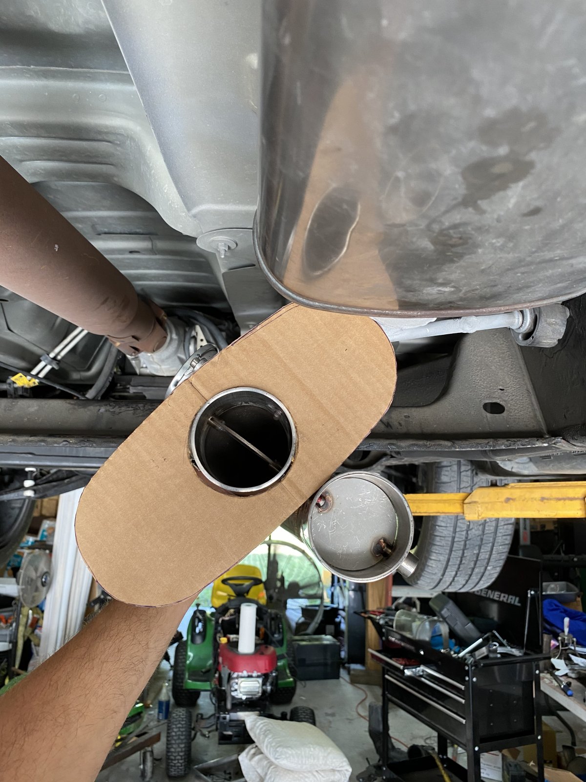

Spent about 4 hours under it this afternoon trying to figure out how I'm gonna do my crazy ass exhaust. Well, about 2 hours of that time was working on the valve. I unbolted the motor drive from it and found that one of the butterflies was really dragging near and at the fully closed position. Used my Dremel to clearance the metal and got it operating about 99% freely. The motor drive must be a torque monster cuz it moved through that interference with ease. I know it'll be fine after some exhaust buildup. I'll just have to remember to cycle it a few times to keep it clean. That shouldn't be a problem, though. :D

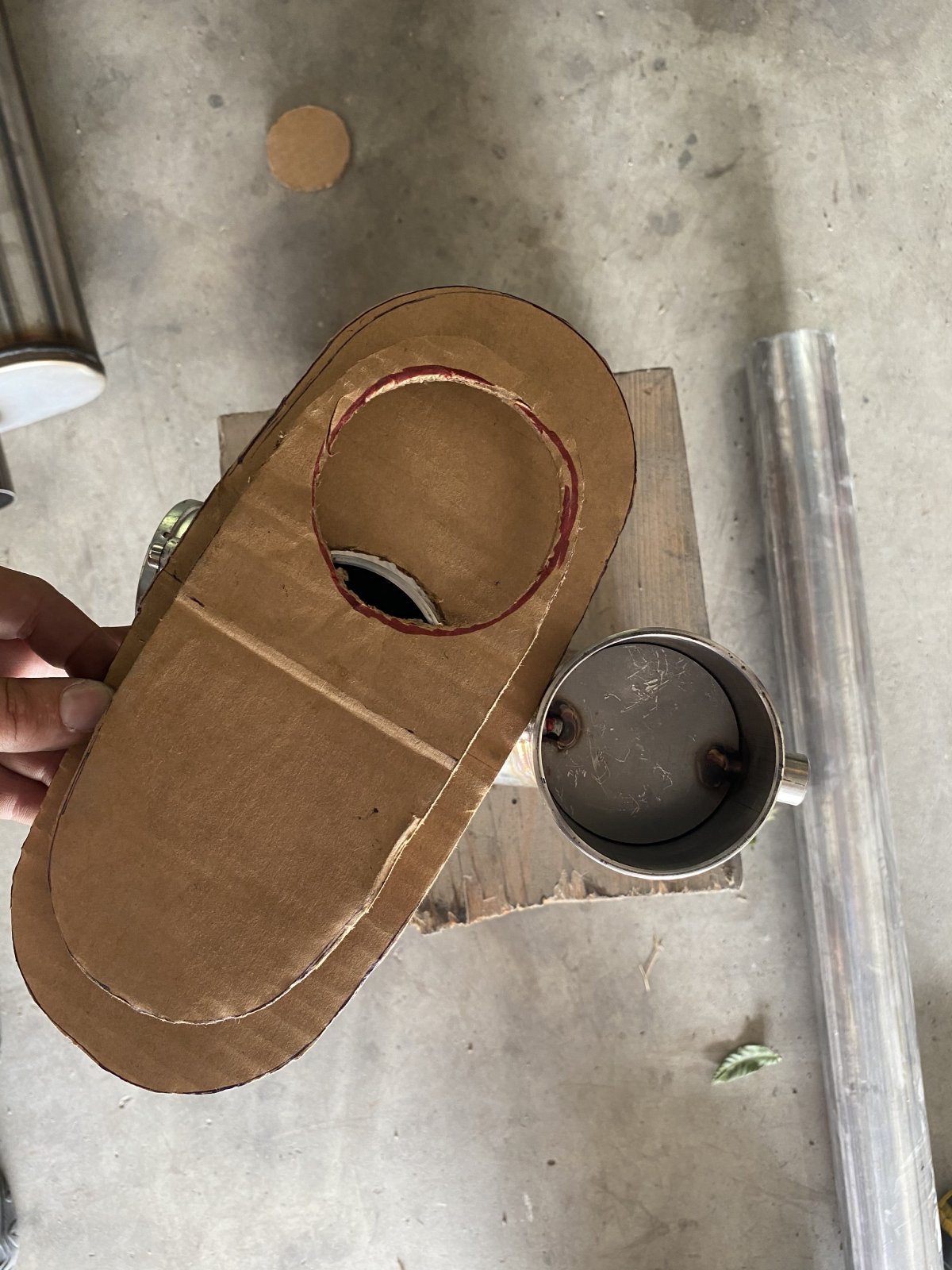

I made cardboard templates of each of the mufflers to figure out placement and orientation. The smaller one I'm currently running is a centered/offset configuration, the long one I'll be adding is centered/centered. I was trying to determine which one should go first and how it and the valve will be clocked. It looks like it's gonna come down to me modifying the cross member for the extra space. That cross member isn't really structural, but I'll still reinforce it after modifying it.

So far, I'm thinking this is a winner. Put the bigger one first and angle it and the valve as pictured so that I can tuck it up as high as possible with nothing extending below the frame rails with about 1/2" to spare. The second muffler will be clocked the same. The 3" straight pipe will run parallel. It will be on the ground/far side of the system so the mufflers will act as a sound barrier between it and the floor of the cabin. They will merge together right at the arch that goes over the axle.
I also tested out the DPDT rocker switch on the valve. I'll do all the wiring at the switch so I'll only have to run two wires to the switch (12V+ and ground) and then two wires (+ and -) from the switch down to the valve to have bi-directional control.
