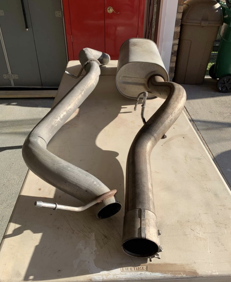

Oh, as for my exhaust plans- I originally wanted the cutout/unmuffled circuit to merge back into the pipe after the muffled circuit and continue over the axle and out the back. Materials and space constraints prevented this, so I just dumped it in front of the axle. Since I now know that the cutout is contributing to the noise, and it's exiting under the cabin, I'm gonna work on getting it tied in and out the back as originally planned, in hopes that this makes it quiet enough inside the cabin. I want the cutout pipe to be as free-flowing as possible, so it can't be necking down into a smaller pipe. Since my Tahoe is lowered, I can't afford to have the over-axle arch any larger than the factory 2.75". Really, I'd like to get a shorter, but wider (oval) pipe for even more clearance. I could simply get a 3" U-bend and hammer the bottom and/or top side(s) to make it 2.75" or less. But, such a pipe is about $30 on Amazon.
I was passing through New Orleans yesterday for work, so I checked FB Marketplace (I use Jenn's account) for take-off exhaust pipes. It didn't take long at all for me to find an ad for a factory '06 LLY exhaust, complete with muffler. It included the factory air intake and filter assembly, all for $50 or best offer. I met up with the guy and, since I had no use for the intake, he offered the exhaust to me for $30. Score! So, now I have plenty of nice quality 3.5" tubing with more bends than I'll ever need. I was even considering using the muffler since I thought mine weren't sufficient, but now I'll try to sell, trade or give it away. Since the pipe is 3.5", I can beat it down to ~2.5" or so high and it'll still flow as well as a 3" pipe.
Pic from seller's ad. I even got the 3.5" band clamp:
