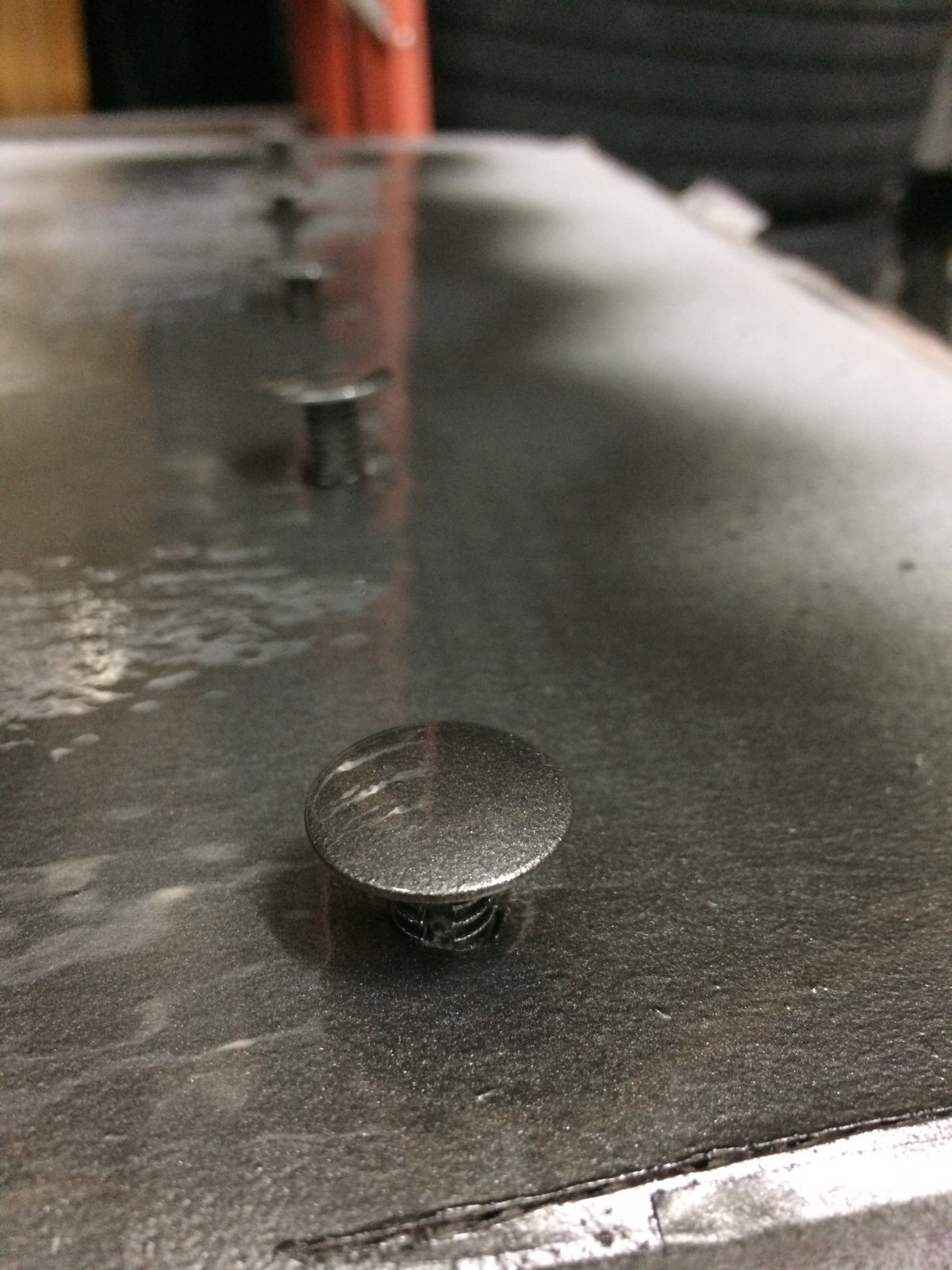

Those should blend it very nicely. Are you happy with the fit of the tree rivets?
Didn't bother to test them. It's either grind, weld and paint the roof (not happening) or cover the holes with a strip of body-colored molding (pricey and wasn't gonna paint that much) or cover each one individually with these things. So, regardless of the [initial] fit, these are gonna happen!
I did remove and measure a screw a while back and ordered these accordingly. They should snap in very firmly. I'll apply a thin layer of urethane sealant to the underside of the head since the threaded insert that these would bottom out on is raised above the roof's surface a millimeter or two. The sealant will make up that difference as well as seal and adhere the cap to the roof.
45,011
Four coats of base and four of clear. You know it's good when you can see the reflection of the ladder in the finish:
Gonna let these sit for the night and maybe put them out in the sun tomorrow. If I don't work too late and have free time tomorrow afternoon, I'll take the rack off and clean, buff and wax where the mounts were and aim to get these plugs installed on Sunday.

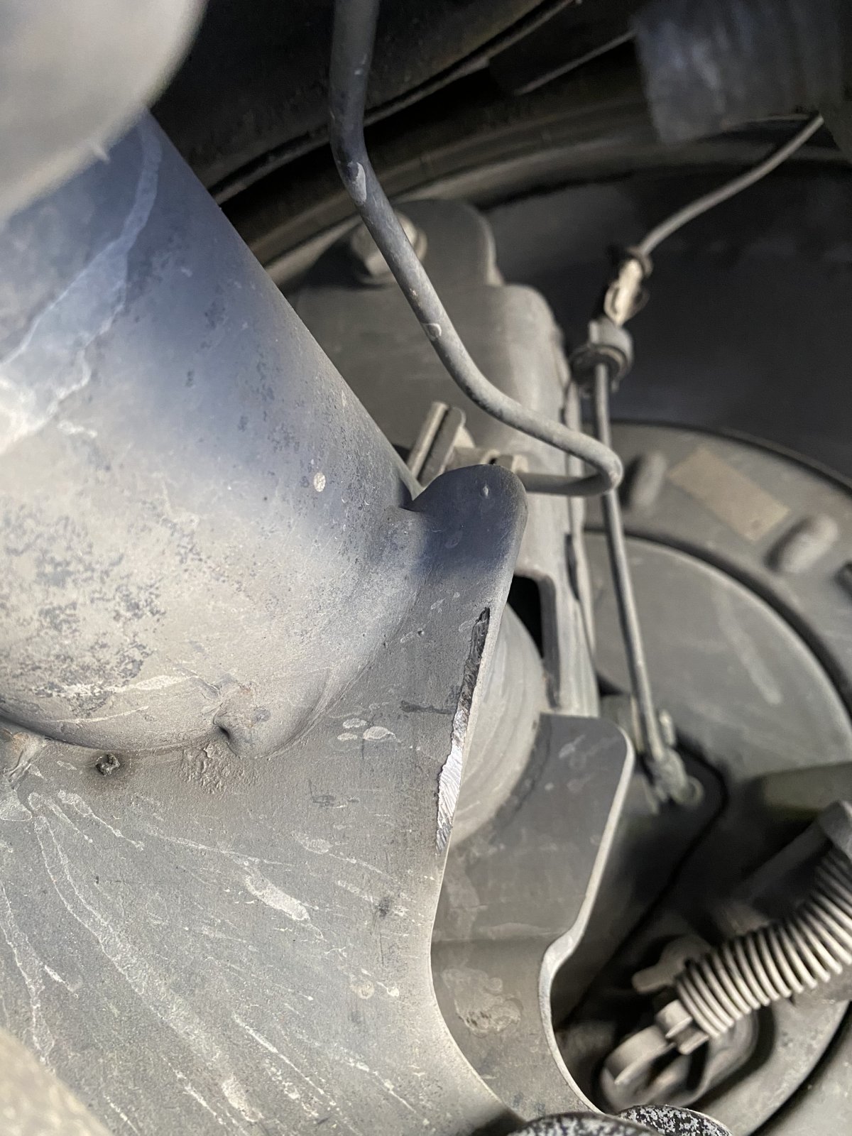

Did a little work yesterday. Back when I hauled that 300 lbs. of sand for a portable basketball goal, I heard a few bumps and scrapes in the back. I finally had a chance to put it on the lift and inspect yesterday...
This ear on the axle side panhard mount tapped the cross member:
So I trimmed it down to just below the top edge of the bushing. It's only about 10mm of clearance, but it's a little something. Pretty sure I'll end up notching and boxing that cross member later. I didn't catch it at first, but the grease fitting is now exposed. I filed the cut part smooth and painted it and the line in the cross member so I'll know if it ever contacts again:

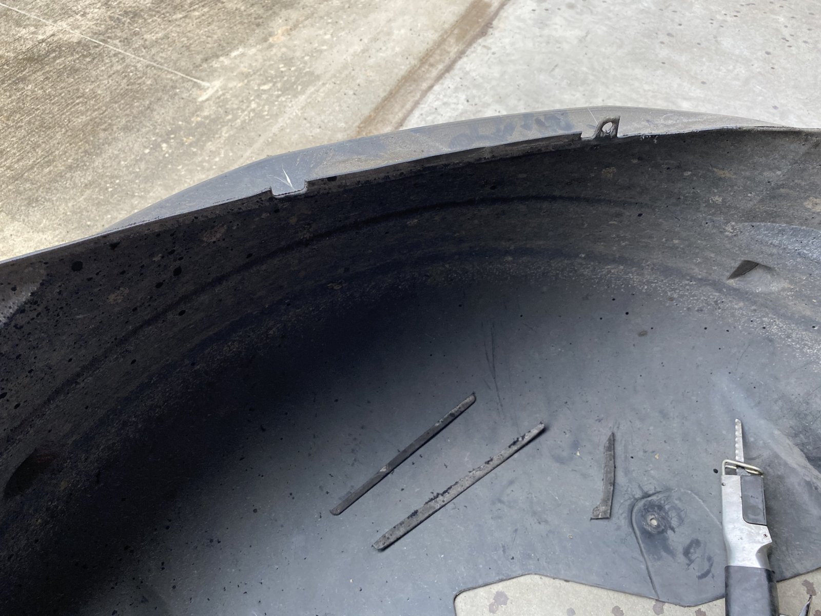

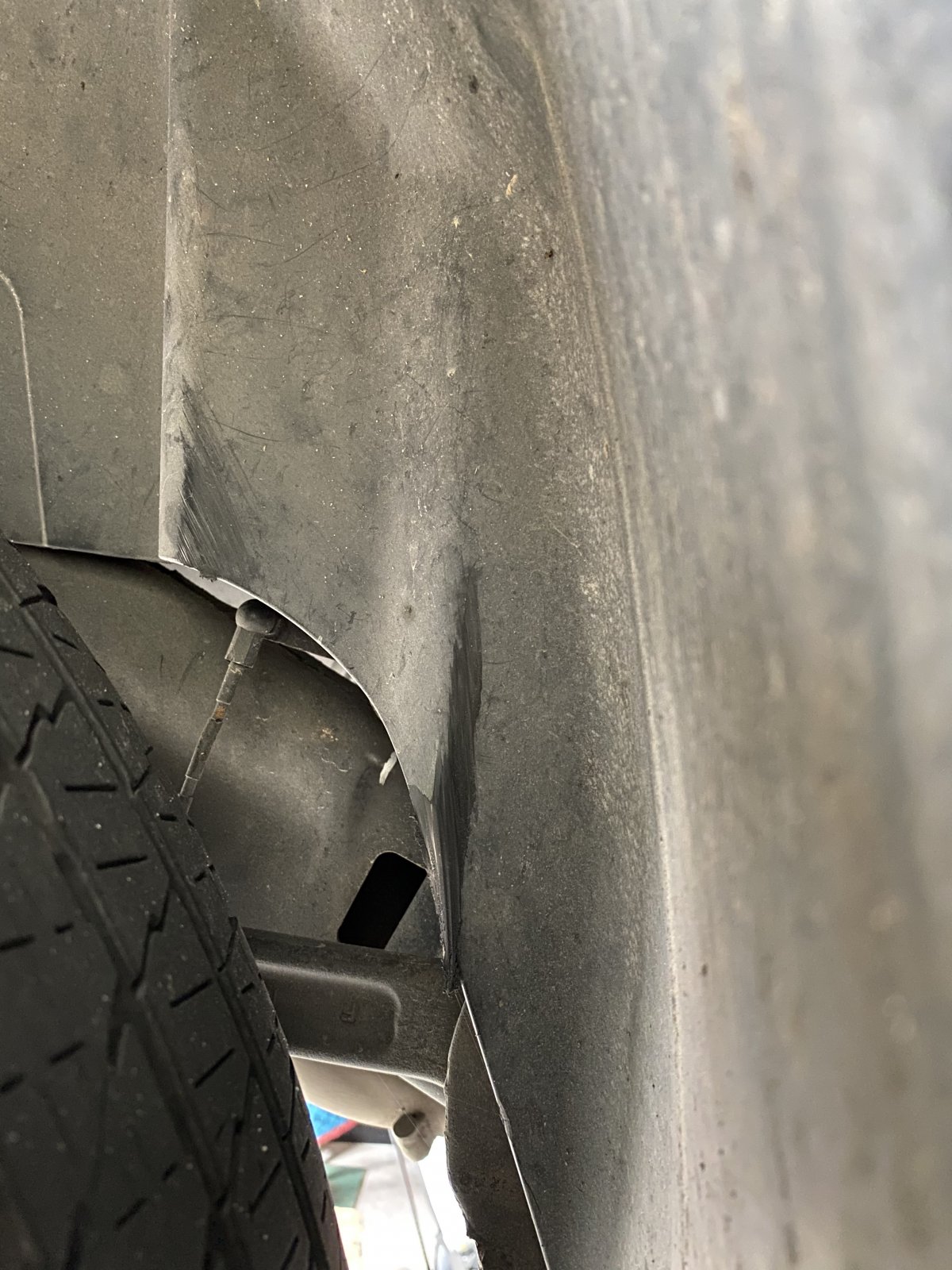

The tire rubbed the fender liner and lip. The plastic is ground down a little and the metal part just forward of it is what lightly sliced the tire tread:
I removed the liner and rolled the fender lip:
And trimmed down the lip of the liner. I trimmed a little more than what's in this pic. I also softened that wall with the heat gun and flexed it outward to tuck in tight to the metal fender lip. This was between one of the test-fits:

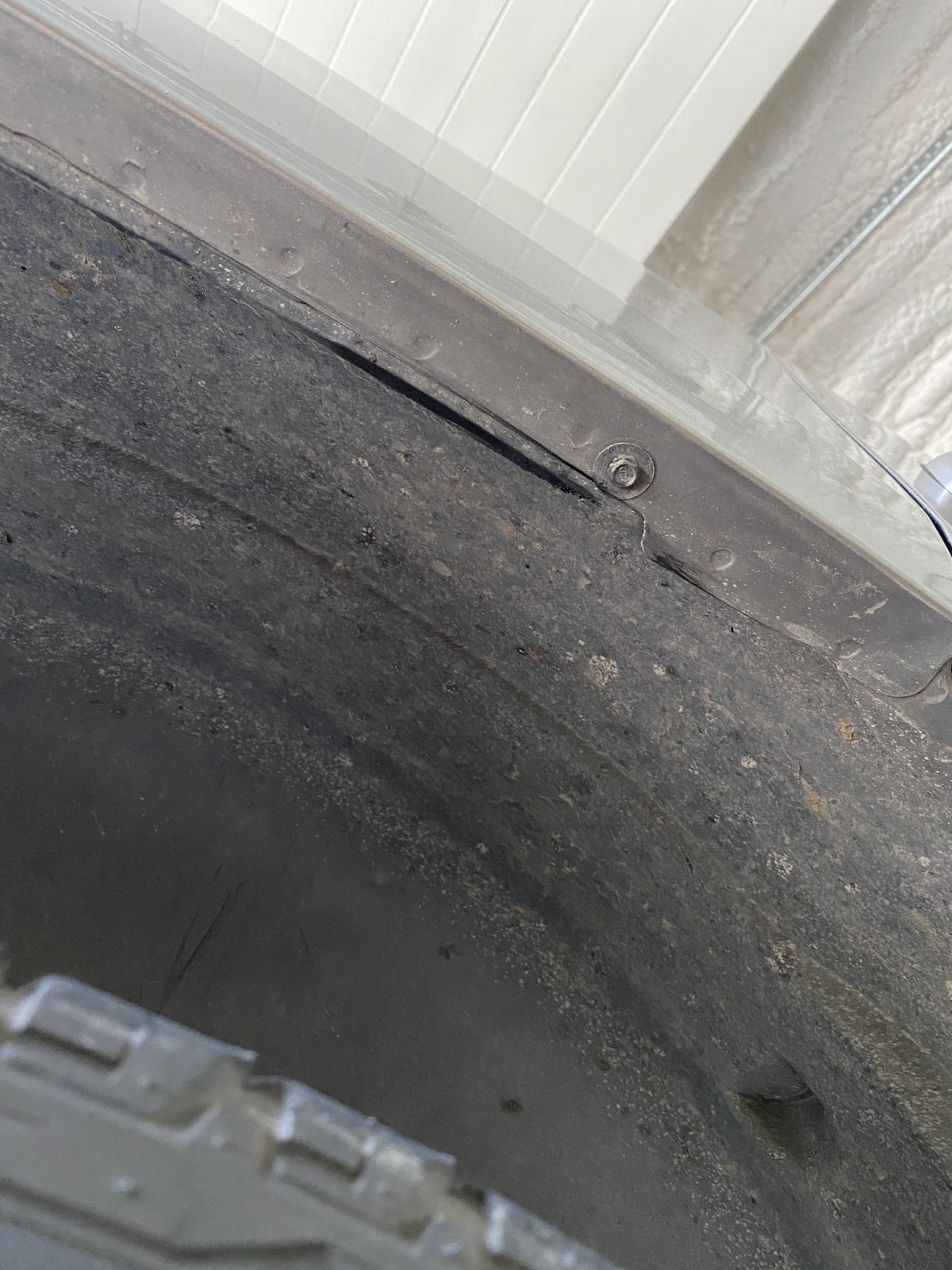

...Aaaand done. Went from a 1.5" wide lip with an angled edge to a 1" wide lip with a rolled edge. I also ended up removing that screw since it wasn't needed and only added a sharp metal edge. Doesn't sound like much gain in clearance, but it was barely touching and I gained 1/2" of clearance. That's pretty significant in this area:
It was also rubbing inside, so I used the heat gun again to soften and reshape it for a lot more clearance:

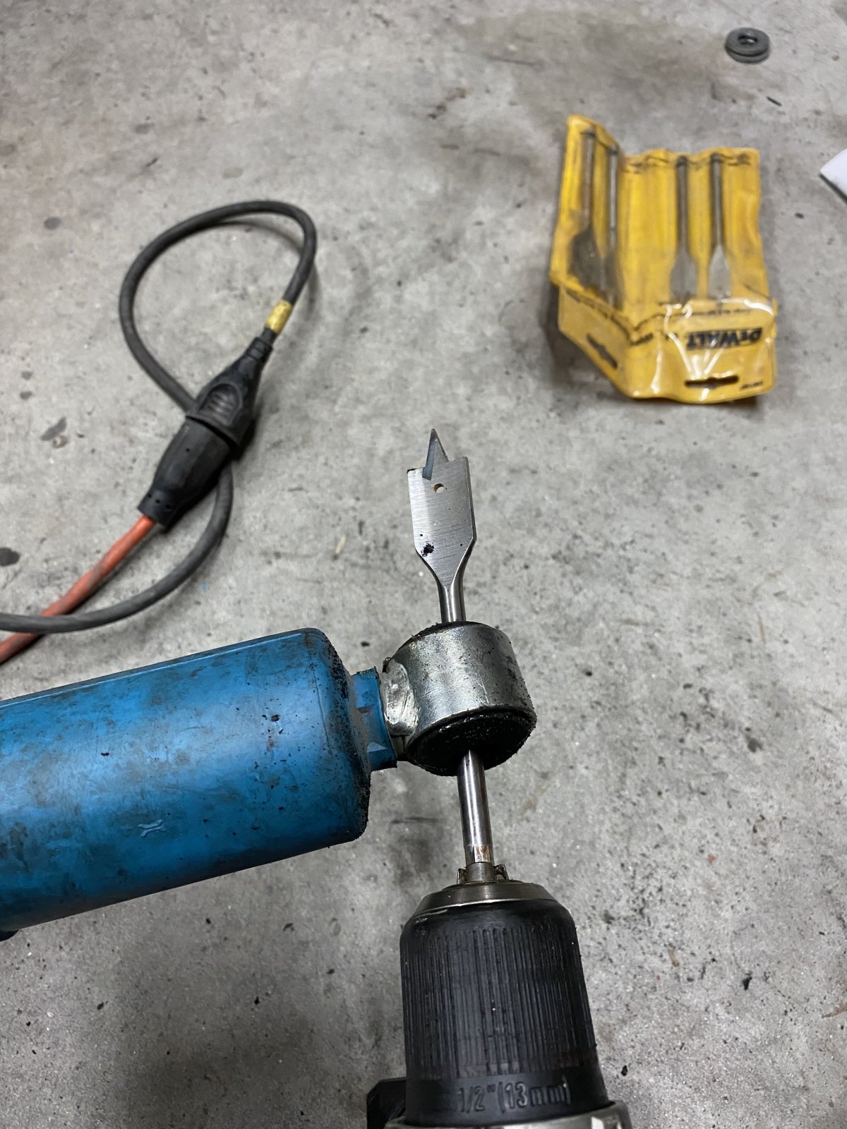

As much as all of this sucked, I did figure out a cool way to bore out a rubber bushing's ID cleanly and while maintaining it's center. Use a paddle bit of the desired size and slide the stem through the bushing, then chuck it up in the drill. The tapered backside of the bit keeps it centered and it'll gradually and cleanly open up the hole. A regular bit would've dug into the bushing and chewed it up and likely wouldn't drill straight:

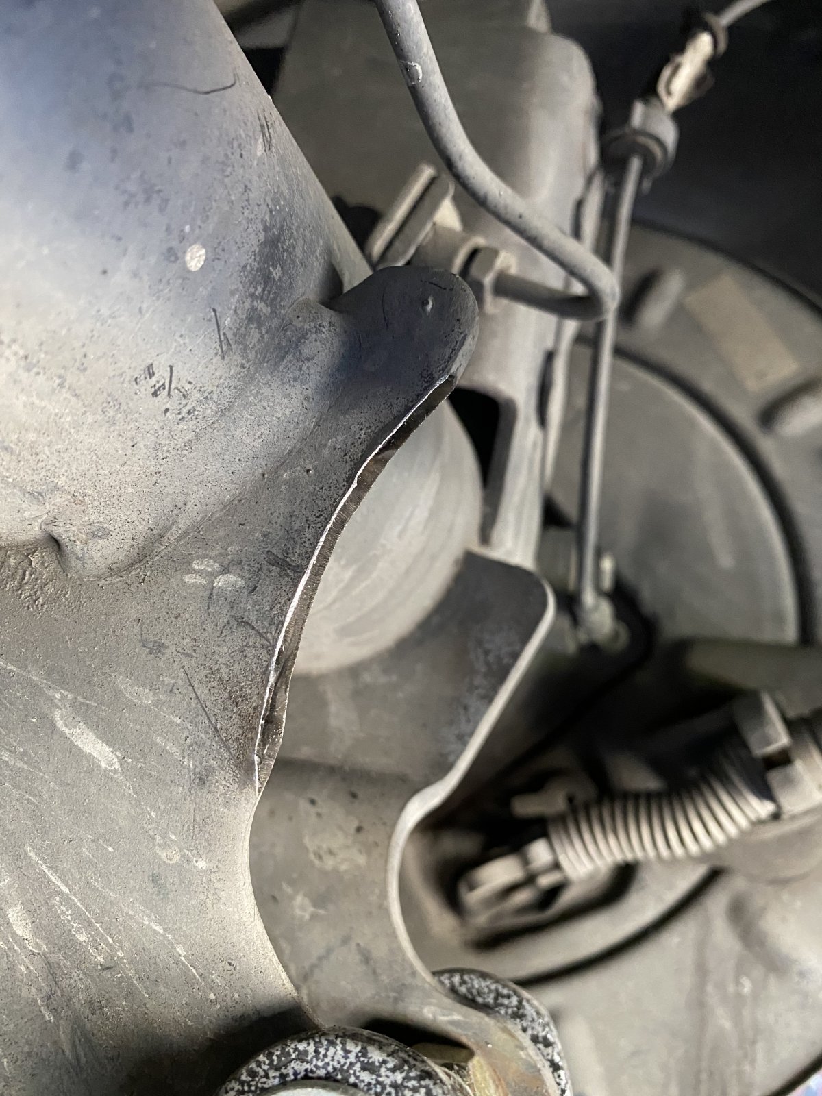

After boring out the rubber bushings, I was able to press in the factory sleeves and bolt in the shocks. While I was under there, I saw where my sway bar had been rubbing the shock mount due to me not having the axle centered, so I clearanced it a little and adjusted the panhard.
Before:
After:
Yes, I smoothed and painted it after I was done. I also flipped the axle side half of the panhard to put the grease fitting facing downward. Cutting that ear off for more clearance a week or two ago exposed the fitting as the new high point, which means it'd get snapped off should that part ever bottom out against the cross member. The mount has a slotted hole in the underside so the fitting is accessible from the bottom. Simple solution there.
