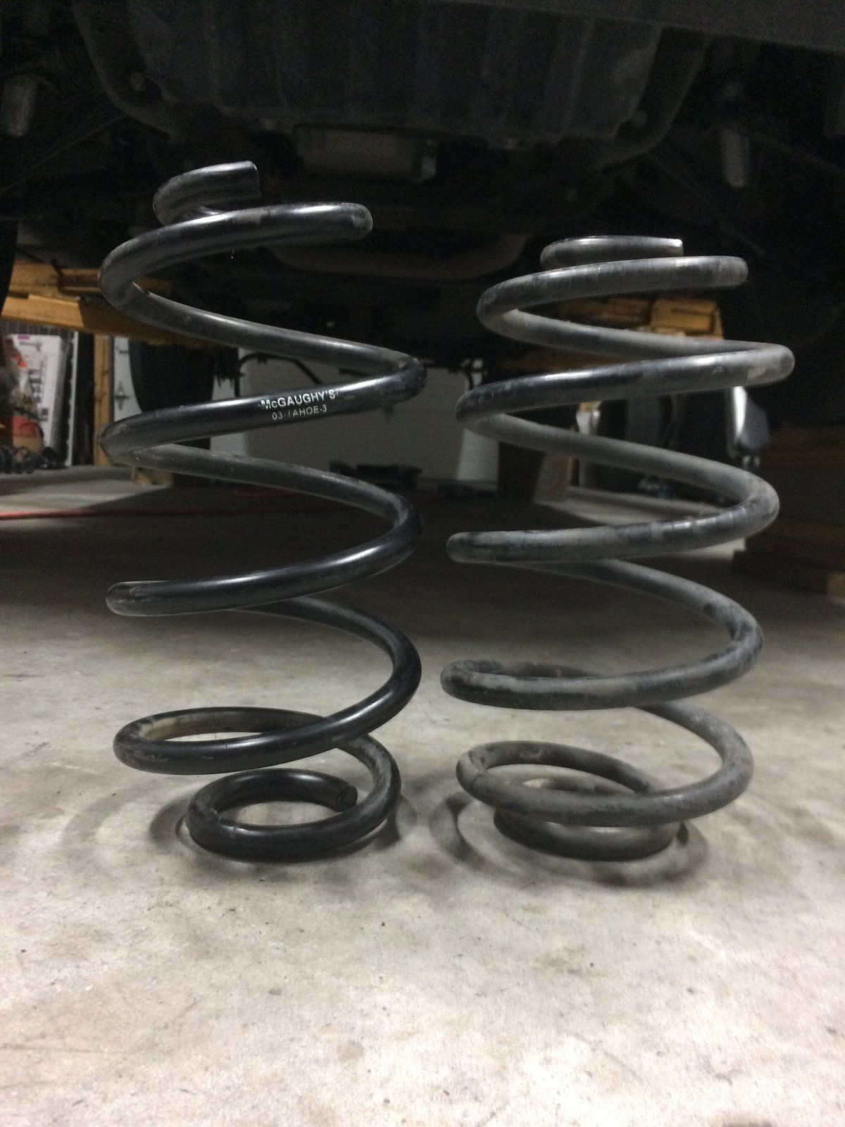

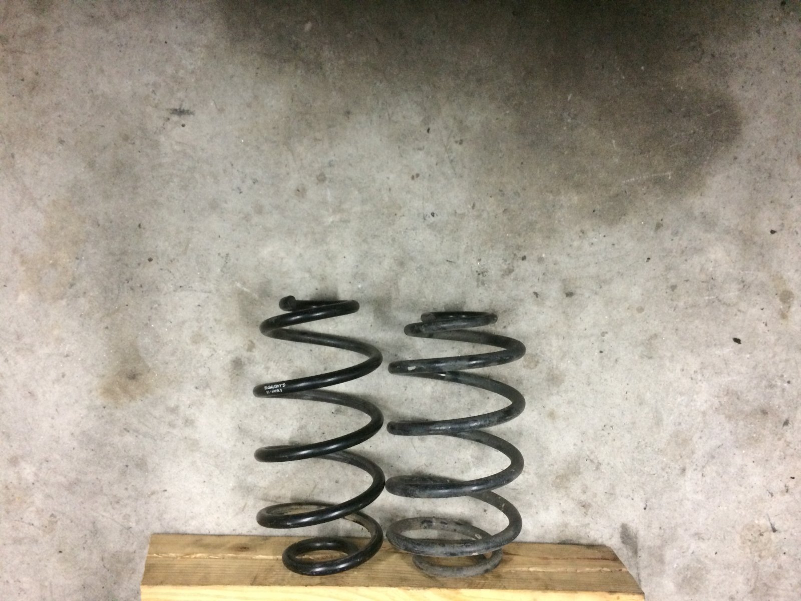

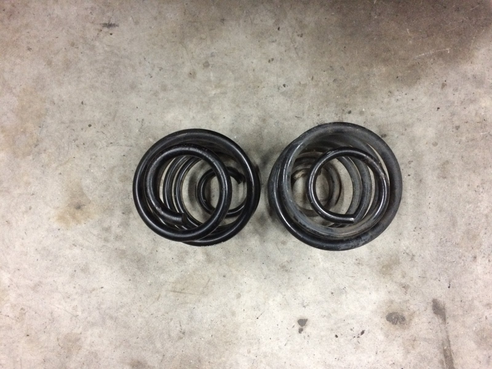

McGaughy 3" coils compared to "mystery" coils:
The McG coils dropped the rear 2.5" and the mystery coils dropped it 3.5". They ride better than stock but aren't too soft. I have a lead on confirming their origination.
First off, I want to say that my front and rear drop figures are averages of the left and right sides, rounding to the nearest 1/8".
Aaaaand I believe I've determined the mystery coils to be the rear ones from a Jeep TJ ('97-'06 Wrangler). So, if you want a good ~4" drop coil for cheap, hit up someone with a lifted Jeep or maybe a 4x4 or Jeep shop for some stock coils.

I thought the same. After searching around, I saw a few brands of 4" and 5" drop coils and they all look VERY similar to the TJ coils. TOO soft? Surprisingly, no. At least, not with an unloaded Tahoe with the 3rd row removed.
Maybe the TJ rides really stiff? Also, I'm comparing these coils to how my stock ones rode. Mine having AutoRide and ALC means my factory coils were the softer version. It really does feel very much like it did when stock with it's disabled ALC and stiff electronic shocks. It's a little softer, but that's expected and what I wanted. The Belltech SP shocks are notably softer than the stock ones, so even those are a factor.
I'm counting on these to be too soft for any sort of load, including just the 3rd row installed. My stock setup felt way more squirrely with those seats in. If the ALC system was operable and adjusted properly, this could easily be remedied and is what I plan to do if those AirLift bags work out.

Yeah, he uses that terminology as a marketing tactic- to reinforce that if that's the style/amount of drop you want, it is available exclusively from him. So, it actually IS "his" kit. He's not misleading anyone at all. He's actually saving people the hassle and disappointment of buying a mass-produced drop kit only to achieve less-than-optimal results. Belltech or DJM isn't gonna warranty their Trailblazer drop coils being used in a much heavier vehicle, even if they work perfectly fine. With Tony's arrangement with them, they sell more coils and it's Tony's name that's on them.
I completely understand and agree with what you're saying. Getting more drop by using an overly (dangerously) soft spring is like people running rubber band tires on stock wheels as their method of "drop". What I got out of the TJ coils defies everything I was expecting, which I why I say I'm pleasantly surprised with the results. If it were a 4" drop but felt like a '67 Continental, I surely would NOT be "pleasantly surprised" and I wouldn't have kept them.
They're barely compressed more than the application-specific McG 3" Tahoe coils. With both laid on the ground, side-by-side, the TJ coil is about an inch shorter. I got 2.5" drop from the McG coil and 4" from the TJ coil, so it's only compressed 1/2" more than the McG coil. It's nowhere nearly as overloaded as the 5305 coil would be, which ends up having 2-3 coils bound together. Maybe the TJ coils are a harder metal? The wire diameter is only .3mm thicker than the McG, and that could just be thicker powdercoating.

If there are any engineer types that wanna crunch numbers to try to determine capacity:
Stock coil-
Height: 16.25"
OD: 5.5"
Wire D: .594"
Total coils: 8
Active coils: 5.75
McG coil-
Height: 12.75"
OD: 6.313"
Wire D: .60"
Total coils: 5.75
Active coils: 4
TJ coil-
Height: 11.75"
OD: 6.75"
Wire D: .61
Total coils: 6.5
Active coils: 4.25

I’m a lazy engineer. Here is the answer sheet.
http://www.racingsuspensionproducts.com/spring rate.htm
Cool!
So stock coils are at 263lb/in
McG coils are at 250lb/in
TJ coils are at 202lb/in
Pretty interesting.
Note... if you cut 1 coil off the TJ springs you would essentially be at stock spring rate of the Tahoe.
This is per spring, correct? So I lost 122lbs of capacity? Doesn't feel like that much of a change, or maybe 122lbs isn't so much. The lower C/G and poly sway bar bushings probably compensate for most, if not more than the 61lb softer corner support. No worries, those Airlift bags have that covered, with about 878lbs to spare. ;)
If I got the drop I was supposed to out of the front, cutting that one coil might be an option to get a little more drop and match the stock spring rate. It'd be a 4/5 drop with numerically identical stock ride and capacity.

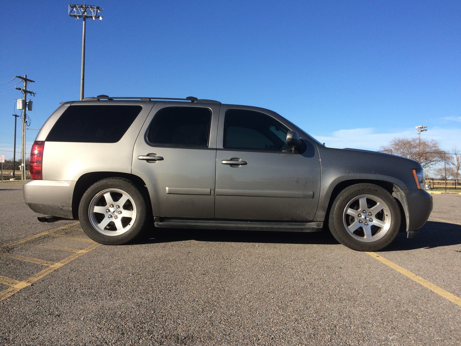

I like this look and drop with maybe a little shorter tire.
Thank you. I'm satisfied with it. I let the whole drop amount discrepancy go. It rubs badly enough as it is so 1/2"-3/4" more drop would just be that much more clearancing needed. Considering the lucky fluke of results from the experimental rear coils, I should be satisfied with the stance.
If I were to do shorter tires, it'd be on the 22s. But they ride stiff enough as it is.

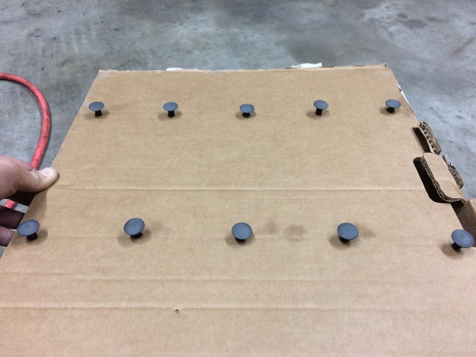

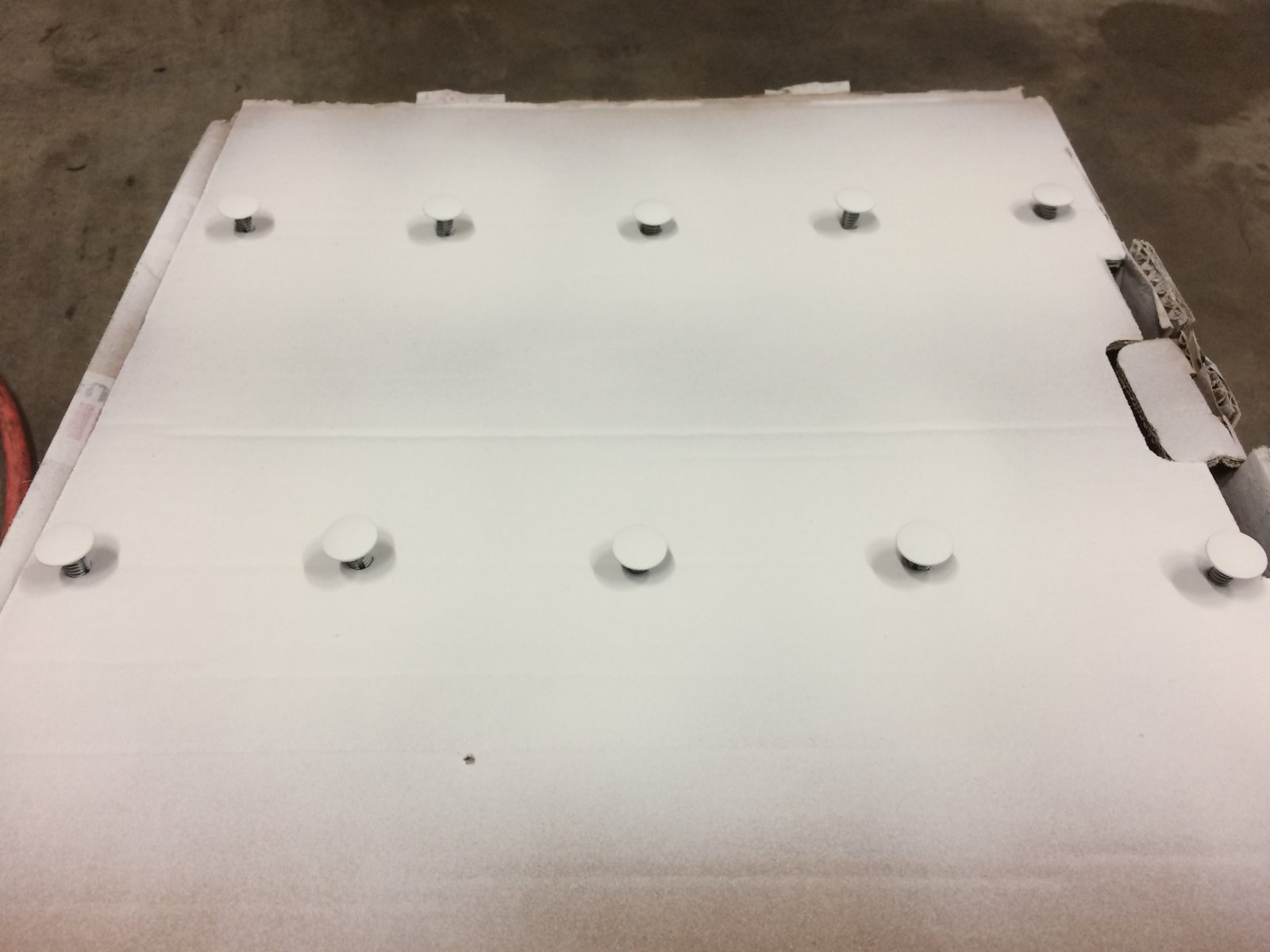

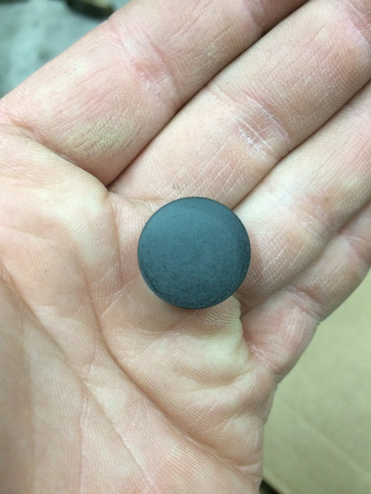

Tahoe's in the garage and work van's in the shop since I had to some work in it today.
Since the temp and humidity was nice and I had some time, I decided to start on the caps I'll use to seal the holes when I remove the roof rack.
Sanded off the mold flash and texture.
Before:
After:
Wiped each cap down with Prep-All and pressed it into a hole in a box top:
After 3 light-medium coats of primer, aiming down and in front of them so the underside of the caps gets coverage:
This is probably as far as I'll get today. I want the primer fully cured before I sand them with 2000 grit.

Those should blend it very nicely. Are you happy with the fit of the tree rivets?
