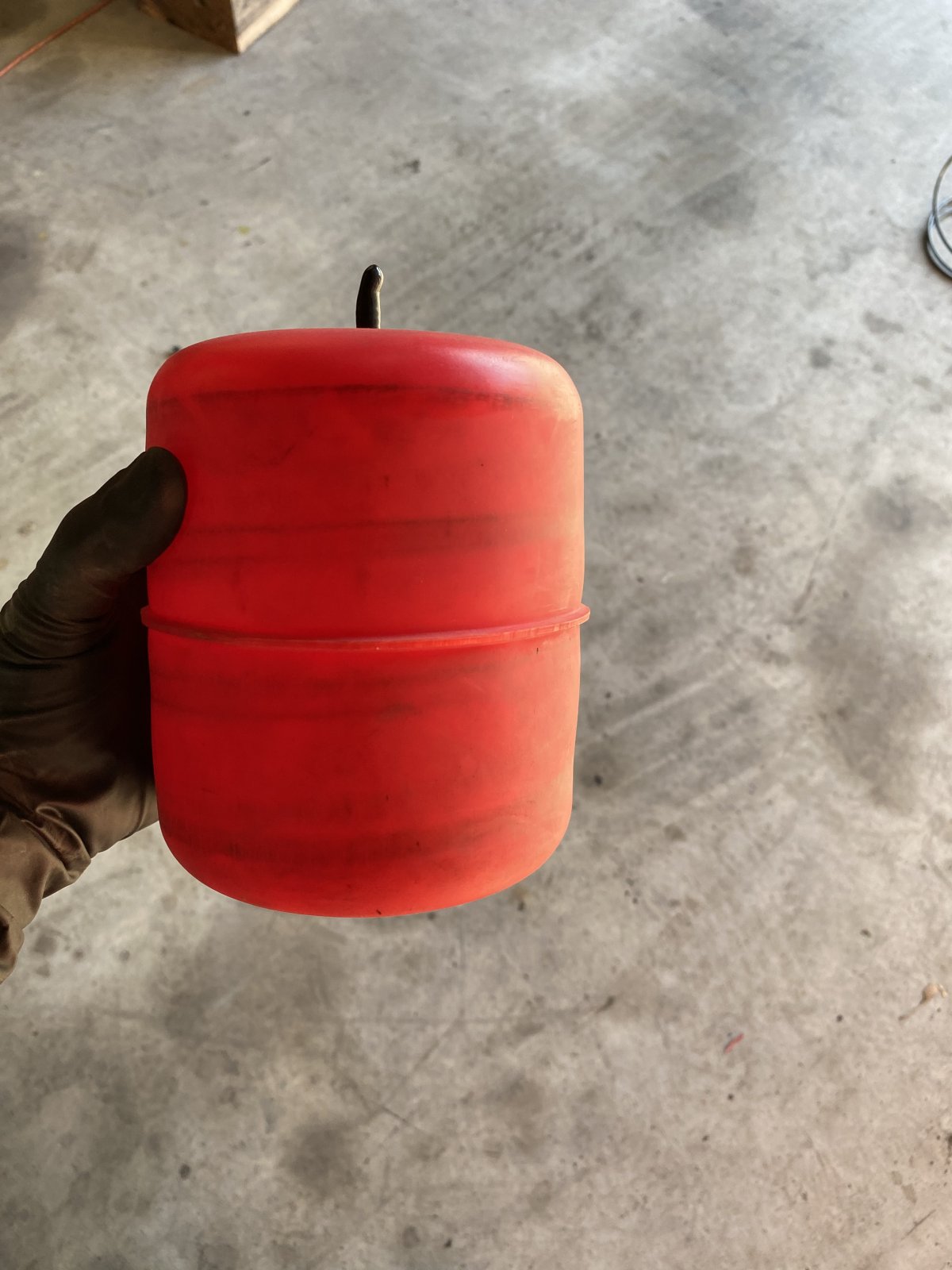

So far, it seems to be operating how I've read how the stock system operates. My stock shock bags were blown and compressor roached when I bought my Tahoe so I've never personally experienced how it's supposed to work.
The bags fit firmly in place with no room for up or down movement, so any air pressure added to them won't be "wasted". This is ideal since they operate at a fraction of the pressure that the stock sleeves did and they don't "grow" as much. They need to be able to lift the rear to it's normal height with as little input from the compressor as possible, so any wasted travel is an issue. These fitting so well inside the TJ coils is yet another star aligning.

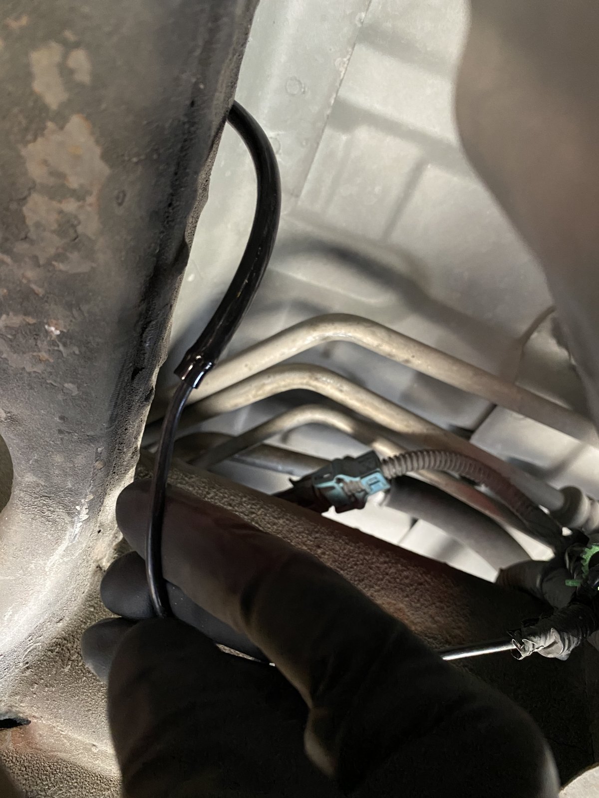

I unclipped the connector from the end of the stock air line and slid it back a few inches which left me with a bulb flared end. I pushed it into the Air Lift air line and it seems to be holding fine. I planned on backfilling the hose with epoxy to make the connection permanent and to ensure a seal, but that may not be necessary, at least not while I'm testing. I shoved it in further after this pic.
I need the system to think that the current, lowered height is the appropriate ride height. Otherwise, it'd think I had so much weight that it was sagging 4" and it'd try to air it up that 4". The Air Lift bags would explode long before it ever reached that height. To accomplish this, I shortened the sensor links to align the marks I made when it was at stock height. I removed the links, positioned the sensor arm to align the marks, then measured for the link length. I made the links out of a 6" piece of stainless 10-24 all thread rod. Just pulled the ends off the original link bars and threaded the stainless rod into them.

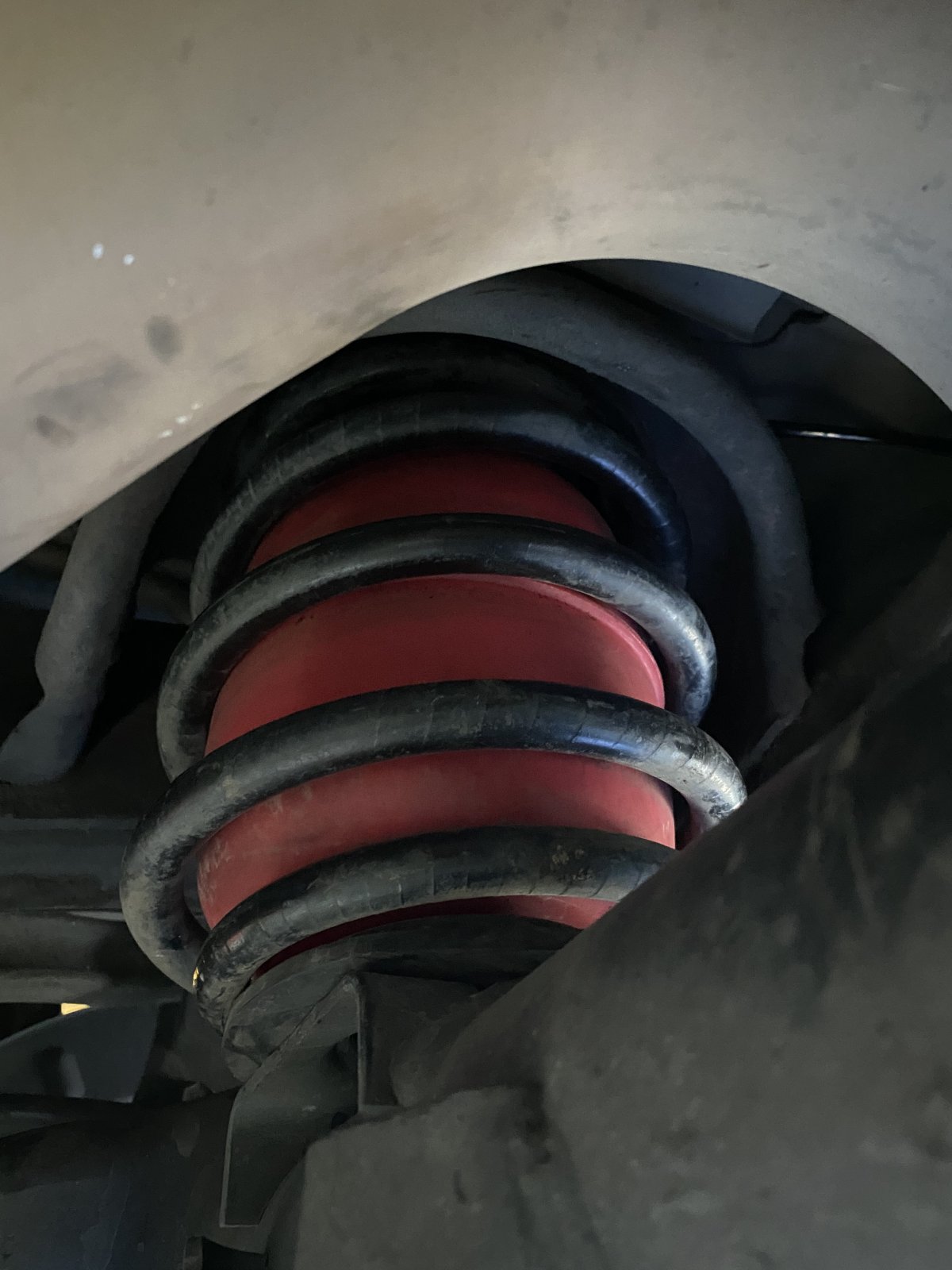

I plugged in the fuse for the ALC compressor and turned the key on. After about 5-10 seconds, the exhaust valve clicked (system test) then the compressor came on for about 5 seconds. The bags firmed up a little and the rear lifted about 1/2". As far as I know, this is how the stock system works. I may shorten the links a hair cuz I really like the full 4" drop.
Bag snugly in place inside the TJ coil:
On the test drive, I might have detected a slight bit firmer ride. It was too minimal to know for sure. So far, I'm guessing I could call this is a "win". I need to test it loaded, so I'll use my crawfish pot idea to squat the rear about an inch, turn the key on to see if it lifts back to the same point, add more water to drop it another inch, etc.

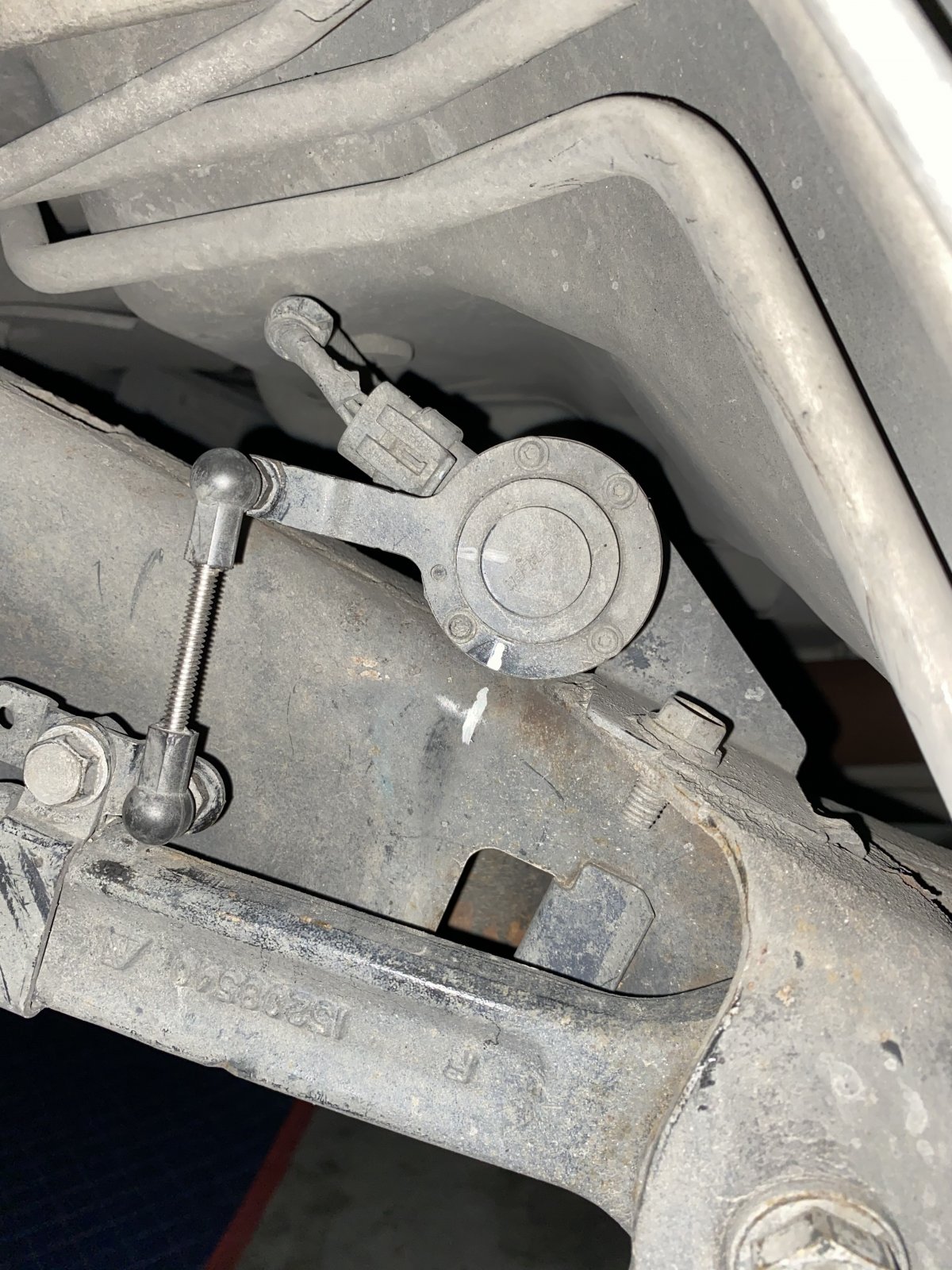

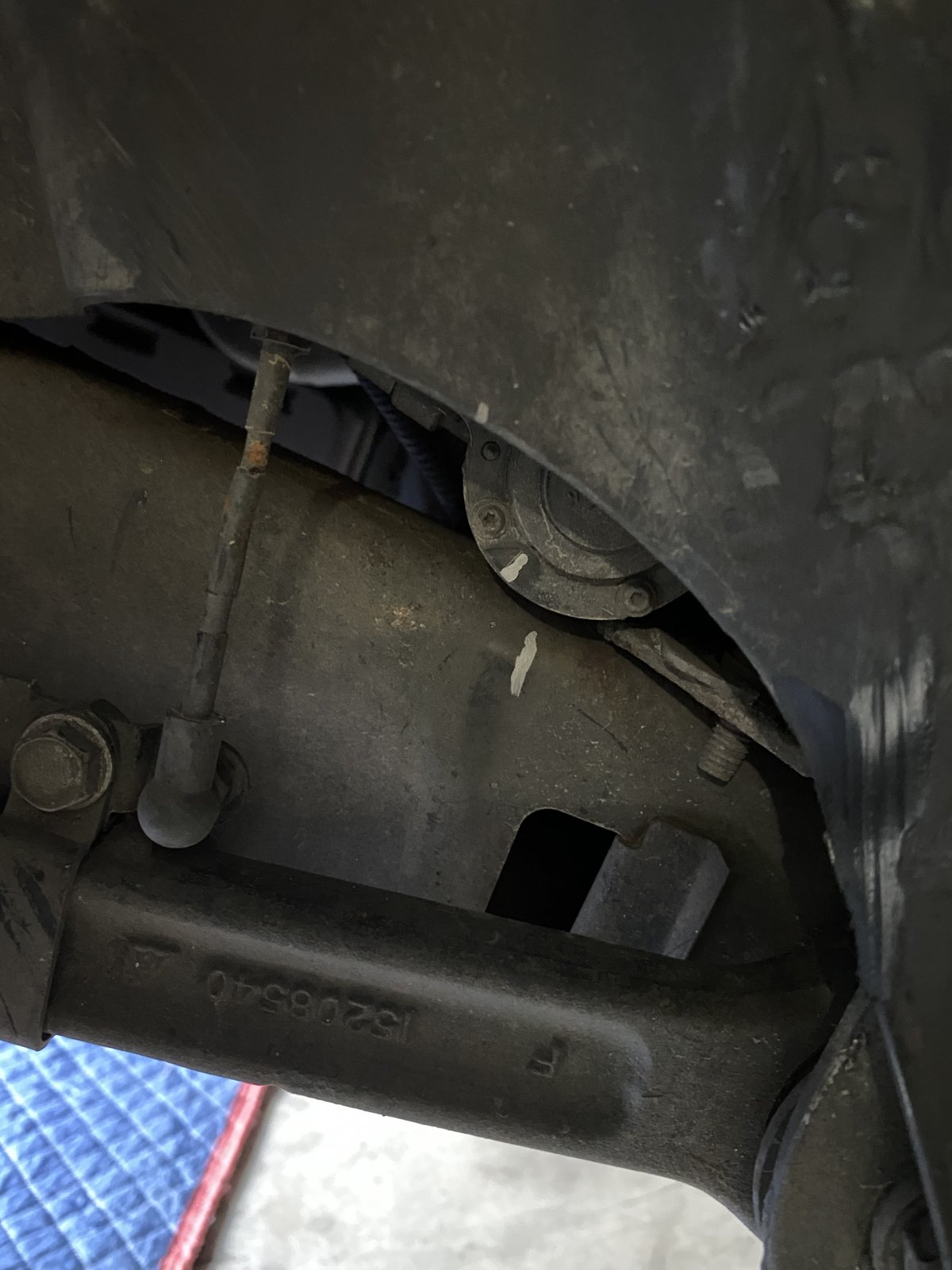

I just got back from getting dinner. I measured from ground to fender and it was 1/8" lower than where it was when I parked it Sunday night. I started it and put my tape measure to it. The compressor kicked on and it rose ~1/16". On the drive to the pizza place, it felt like it did when I drove it last. When I got back in it at the pizza place and started it, the compressor came on for about five seconds and I even felt the vibes in the seat. The ride home was a little more firm, not uncomfortable by any means. It felt more balanced with how the front rides. I did the hard slalom motions with the steering wheel and it was noticeably more controlled- less wag and quicker, almost immediate recovery and settling. When I got home and parked, I measured it again and found it was now 1/2" higher than when I started. Where I parked at the pizza place, it was an incline with a shallow dip running widthwise, like the Tahoe was parked over a ditch with the front wheels on one side and the rear over the other. I'm wondering if this loaded/squatted the rear a little more and the compressor put more air into it to pick it up. The extra air would've firmed up the ride which would make it feel more like the front as well as make it more stable against swaying. I liked the feel and handling, just not the lifted height.
So now I have to (1) Find out how much pressure it put in the bags to accomplish this firmness. (2) Lower it an additional 1" - 1.25". (3) Mark the sensors and adjust the links so that it airs up to this same sensor position.
This would give me my 4" net drop AND the desired spring rate (the slightly firmer one I had on the ride home) with the bags inflated to what the ALC system detects as "normal". Everything hinges on the amount of pressure being used...
