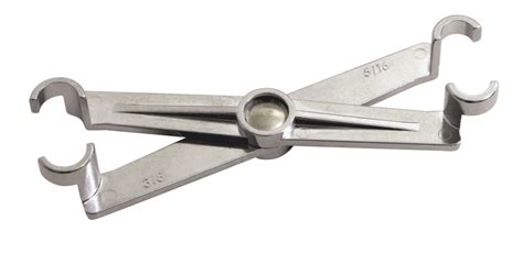

Lisle 39420 (Blue) works for me. That metal split one doesn't work as well.

Haven't found one that works yet, I grabbed a split one from lisle still wasn't worth a shit
Or maybe it does..last time I had to pull the one on ctsv before I brought to dealerahip...I think I ordered that one and didn't come I time. Had to pick it off with a couple small screwdrivers
Well, damn. That looks to be about as low-profile as you can get. If that one still fights it, then either there's probably some overpriced Kent-Moore tool that the factory uses or it's designed for a different type of retainer in the fittings, like the push-to-unlock style on the plastic fittings.

I have yet to find any disconnect tool worth a shit in my experience fwiw. I know I am just a shit bird in here but that’s my .02.
That metal scissor style has never given me any grief at all. Just put it around the hard line and push into the fitting and the fitting comes right off. Used it many times on my Jeep and countless LS engines. Never fought it once.

You can see what Randy is describing here. Note how close the two metal fittings are on the inlet and outlet of the sensor. Black braided is the incoming hose, stainless braided is the outgoing. The black plastic sensor body doesn't allow room for standard release tools which go down inside the fitting to spread the locking tangs apart:
Of course, this isn't really a thought until after you click it on there then wanna take it off. I think the idea is to use this style of fitting, which has an external, sideways-sliding lock:
