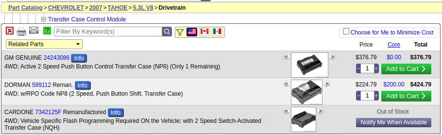

Suggest going to www.gmpartsdirect.com, enter your VIN, and see if the newest part number is available there for your VIN; part numbers are constantly being updated and old ones superseded. Once you have the updated part number you can search the internet for a part and availability.
Rock Auto is also a good source for parts. Looks like a new one would require programming.
