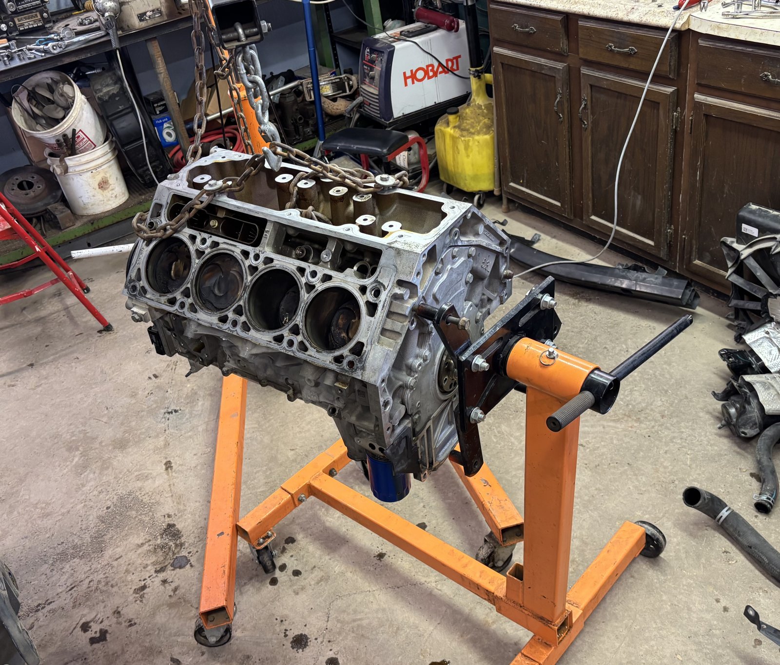

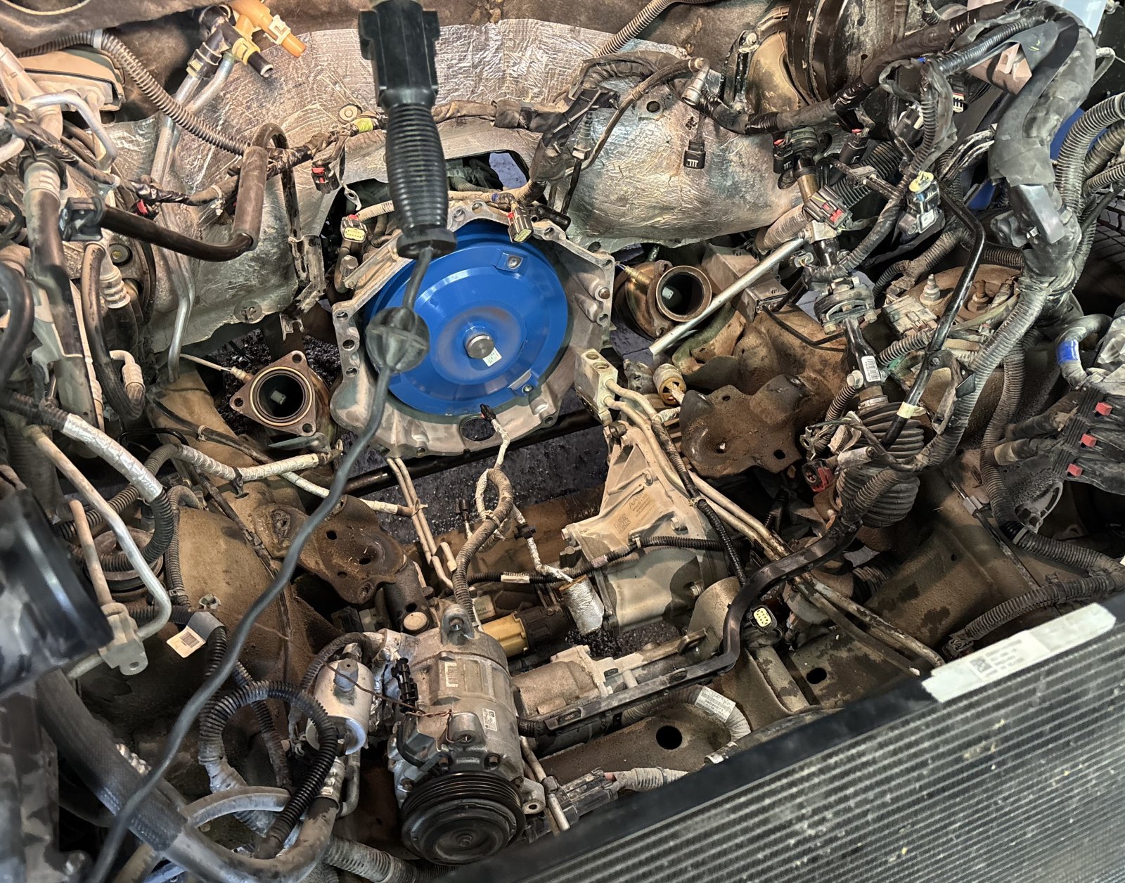

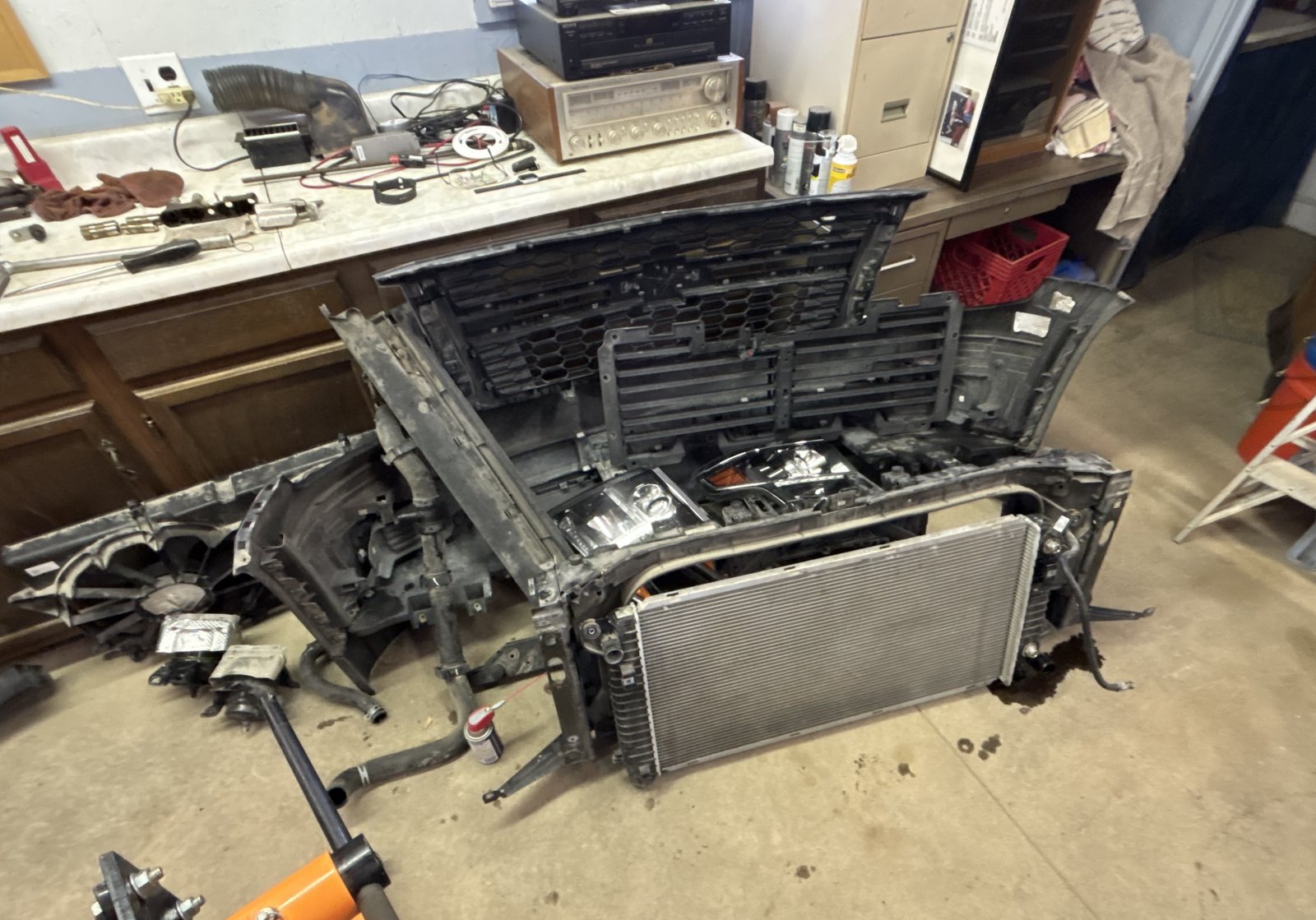

Did more tear-down over the weekend. There was an obvious difference between the driver side and passenger side as far as tightness of rocker bolts, head bolts, etc. Leads me to believe that this motor had work done on the driver side before I got it. I purchased the truck in February 2021, with ~42000 miles.
I
Oct 24, 2024
76
63
No going back now.
