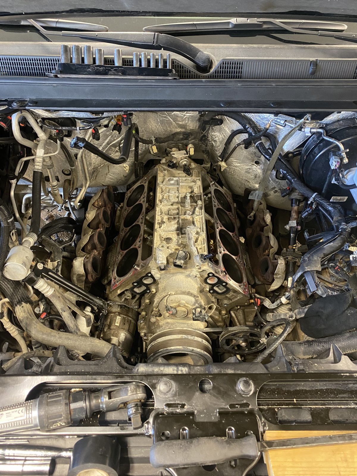

I don’t have much for pics of this whip… it carts the wife and kids around and I usually end up with a speeding ticket on road trips lol
Here’s a pic of the carnage I’m into now!
