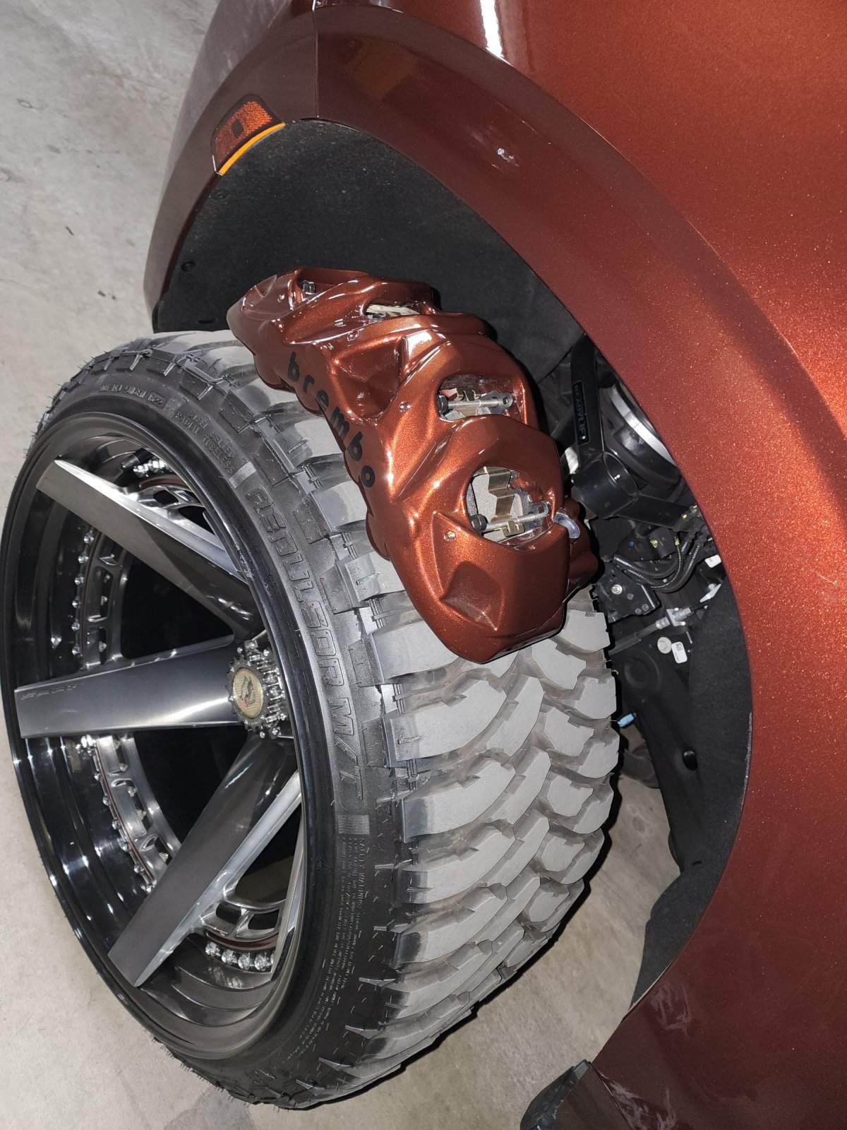

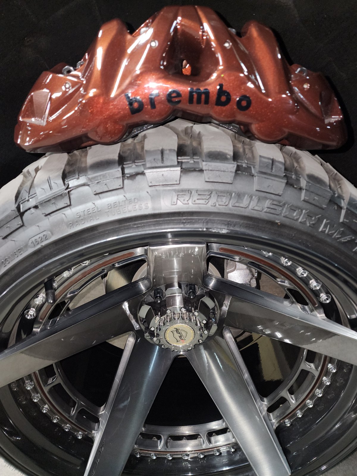

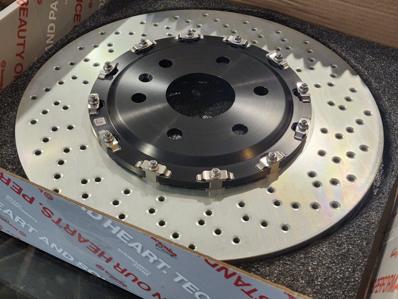

These just arrived yesterday, so I already made plans to install them next week. I could have gone with the standard red, black, white, yellow or fluorescent green calipers Brembo offers, but i didn't want them to stand out too much at first glance. For an additional fee, Brembo can paint them any color of your choosing. They then follow that process up with a high temperature clear coat.
I'm currently running 1/8" spacers on my front wheels because the spokes on my aftermarket wheels grind against a portion of the stock brakes. I could have grinded it down, but that would have looked tacky. So my motivation for getting these is partially because of that issue, but mostly because I like the look of big brakes and their functionality. I also drive aggressively on occasions, so these will be perfect.

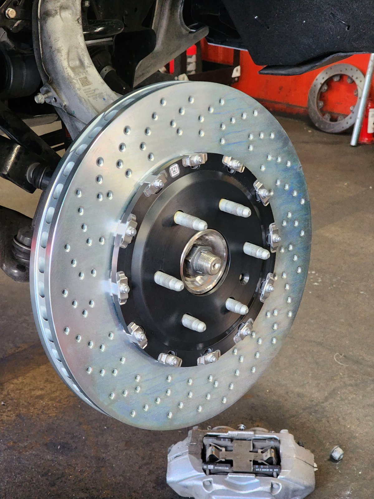

I decided to install the Brembos today, since my wife's birthday is tomorrow - because she'll raise Hell and high water if I took her special day to do something for myself.
The install kind of went smoothly. The only hiccup was an extra charge for removing the stock heat shield on the front brakes and replacing the wear sensor to fit the front calipers. Aside from that, everything went smoothly. It was a two-man operation, with both mechanics on each front and rear brakes. I'll break them in locally on level ground for the first few days because my initial decent on a ramp was really loud. "Freight train stopping" loud.
Anyway, I'll post glamour shot pictures on a later date when she's all cleaned up. In the meantime, here are some preliminary shots during the install.
