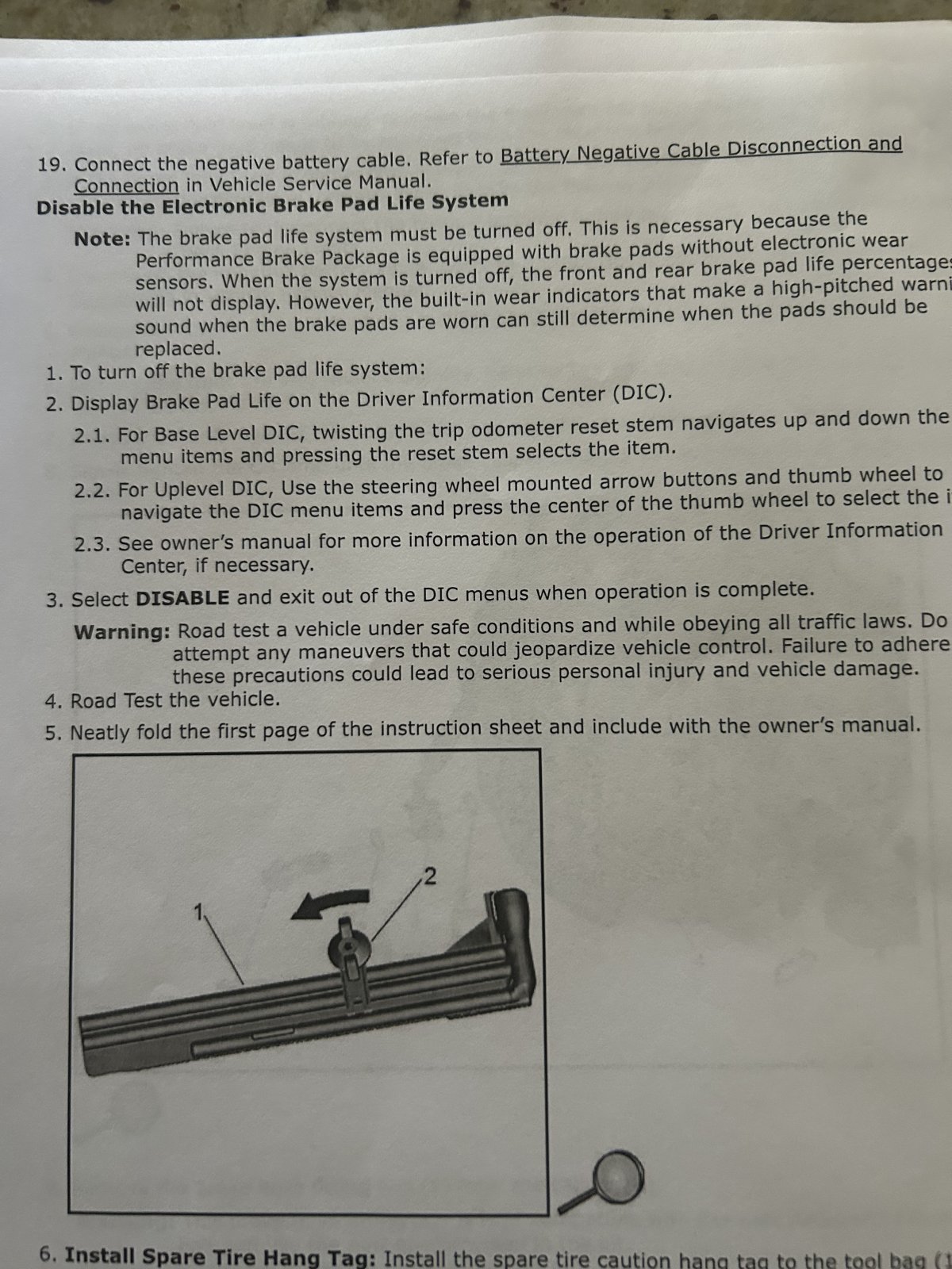

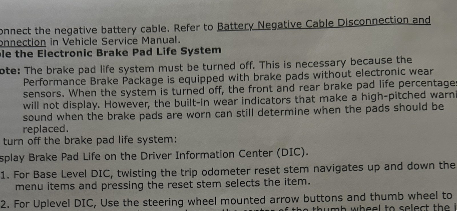

Another Update on my Brembo/GM performance front brake kit.
I went back to the dealer service department to figure out why my 2024 Tahoe High Country is not reading brake life on the DIC.
Originally the mechanic who has worked on several of my trucks over the years, told me the performance brake kit doesn’t come with a sensor to plug in to the brake life monitor.
I questioned this and showed him installation instructions that was linked on this thread, and that showed a plug and play connection for performance brake kit and the brake life sensor.
He took me to the parts department and put in my VIN, year and model and pulled up the manual and installation instructions straight from GM.
He said they always put that information in, just like I did when I ordered the kit from GM.
The instructions, model number etc is the same as the link posted previously on this thread except for the instructions page 14, and this is completely different than page 14 of the linked install instructions.
Turns out my mechanic was correct about the brake lfe sensor for the performance brake kit and my 2024 Tahoe.
It is not plug and play and if I want to read “brake life” on the DIC it would have to be modified and spliced to read percentage.
This was straight from the GM performance parts install instructions.
Apparently there might be something with the year and VIN and the performance kit that matches that.
