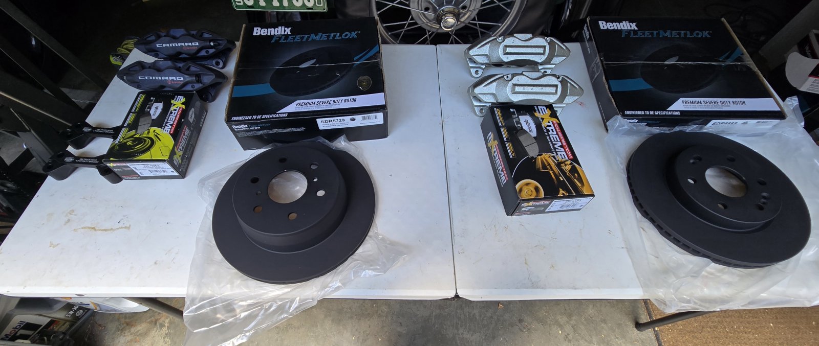

Here's the upgrade parts for my 2014 Sierra
