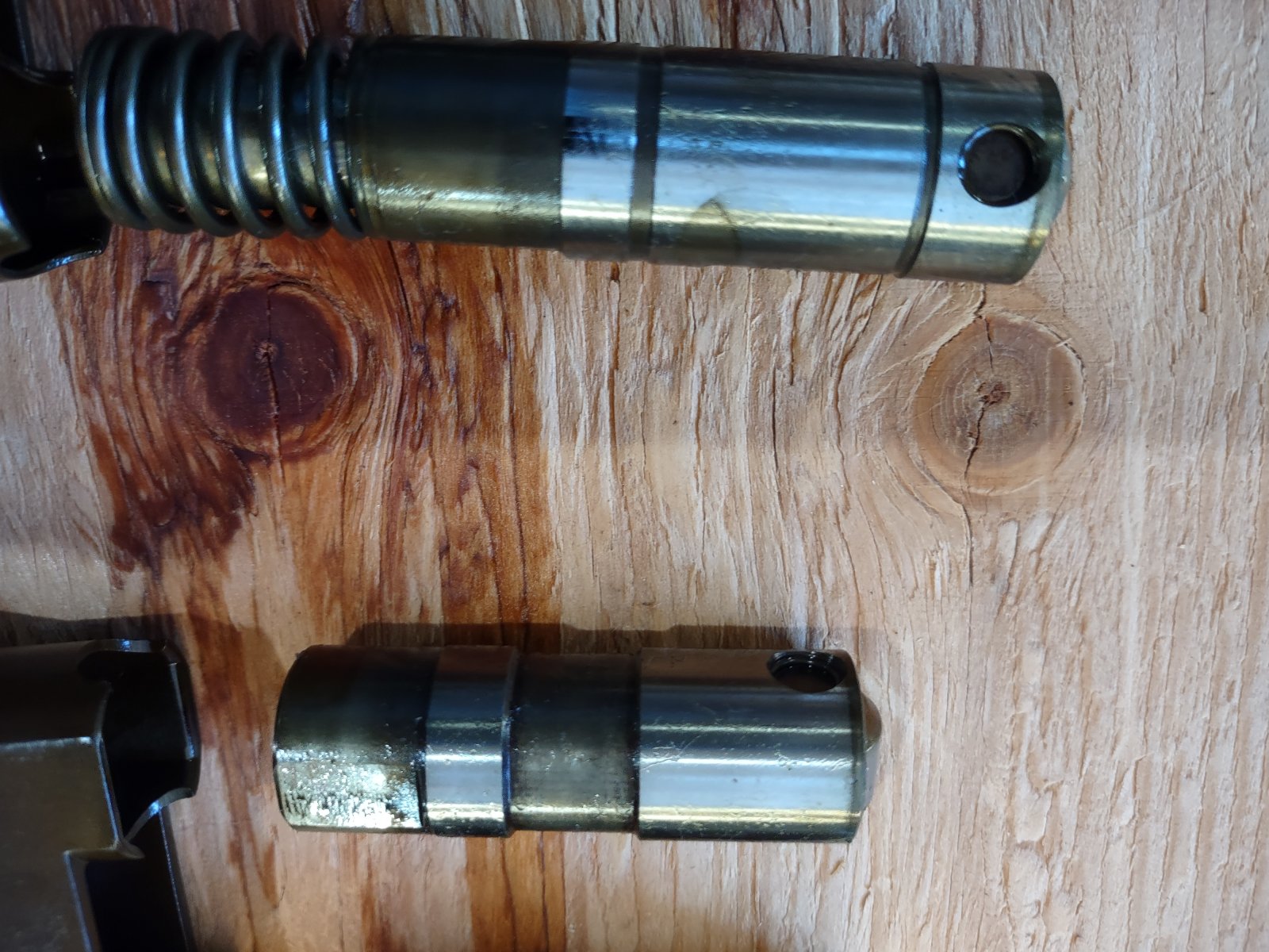

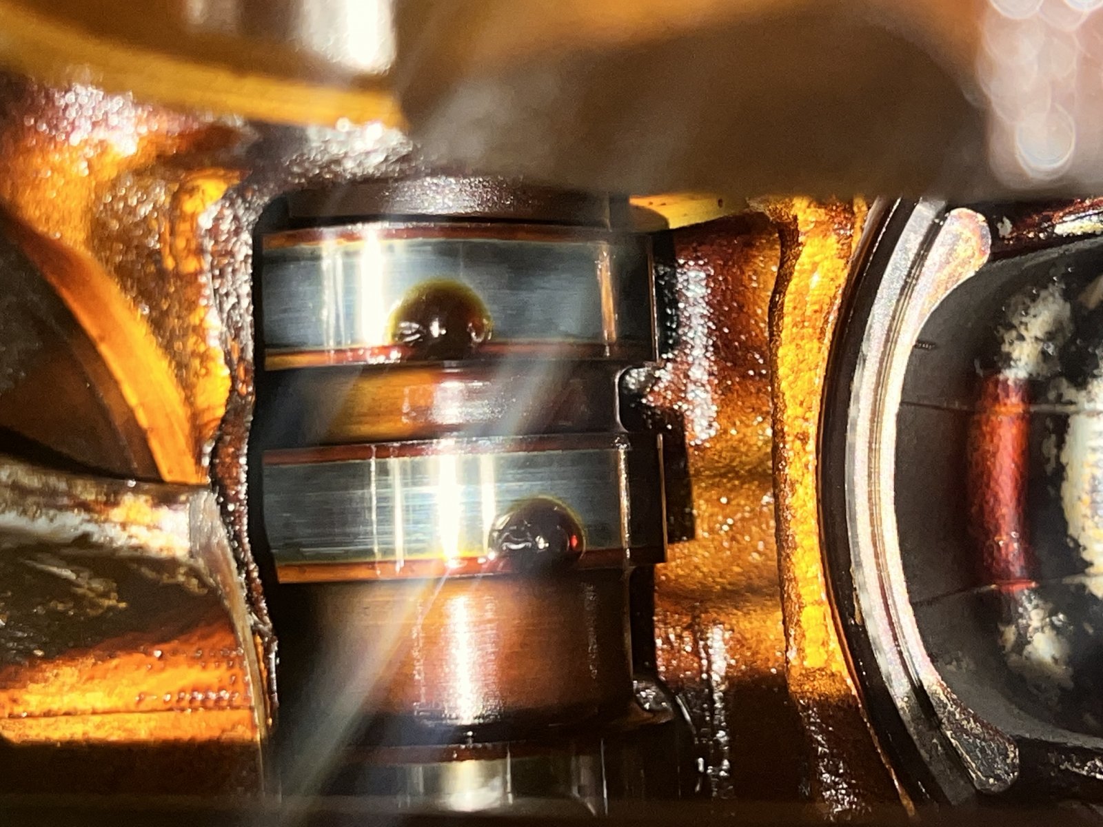

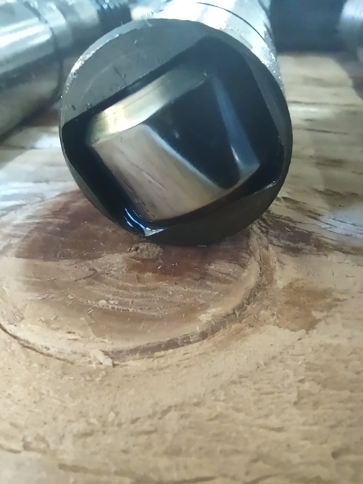

Here's what the lifters look like at just under 200,000 miles, with two oil changes with the Valvoline R&P.

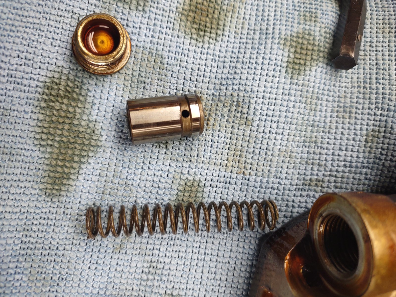

Oil pressure relief valve from the OEM oil pump

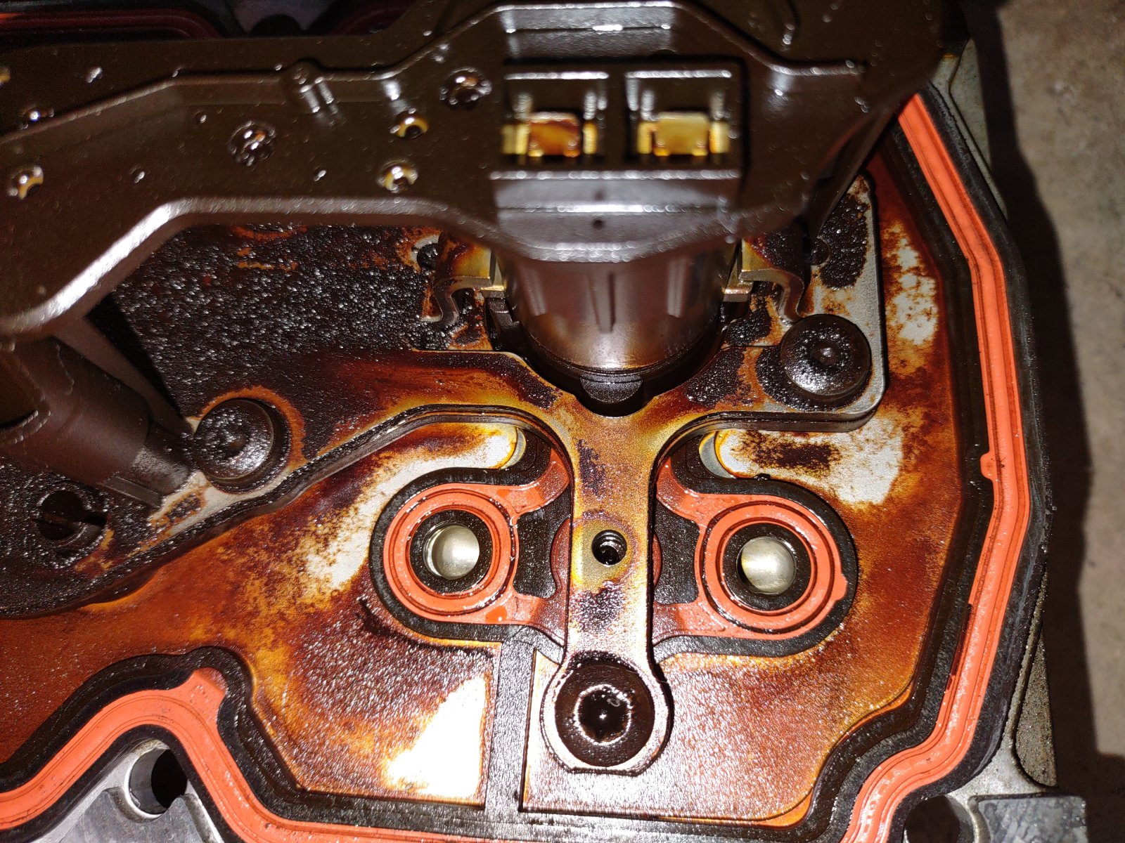

And here is what your VLOM plate looks like underneath. Notice there's no o-rings on these later models, it's more like a molded gasket. Probably why GM says you need to replace it when you remove it. I can only surmise that the clean areas are areas the Valvoline was working where oil was spraying out, lowering his oil pressure. His o-ring was pretty much like yours also

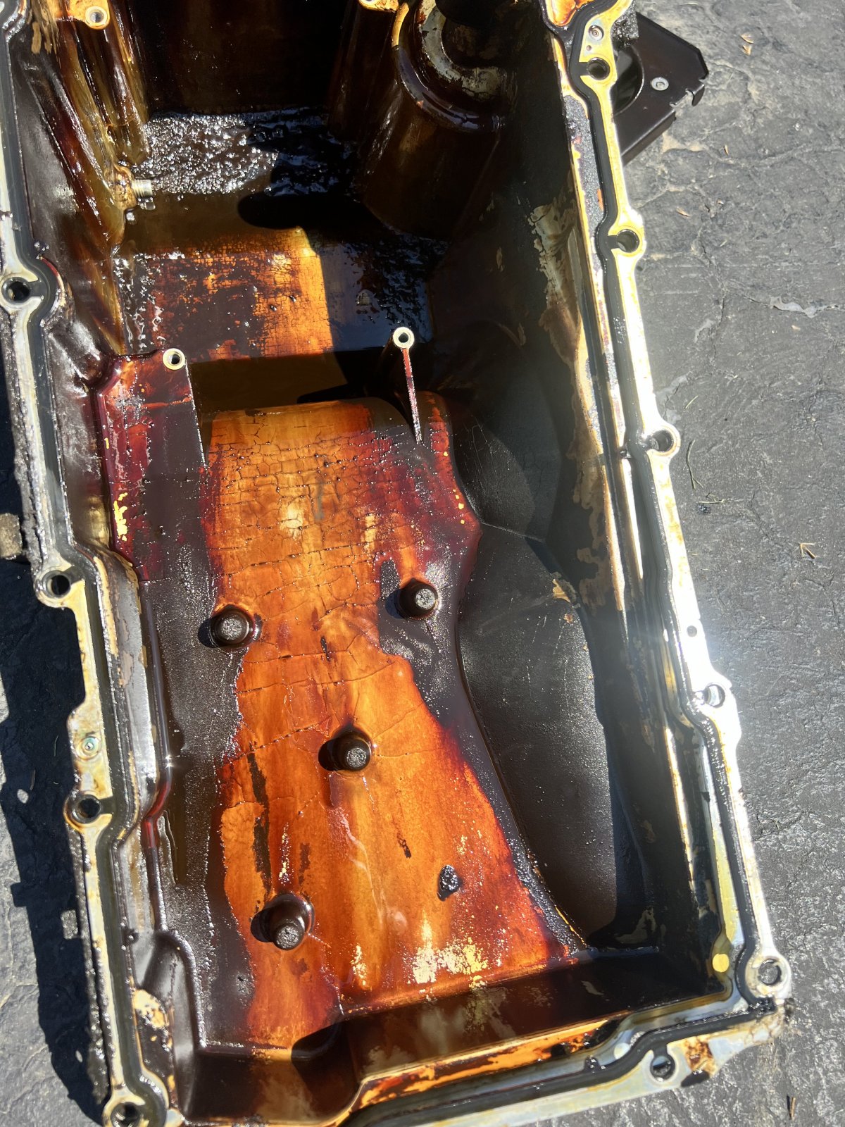

That pan has evidence of several extended oil change intervals all along the sides. The pan in my 2012 was relatively clean with just a brownish staining at 120K, and no carbon buildup like that.

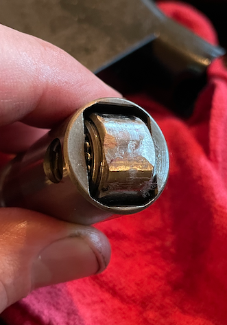

This is what a damaged cam lobe looks like. Note the deep scar along the edge. This was caused by a bad lifter tray that allowed the lifters to twist slightly:
Here's another lobe:
And here's one of the lifters:

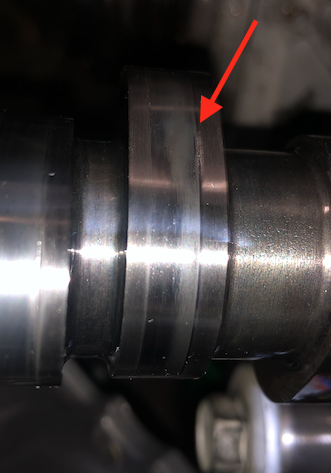

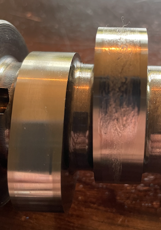

I was only able to take pics and I couldn’t touch anything so I can’t get a super good feel for it. But this is what most of the lobes looked like. There are some surface scratches but I feel like for a cam with 200k on it that it looks decent
That’s some pretty nice testing you got there’s. It sounds like everyone swears by r&p lol. I’m not sure if my VLOM was replaced but it might be something I’ll consider in the future
Those look fine for 200K. Normal wear patterns on those two lobes at least.

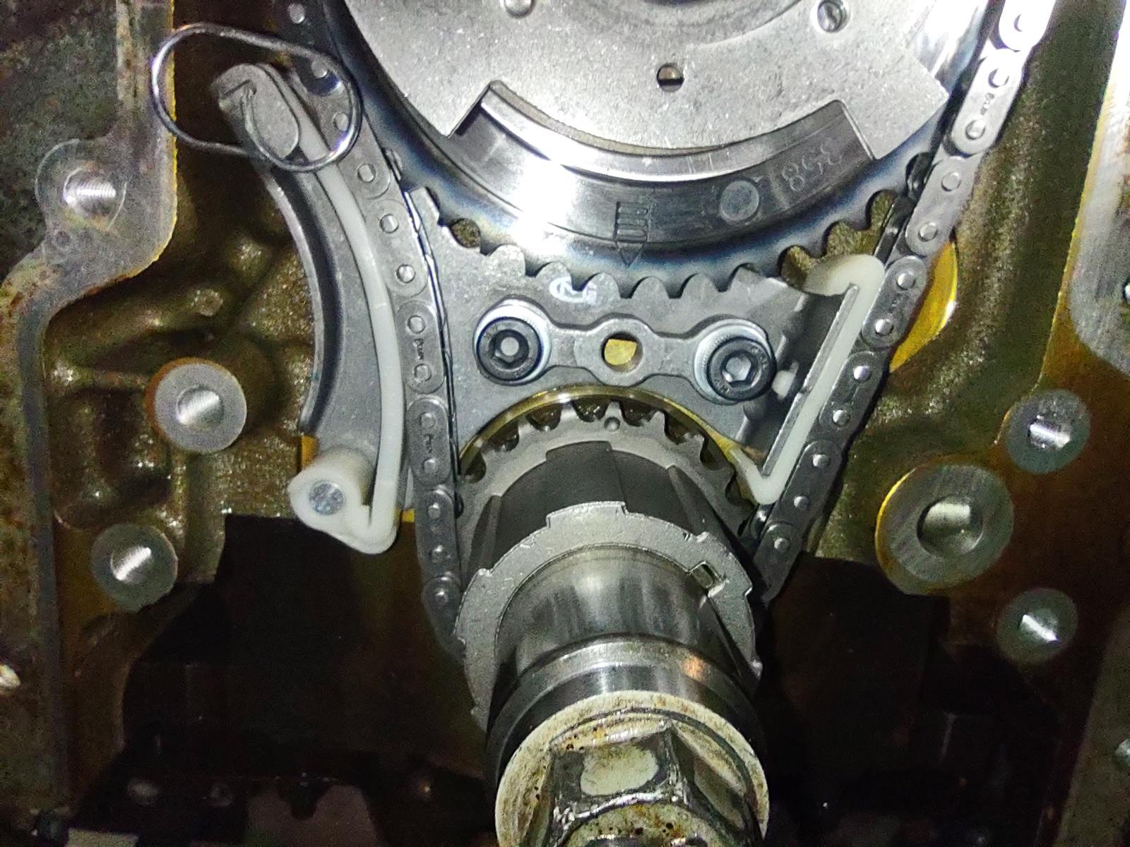

Here's a view of the tensioner installed, you can see the plastic strip alongside the chain on the left. You need to have that pin installed to get the chain on.... The tensioner really pushes that hard.
And here with the pin removed. If you could feel slack in that chain with the oil pan dropped, you definitely need to pull the front cover. More than likely that's the ticking sound you hear. The remains of your tensioner flopping around....

And note you have a smaller plastic piece that the chain rides on on the opposite side. You could have simply lost that as well. It would make a ticking sound in either case, as the chain sort of bounces off the remnants of the tensioner

Aaaaand here’s the timing chain slack. It’s probably not supposed to be like that LMAO. For reference, I'm touching the right side of the timing chain if you're looking at it head on

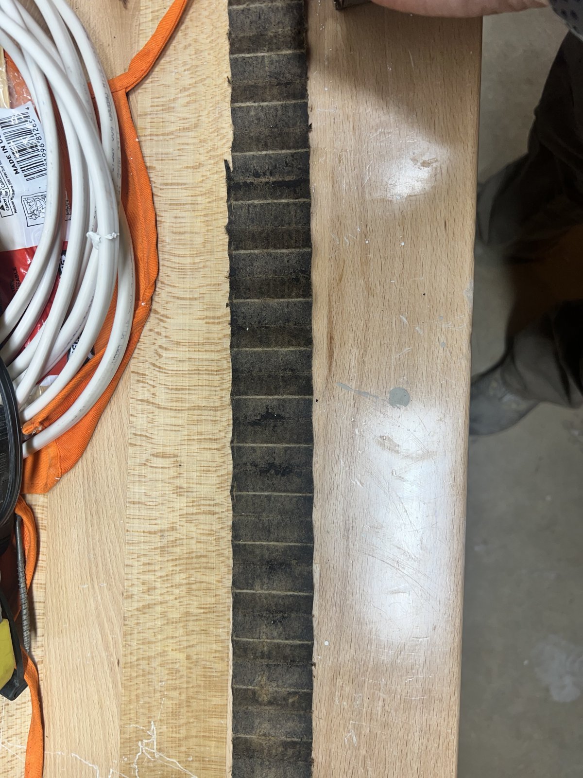

Here’s a photo of the filter pleats with the oil squeezed out of them. Really not much. But I wonder if the tiny flakes you do see could be the timing chain hitting the metal because those seemed to be ferrous (but I didn’t have a super strong magnet)

Without a doubt, your next course of action is to pull the front cover. Since you'll be removing the oil pump, might as well replace it. (And open up and remove the oil pressure relief valve see if there's a bunch of crud collected in there.)
I prefer the felpro gaskets and seals. Get their front cover set, it will come with a new crankshaft seal. Take note that it is Teflon, do not lubricate it before sliding a harmonic balancer in. It actually gets assembled dry, or it will leak guaranteed. You'll want a crankshaft locking tool that goes in place of the starter. Several available on Amazon. You will need a serious breaker bar to break loose the crankshaft bolt. I use a 42-in 3/4 drive breaker bar.... But a good quality half inch breaker bar with a 24 inch pipe over it will do the trick. Crankshaft bolt needs to be replaced once it's removed, it's torque to yield. I always replace them with a good quality crankshaft bolt that's reusable. (ARP, just search on Amazon for arp LS crankshaft bolt)
How far you go while you're in there I guess depends on your budget. At a very minimum, you can just replace the chain and the tensioner. I would consider an oem oil pump a mandatory change as well. If you decide to change the gears and get a complete set, go with a good brand such as Cloye's or Melling. Same for the tensioner itself. For the VVT solenoid and actuator, you want to stick to genuine GM or ACDelco.

Lol, even the timing chain in my lq4 engine in the 2003 Hummer H2 is tighter than yours, and there's no tensioner in that :) That's good that you checked that!
