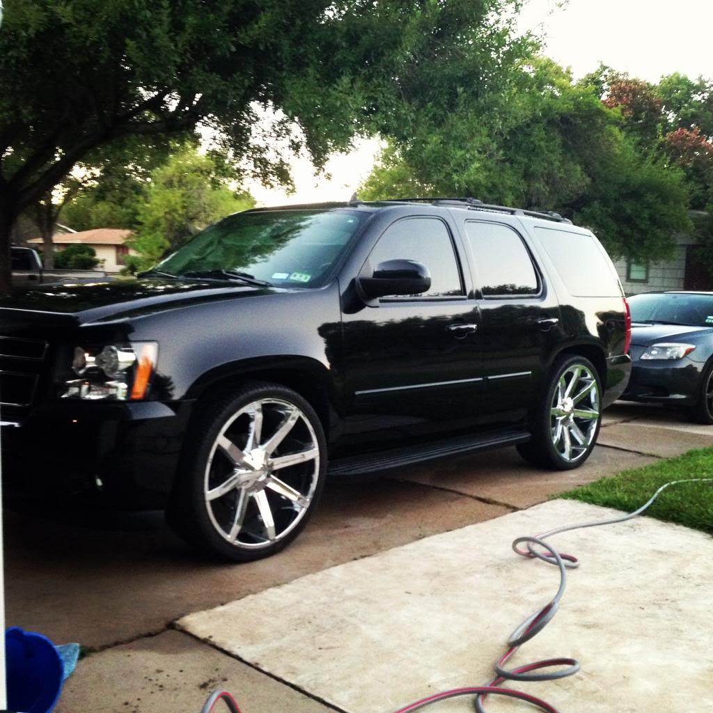

this is mine with a 2/3.
My jaw just hit the floor. ^ that is win right there. What kit did you use to lower? Any problem after you lowered with bottoming out with no one else in the car? Any problem at all after lowering?
