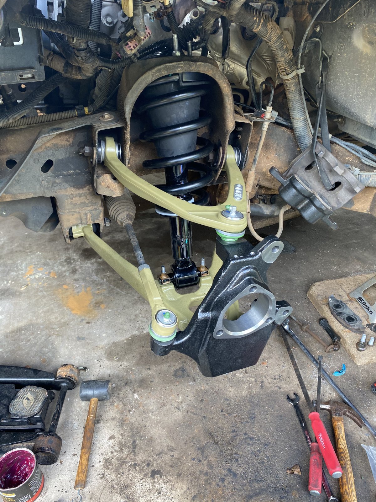

Hey folks, just replaced all the suspension components on my 2013 Tahoe LT but I’m having a hard time finding the torque specs for all the components. I replaced U/L control arms, Struts, outer tie rod end, put in a 2in lowering spindle. Anyone have a link to the info? TIA

View attachment 280506 Hey folks, just replaced all the suspension components on my 2013 Tahoe LT but I’m having a hard time finding the torque specs for all the components. I replaced U/L control arms, Struts, outer tie rod end, put in a 2in lowering spindle. Anyone have a link to the info? TIA
We just did all this too.
The strut bolts, top and bottom are 37 ft lbs.
The sway bar end links are 17 ft lbs.
The upper control arm nuts get torqued to 140 ft lbs.
The upper control arm ball joint nut gets torqued to 37 ft lbs.
The lower control arm nuts get torqued to 129 ft lbs.
The lower control arm ball joint nut gets torqued to 92 ft lbs.
The tie rod jam nut gets torqued to 55 ft lbs.
The tie rod ball joint nut gets torqued to 44 ft lbs.
The hub bolts that go into the knuckle get torqued to 133 ft lbs.
The brake caliper bracket bolts get torqued to 148 ft lbs.
The brake caliper guide pin bolts get torqued to 74 ft lbs.
If yours is 4x4:
The spindle nut gets torqued to 177 ft lbs.
The axle shaft flange bolts get torqued to 58 ft lbs.
