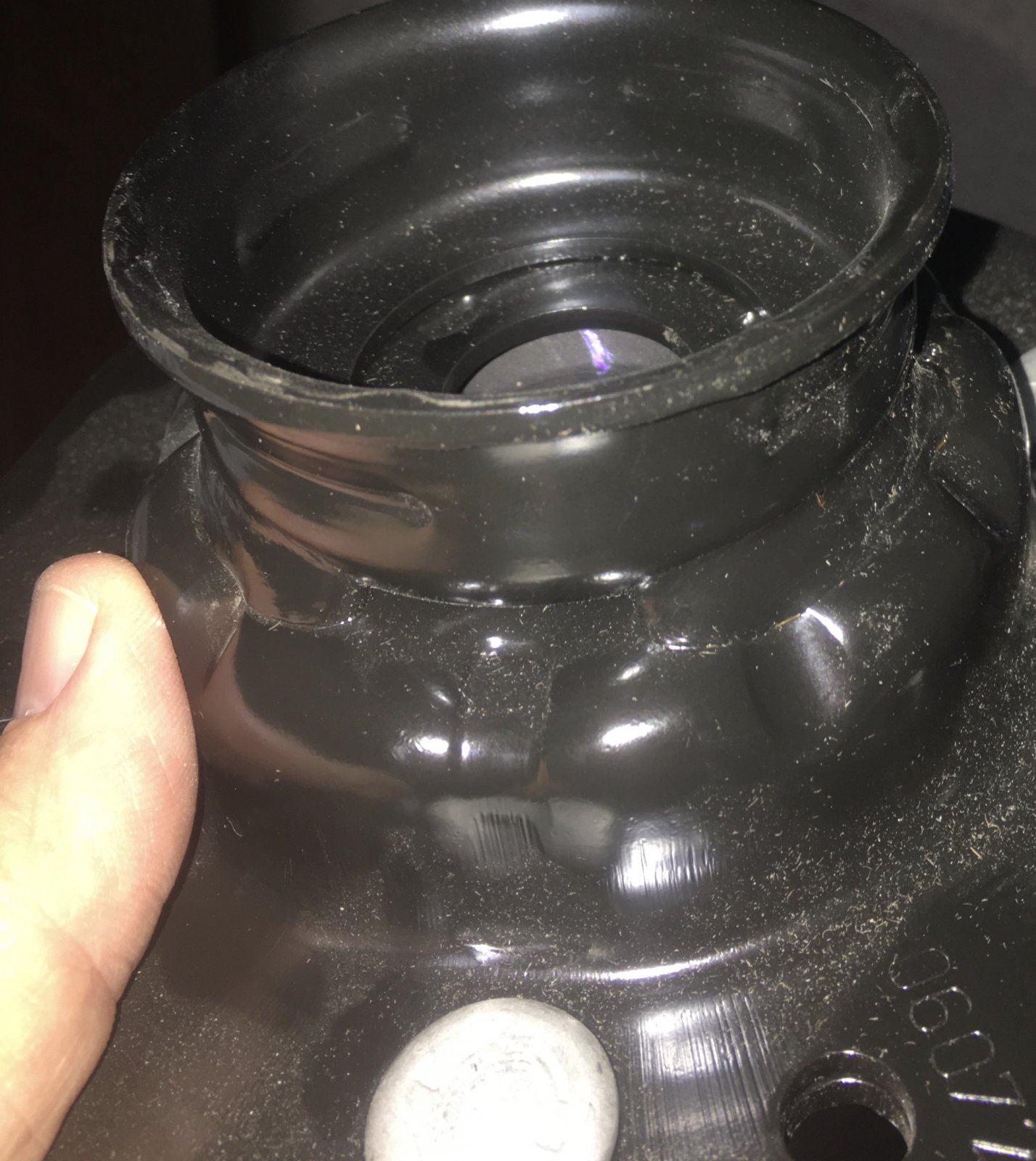

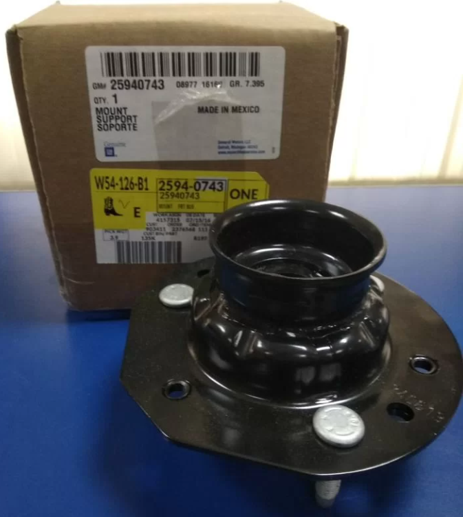

BAM! Thanks, clear as day now. I’d say do the two prong approach. Contact the seller of the strut and ask for a RMA and prepaid shipping label on the sticking strut. After you get the return authorization order a replacement on the same call. They may ship it for free.
Once you have the replacement strut you can have the mechanic swap them out after you pull it. You can also inspect the strut bushing. It should look identical to the one above. The standard hydraulic version look different.
You can see the rubber bushings inside with the blue mark on it
Looking straight down all you can see is the steel washer covering the bushing. The GM OEM version do not have the part # on them but are stamped 060821 on the top & 051113 on the bottom. Not sure if that’s a date code or not.

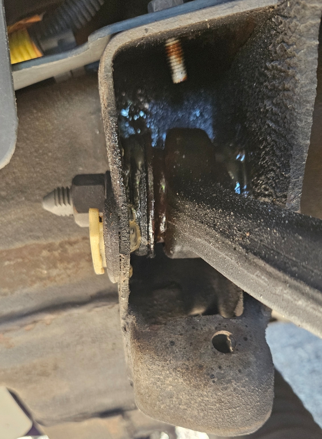

Well, I believe I may have found the culprit.
I sprayed my control arm bushings in hopes the thunking sound might be a bad bushing. After spraying them the noise ceased for a few days, then came back. I sprayed again and same deal, couple days later it was making the noise.
So on the 3rd spray down, I noticed something...and I remembered this started a few weeks after my alignment.
Needless to say it's going back in this week and we will have to work out a solution....hopefully it can be straightened out to ensure proper fitment on the control arm.
Should be evident in the pic.....:mad:
