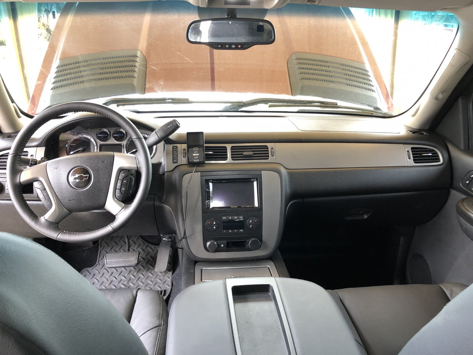

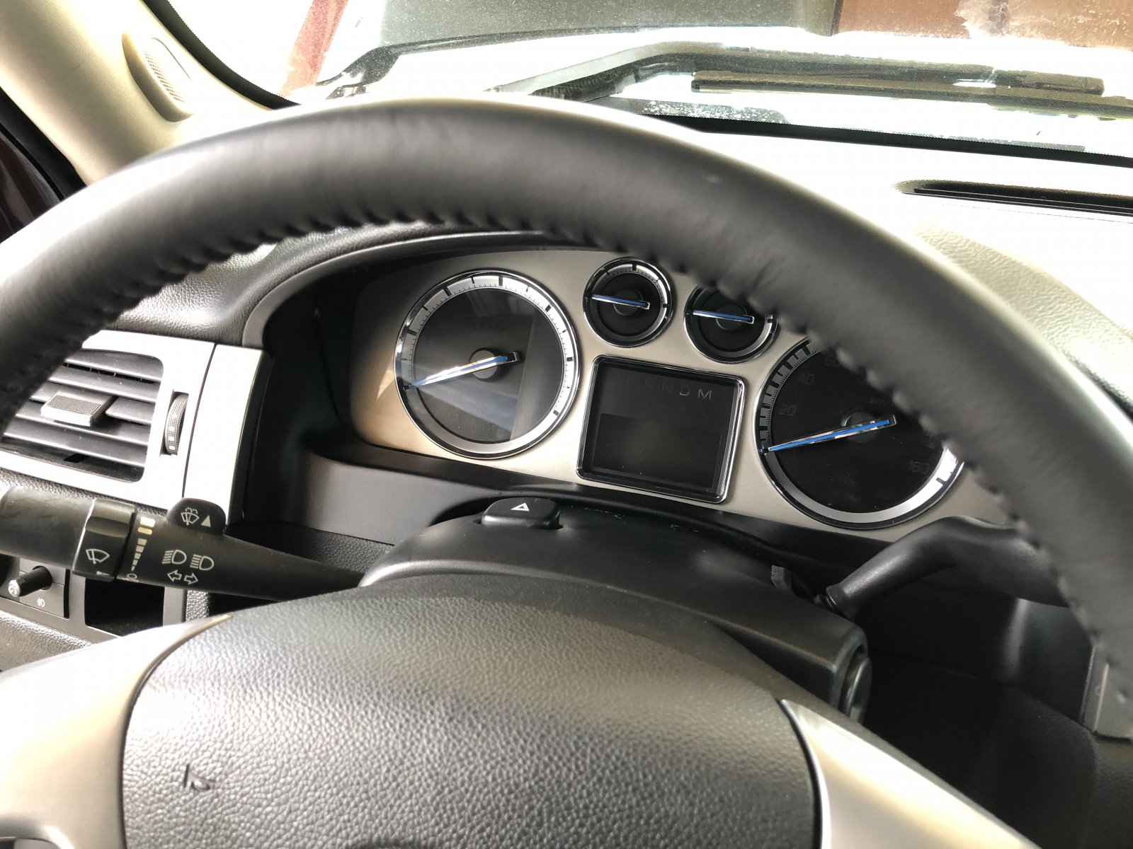

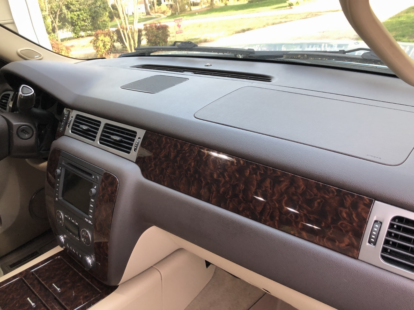

No sir lol. But I’m the guy who took my entire LT interior out of my Silverado and installed a dash out of a Tahoe so I could retrofit an Esky cluster., then followed with the door panels and had to make my own bezels for it all to work and look factory.

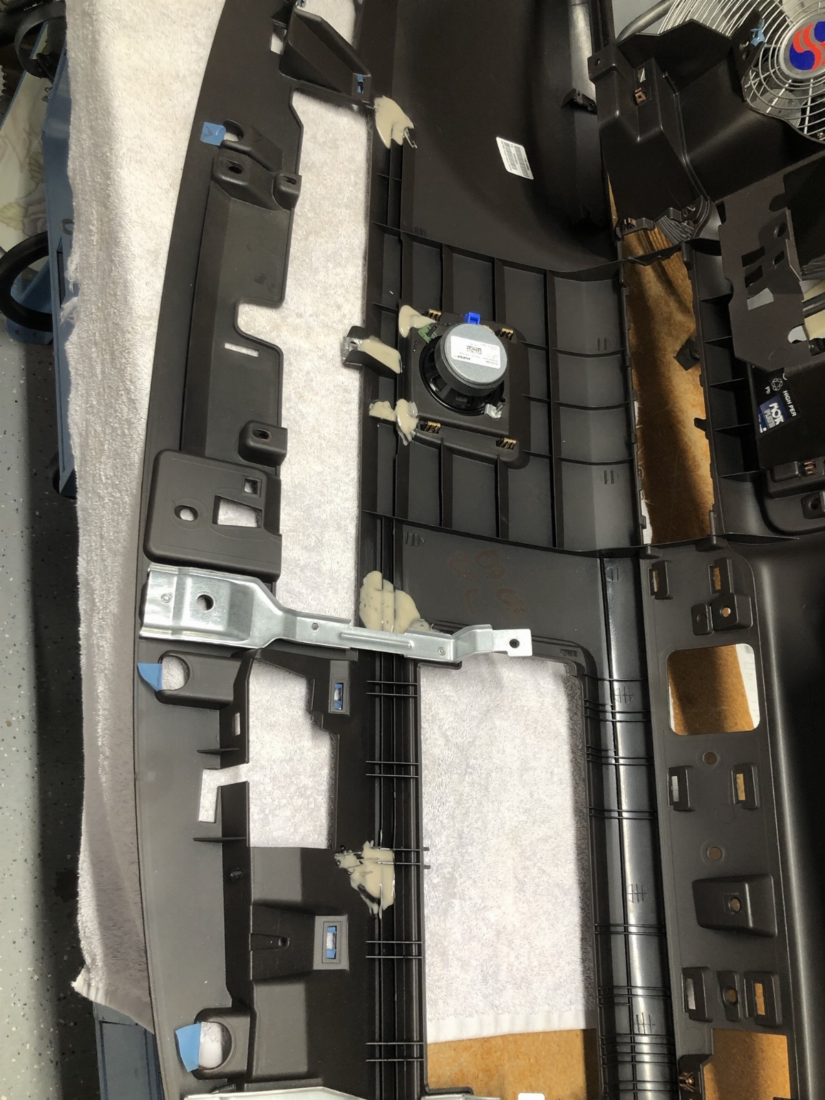

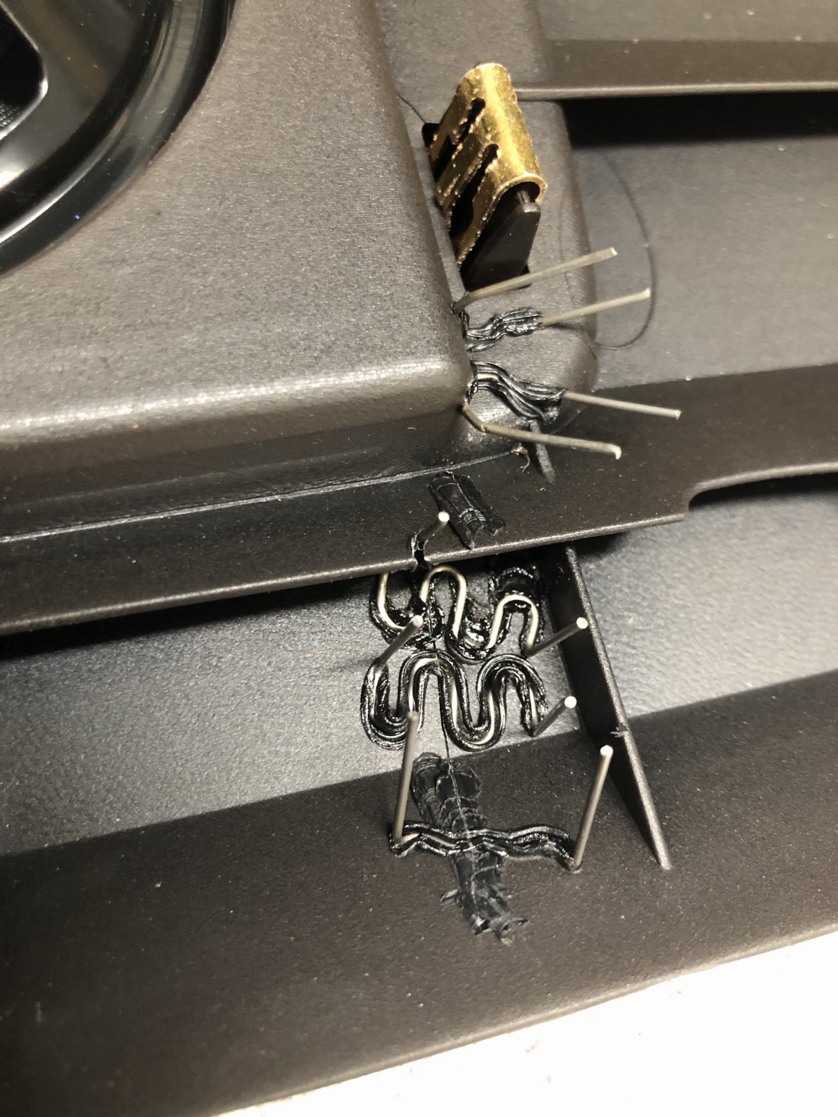

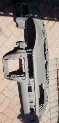

Well my dash finally cracked at the air bag. I decided to try and salvage it. During the process getting it out another crack occurred at the center speaker. I fixed all cracks with the hot staple gun and jb weld plastic bonder. The center clip to hold the front dash has always been missing so I took some 1/16 aluminum and made a new clip. Used the jb weld to secure it. The hot staple helped hold the cracks together. Then roughed up plastic with 80 grit paper. I did find more cracks under the dash once I took it off so I repaired those areas too. I’m very surprised how brittle the plastic is over the years. I will keep this one until it gets worse then replace it. Anyhow here’s some pics.
Has it held up, or cracked elsewhere?

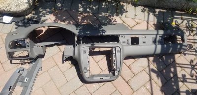

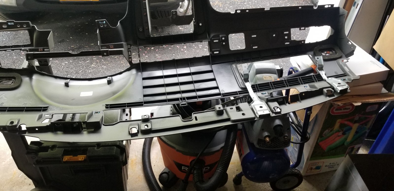

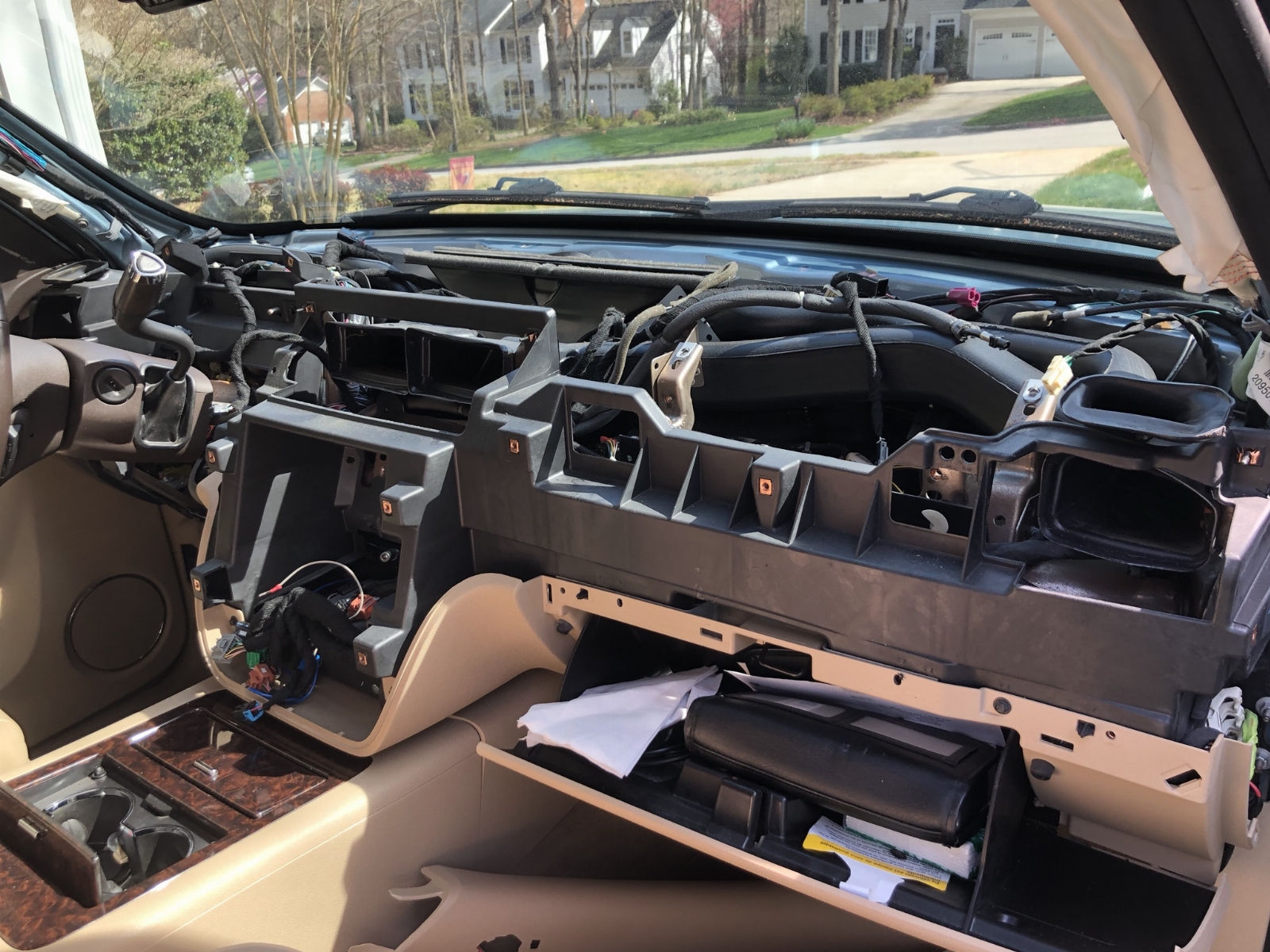

Wow wow wow 5years later a new house a new born a union strike several jobs and a national lock down, I finally installed my dash. Lol I had to laugh the last time I posted pics of the dash was March 25th of 2016.
Brooklyn hoe
Oct 26, 2011
135
23
Dash was plasti dip before Installing old dash was cracked in 5 spots.
