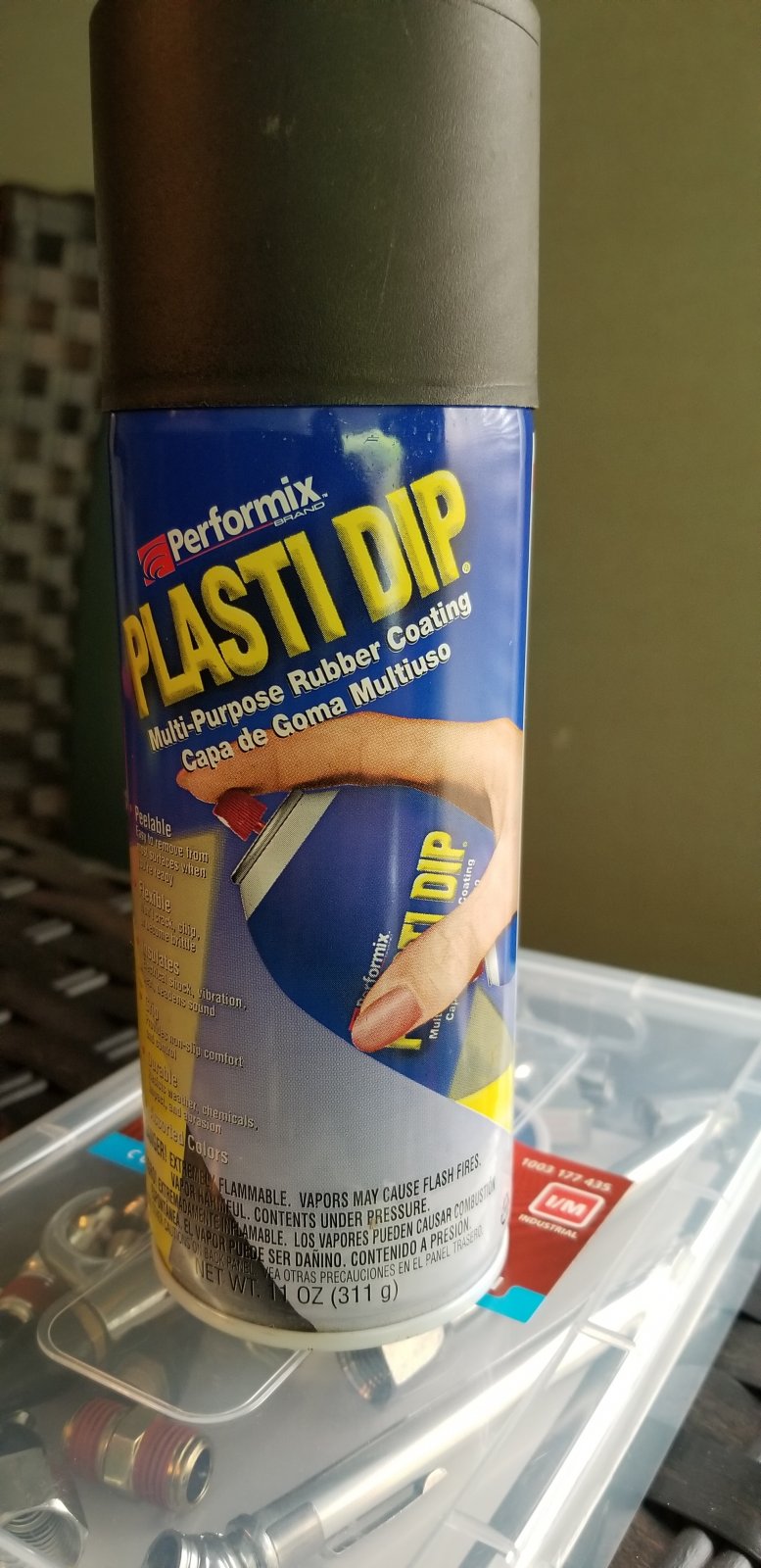

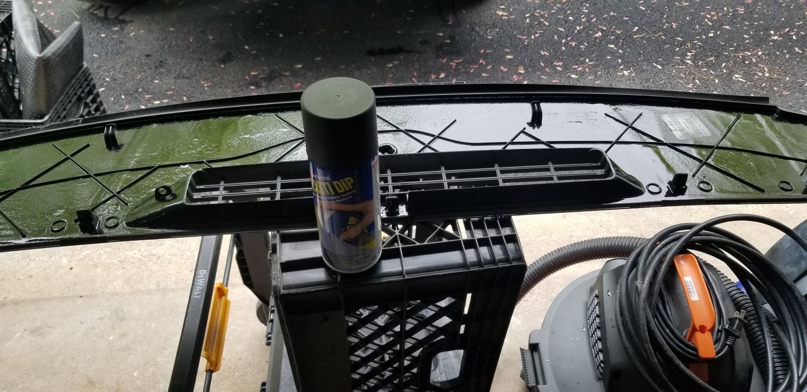

Thanks, it was easier then I imagined. Tools needed where 10mm and 7mm sockets also a pry tool. Scariest part of replacing was removing the air bag. As for reinforcing the dash I used 1 can of plasti dip.

Oh Yeah almost forgot. When taking out the bolts you can use a drill to make it go faster but when you are installing the new one, hand tighten if not the bolts will snap.

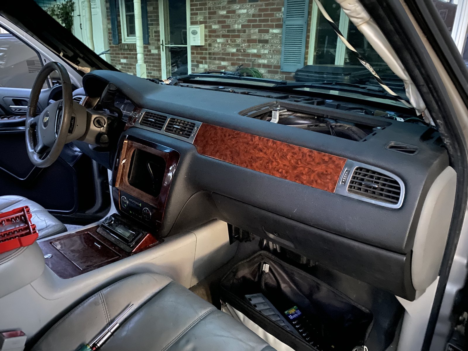

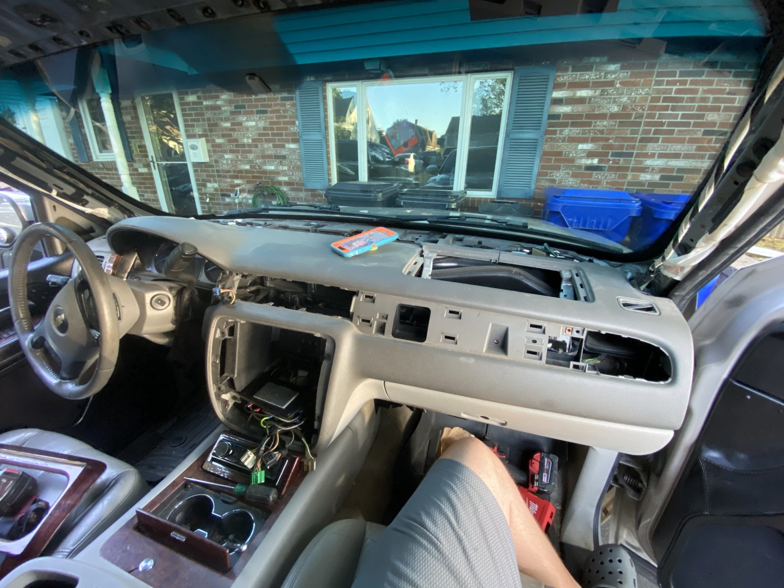

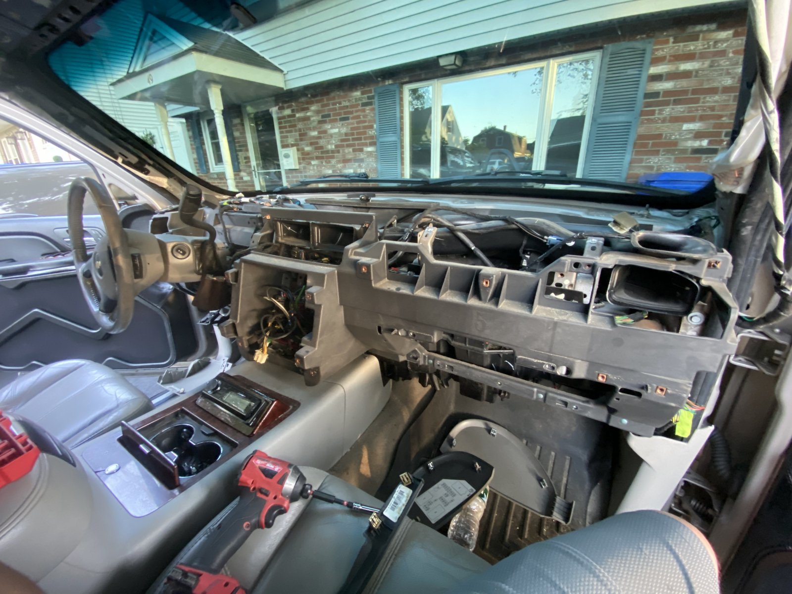

Just swapped my dash. Took a hour and 40 minutes to from start to 98% complete. Just need to do the airbag and the front piece of the dash (ran out of daylight)

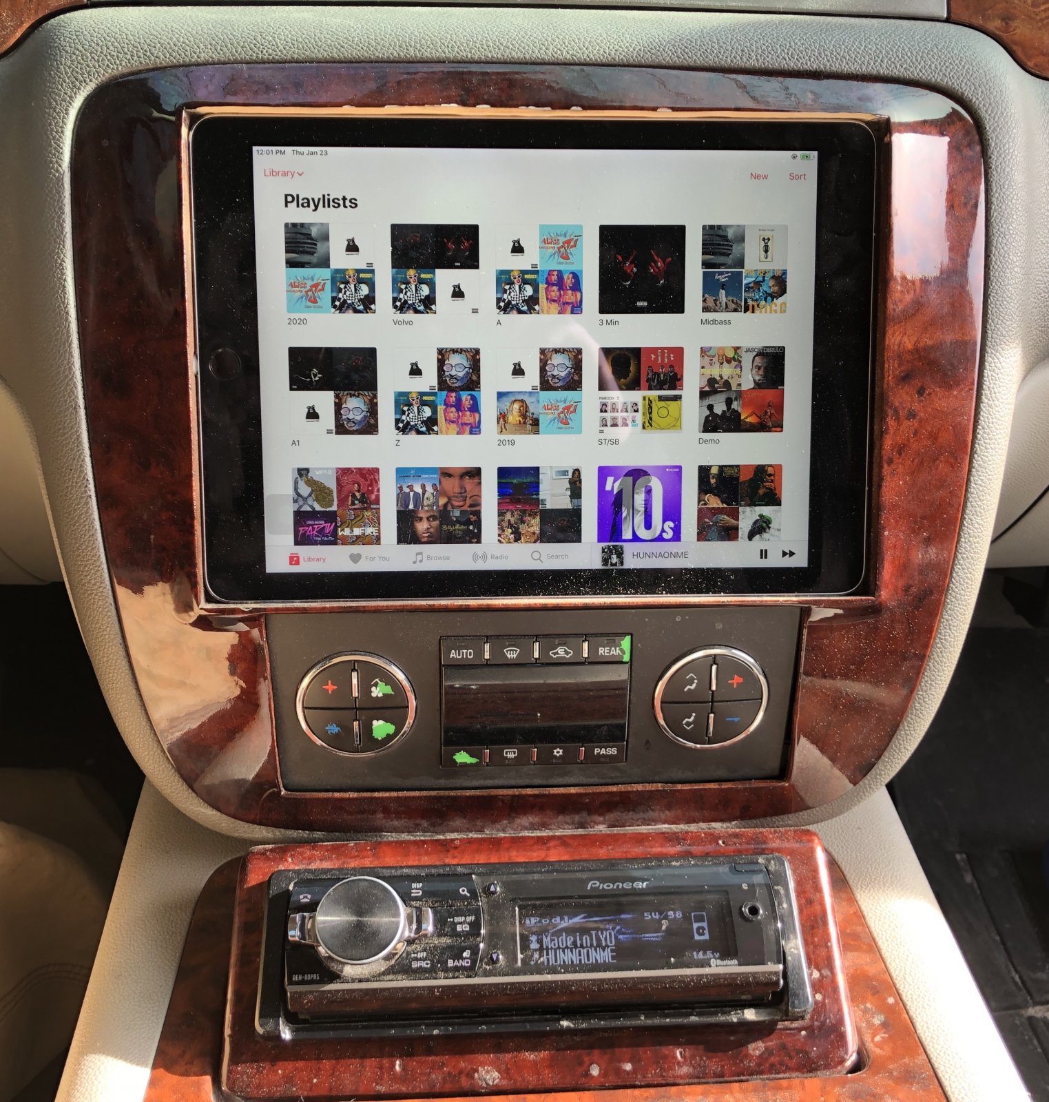

What's the button in your console forward bin for?
52,954
Or what’s up with the area of the dash where the stereo is supposed to be? Is that a giant cubby?

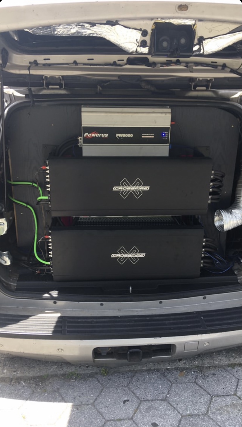

Button is for the amps and the huge cutout in the dash is for the iPad Pro. I didn’t want it to stick out past the factory edge of the dash so the only way to get it to sit flush was to cut a huge part of the dash out

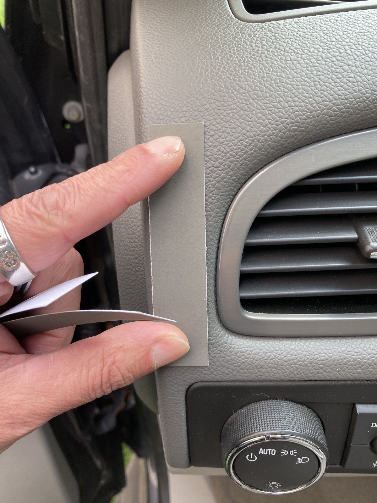

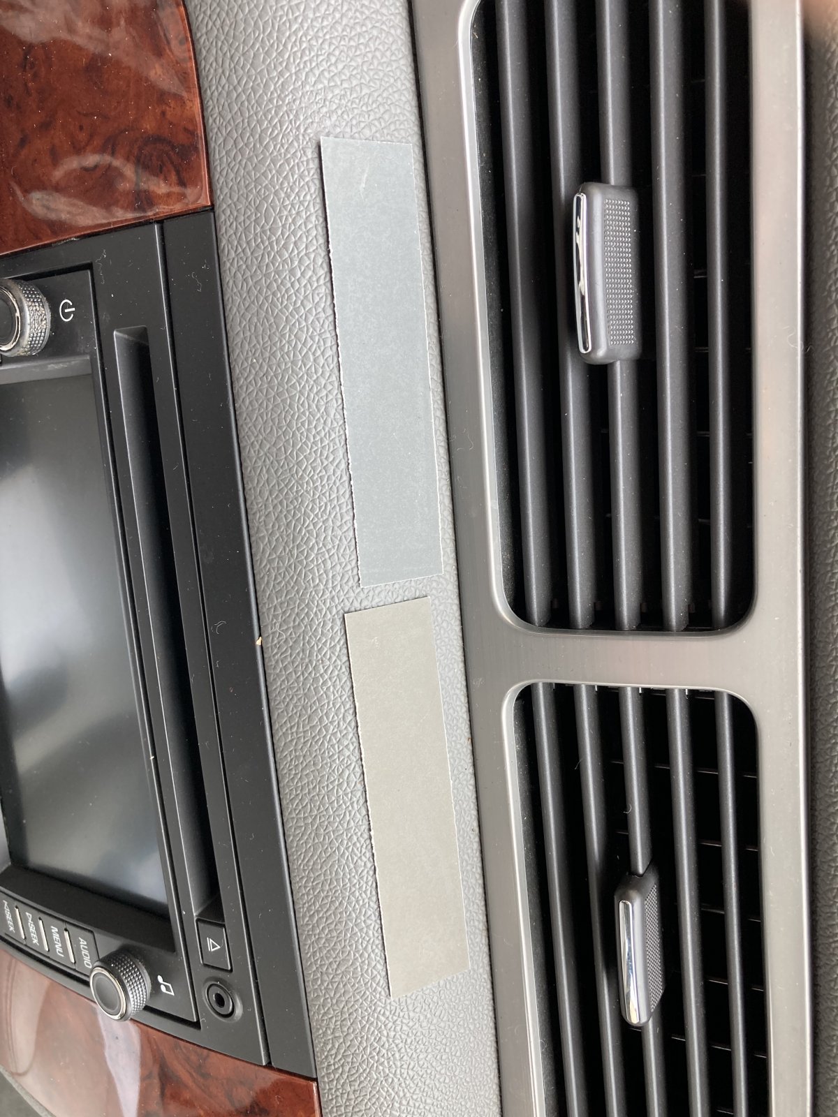

Hi there,
I follow this post to find example of coverlay dash cover (not dashskin) because I just purchased a 2010 tahoe LT (which is now in France). Unfortunately the daah was completely cracked and I have to repair it. I can’t buy a new complete dashboard because it can’t be send to France. I have found Coverlay dash cover as a good solution but I have a concern choosing the right color.
Coverlay send me color samples but it’s difficult to know if I have to order medium Gray or Taupe Gray (see picts) because it look the right color is in between…
does anyone have installed a dash cover from Coverlay in a dark titanium interior and can help and show result?
It’s difficult for me to buy just one part of the kit because transport and customs cost more than the product for French shipping and I can’t return it.
