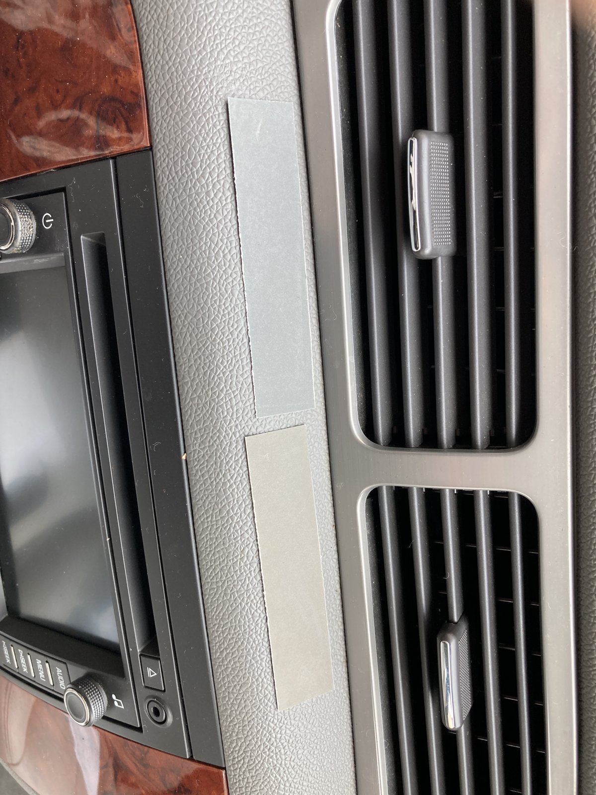

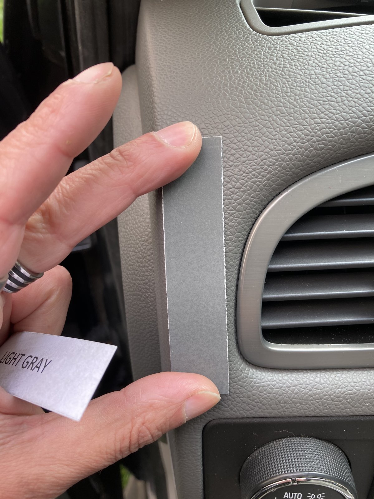

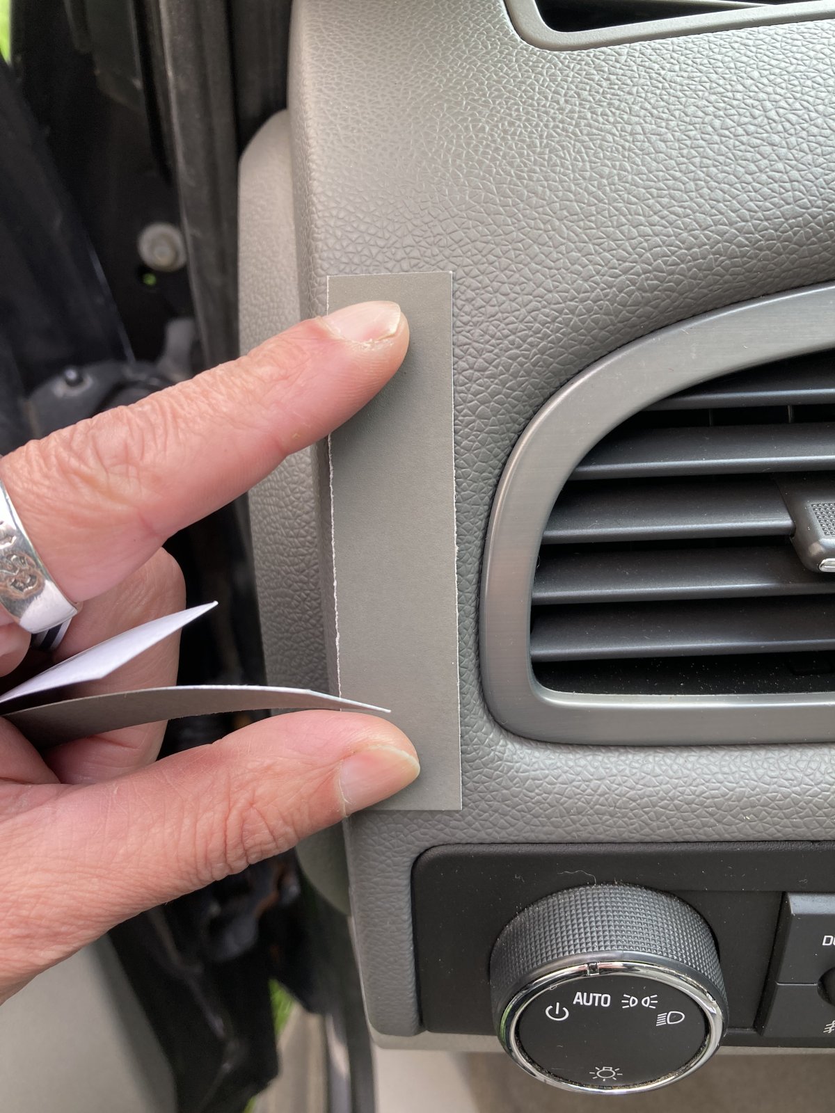

Coverlay send me color samples but it’s difficult to know if I have to order medium Gray or Taupe Gray (see picts) because it look the right color is in between…
does anyone have installed a dash cover from Coverlay in a dark titanium interior and can help and show result?
It’s difficult for me to buy just one part of the kit because transport and customs cost more than the product for French shipping and I can’t return it.
First pic.. left one... And 3rd pic.. is your color, the other looks too brown, tan.. should be able to look up color by RPO code, in glovebox or console..

Thanks for your reply. That’s my problem. Looking for 1rst pict, I would choose left one but right one is the sample on 3rd pict which better fit. Yes I have seen the RPO (833 or 83I) which is dark titanium
Dark titanium is the color of mine as well. Blackcar is right on the dashskin having the correct color. Coverlay doesn't list the dark titanium as an option.. I don't know that the difference in packaging size would be that much from a dash cover vs a new dash. As the cover seems to be only about 8in shorter across the front of the dash.. in a perfect world we would want to replace the issue all together.. just too many decisions..

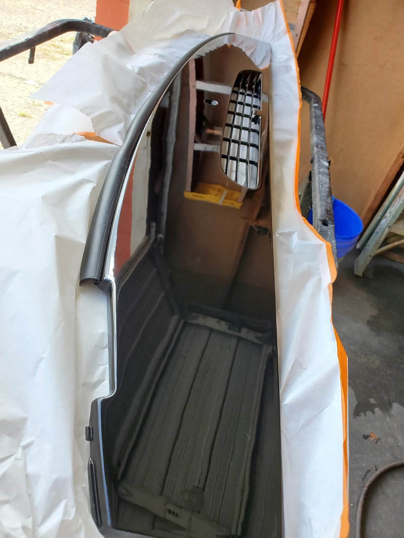

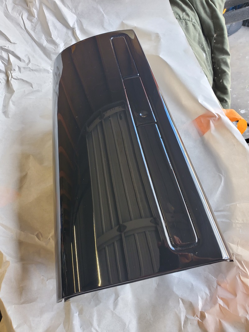

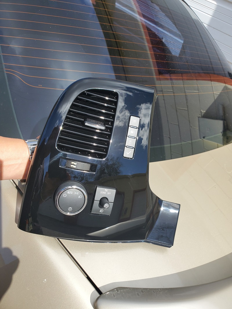

I got tired of the dash cracks that seemed to grow and get worse just by looking at it. I picked up a replacement dash for 100.00 a while ago. I remember it costing more to ship than what I paid for it. Since I am in the midst of rewiring and changing a few things. We smoothed and color matched the dash. Effort was completed this past weekend. Will work on the upper and lower glove box doors and the air bag cover this week.

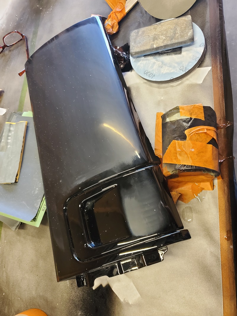

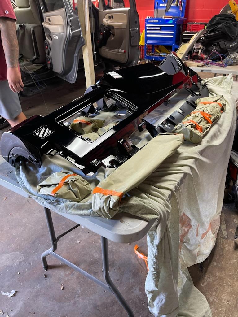

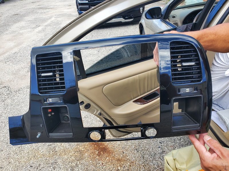

The forward part of the dash and the airbag panel done and completed last night. Rest of the pieces should be ready by the end of this weekend.
Heck yeah Staggered, that looks awesome.
Do you think the glare could possibly be a problem?
Seeing this makes me want to paint mine when I get a new one.

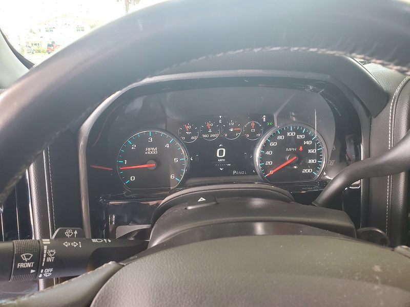

^^^ I don't think so. We'll see though. I have a couple of trucks. I don't think I'll be driving this one on a daily basis. I actually did the dash pieces on the High Country as well but limited to the existing plastics only. Did 2 colors on that to keep up with the H. C. interior piping color / theme.
Also swapped the H. C. instrument cluster for the Denali cluster. Nice little upgrade.

What did you smooth it with? Thsts pretty impressive to get plastic to shine like that.Nice work!

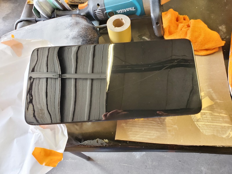

It's definitely a process and of course it's all in the prep. Always. There are many painters and shops that will not do this. Mostly because it's tedious time consuming work and labor intensive to get this finish. All of the plastics on most of my trucks are done like this or something a little different (i.e. dual colors).
Start with 320 grit to get the most bite and to bring down the texture. then some sanding, priming, sanding, color, sanding some body filler on areas that need a little fill (like around the handle to open the glove box. Clear, polish, more color, final clear final polish etc. on the 2011 the dash faces are not textured so less work but still must prep. Great results though.
I remain on track to get most of these done by the end of this weekend, er tonight. There are few more that need some final work but the lion share of al of the parts are done.
