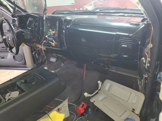

Getting back on topic. Still making progress. Most f the major dash pieces are in now.

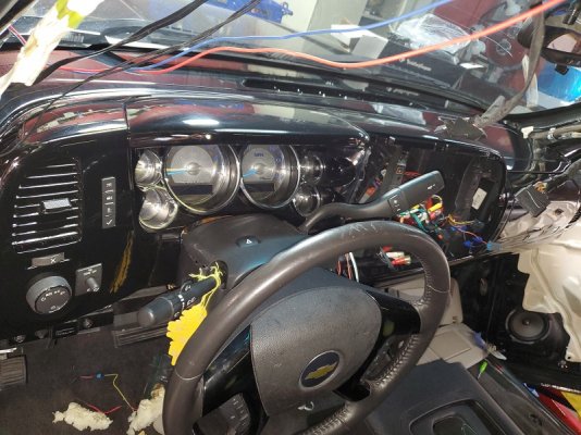

That's solid @Staggered 02, looks like an old school steel dash!
Thanks Jeremiahm. I agree. I had one of those old school vehicles a very long time ago. A bit of a retro look while reinforcing and hopefully mitigating the cracked dash issues on this generation vehicles. Most of the pieces are in now. I have a few stragglers that are in work now.

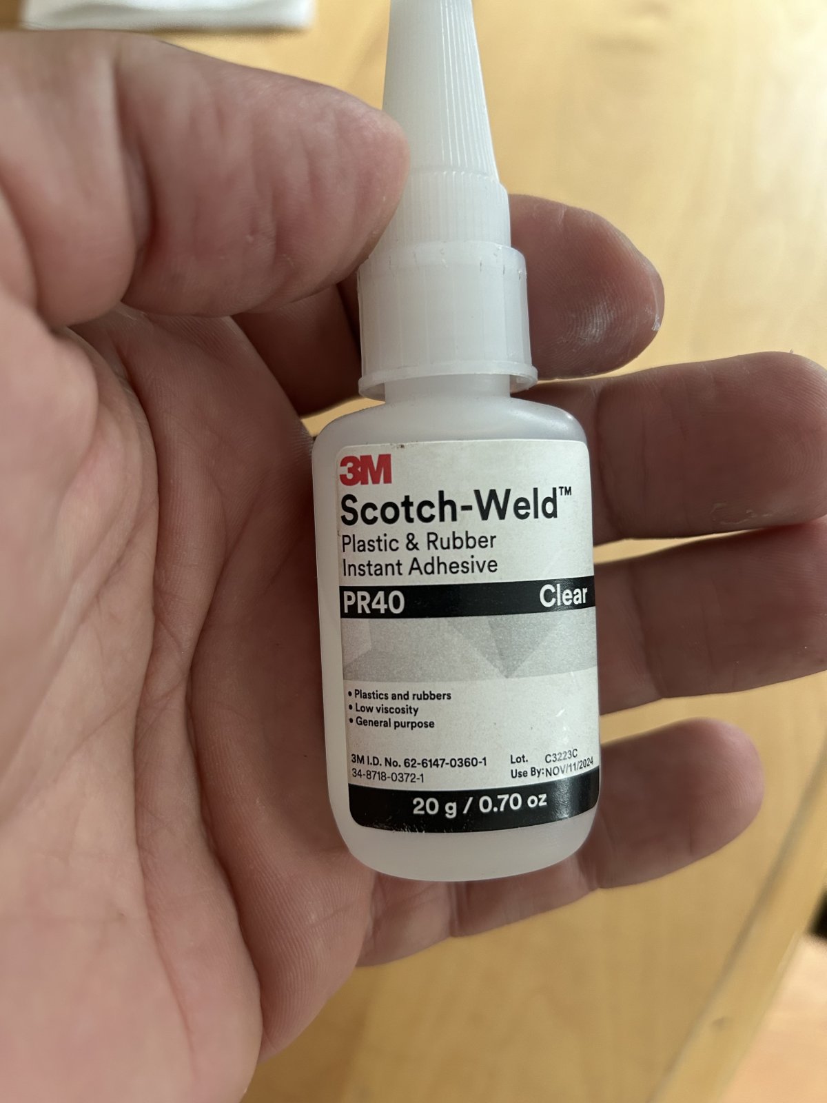

I don't know why I didn't post this earlier, but I got this to try to keep the pieces together and from falling apart and down into the dash structure. It's quite strong and uses very little. Hoping to apply it this weekend as my dash is in pieces haha.
Have you tried a little test spot of glue? Usually the instant adhesive stuff dries very brittle and can/will come apart when you hit bumps or the dash rattles for whatever reason
I haven't yet, today was crappy out. I'm going to put a dab on a section tomorrow morning. I'll let yah know how it goes.
It's pretty rugged stuff, used it on my daughters' boyfriend's dirt bike plastics and it's held up surprisingly well. It's pretty impressive stuff, it's different than a super glue. At least how it reacts once it has contact with plastic.

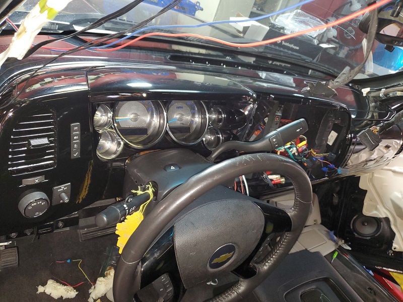

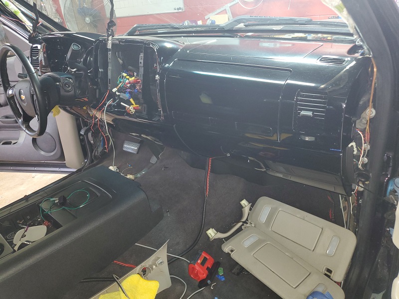

Inspection time came around and the backlights on my cluster had blown since the last inspection. My dash was already cracked to all hell. Took the cluster out and shipped it off to ACS for a rebuild and upgrade.
Finally decided it was time to hunker down and get the dash replaced.
Dash and Dash extender picked up from the Chevy dealership… waiting on the cluster to come back and the interior rebuild begins.
2024 price was 1k for both dash parts.
