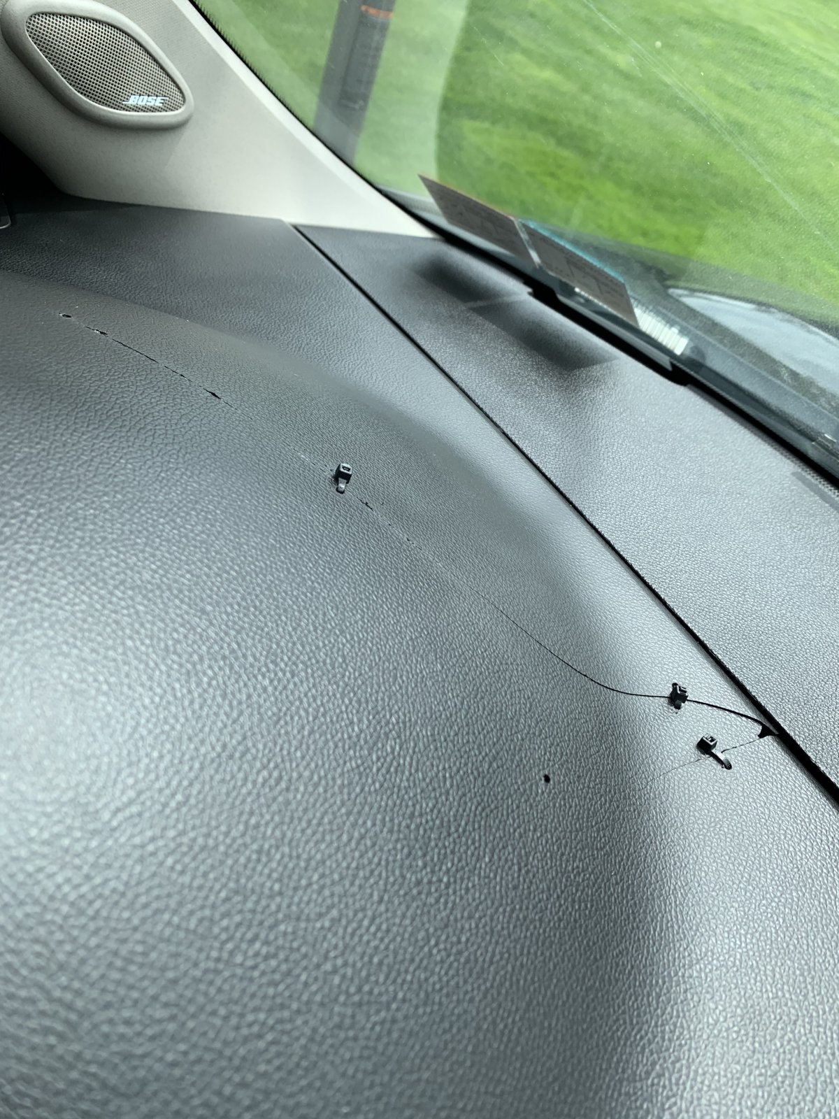

Here is a pic of my quick and dirty zip tie repair. I just wanted the rattling to stop. I thought about using J-B Weld 50139 Plastic Bonder Body Panel Adhesive and Gap Filler...but the zip ties are good enough for now.
