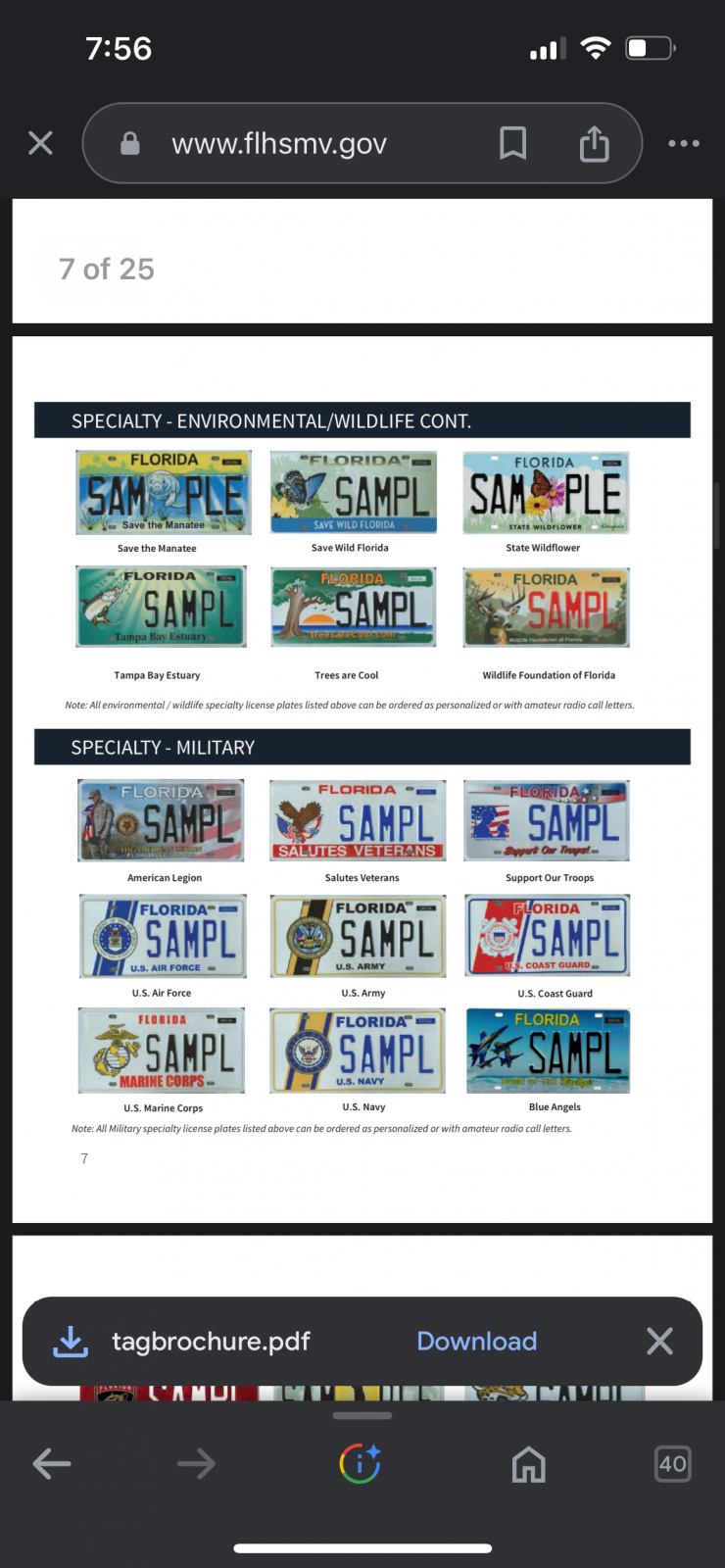

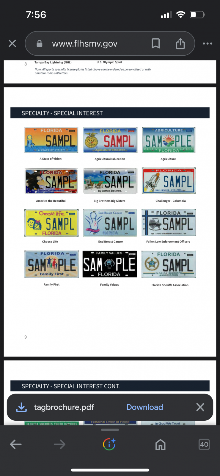

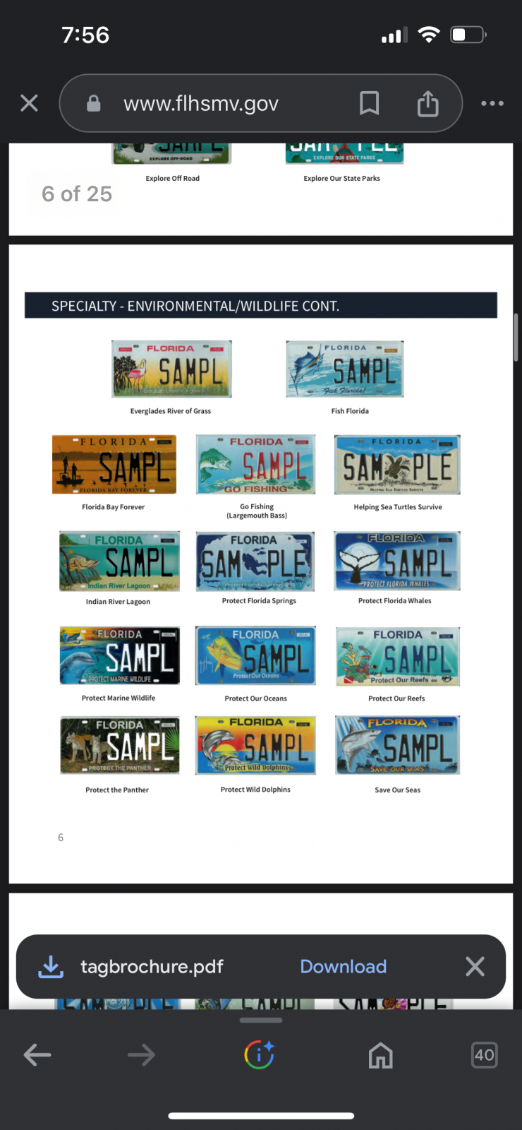

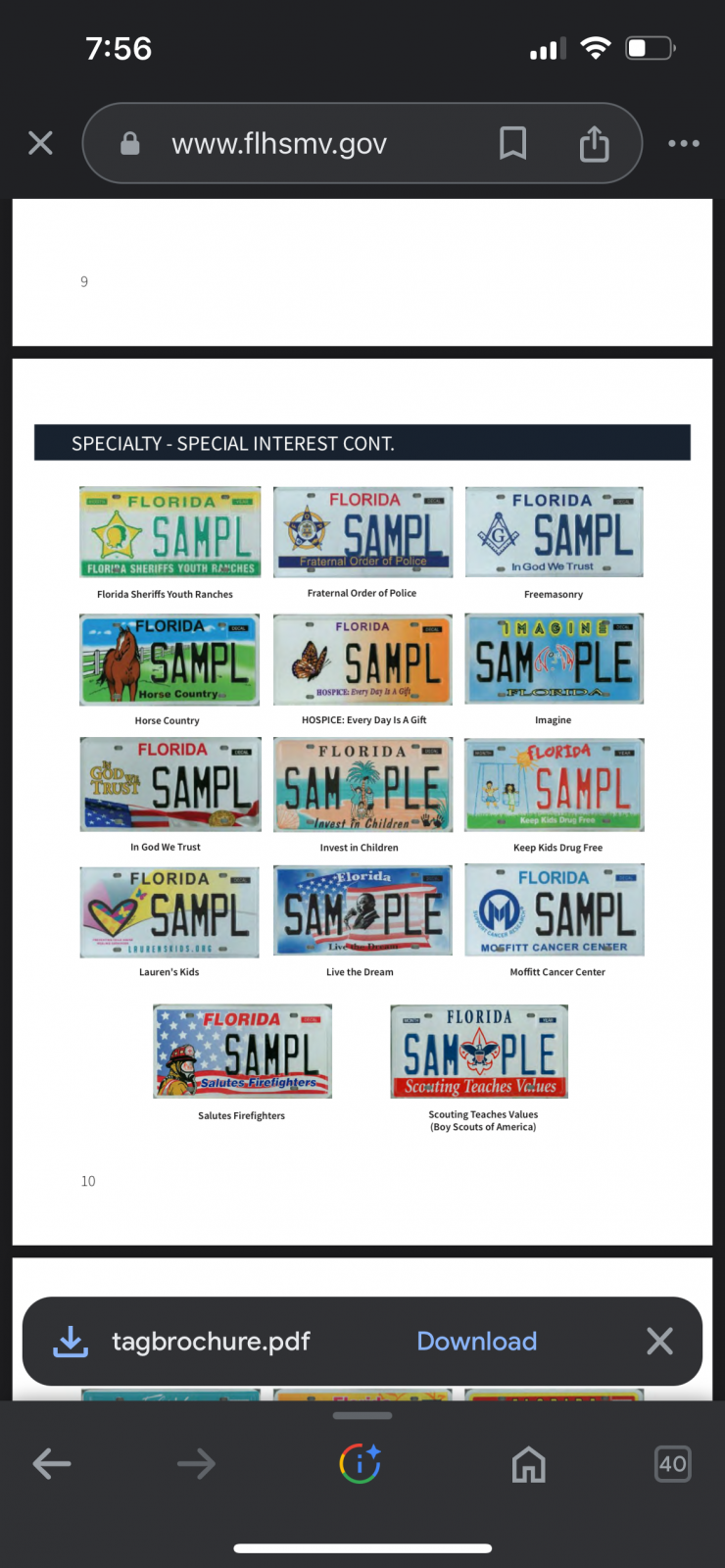

I was actually looking for what plate I should get not the verbiage because the trucks kinda too stock imo for a custom name plate. But I might do like save the cougars or something plate.
There’s so many options in fl it crazy.

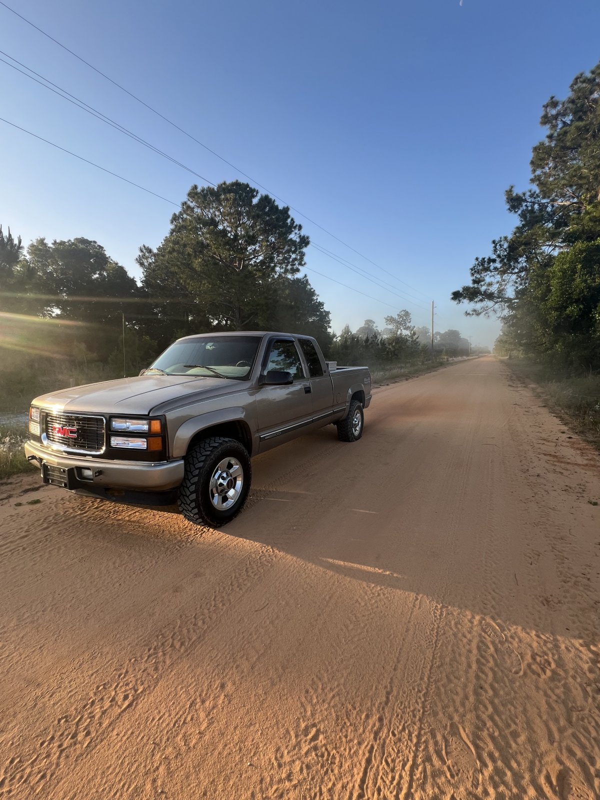

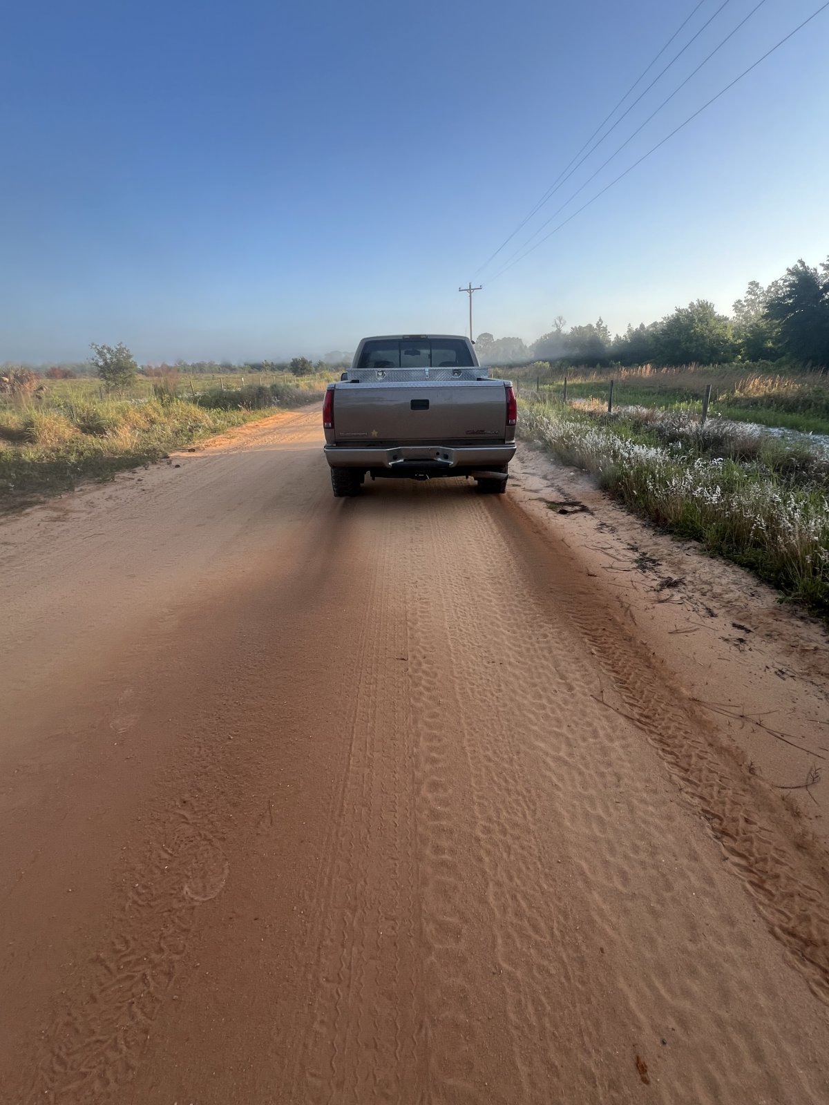

Went down and cleaned my shop up a bit before work and drove the dirt road way in the gmc. I’ve got close to 30miles on it so far with no issues, I think that warrants getting a spare set of keys made.
Anyway decided I’d see how bad this 4l80 first gear is and it impressed me! 1st gear and foot brake and it had no issues activating the g80 and digging two holes. I honestly expected it to just make noise and heat up the torque converter. Especially with half the gas in the tank being 5 years old. The G80 impressed me too, both tires spun from the get go and didn’t let up until I did. Much better than the G80 in my Tahoe which works about as often as people in my generation. (Not often) Makes me slightly less sure about the H2 axle swap I’m scheming.
However somewhere between the hole digging and some rough spots on the dirt road (which I just added to). The interior door handle rod jumped out of its plastic retainer rendering the interior driver handle useless. Guess my rod bending trick wasn’t enough and I’ll have to buy new plastic retainer thingys.

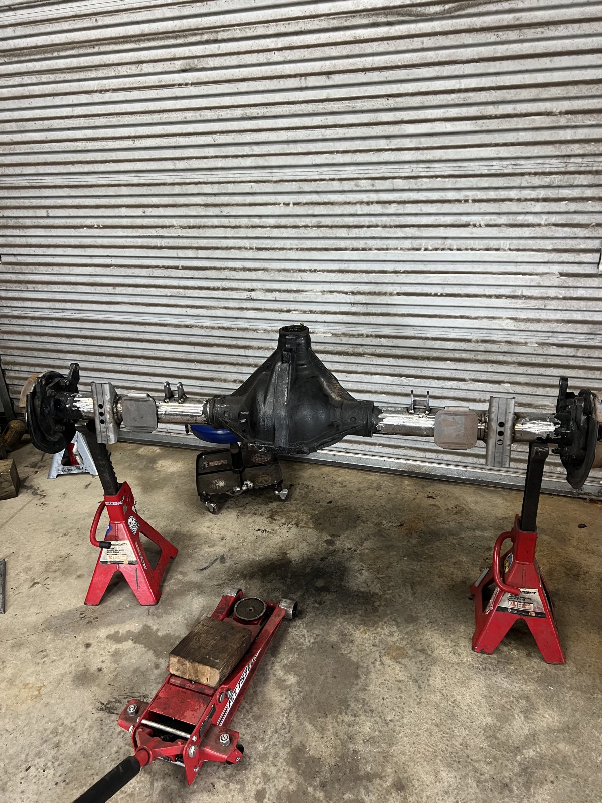

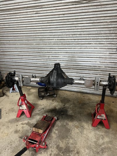

Axle is all welded up, I was originally going to wait until it had been rebuilt and actually weld everything once it was mocked up in the truck. But instead I just took a crap ton of measurements and used my digital angle finder a lot. I think it will work out.

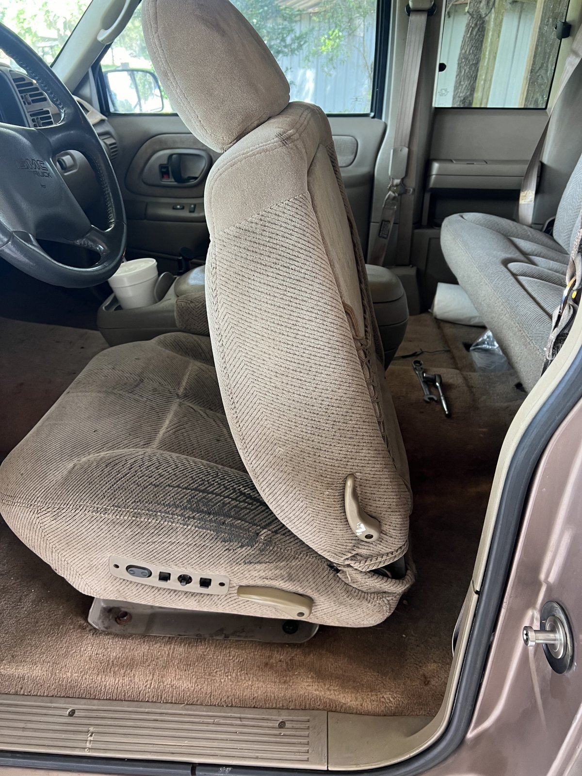

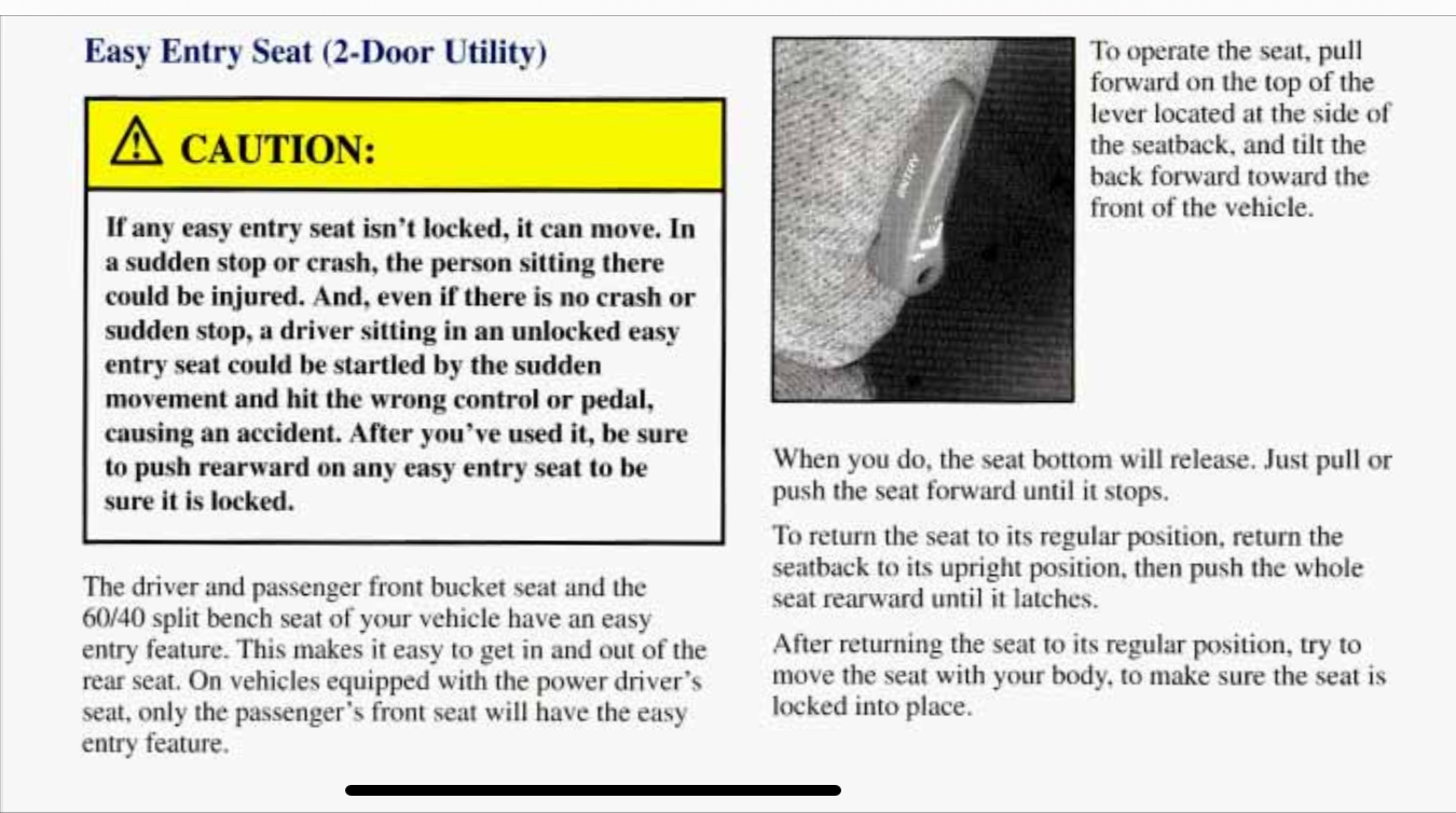

Also maybe one of y’all know, but I’m struggling to find a driver seat that isn’t totally busted, and has the top handle on the side that folds the seat forward and slides its forward to access the back easier. Thing is my current seat only folds forward when that handle is grabbed. I’m not sure if that is just another thing that’s broken with this seat or if that is actually how it’s supposed to work. If all the handle ever does is fold the front forward and not move the base then I can move forward with the nice Tahoe seats I have.
east302
Dec 21, 2016
1,688
1,688
Mississippi
Nope, that’s how it is supposed to work. It’s probably something to do with the power seat base. My 98 truck and Tahoe (both power driver seats) are the same way.
Edit:
From the manual, power seats didn’t have the slide-forward feature like the manual seats.

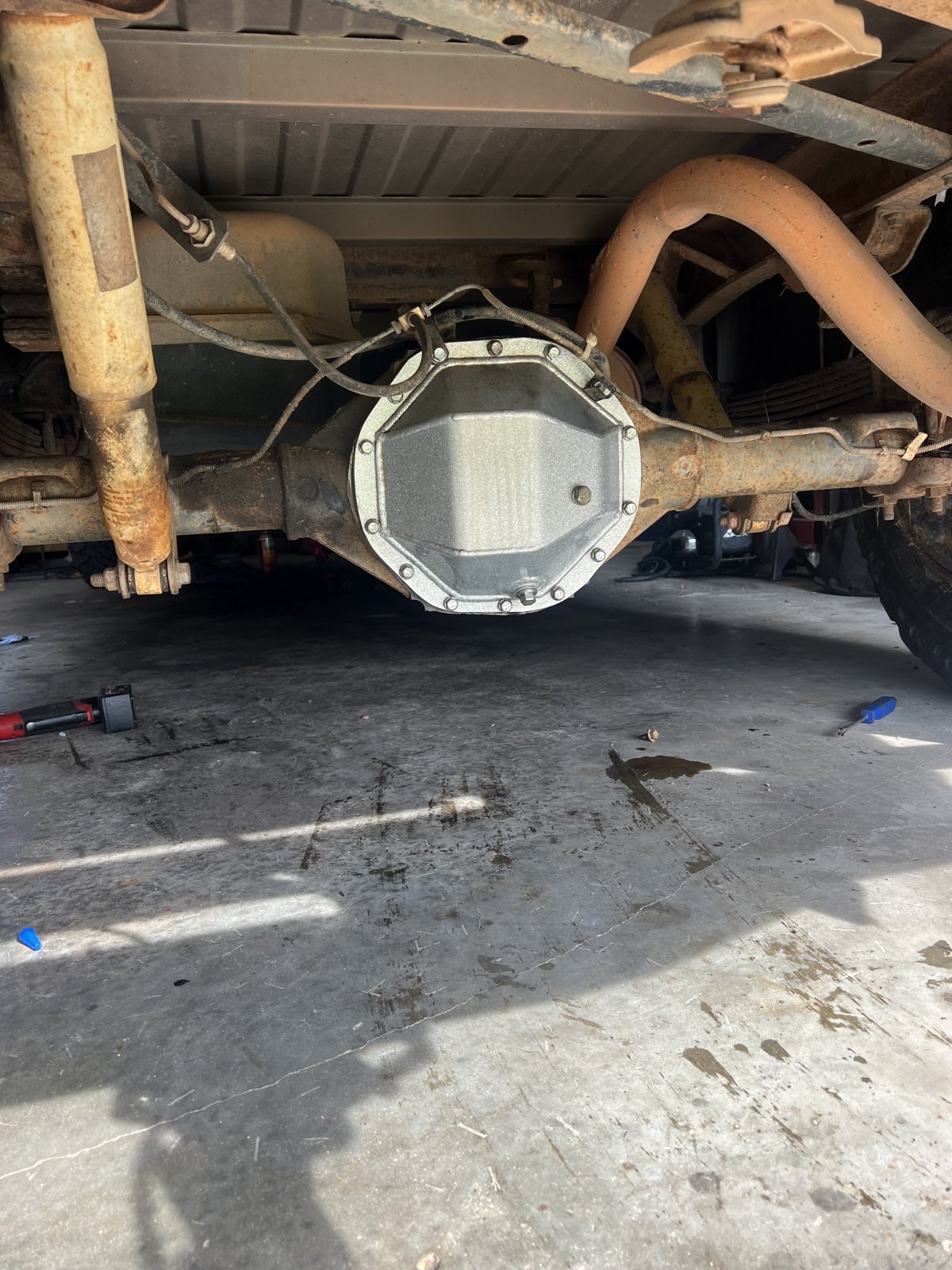

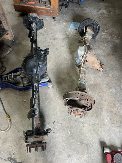

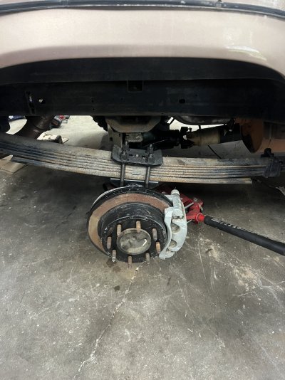

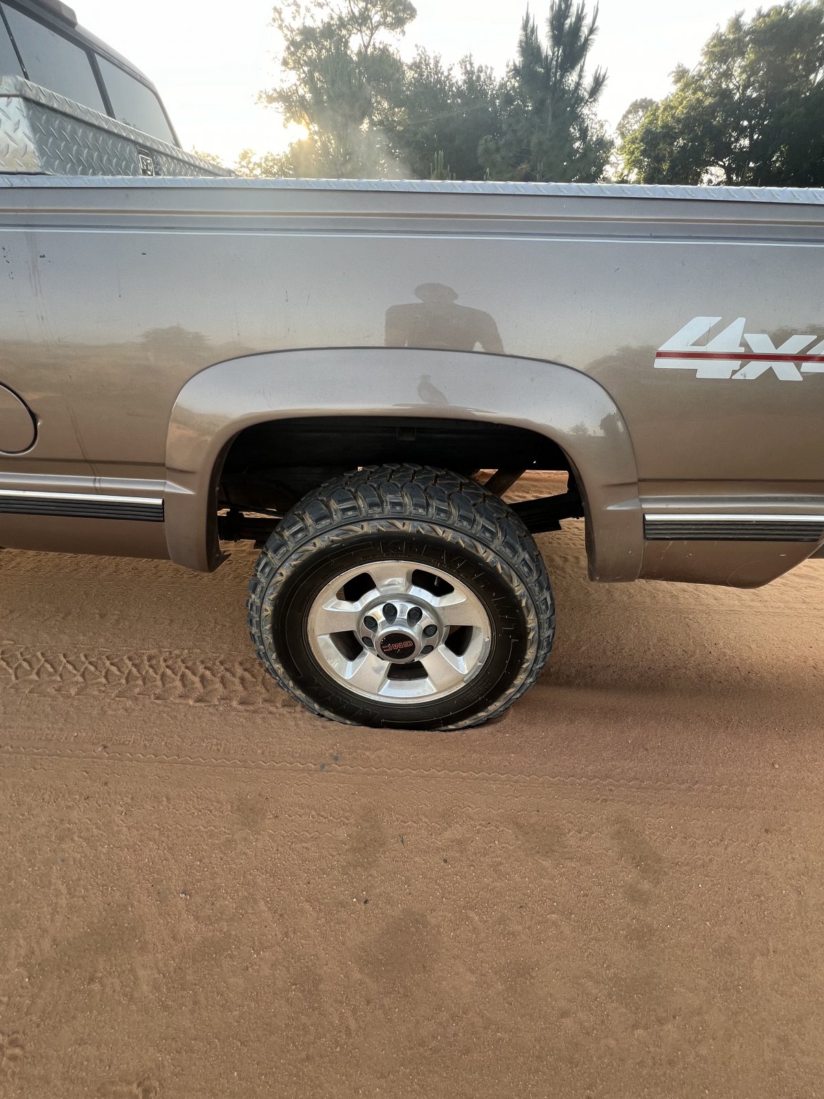

I’m either getting good at axle swaps or this was just an easy one. Took about 3hours to get the old one out, and new one bolted in. It’s not done, still needs, shocks, brake lines, diff fluid, and a shock mount relocated because I’m an idiot and welded them both on the front of the axle.
But pretty happy with the progress and hopefully next weekend it will be moving and stopping under its own power again.

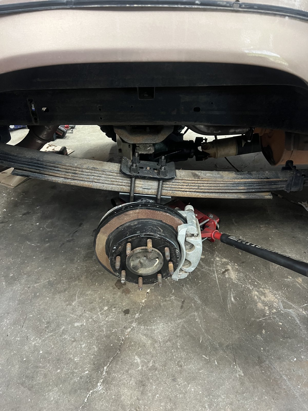

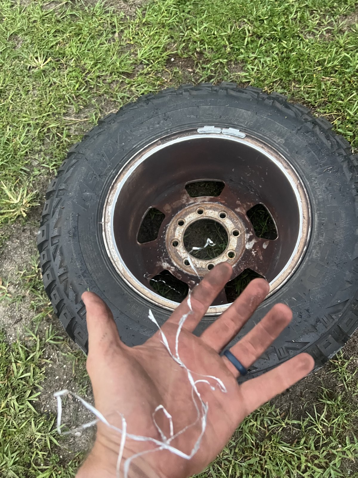

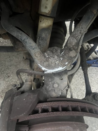

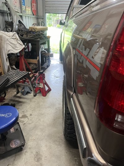

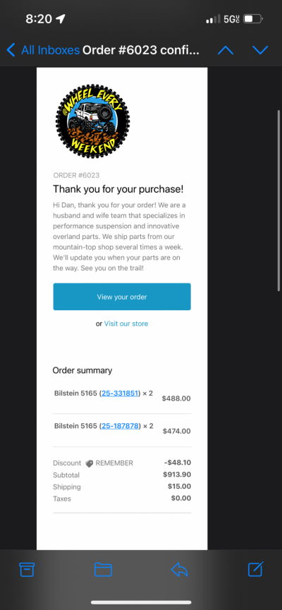

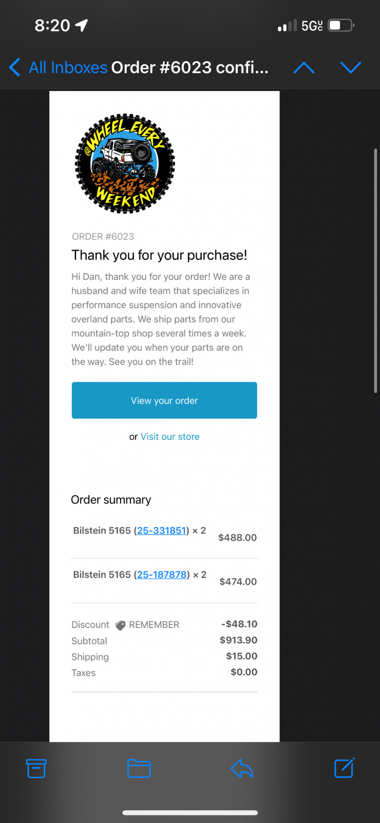

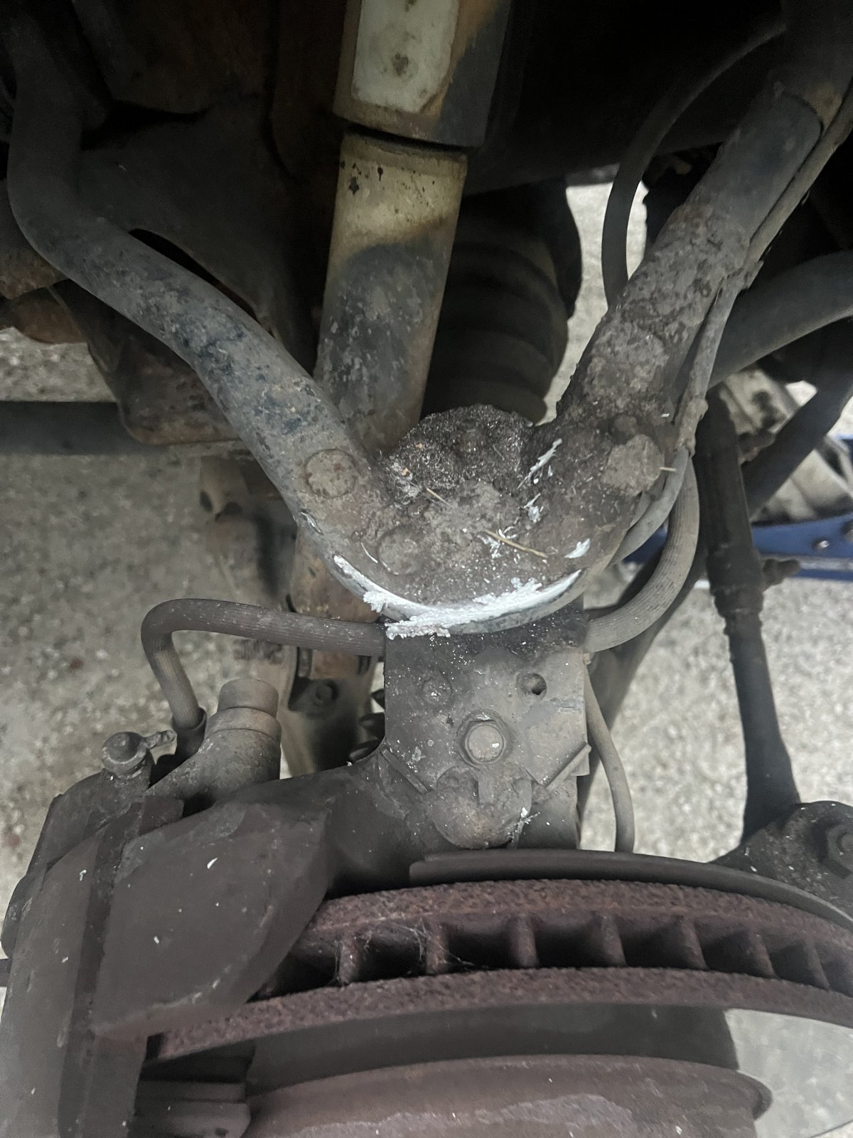

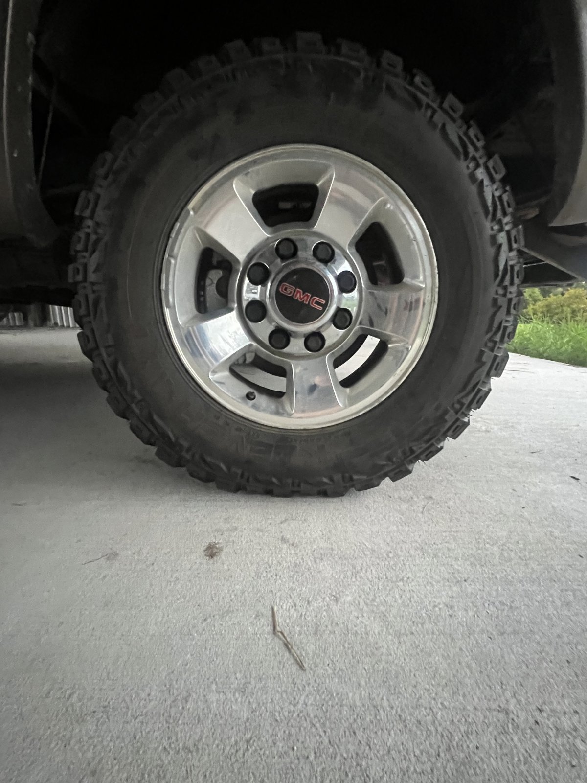

I finally finished this up last week, made brake lines, relocated a shock mount that I welded in the wrong side of the axle, and bled the brakes. The brakes are great, but I’m waiting on shocks to show up. I ordered 5165s from Wheel Every Weekend, which is the same people that specced my rangers 7100s and my goodness those things are amazing.
I did play around with wheel spacers once I got the truck rolling again and realized the H2 axle is about equal width to the front now so it doesn’t need spacers in the back where the old axle needed 3”. Since the back doesn’t need any to match the front I attempted to ditch the front 1.5” spacers and that ended poorly. I didn’t notice it when I bolted the wheels on but apparently the UCA touched the wheel lip and shaved me some pretty aluminum strips. Not major damage was done and I slapped the 1.5” spacers back on for now, I also have a set of 1” but I gotta grind the lug stud tips off for them to fit, not sure it’s worth it.
Anyway after the shocks are in the next priority is alignment which means I might as well do tierods and that means kryptonite.
