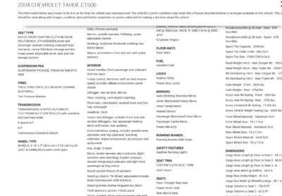

Found a few auction sites, but Iaai and salvagebid seem to be the only two big ones (that aren't just local), and they have the same vehicles..
Iaai is the only place I have seen that has vehicle SPECIFIC options...
Everywhere I have searched online only has generic VIN details..
