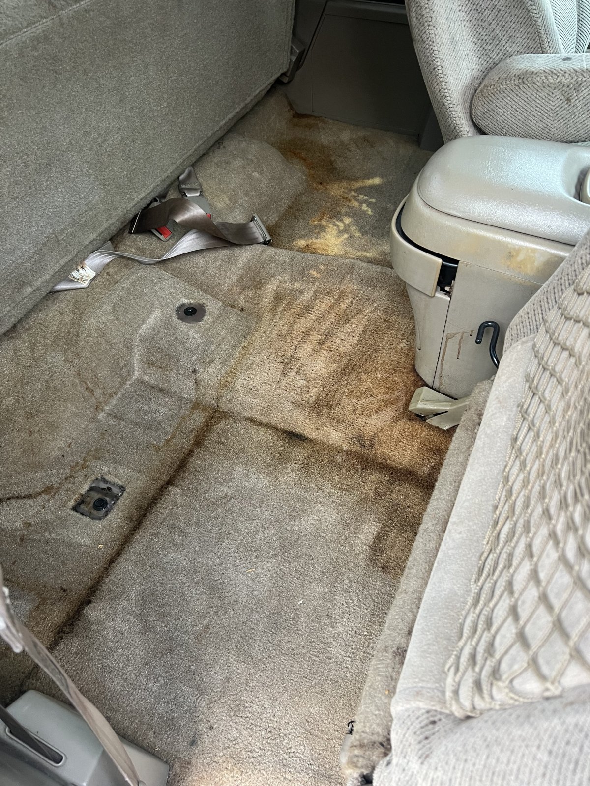

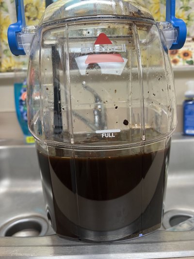

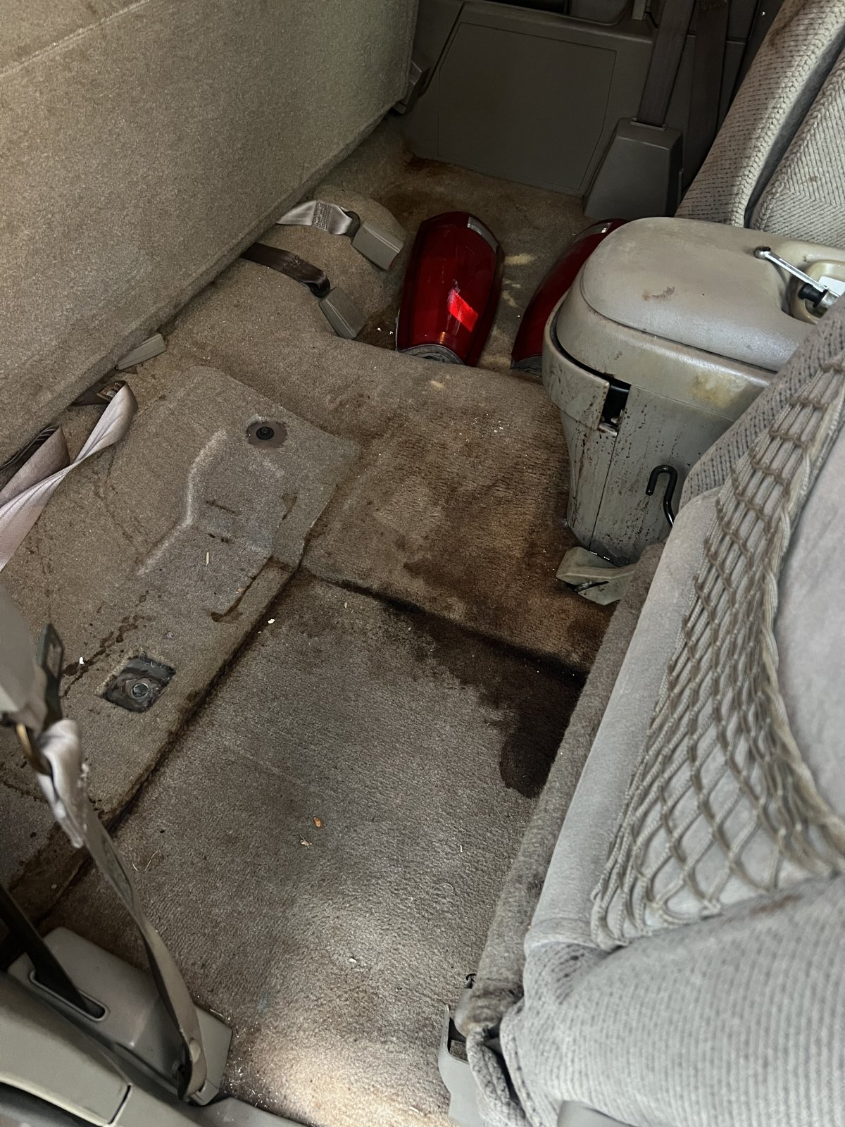

Started cleaning up the interior and found some dark staining, looks like from dark soda probably mixed with alcohol. He was notorious for driving around with a 64oz big gulp full of rum and coke or vodka and lime. Also found two cans of tomato paste, I’ll be sure to drink them in his memory.

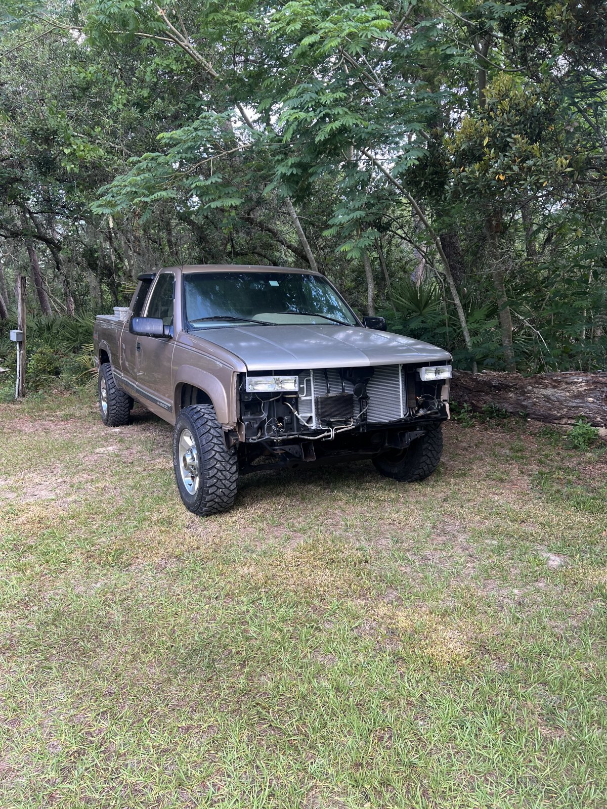

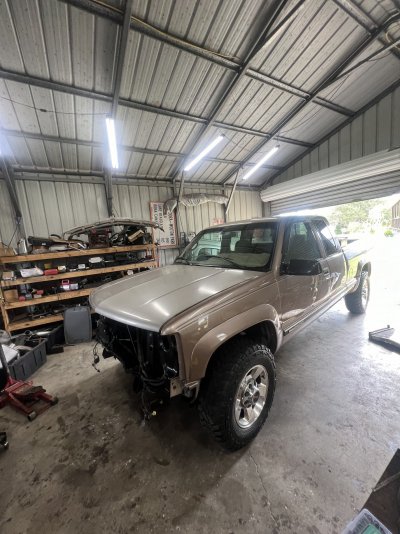

Got the eBay lower shroud in and it’s actually a super nice unit that fits perfect, very happy with that. Had a helper while I tried to bolt the bottom up. Also installed the headlights but still waiting on the grill.

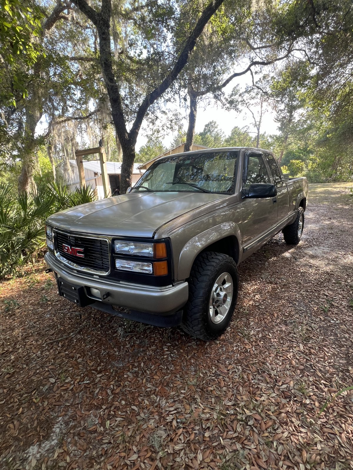

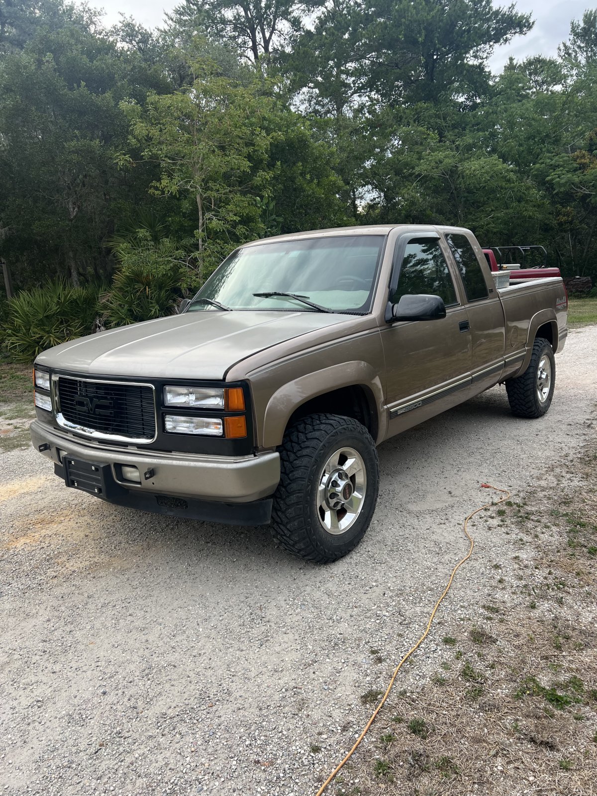

Got my LMC order and got the grill on. Put the temporary bumper on but only with a few half tight bolts because I’m missing two brackets and need a floor jack to help tweak a few things into place better. Also got my mini carpet shampooer and it kicks butt! Gonna pull the interior tomorrow and spend a few more hours sucking out the yuck.

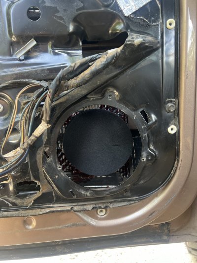

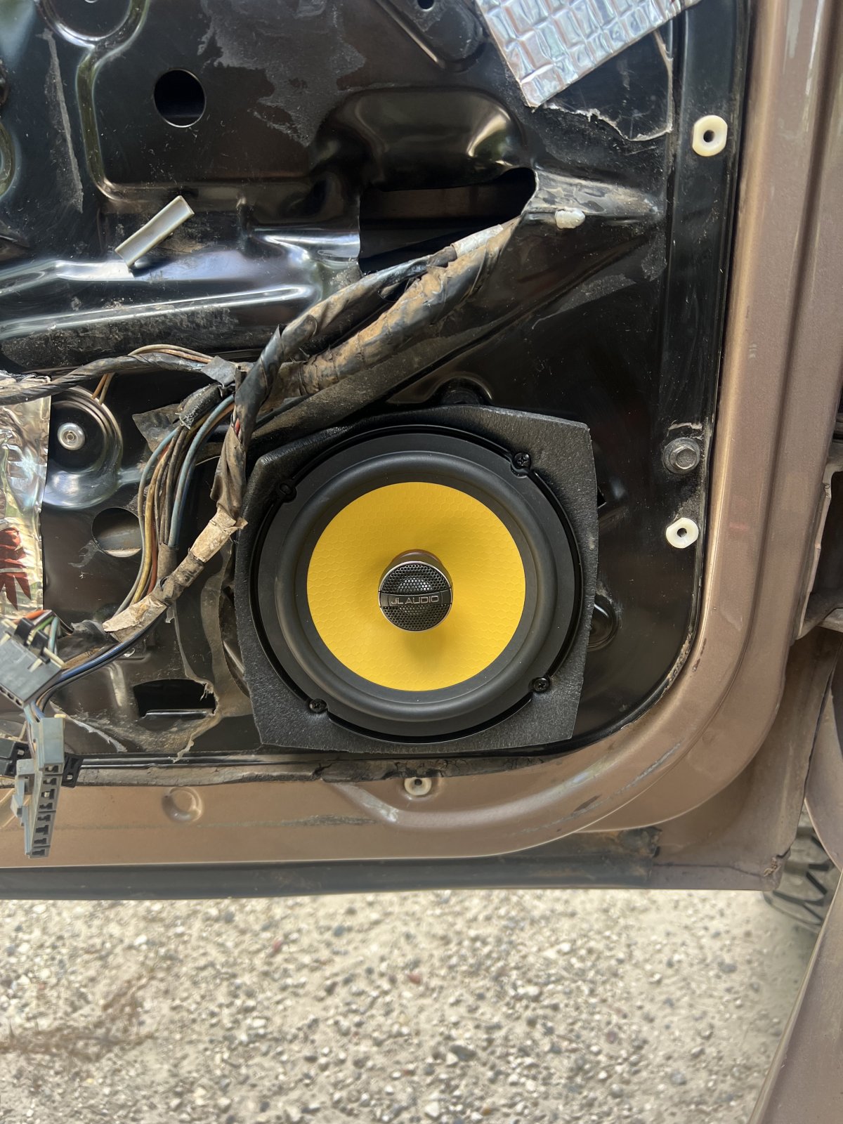

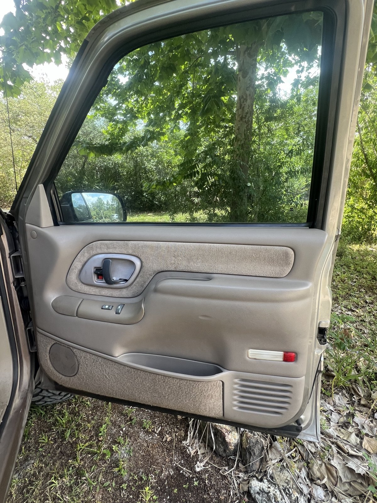

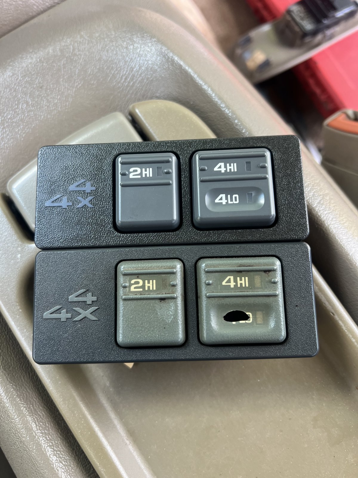

Made a tad more progress. Got the doors finished up with new handles on the outside, sound deadener on the inside, new JL Audio C1s, and slapped the panels back on after a good scrubbing. Also swapped out the 4x4 selector and the HVAC control panel as they were both pretty busted. Lastly the GMC logo came for the grill and my want to daily this thing has intensified.
Also looking for suggestions for a front license plate, as well as what custom Florida tag I should put on the back.
