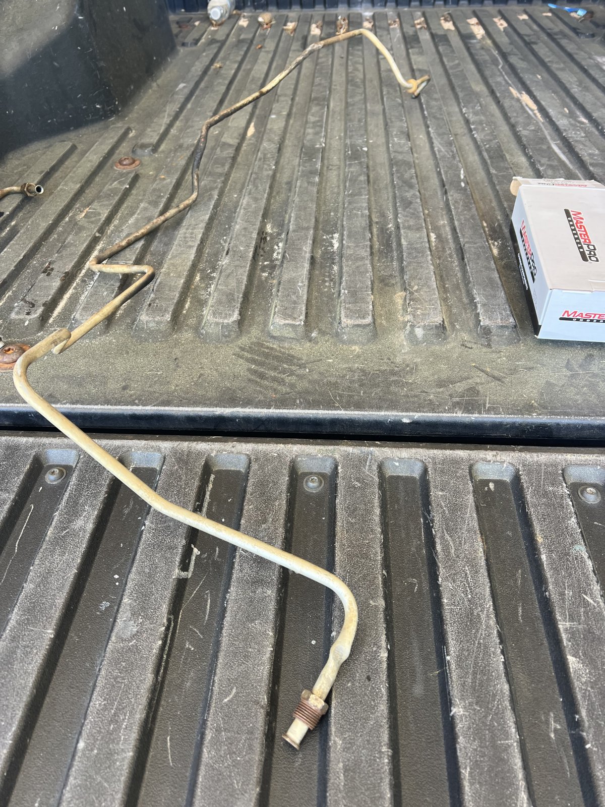

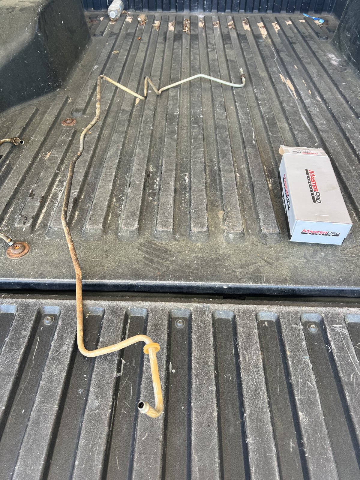

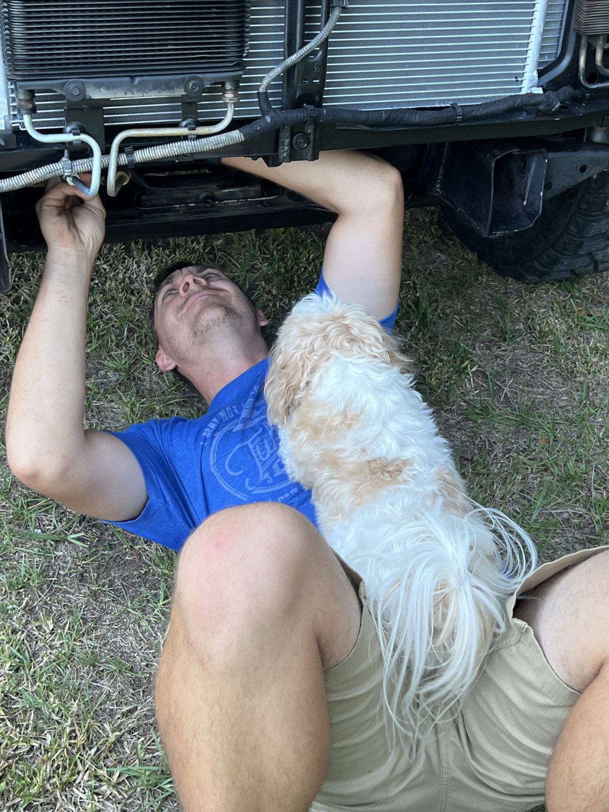

Having trouble locating the correct trans cooler line, anyone think they can help? I have the other two lines but the one I’m missing and nobody seems to even list is pictured in the top of the photo with three lines. It’s a solid hardline, no rubber at all. I would reuse the one I have but it is severely twisted on one end.

So your transmission is the early 4L80e with cooler lines near the bellhousing (side-by-side)... however:
The transmission I swapped into my 99 Silverado was also the early style like yours, and the coolers actually both fit into the the transmission with just a tiny bend by hand.
What implying is that line may actually work on either transmission (?)
Maybe if it's just hardline, you can just source another one from the wrecking yard.

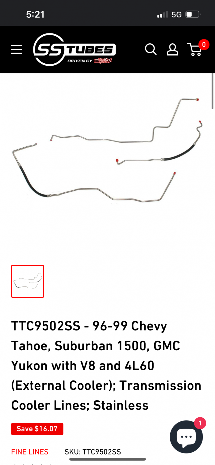

Uhg no kill me before I have to go scrap yard digging for something this hard to get to. Did the early 60es also have that line configuration?
I have and I only see what I think is it in a 3 line kit and listed as for a 4l60e. Which is suss to me
I would call them.

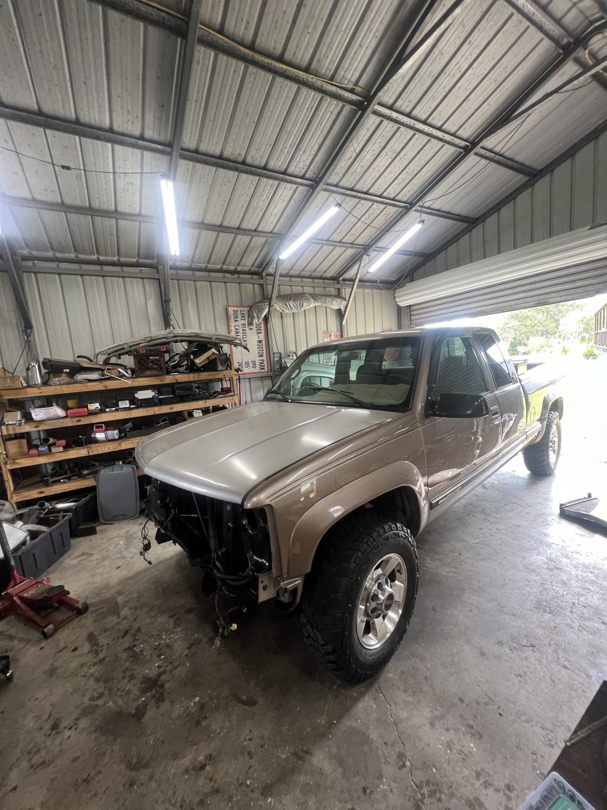

Made a bunch of progress today.
-Installed the oil cooler adapter with new seals.
-Installed oil cooler lines into adapter.
-Added new oil and oil filter.

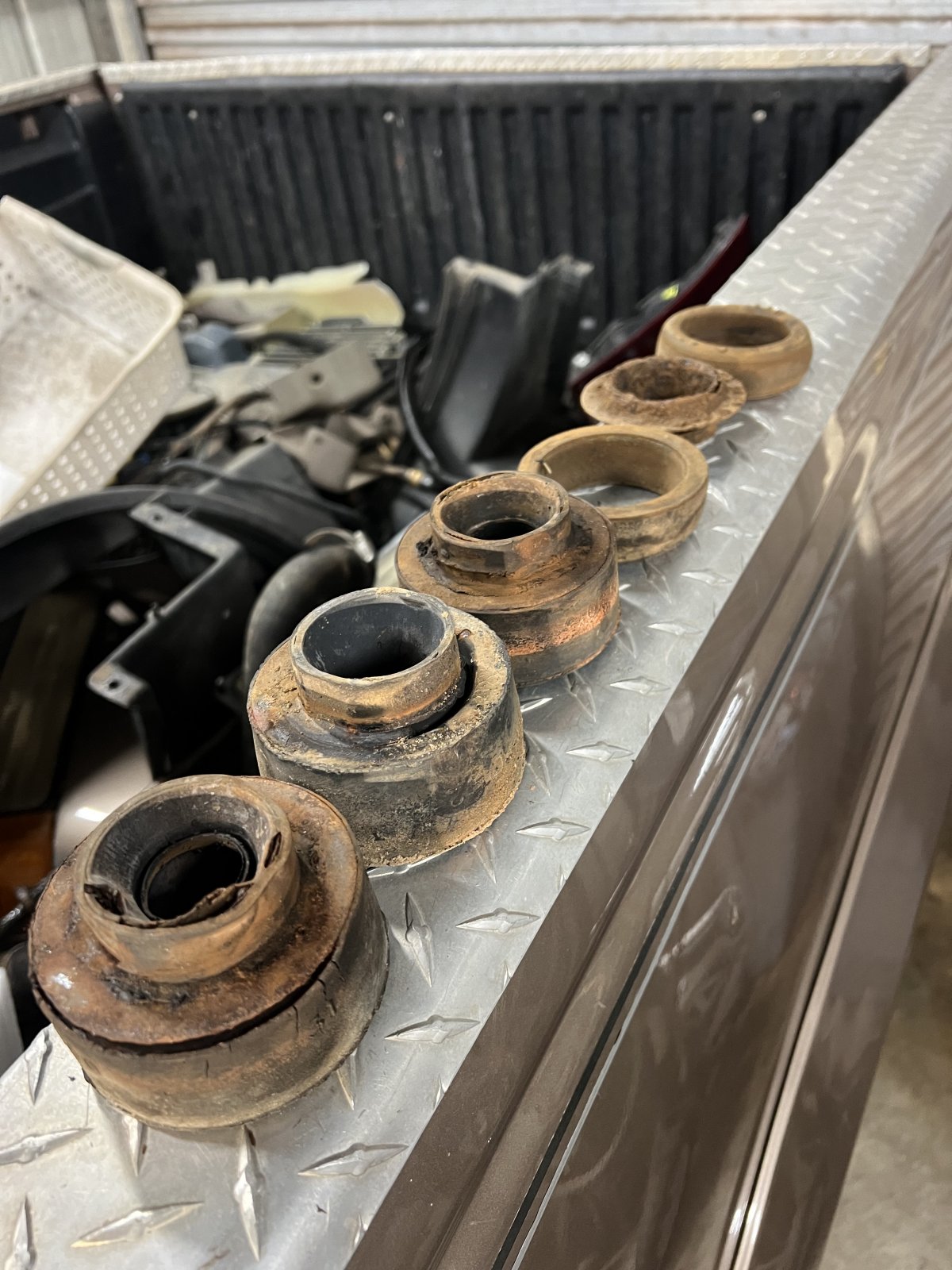

-Removed 2” spacers from up front and replaced them with 1.5” making the front to rear width almost perfectly even having 3”in rear.
-Mounted core support and reinstalled all fender and fender liner bolts.
-Routed main light harness through core support and cleaned up more wire sheathing.
-Routed PS cooler lines and mounted PS cooler.
-Hooked up battery to see if truck was going to freak out and it didn’t seem to.
I feel like I did more but I forgot.

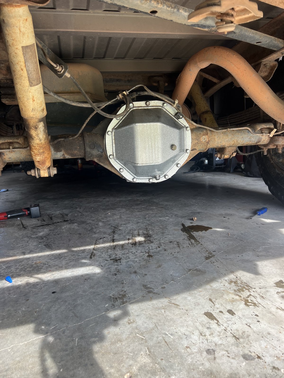

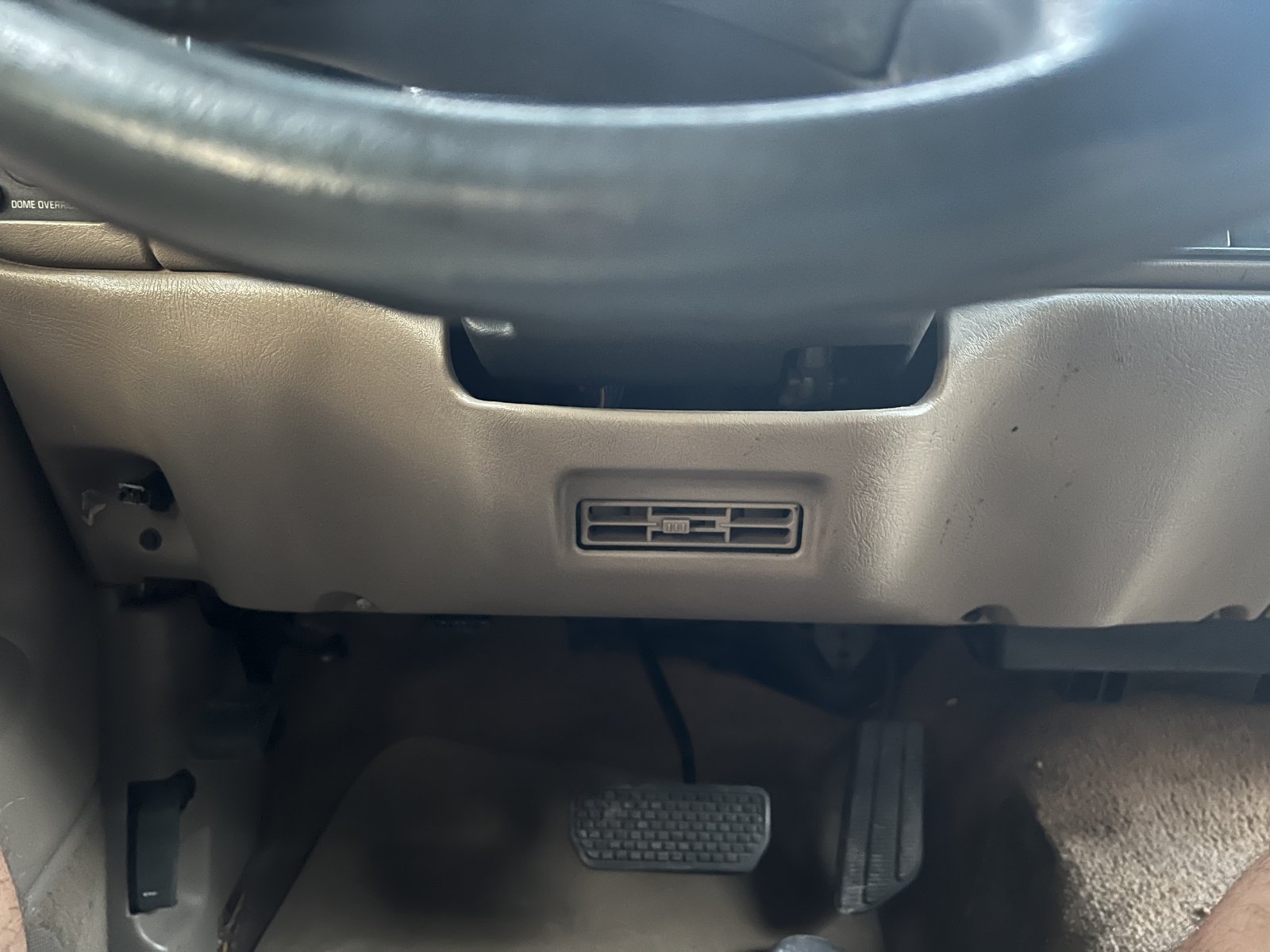

A couple more things I’ve found.
-brake lights don’t work at all, not turn signals or reverse lights ether. I already installed an aftermarket replacement set maybe they don’t work with it for some reason. Will swap stocks back in.

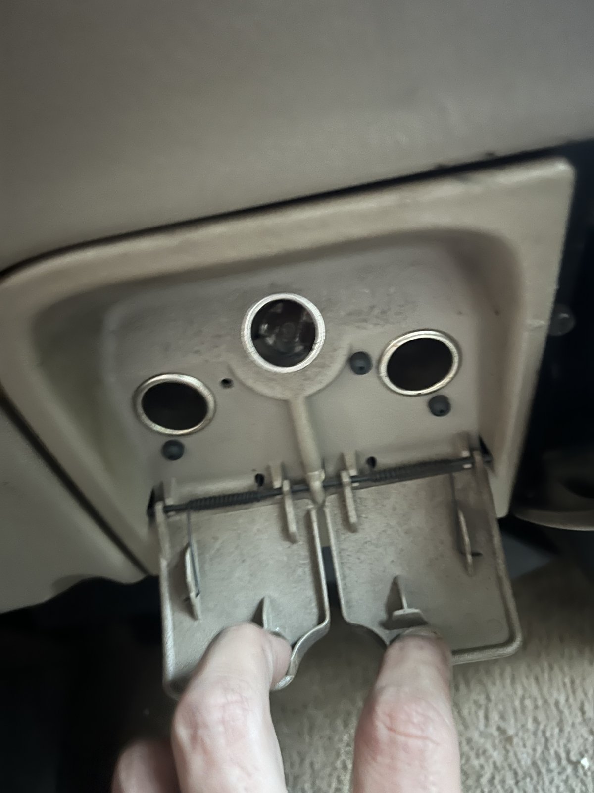

-has ball cooler vent very cash money
-has three cigarettes lighter ports so I can chain smoke more effectively
-has cool work light that you can unspool and take with you around the engine compartment.
-Needs brake help, master cylinder was almost empty when I got it, I topped it off and the brakes do work, but not well. Not sure if I’m gonna H2 axle swap it to fix the drum brake problem. Or if the fronts need help, I did check pads and rotors up front they seem fine.
-Extended cab window brackets are all busted, window appears to be held in with tape.
-Need bulbs for passenger side turn signals, they broke when trying to remove them.

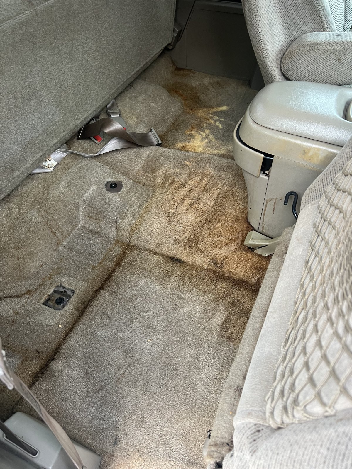

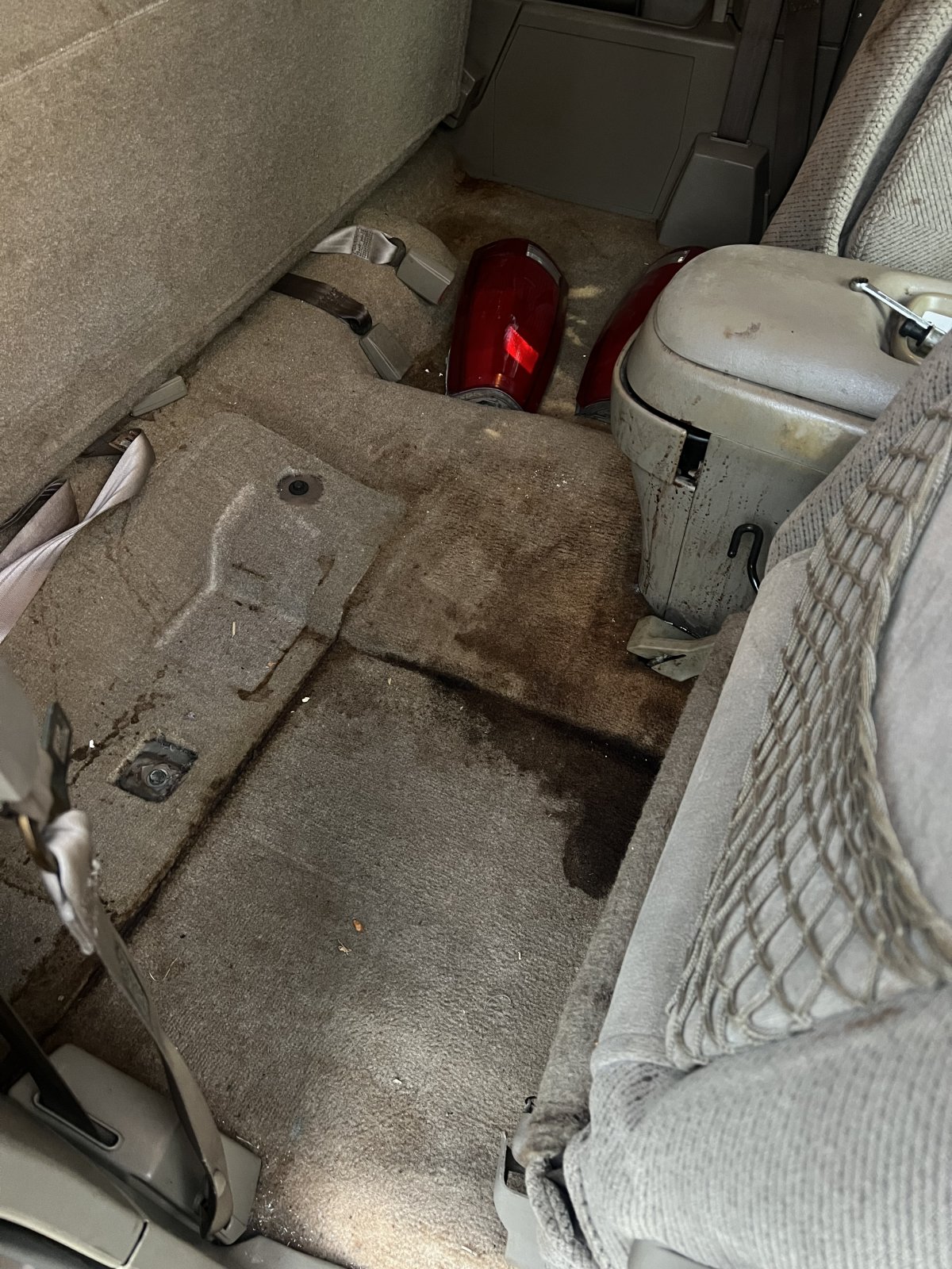

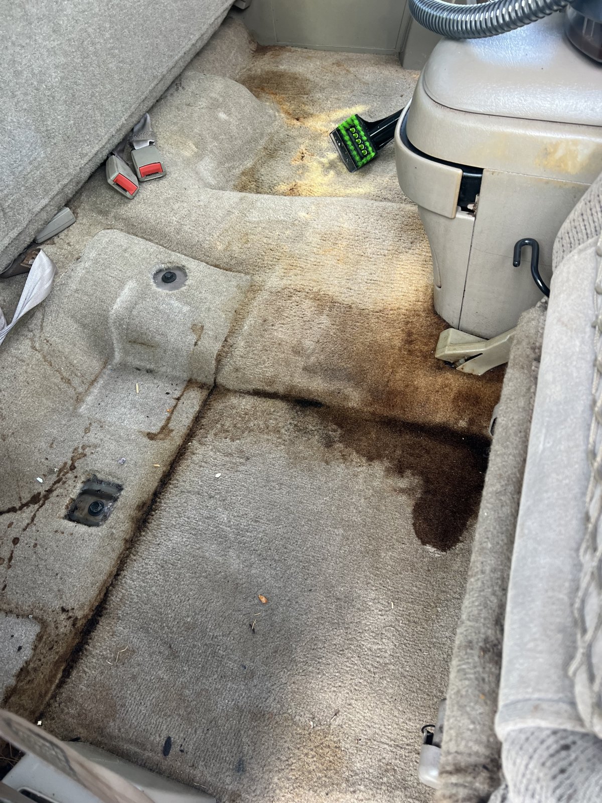

Started cleaning up the interior and found some dark staining, looks like from dark soda probably mixed with alcohol. He was notorious for driving around with a 64oz big gulp full of rum and coke or vodka and lime. Also found two cans of tomato paste, I’ll be sure to drink them in his memory.
Got the eBay lower shroud in and it’s actually a super nice unit that fits perfect, very happy with that. Had a helper while I tried to bolt the bottom up. Also installed the headlights but still waiting on the grill.

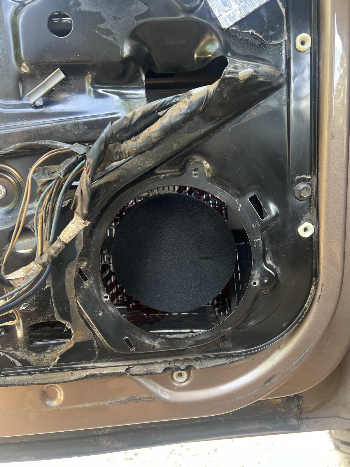

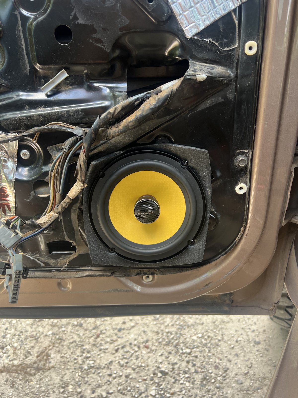

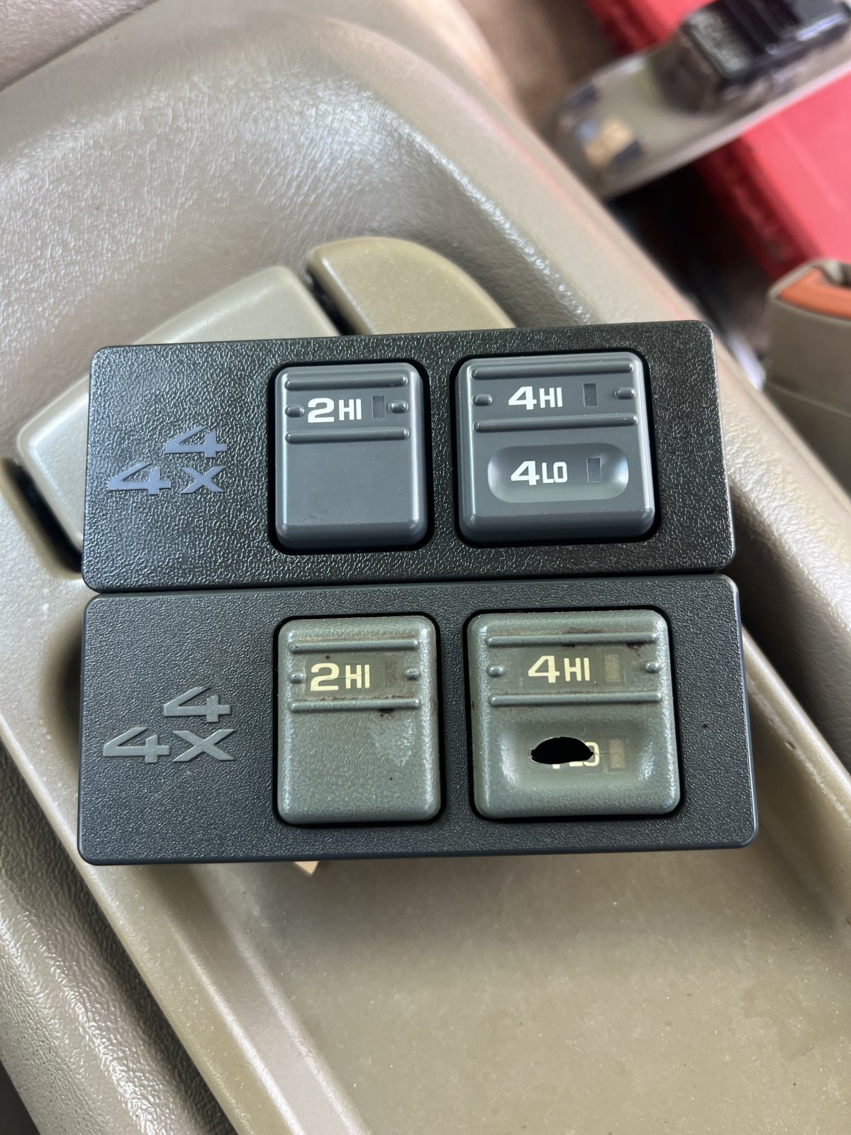

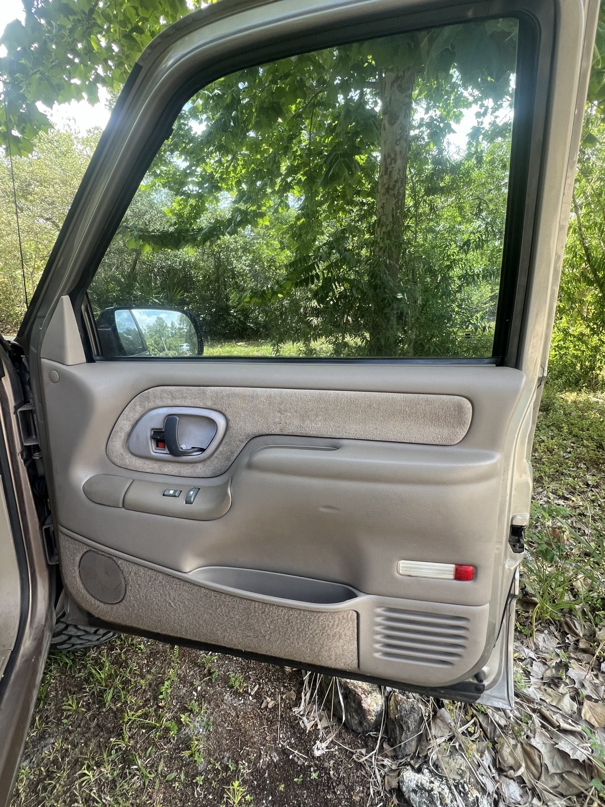

Made a tad more progress. Got the doors finished up with new handles on the outside, sound deadener on the inside, new JL Audio C1s, and slapped the panels back on after a good scrubbing. Also swapped out the 4x4 selector and the HVAC control panel as they were both pretty busted. Lastly the GMC logo came for the grill and my want to daily this thing has intensified.
