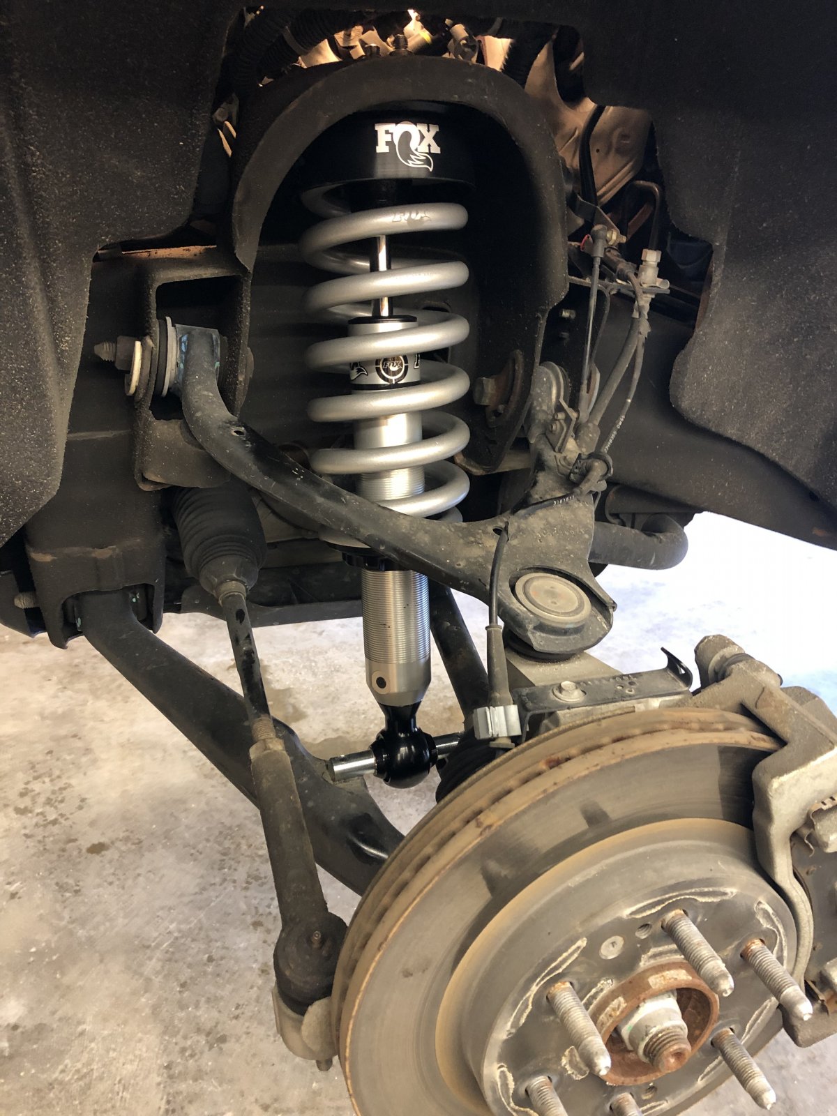

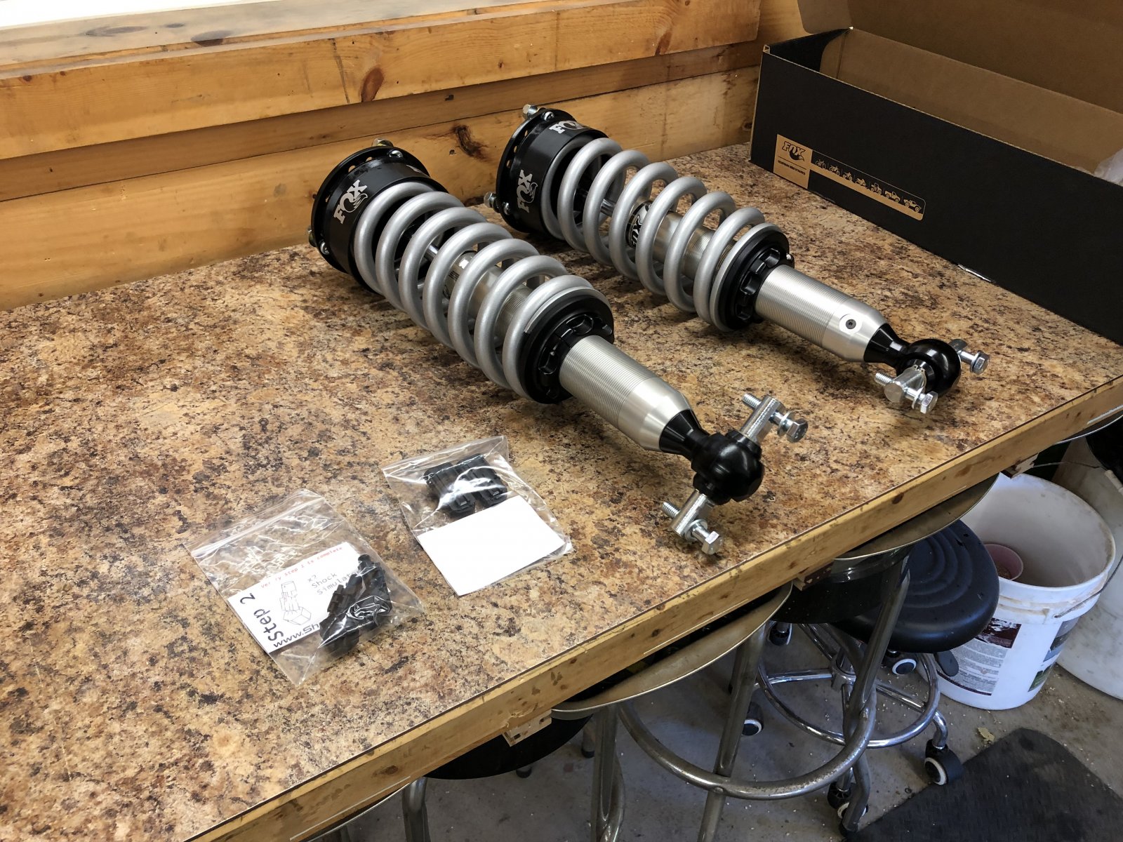

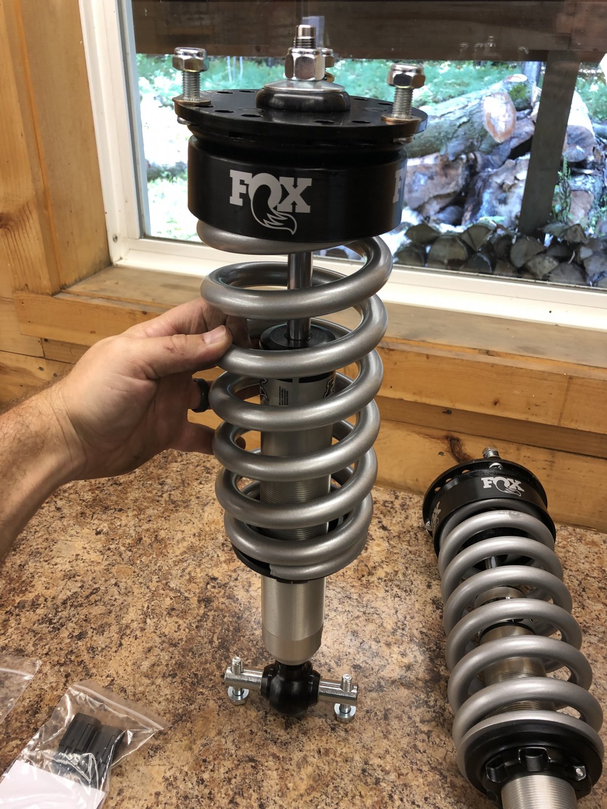

Just installed these yesterday. Fox claims they are adjustable between 0-2” of lift. I had no clue where they were set at from the factory, so I just installed them where they were pre set. Well, it gained just under 2” of height, OVER the 1.5” leveling kit I already had on it. Too damn much, so I will have to adjust them down. I would like to get back to 1.5-2” over the factory height. That was perfect for the stock wheels/tires IMO.

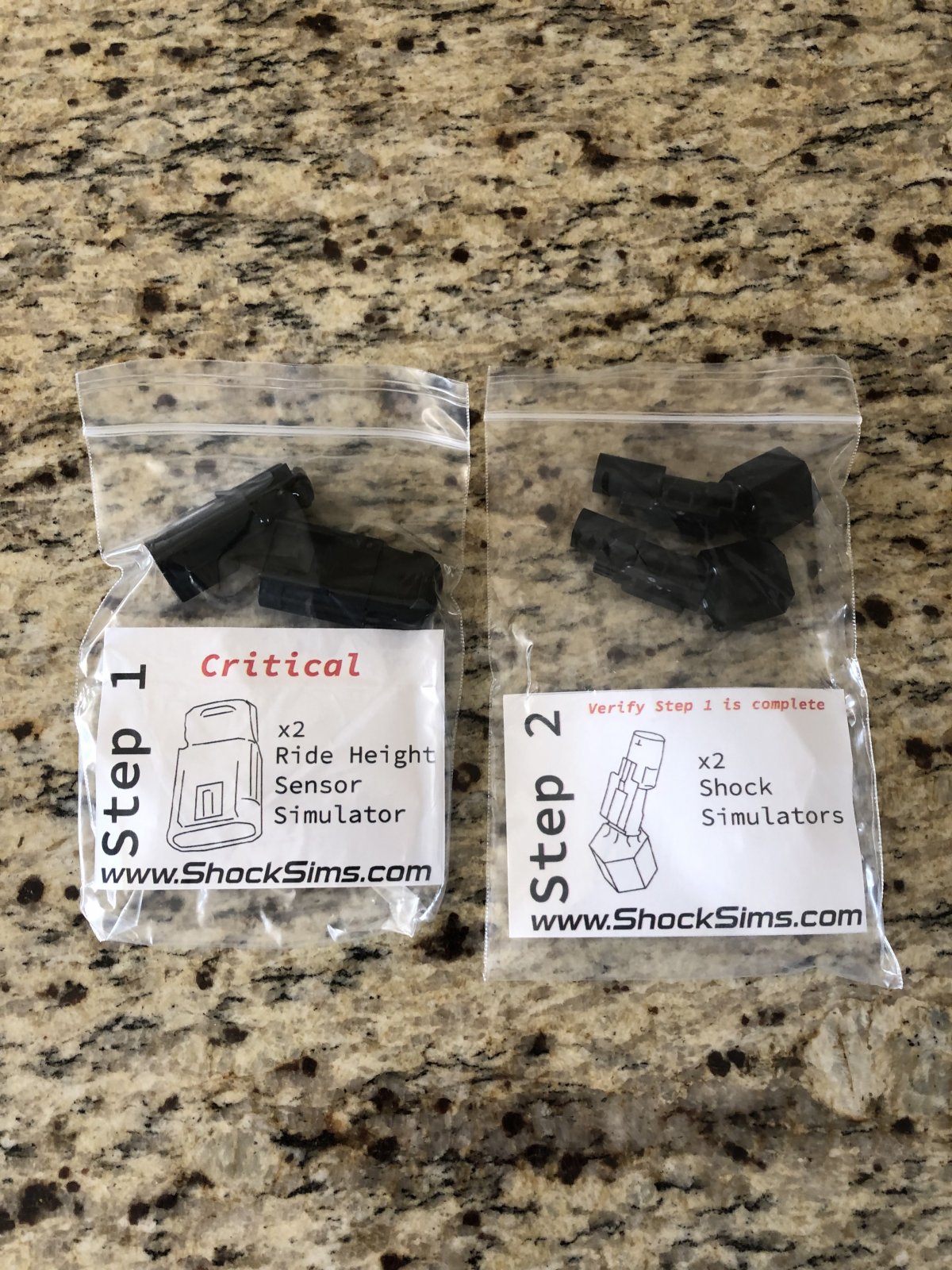

The magnaride delete kit worked flawless. Unplug the factory wiring and plug the little plastic buggers in. Its that easy. Had no codes or anything come up. They seem pricey for what they are, but you dont have a choice I guess. And I know a lot of work went into making them.

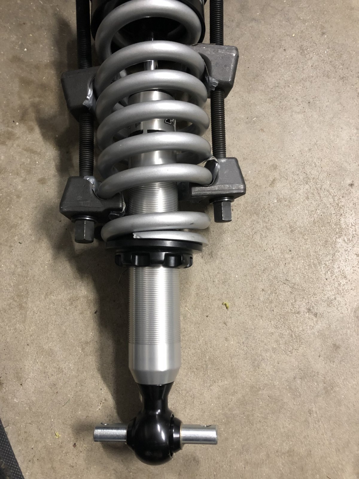

Hi,
This is the same exact setup i am planning on installing. With the front Fox coilovers, do you have to remove them from the car to adjust the height?

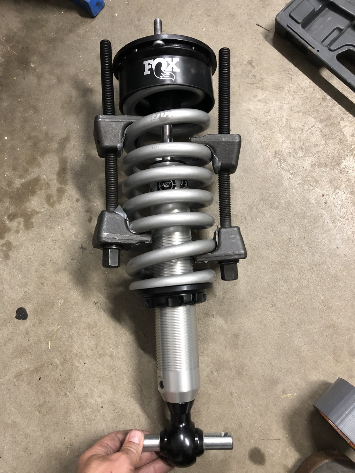

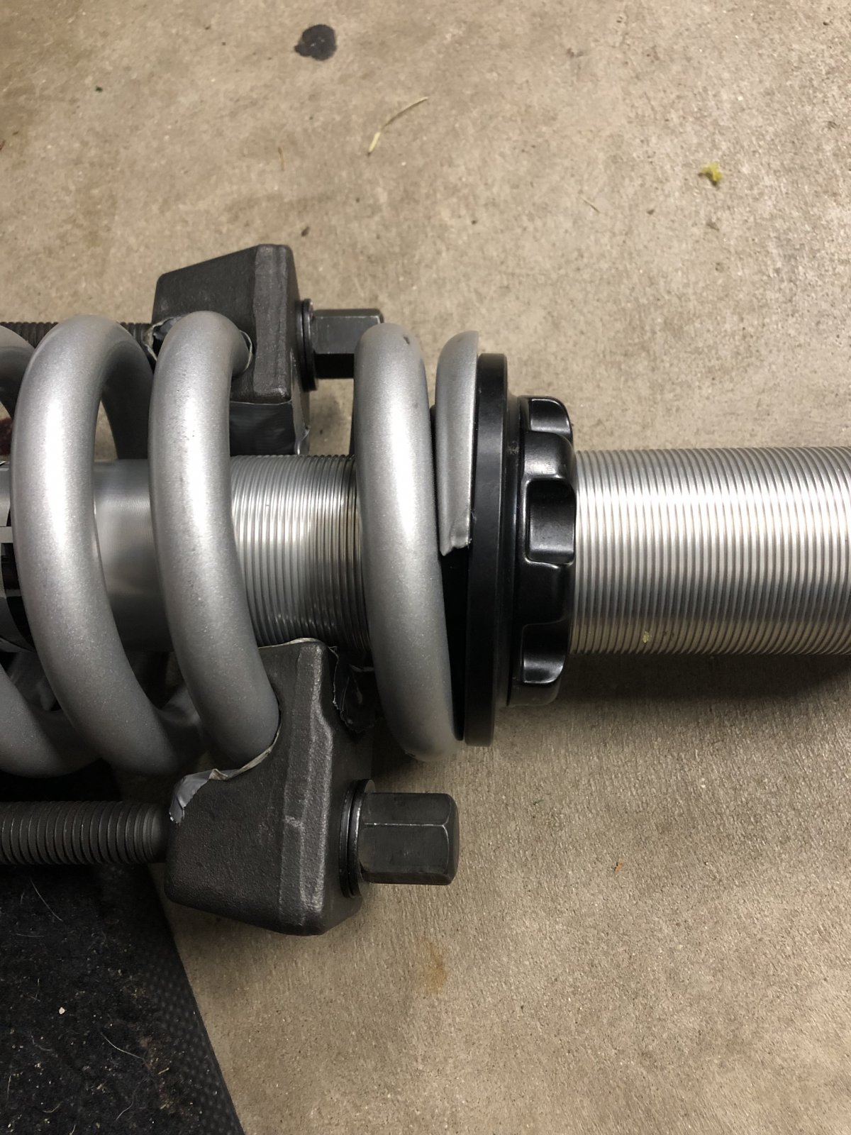

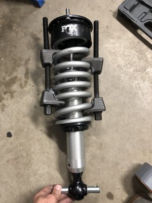

Well, I just walked in the door from checking on this, as I still need to get them adjusted down a few inches. As far as I know, the answer is YES.
I rented a coil compressor tool from the auto parts store today, which does actual fit in between the coils, however there is simply no room to use it while the coilovers are on the vehicle. My plan was to take the tension off the coils and then try to twist the adjustment “nut” by hand. But again, I will need to remove them.
My other thought was to purchase the Fox adjustment wrench for these units (which is much different then a typical spanner wrench). I found it on line for a measly $7... why the living hell they dont come with the wrench is beyond me. However, it is my understanding that even with the wrench all the tension should be off them, otherwise it could damage the threads. So, yep, gonna have to remove them even with the wrench.
Ugh. Then to top it off, once you remove them and adjust them, it is basically a trial and error thing to get the desired height. This could be quite a time consuming process.

Yes, I too wish they would come preset at a desired height. Im going through hell right now trying to get them lowered down. Took one back out tonight so I could get the spring compressors on there. Once I got the spring compressed down I loosened up the pinch screw so I could spin the nut down... and thats when I realized the nut was cross threaded! How the fawk that happened I do not know, but its all screwed up now. SUCKS.

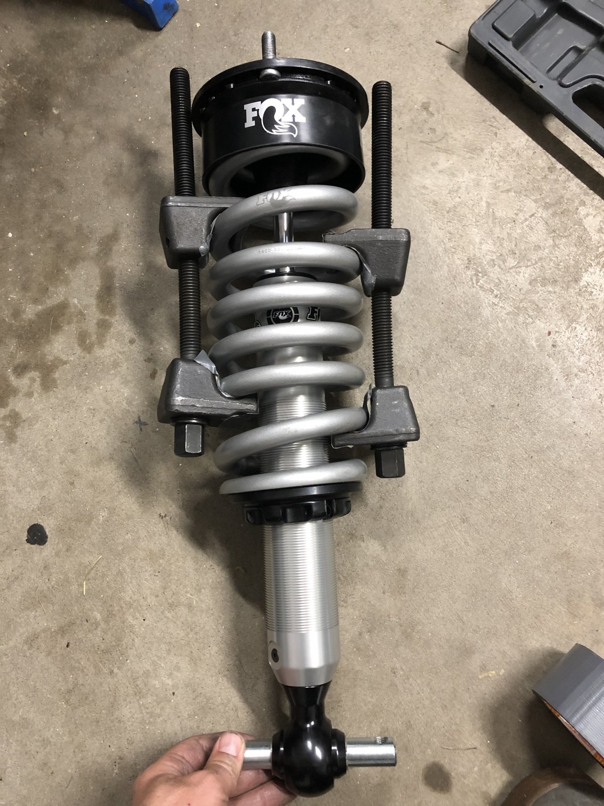

Overall what is the exact height from top to bottom of the new fox struts compared to your stock struts that you took out?
I didnt take an exact measurement, but it wasnt a whole lot more than the added height from the leveling spacer.

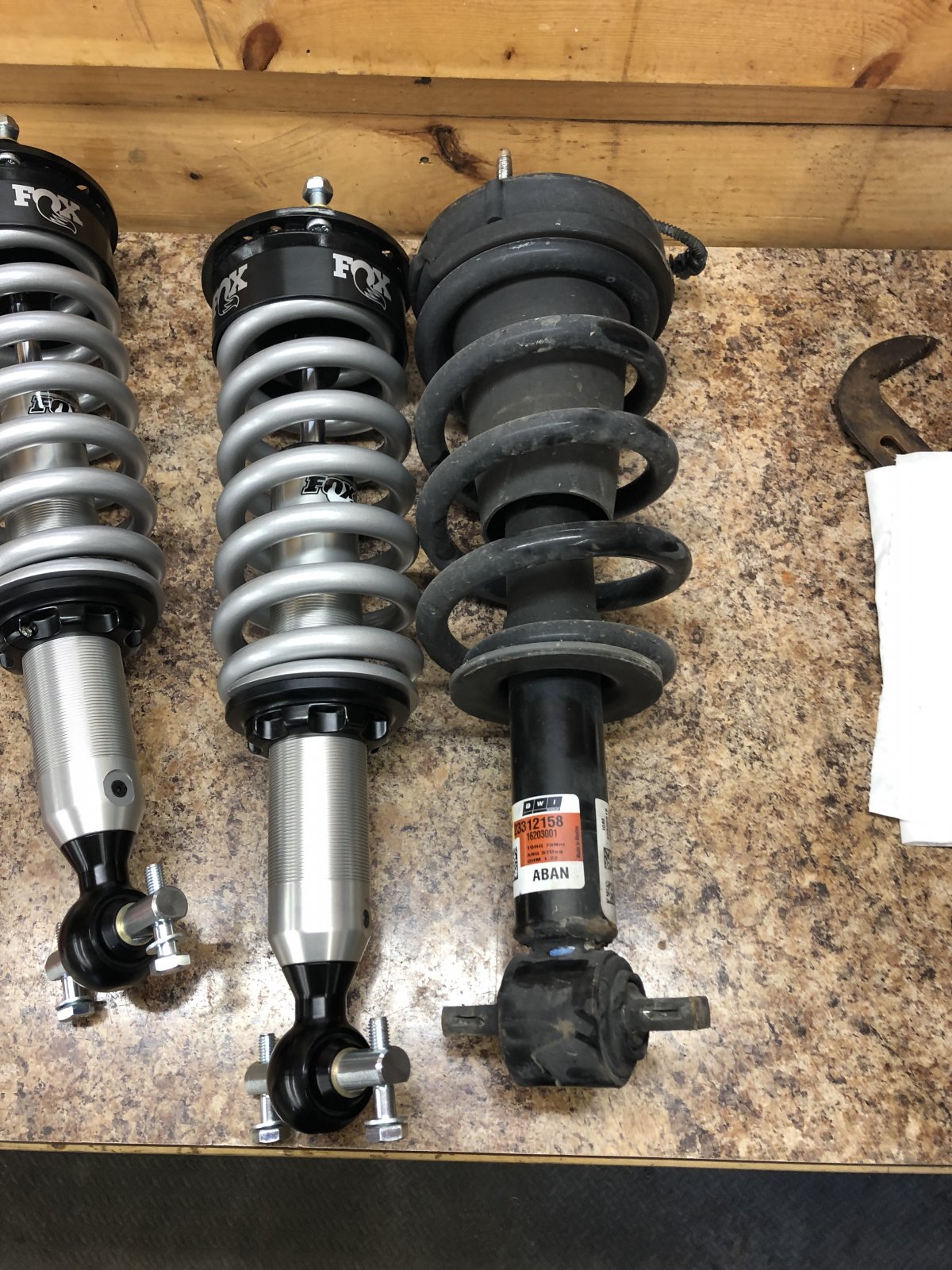

Here is a pic of one next to the drivers side unit (the tops are lined up). Of course the passenger side one was several inches shorter (it was the one leaking and blown out)...

Im in a bit of a pickle here because I obviously screwed up one of the attempting to adjust them down.
We used a wall mounted strut compressor when adjusting the ride level on the Fox 2.0's.
I'm not sure you can do the job correctly on the Fox shocks without it. The wall mounted unit compresses the spring so much that all you do is just adjust the shock via the threads, seriously the shock becomes very accessible.
I marked the original +2" preset thread and then started working from there.
Here's a video that shows the type of spring compressor I'm talking about:

Well, yea I thought that was basically what I was gonna do but using the cheap parts store spring compressor. WRONG.
