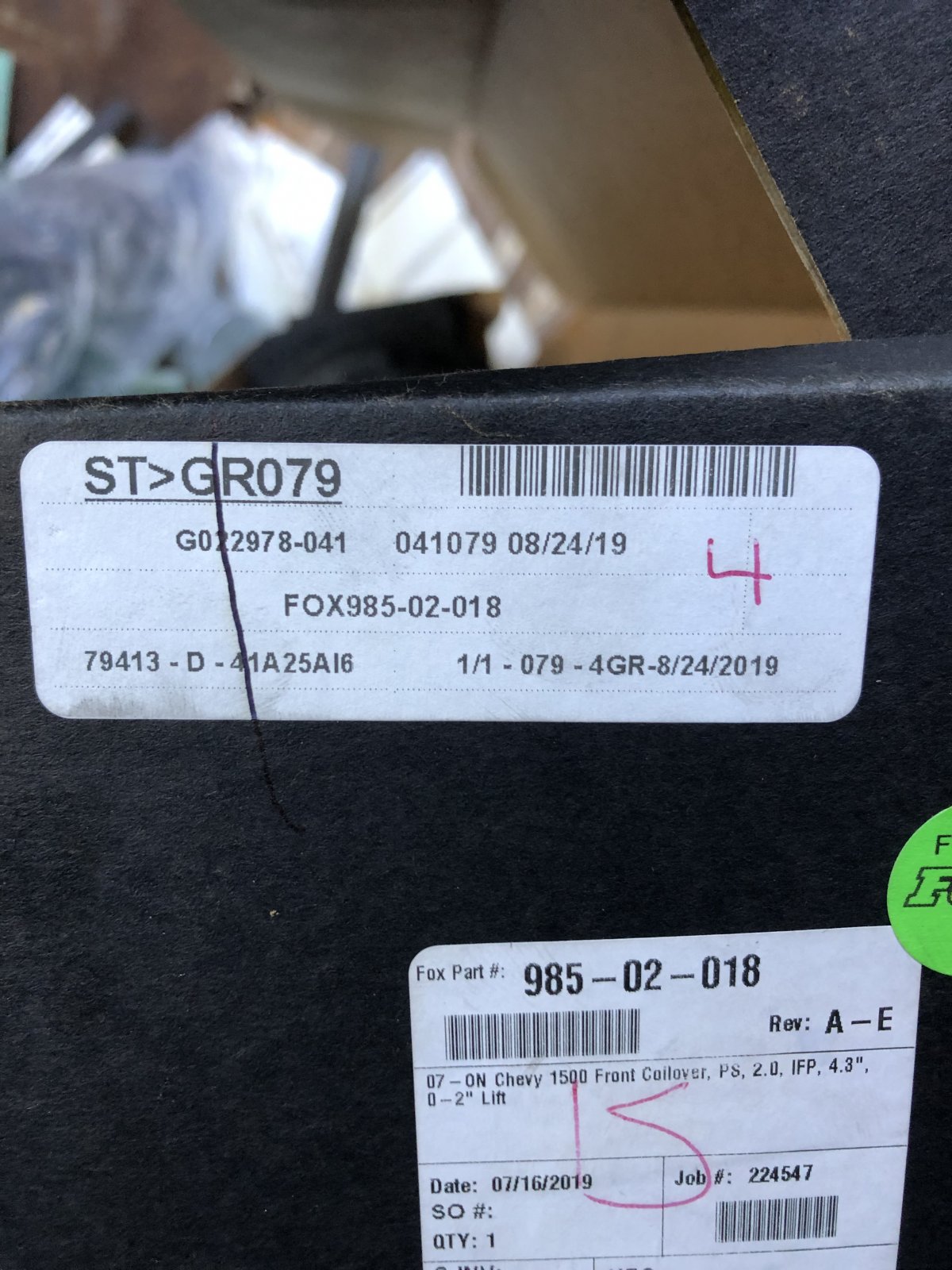

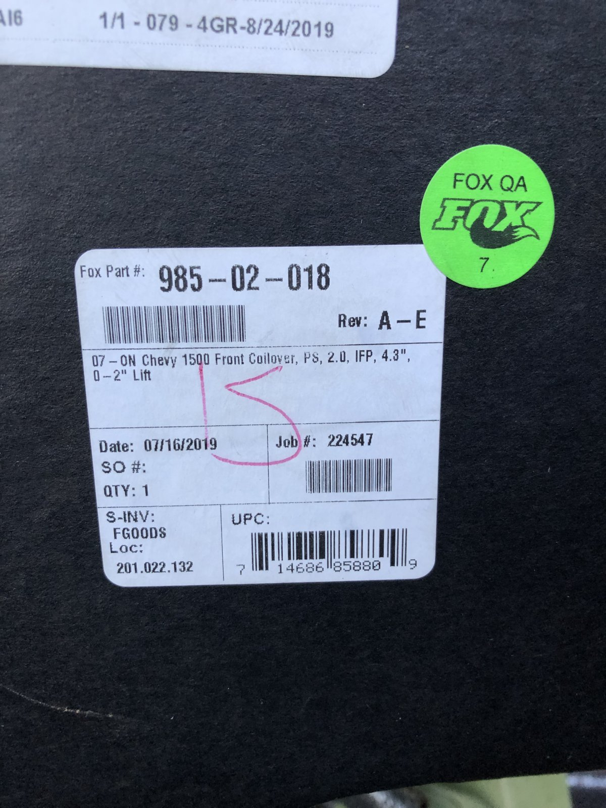

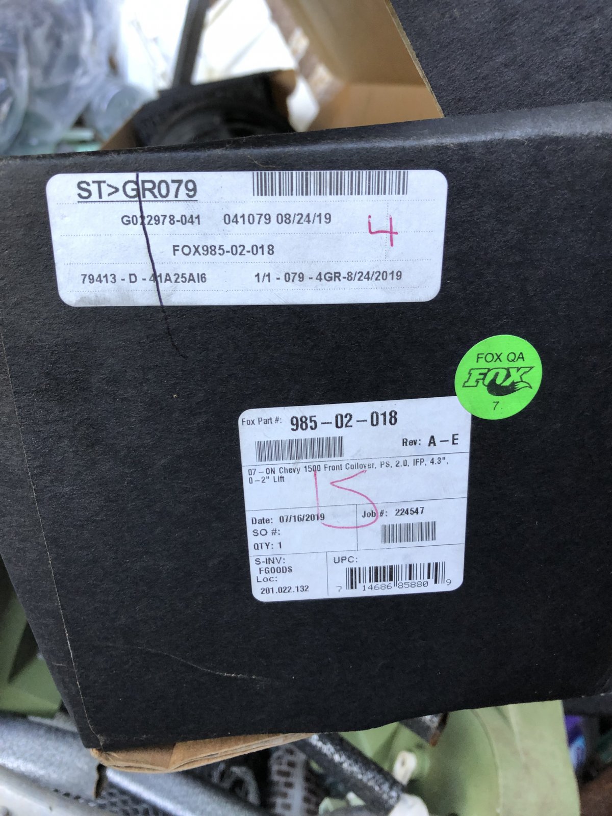

What's the part number for the fox shocks? Looks pretty good.
Oh yea, I dug a box out of the trash the other day and snagged a few pics of the part numbers for ya...

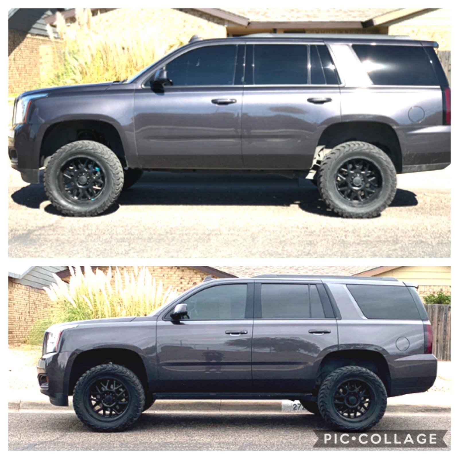

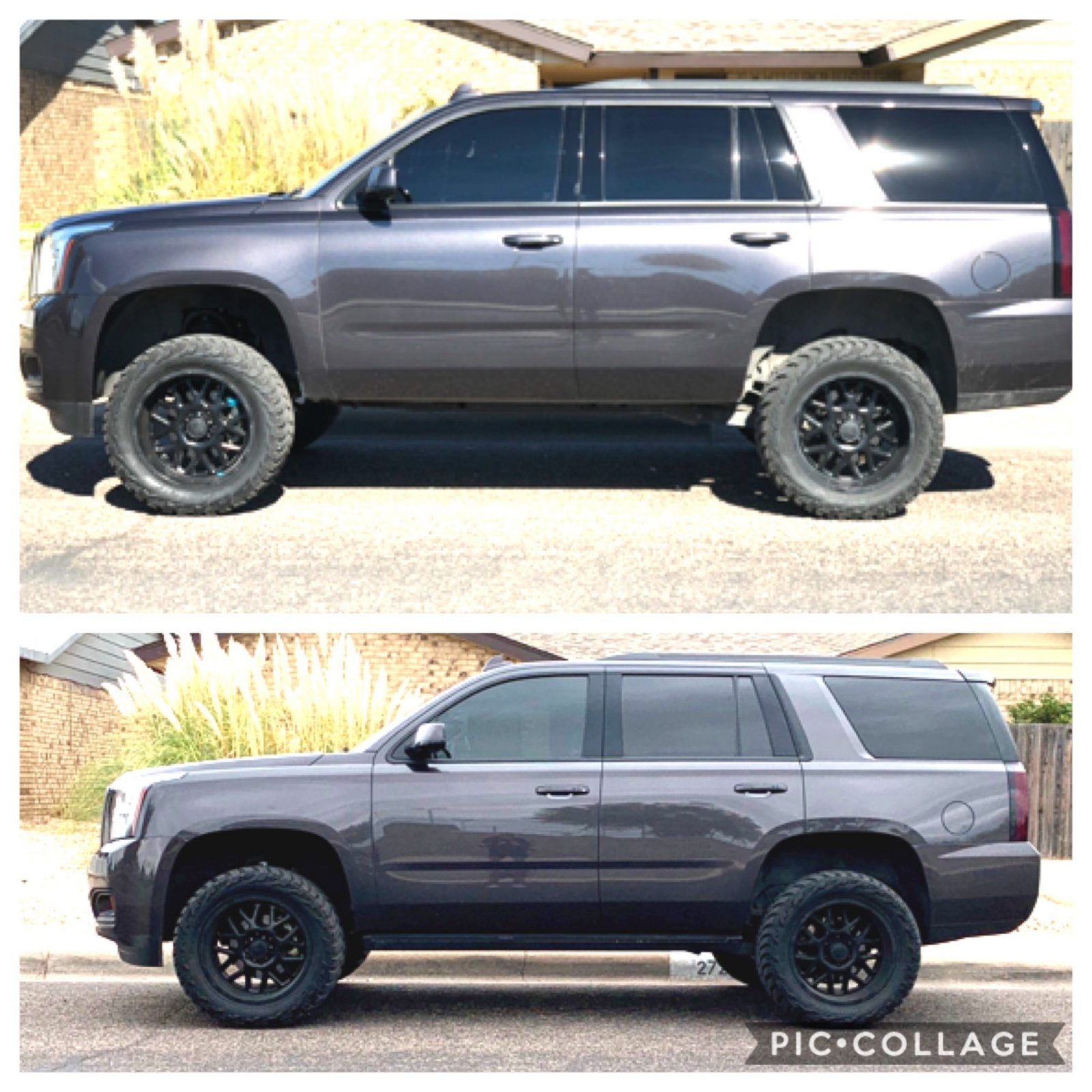

I just recently had my front Monroe Shocks (MRC deleted) pulled off and went with these Fox Coilovers and fox 2.0 in the back and got rid of the auto leveling factory shock.
To my shock, after install my front is lowered 2.5” and my rear dropped 1”. I have the 4” Fabtech kit AND a 1” spacer up front and my fender is measuring 39.5” vs 42” previously. My vehicle front was higher with just a maxtrac 3” leveling kit.
I had the work done in San Antonio and drove right back to Midland and the next day measured my fenders after it DEFINITELY seemed lower all the way around. The guys at Maximum Altitude said the rear dropped prob bc the auto level feature delete. But I’m at a total loss for why my front would’ve dropped 2.5”. They installed the fox coil overs straight out of the box.
Any ideas?
Nokturnal
Jul 25, 2018
154
169
Top is Fabtech 4” Kit with 1” front spacer. Monroe Shocks upfront and factory rear auto level. 42” front fender 42” rear.
Bottom is same setup except now has Fox Coilovers up front with 1” spacer and fox 2.0 rear. 39.5” Front 41” rear
