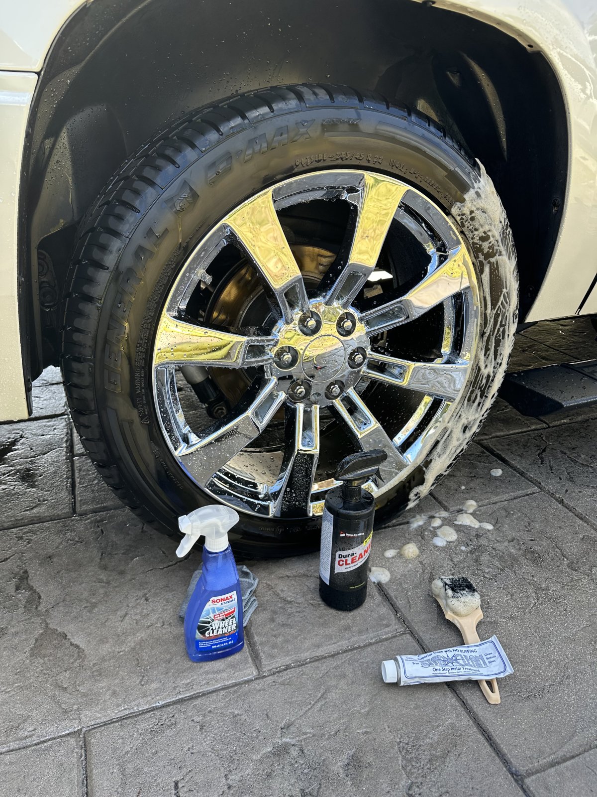

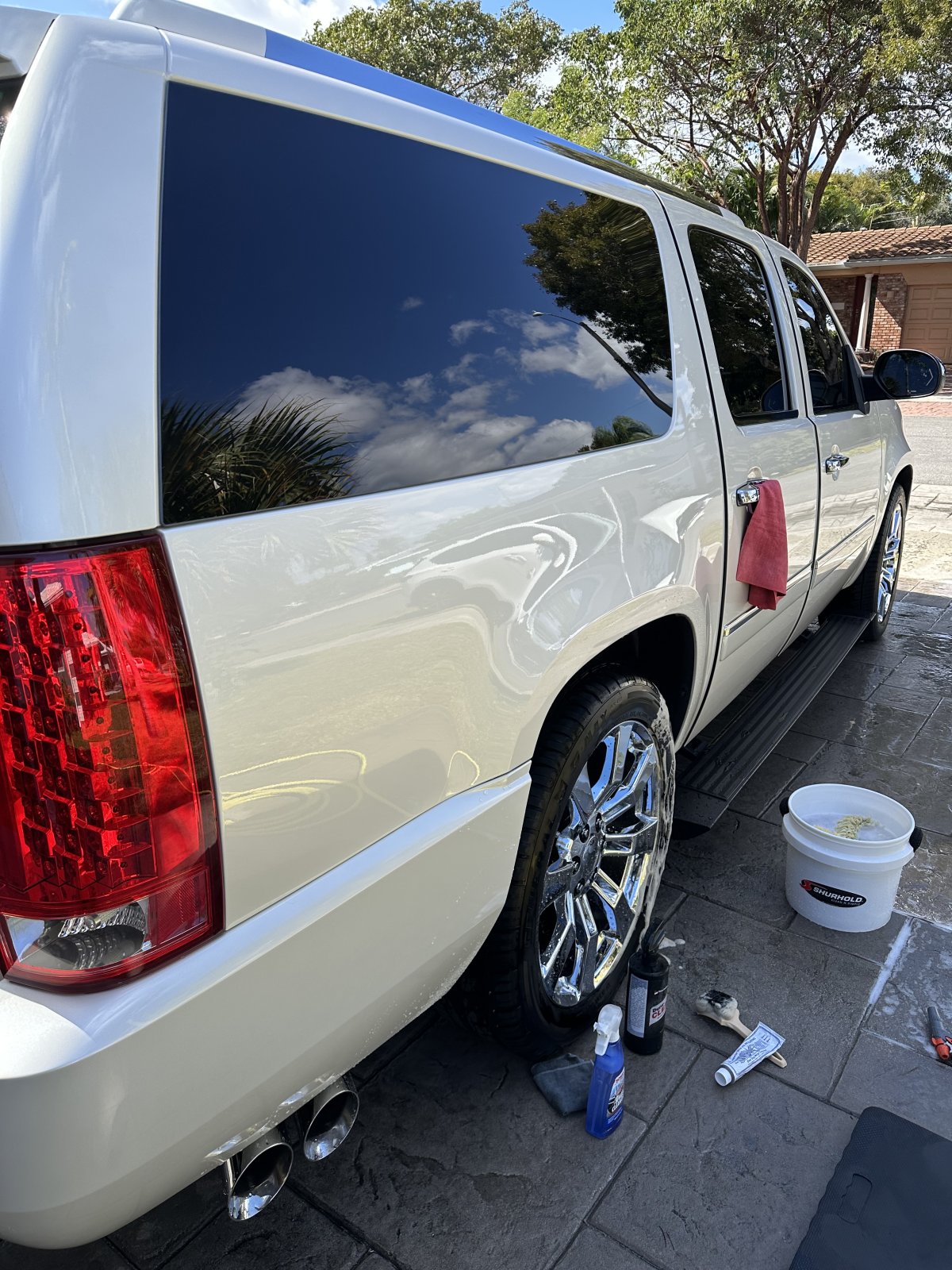

Finally found a perfect weather day with nothing else to do but detail the Suburban in between the Olympics, the Super Bowl and the in-laws from Australia with us.
I took care of the Buick and Mazda on Saturday and geezus the girls can "destroy" a clean car in minutes. But I do it anyways. Just like you, but sheesh....
xoxo ladies! :love62:
Washed, then time to detail. Wiped down with Collinite's Universal Detailer (very similar to 845 Insulator Wax but in liquid form, so it goes on so easy with a fresh microfiber.) And it really keeps the shine IMHO. Then it was time to attack the wheels, tires and fender liners.
I started by washing the wheels and hit the inner barrel with Sonax Tire Cleaner and a stiff brush to make sure any brake dust was cleaned off. I wash the inner barrel every time I wash the truck, so the cleaner did not really even foam up or turn purple. Then it was time to use some Star Clean wet polish, which helped for an extra polish. I didn't want to spend the time pulling the wheels today, so it may be time to put a polishing ball and some Mother's or other polish in there at some point.
I washed the wheels about 3 times during this cleaning process just to make sure nothing was left on too long. The ceramic coating I applied last year is still holding up very well. Might be time to put another coat on, but that is for another day.
I scrubbed the tires again with the Dura Cleaner and stiff brush to get ready for a fresh application of Dura-Coating Dura Dressing. I know some don't like this approach and there are probably other options like Cera Kote that gets good marks, but after applying so many tire shine options that just wash off, sling or don't shine, this has been working for me. But it does take maintenance every so often and seems to average about 45 minutes to an hour per tire and lots of elbow grease to get the tires cleaned (even with the previous coating that is still there) to be ready to apply the top coat for a fresh Dura-Coating Dura Dressing.
It is work, but once the tires are cleaned and the suds are white, the temperature and wind helped to dry them out for the top coat application. And today was perfect for that! Not too hot either so I could clean the wheels in the shade and then turn the truck around to apply the dressing in the bright light to make sure it was an even application. That should keep them shiny for a few months again. That's the part I do like, especially when I am traveling.
I also decided to use Cera Kote ceramic wipes to shine the fender liners and the running boards too (gave them a solid degrease and soapy wash first). This old girl at 109k miles is still looking great, but there are some cosmetics that keep popping up around the vehicle, so taking the time to attend to some of these issues when I can and keep her running strong.

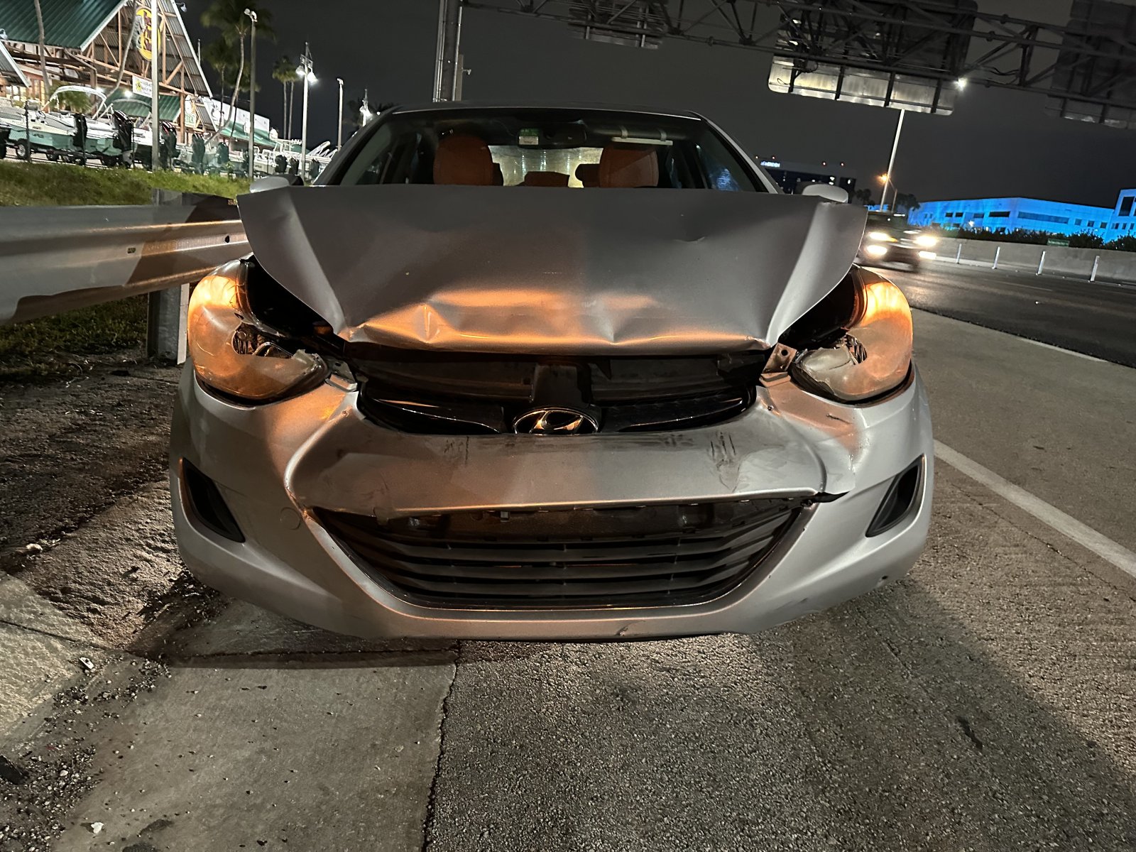

It was a Hyundai Elantra that the low front end went under the rear bumper of her CX-5 and totally pushed in her front end.
And again thankfully missing the liftgate. That rear bumper construction did its job well. Now if it was a big truck, it would have been 100% trashed.

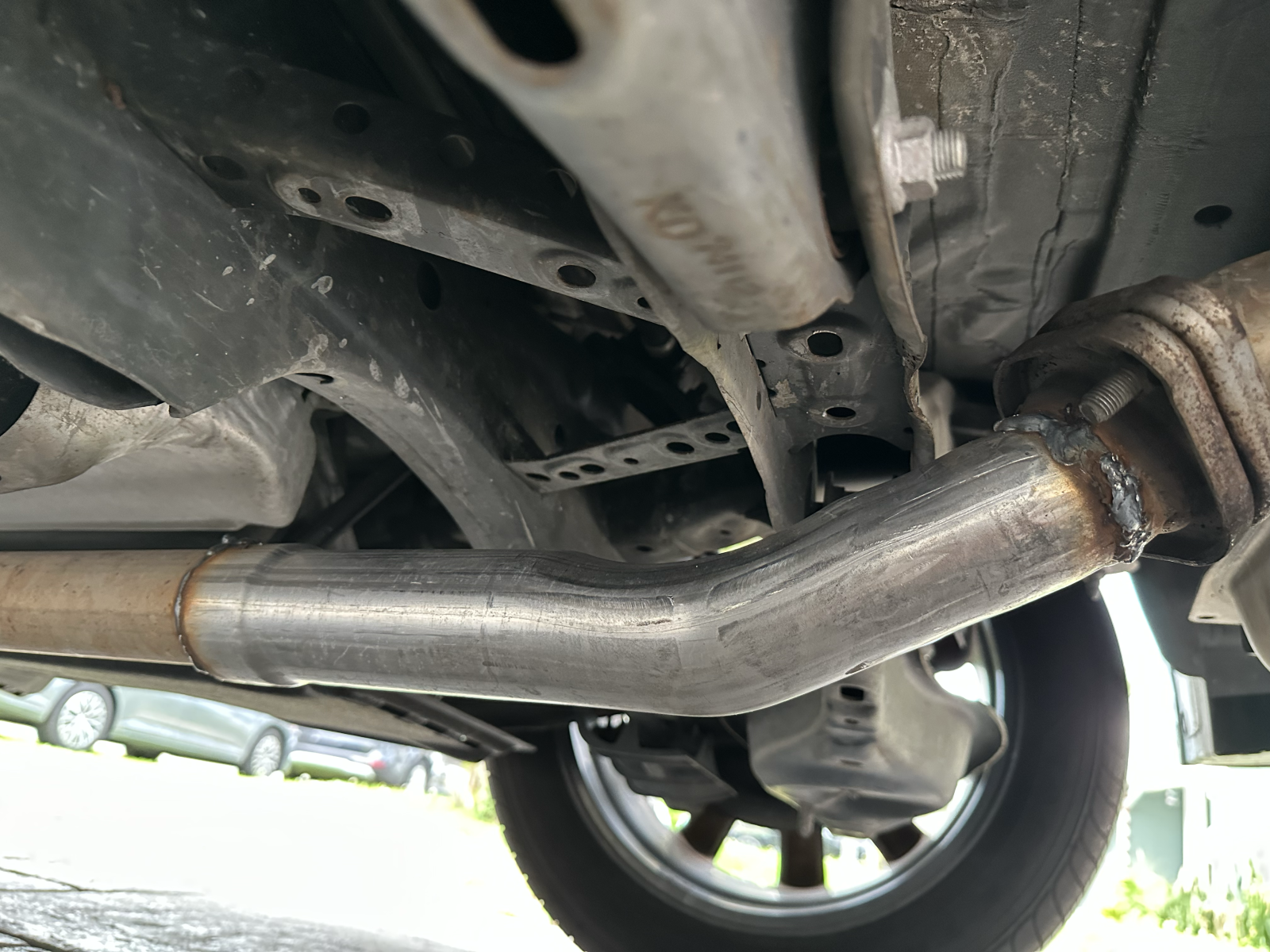

>>Mechanic: It’s safe to drive. I repositioned the exhaust so it’s not hitting the subframe and secured the bumper cover to the bent brackets. It will probably need a new exhaust or a section replaced if they do body work. If not, you can drive it the way it is. No more noise.
I asked him about the dead battery as I had only put the Suburban on charge over night and it wasn't fully charged when I left at 0700. The Mazda did not have any charge yet.
>>Mechanic: A bunch of voltage below threshold codes because battery was low and one for passenger occupancy sensor. And one random misfire but I cleared it and it doesn’t seem to have any. I drove it. Said the battery tested good and probably recharged from driving it. Plus I asked my FIL to put the trickle charger back on it as well.
And there you have it...another saga on the thread. Thankfully all things considered, #1 priority is that my daughter is safe and unharmed. Bonus #2 that her Mazda is still fully operational and finally #3 not her fault and no ding on insurance considering 4 vehicles and 2 teenagers is just not friendly. My mum reminds me of us boys (3 of us) as teenagers and my brothers were pretty bad with their trucks (other time stories), all with trucks and numerous accidents. Not sure how they managed that with $$$.

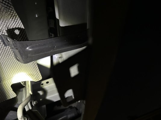

Can't see the pinched exhaust, but just below the cross member. He managed to pull it down a bit so it wasn't banging on the cross member.
Fender braces were bent down. He folded them back up and attached them.

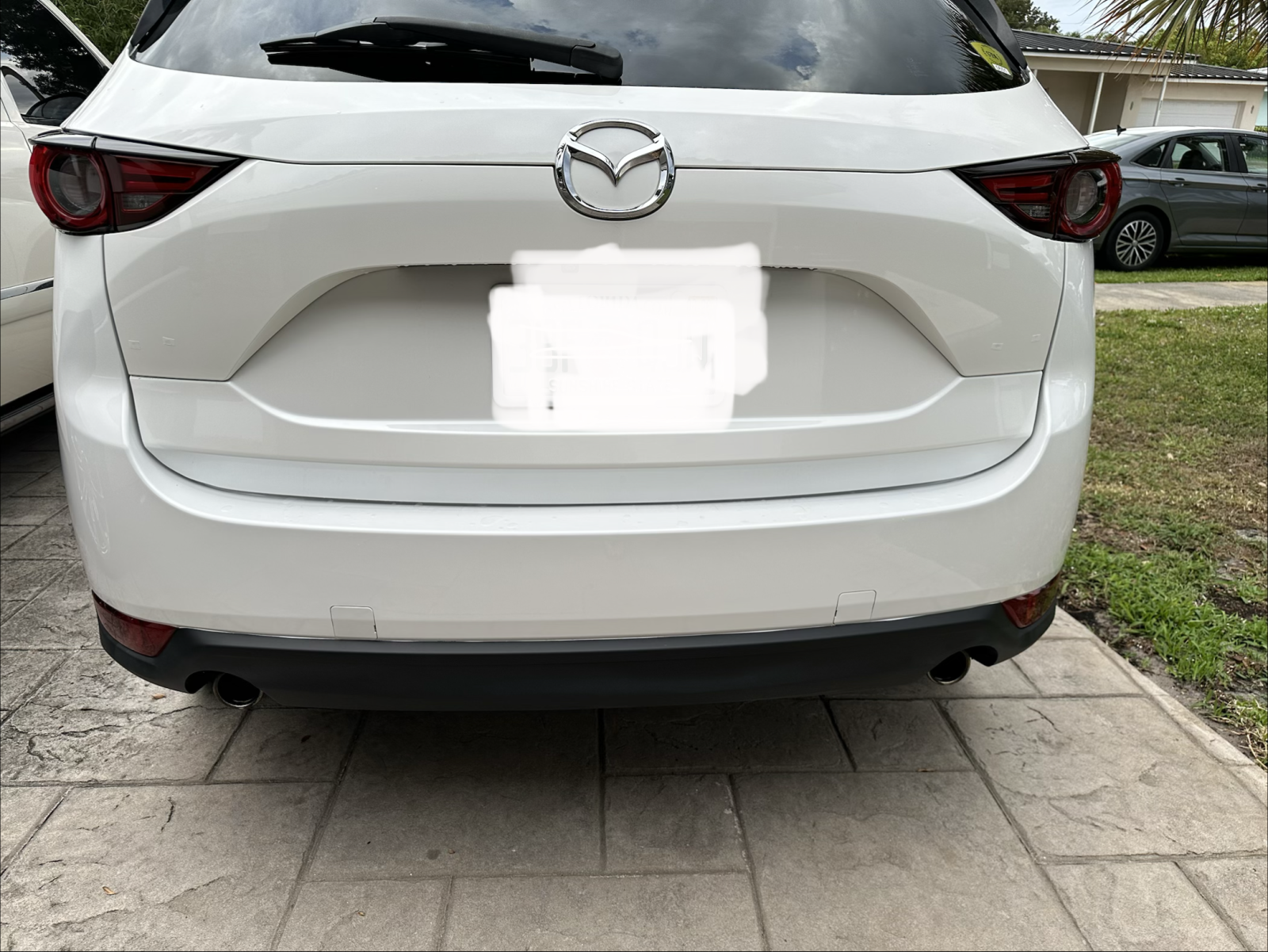

Mazda CX-5 returned in great shape. Painted rear bumper panel and new bumper pad, damaged exhaust cut out (not the prettiest bead, but she will never notice lol) and rear airbag sensor recalibrated. Built like a "little tank".
Happy daughter and happy wife so all is well with the world!

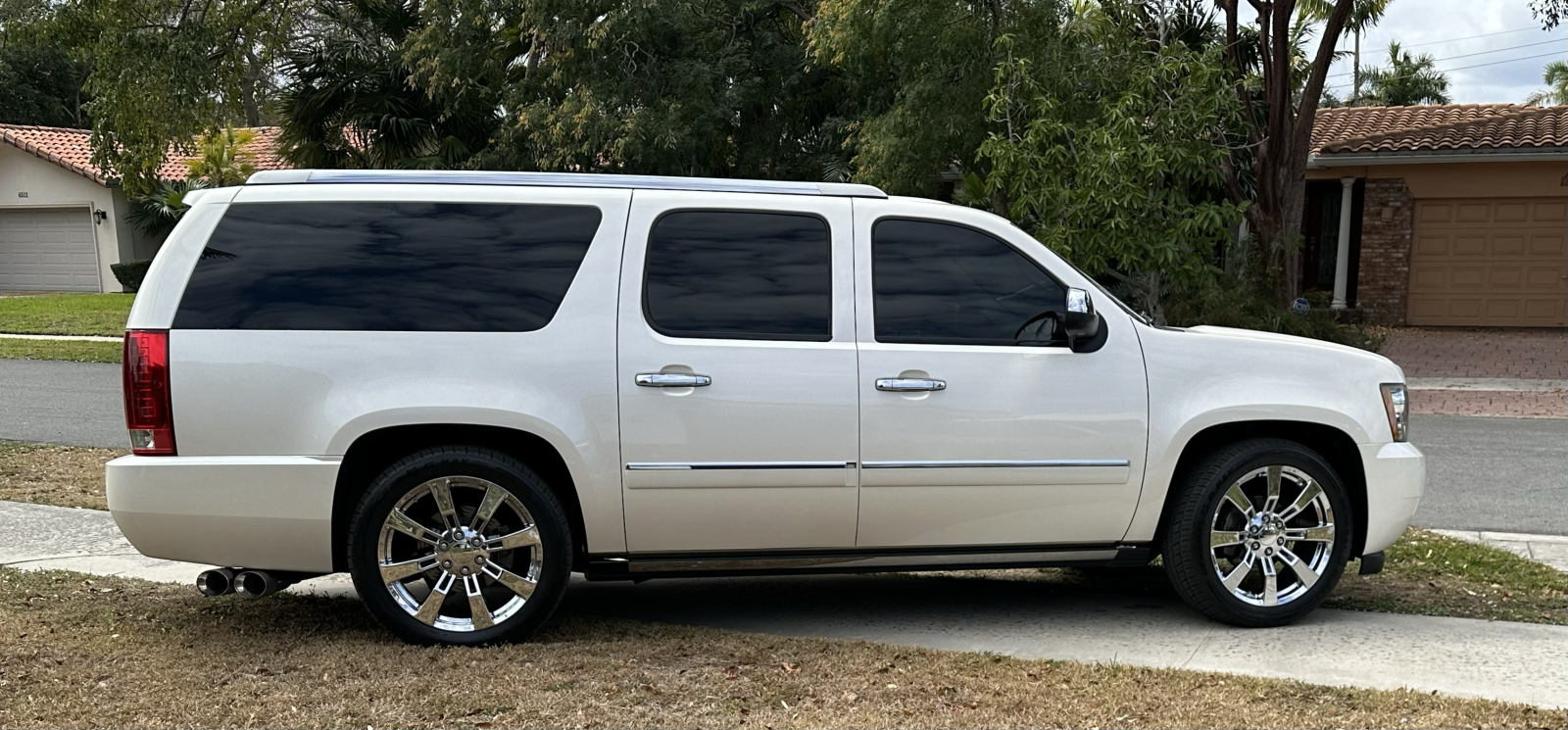

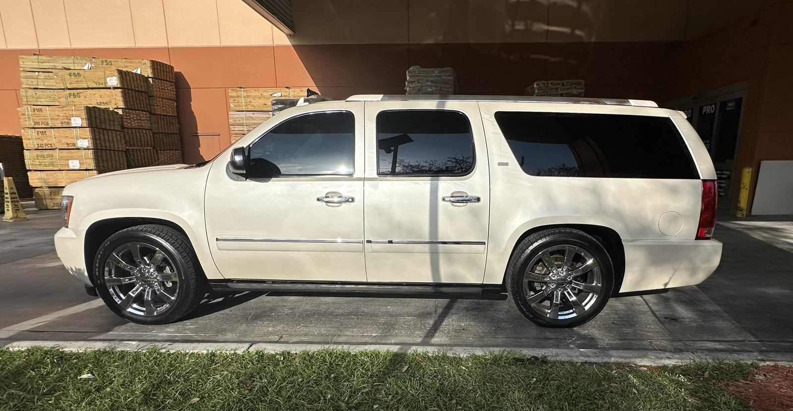

A few shots from an early morning run to Lowe's for concrete and rock. Sure enhanced the stance! Compressor fuse is pulled as the bladders on the OG shocks are toasted, but the actual shock is still in good shape.
30 March 2026
Suburban 110000 miles on the clock.
Went to my buddy's shop for an oil change, electrical system check, rotation and a new battery. The Interstate I had in there was a little over 2 years old, had been killed twice in recent months and was completly dead the other day again. I could not charge it with my lightweight HF charger. Had to jump it with the Mazda, then put it on charge to be able to start it and drop off at my buddy's shop. Got a little bit of pro-rated warranty, which was worth getting a new battery now.
Still flirting with getting her down a little more like with the rear end full of concrete. Not sure when I can fit that in, but sure would look good!
