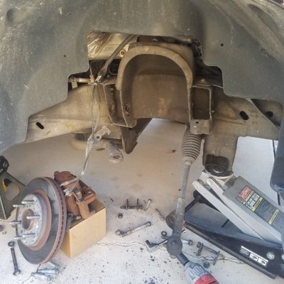

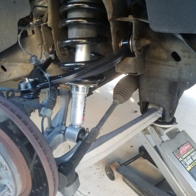

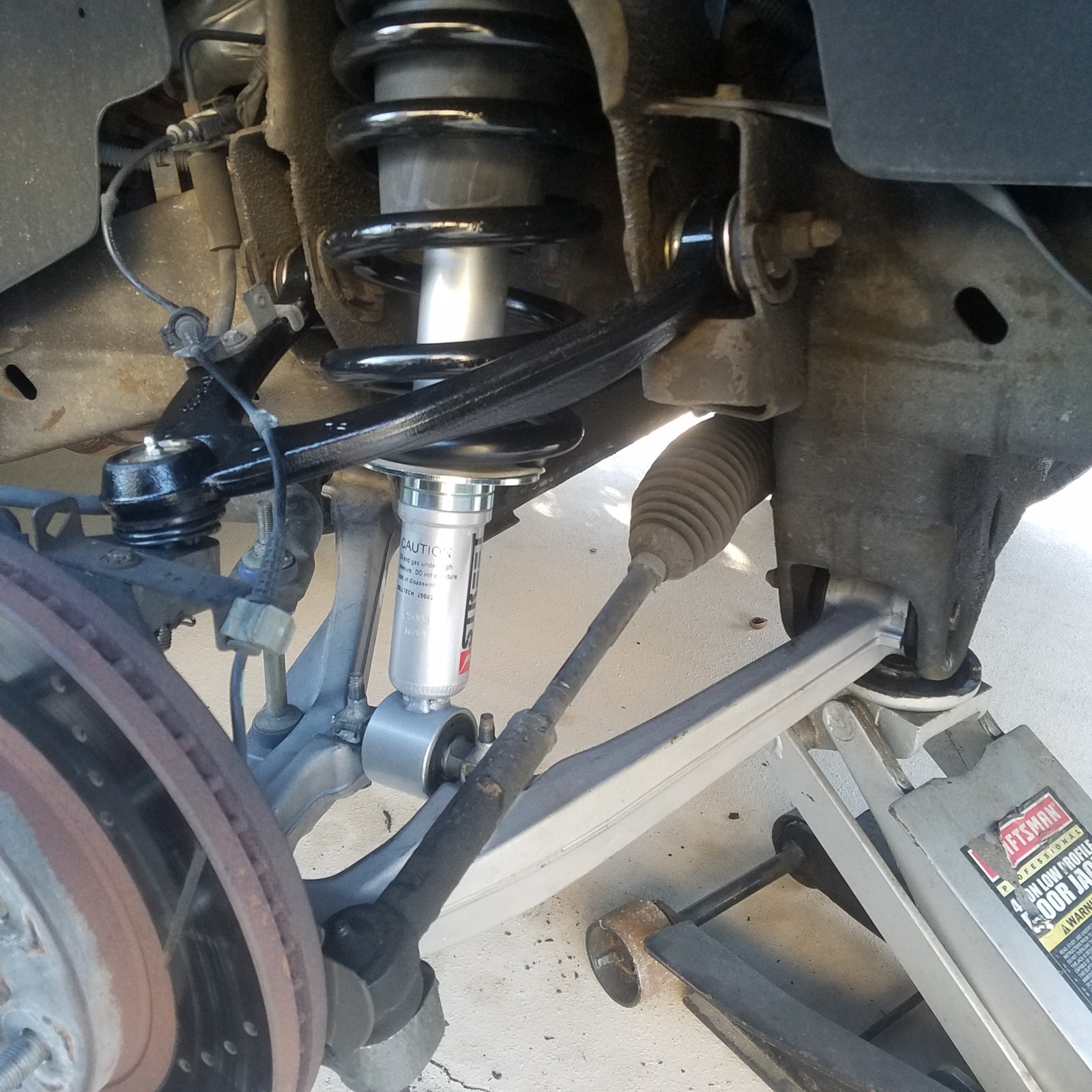

After installing the passenger side and putting the wheel/tire back on. I did not notice a difference at all, in fact the caster camber is so far out it looks lifted. Now I know I'm going to need an alignment but it looks crazy.
Now, since the Pedders drop coils are advertised as a 2.33" drop and I used BellTech 2511 spindles and set the struts at 1/2" higher than stock to compensate for the lower coils.

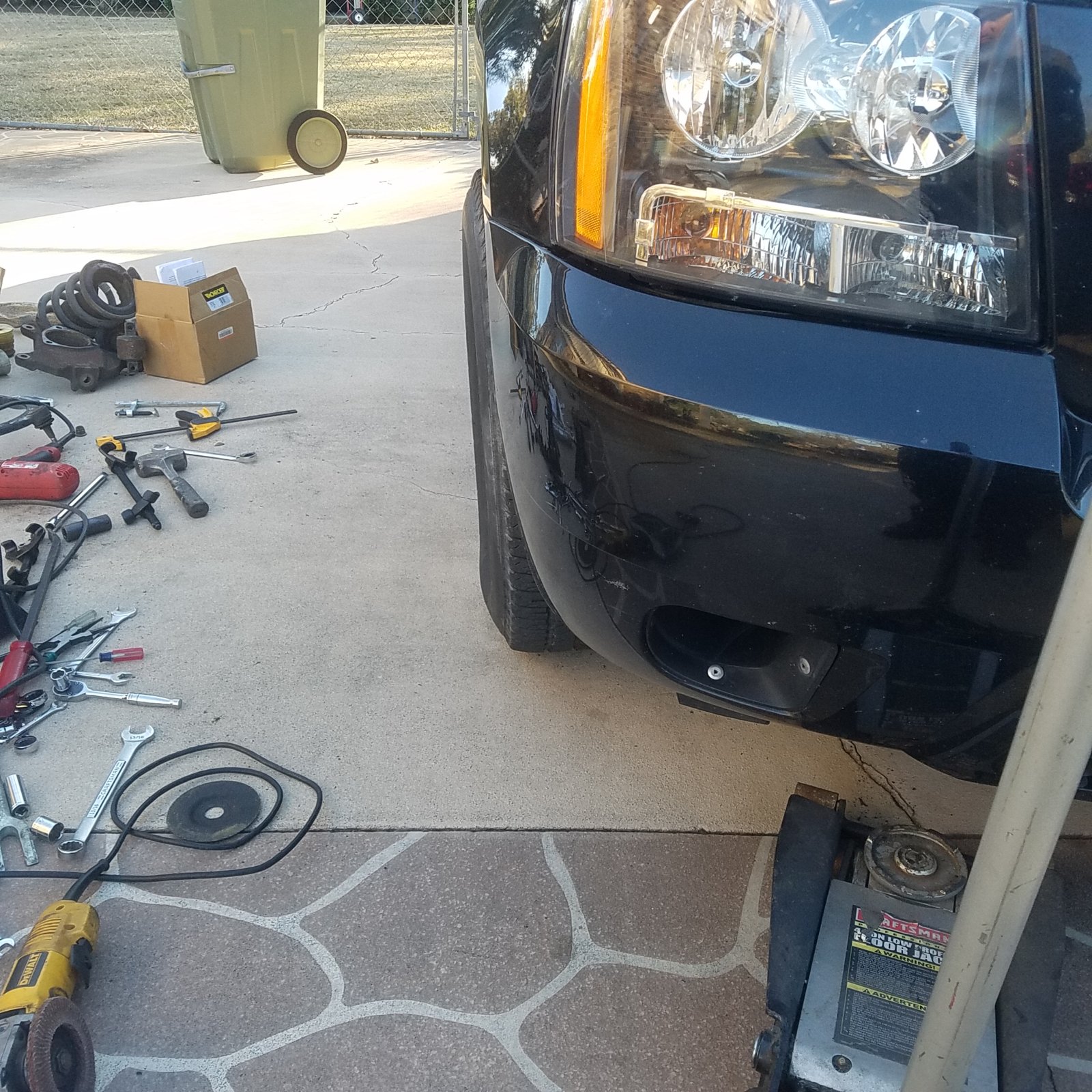

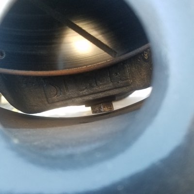

I'm never good with getting pictures. I forgot to get a side view but, you can see how bad its out. And I also took a picture of the lower ball joint cut down. I don't think I've seen anyone post that before. Probably cut 1/3 of the nut down.
