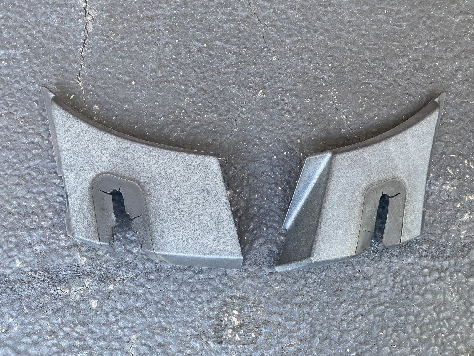

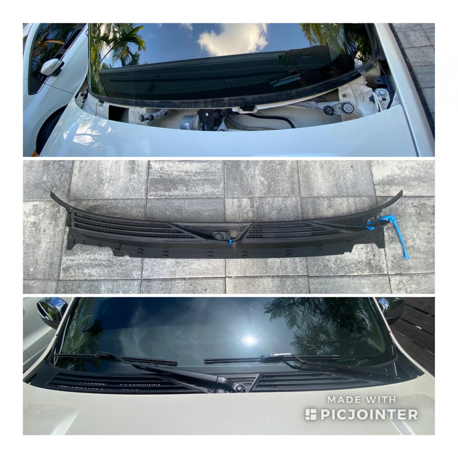

Removed the center cowling, end caps and windscreen wipers and gave them all 3 coats of Krylon Fusion Satin Black spray paint. Looks so much better as they were all tired from the sun. The rubber on the end caps where the hood hinges slide through are a bit gummy and I cut the jagged edges straight and reinstalled them. New units are about $52 apiece. I’m all for new, but all the clips on my existing units are in perfect condition and there is no antenna hole (NBS Esky end cowl covers), so I guess I will rock these for a bit longer until the rubber just gets too bad and maybe replace them at that point. I’m the only one that is going to notice that rubber bit anyways, even if I cut it all the way out. But good for right now.
Before and tired.

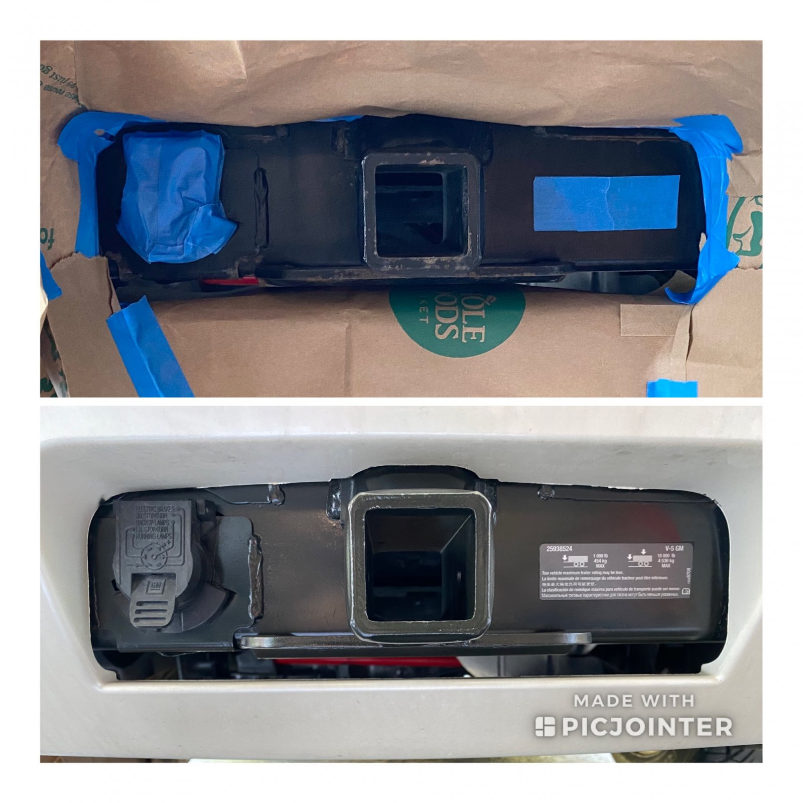

Before hoisting the spare tire, I did a little clean up in the rear and touched up with spray paint some of the surface rusty spots. Still needs more attention but a good start.

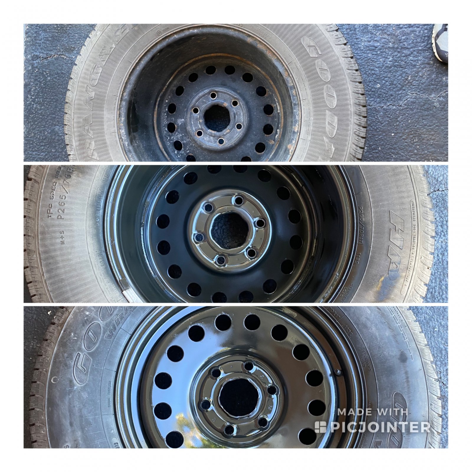

Hit the spare tire with some paint to cover the rust before hoisting it back into place. I did not clean the tire and shine it up, but the thought did cross my mind lol.
Resprayed the hitch before installing the closeout.

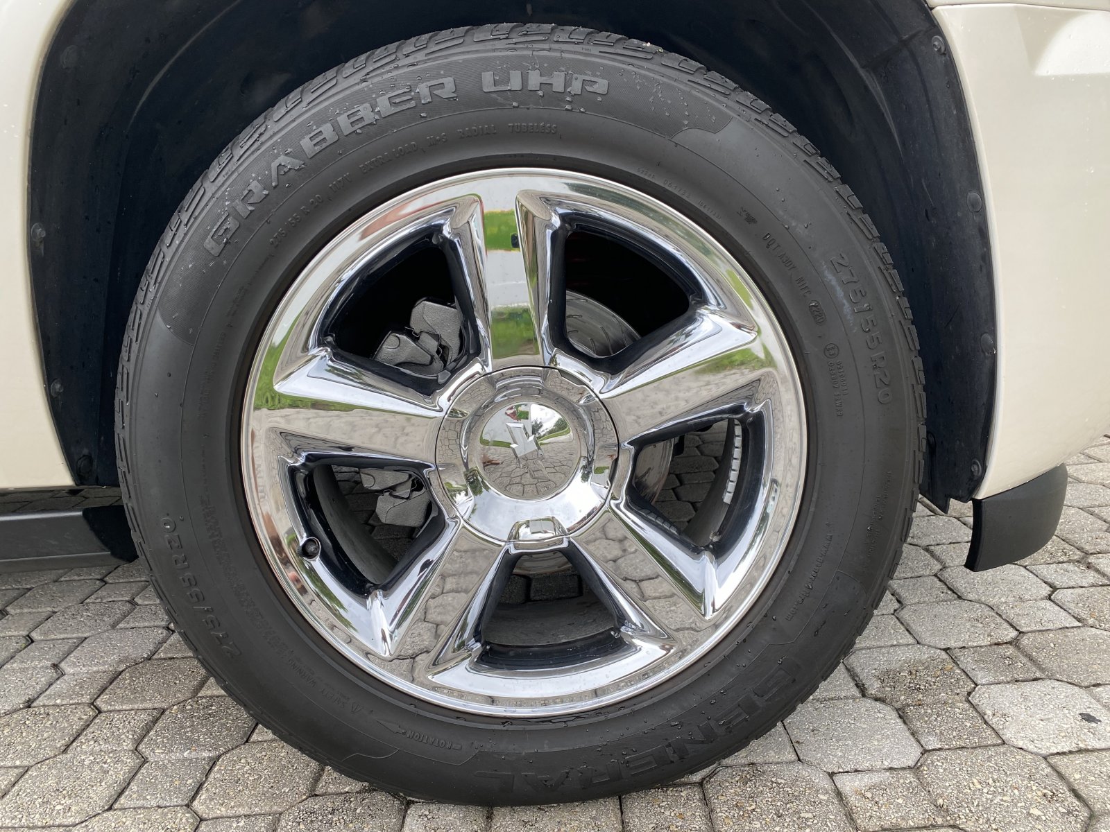

Polished the wheels out.

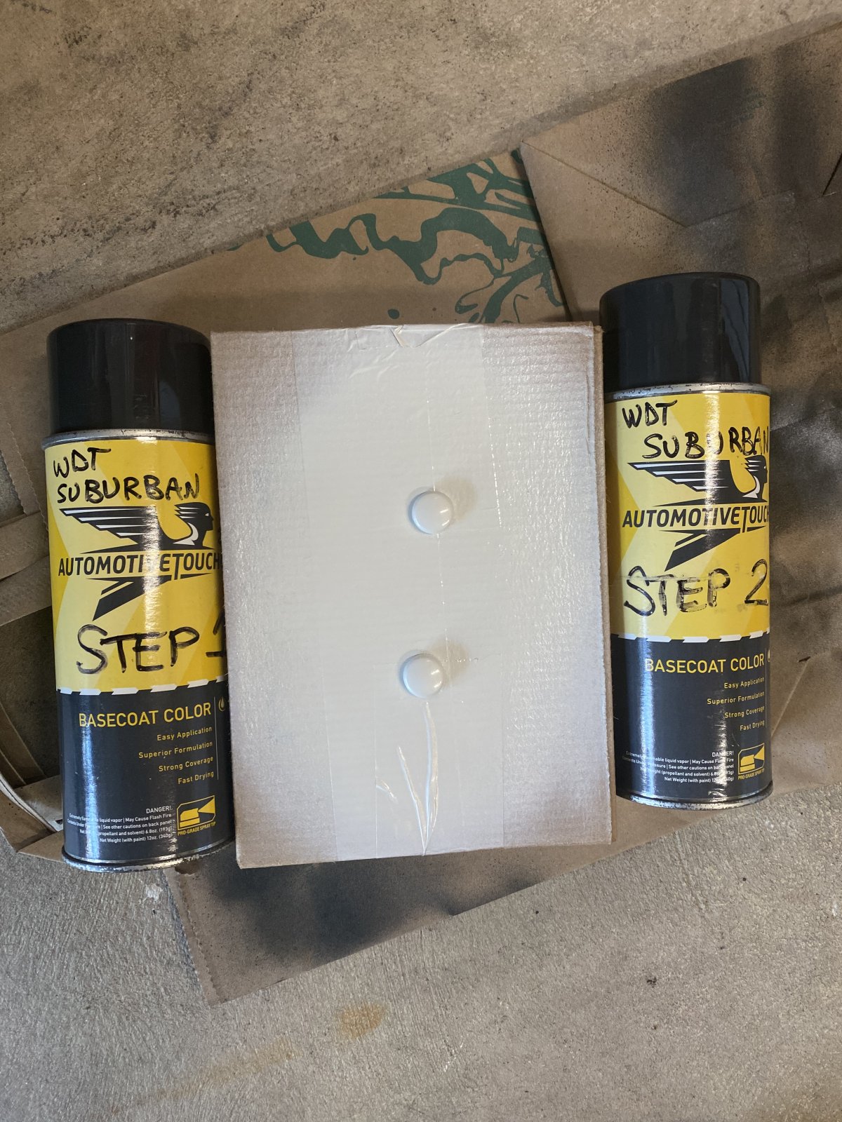

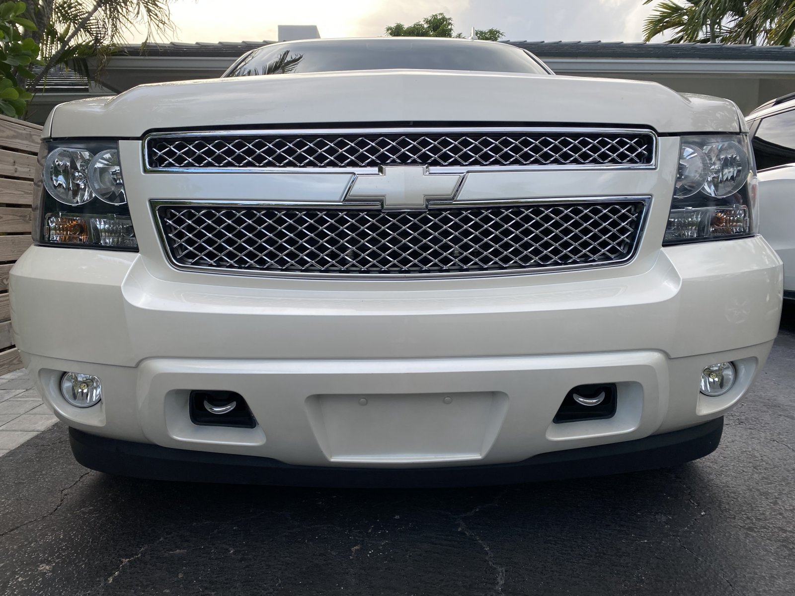

Had to cover the holes in the front bumper from the Missouri front license plate (Florida is a rear plate only state). Wish I could find a close out for the front bumper, but have not seen one, if it even exists....hmmmm....
Grabbed some license plate screw caps and color matched them. Then snapped them in place over the screw heads. Much cleaner.
Polished out the front grille. Yes I hit every hole with Flitz.
Sanded a few jagged edges on the front air deflector.
It made my heart hurt when I first had to install that front plate and drill into that previously untapped license plate spot :( Front plates are so useless IMO.

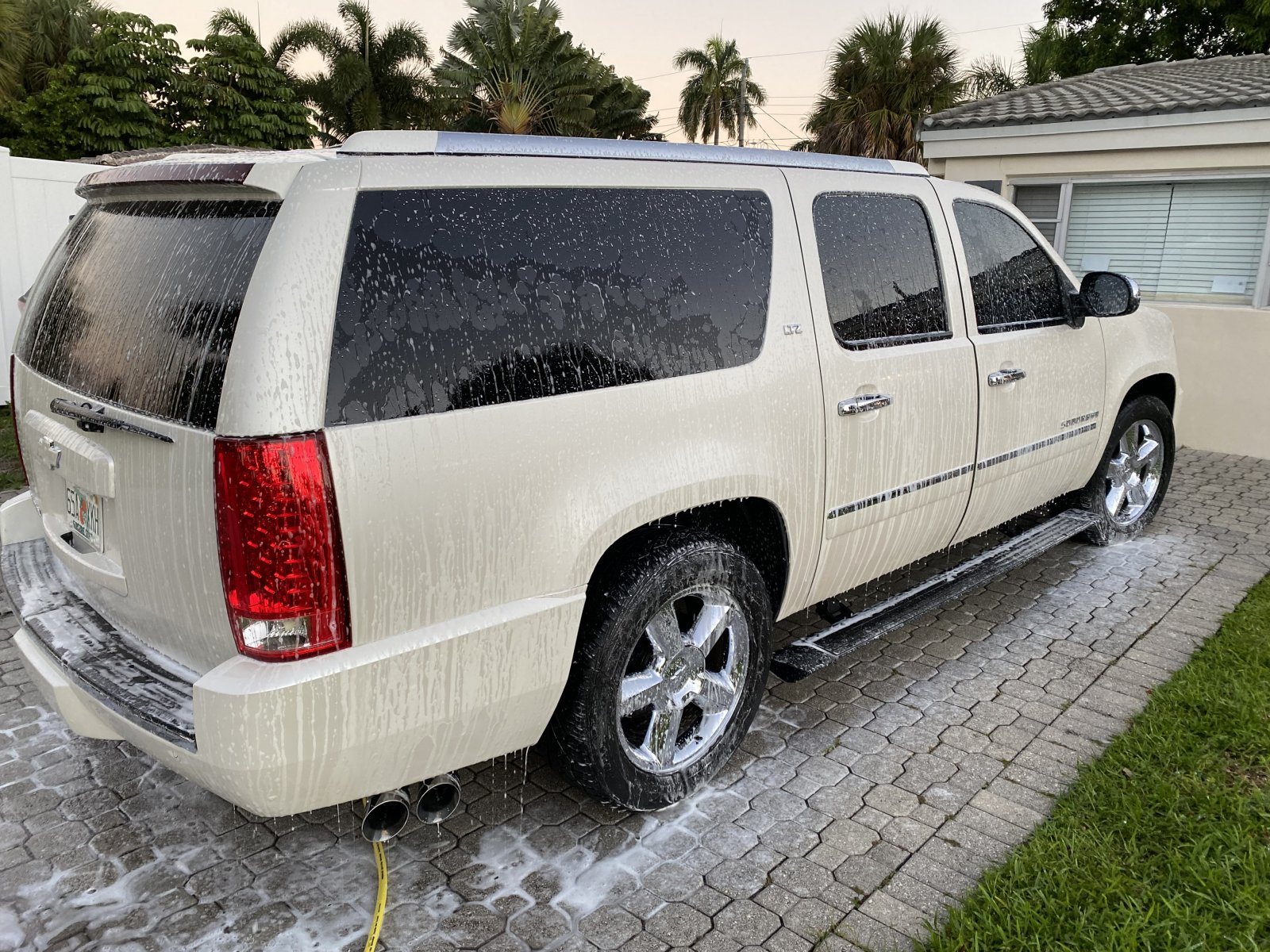

On Friday morning before sunrise, I washed, iron decontaminated, clay barred and washed again the Suburban to make it ready for a Saturday polishing session.
This is what I had access to locally. $25 for 1000mL. Bit pricey but basically did what it said.

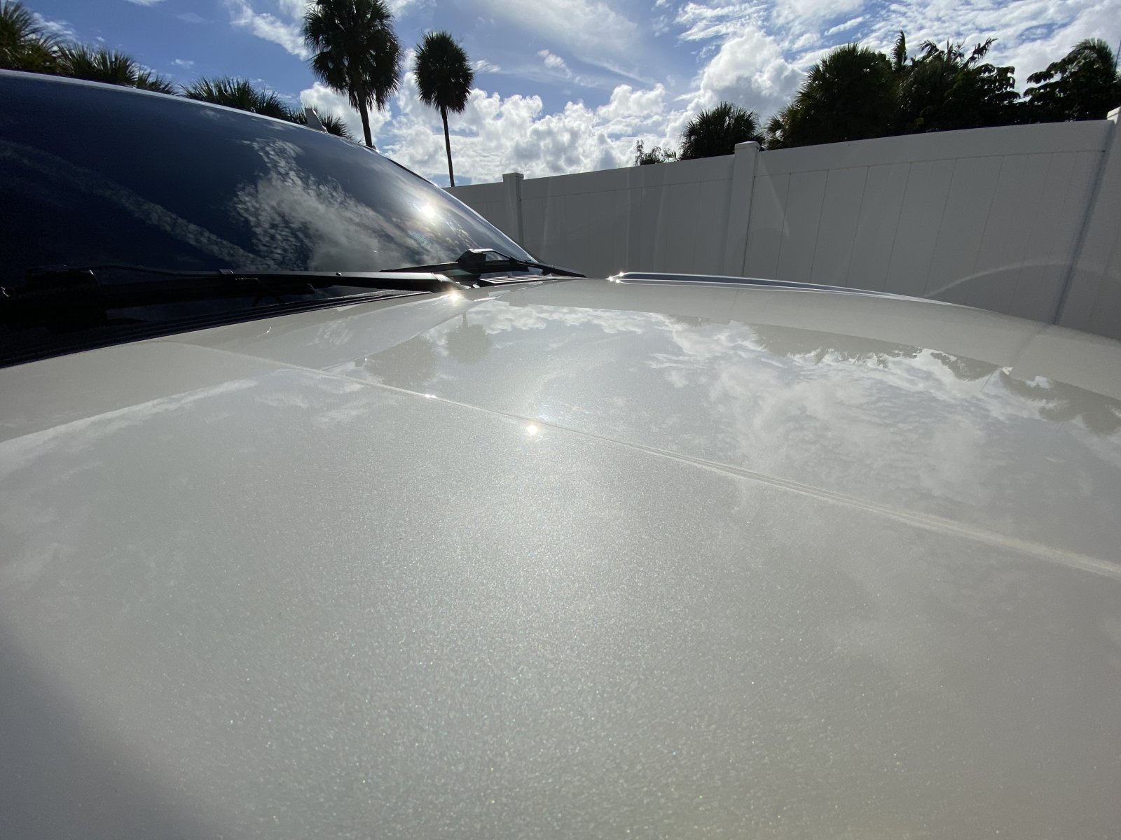

Finally time to detail the long body! Way overdue and desperately in need. There wasn’t much fallout on the paint, but some of it turned purple. Just not the entire truck like gets shown on the videos.
On Saturday morning, I started polishing at 0700 so as to not upset my neighbors and be in tune with the noise ordinance. I decided to change up my products this time around and went with Rupes. Their newest products matched the color of the pads to the polish making it pretty dum dum proof. I did reach out to @adventurenali92 to get some advice on the iron decon and what he thought about the Rupes, as I had been using Chemical Guys previously. I had to leave those products behind in AUS, because it was considered Hazmat and couldn’t go in my boxes.
The paint always looks good and the WDT does sparkle nicely, but had not been polished out for a long time. It needed to pop! I almost went with the coarse Blue, but decided to go with Fine Yellow polish, which turned out to be a great choice as there weren’t any really bad spots needing that kind of work. I saved the Blue pad and polish for the windows, then gave them a solid coat of Rain X.
I was racing the sun coming around the house and thunderboomers rolling in from the ocean, hence why I started so early to keep the panels cool and try to beat the hourly rain forecast. I dodged one rain shower with a light sprinkle and had to wipe down to continue. It would unload not long after I finished in the mid afternoon.
I was really impressed with the Rupes pads and polish. I still have my Porter Cable 7424, which did a great job. Would like a Rupes machine, but will wait if the PC ever dies. After the Yellow Fine polish, I grabbed a Rupes white pad and some UNO Protect and coated the entire truck, including the dreaded roof lol. That is always one big ass panel! Still looking good though. The rain came and the water just beaded right off as you would expect. Sure looked nice and I was super stoked to get that big project completed.

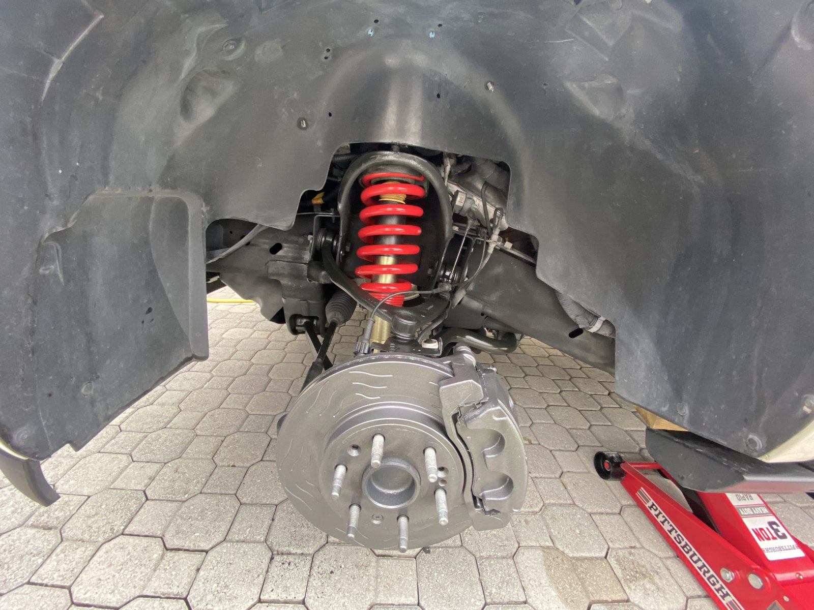

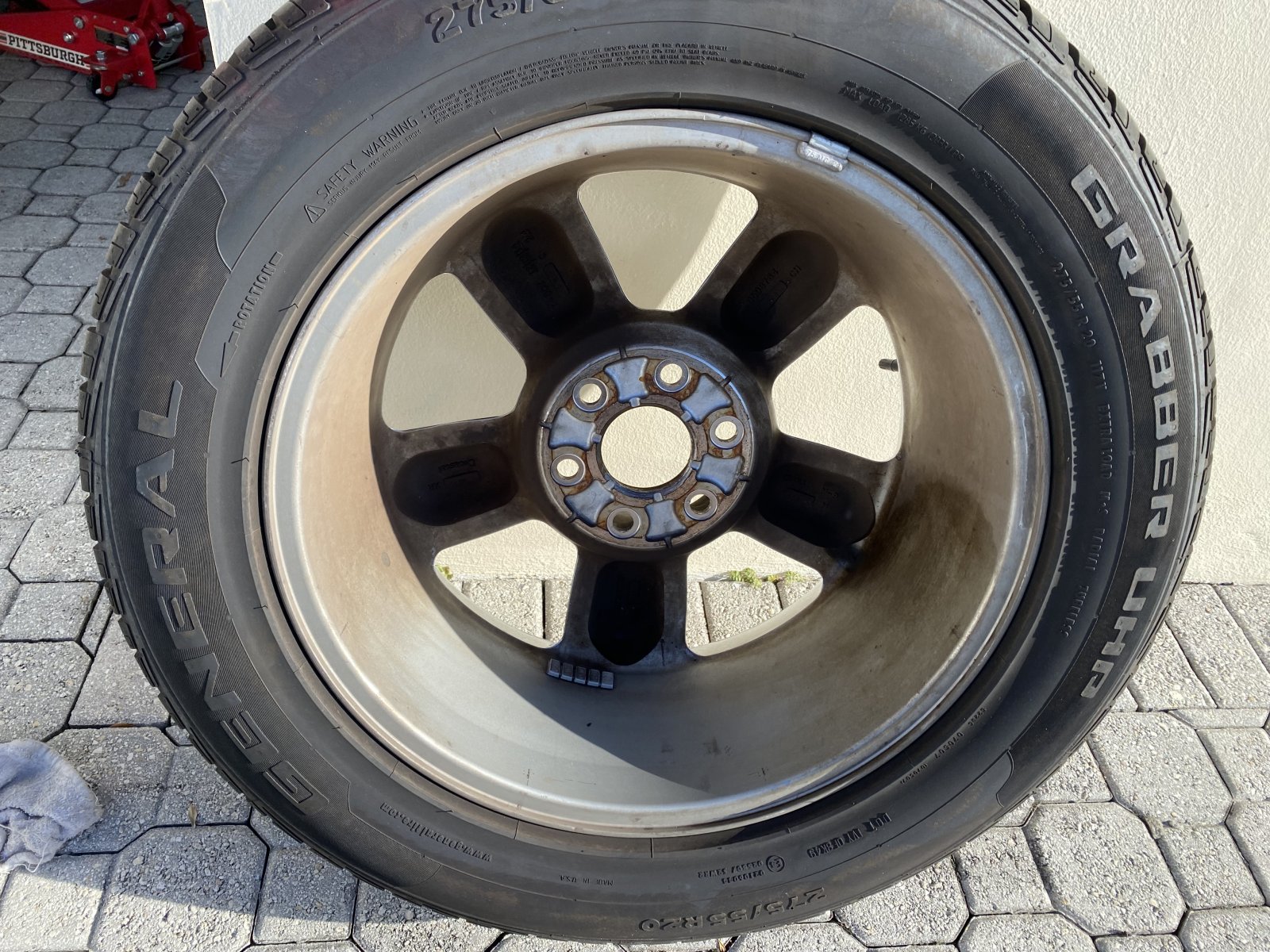

I pulled the wheels off one-by-one, gave them a solid APC cleaning of the rubber and decided to go a step further and clean the inner part of the wheel. Took a lot of APC, water and stiff scrub brush/toothbrush to shift that dirt, brake dust and road grime from many years and miles on the road. But what a result. Nobody will every notice, but it sure looks good to me.

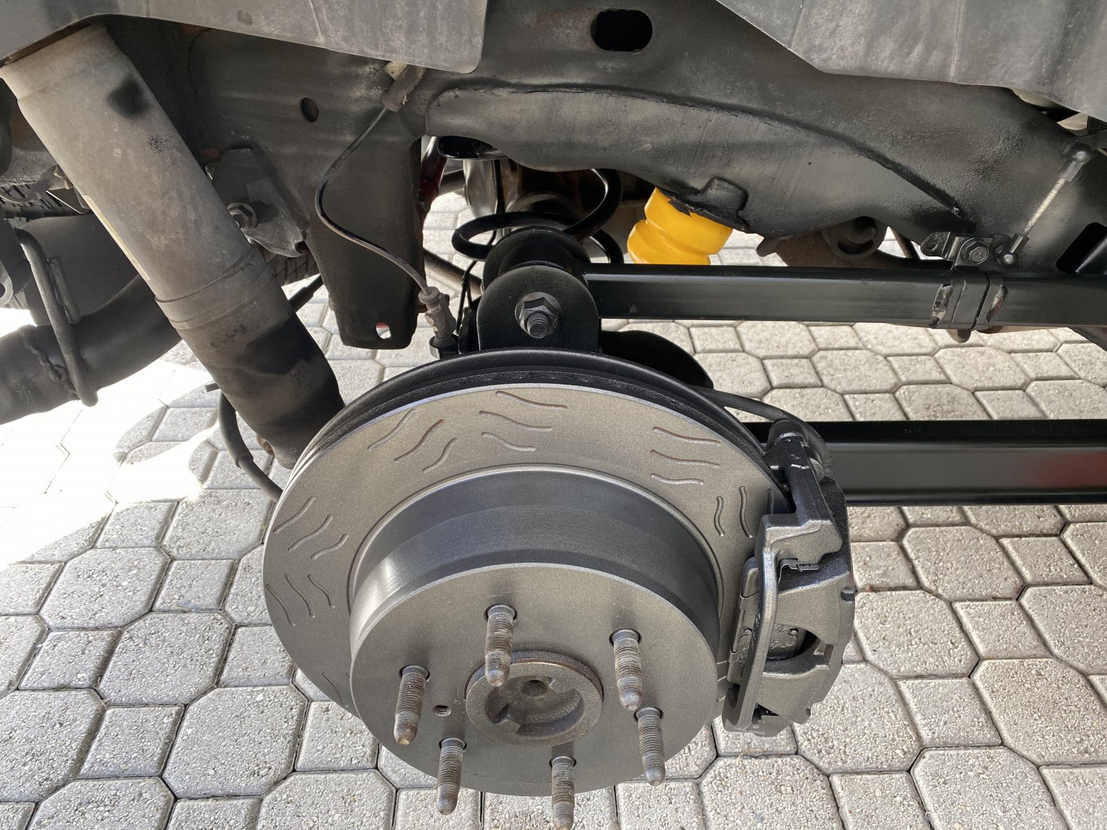

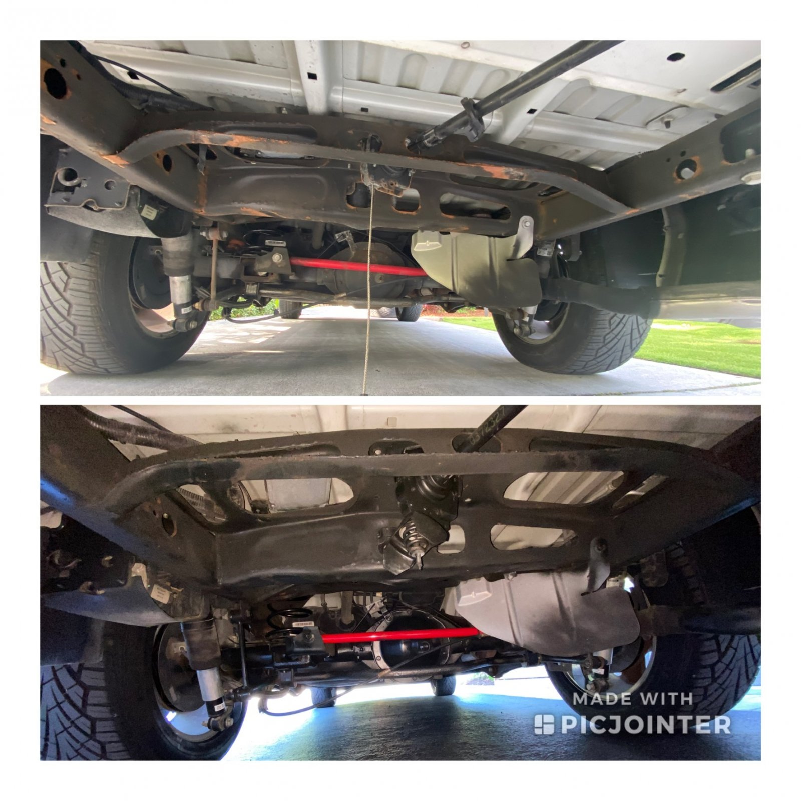

While the wheels were off, I hit the frame and suspension components with Rust Oleum Matte Black to cover the spotty rusty bits and to “freshen” it up a bit. And why not? Would you expect anything less? Lol I freshened up the brakes as well with some Krylon Fusion Metallic Dark Metal for something different. Dark to mask the dirt and brake dust and some light flake and gloss to sit nicely behind the wheels. I had to put the wheel upgrade on hold for a while as the niggly maintenance items that popped up - hubs, tires, normal service, etc.. in previous posts plus setting up a house. Wishlist and still looking at something in the CK375 or TBSS again?
I also changed out the rear axle pad bumpers/jounce stops as the old ones were pretty flaky. In fact, I bought those 2 months ago and that was one of the reasons I was going to pull the wheels for easier access and that escalated quickly into more detail work. Lol

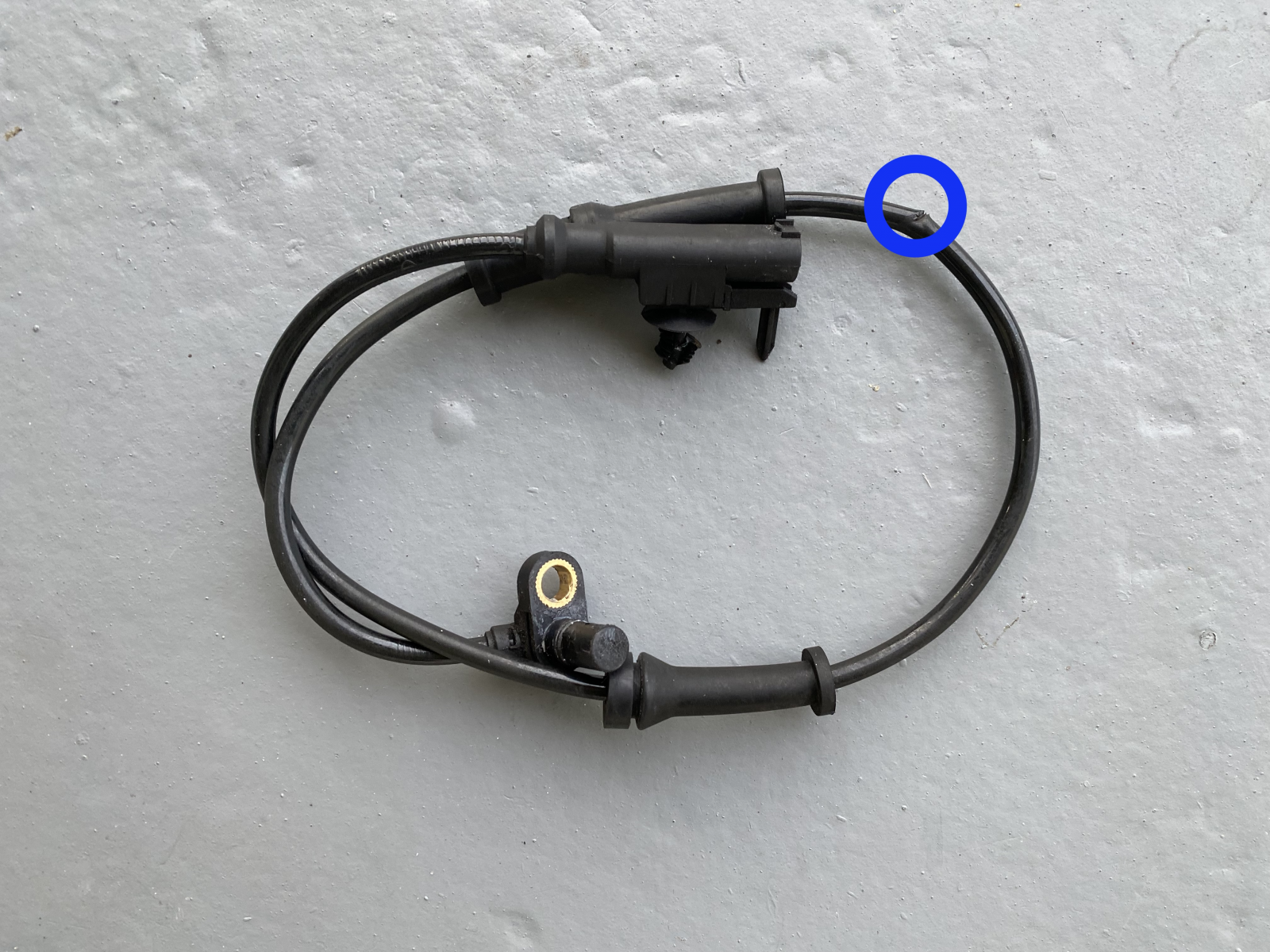

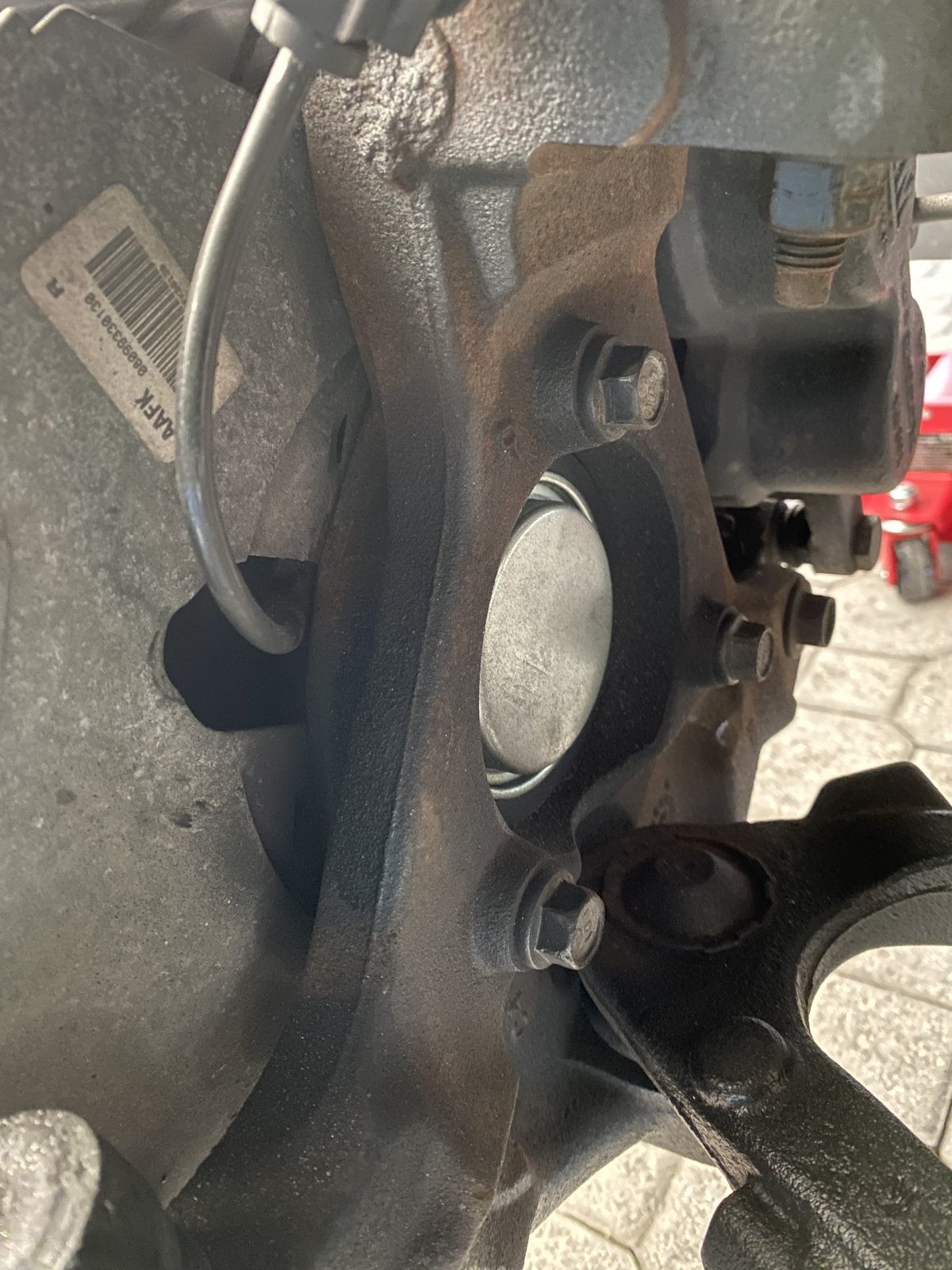

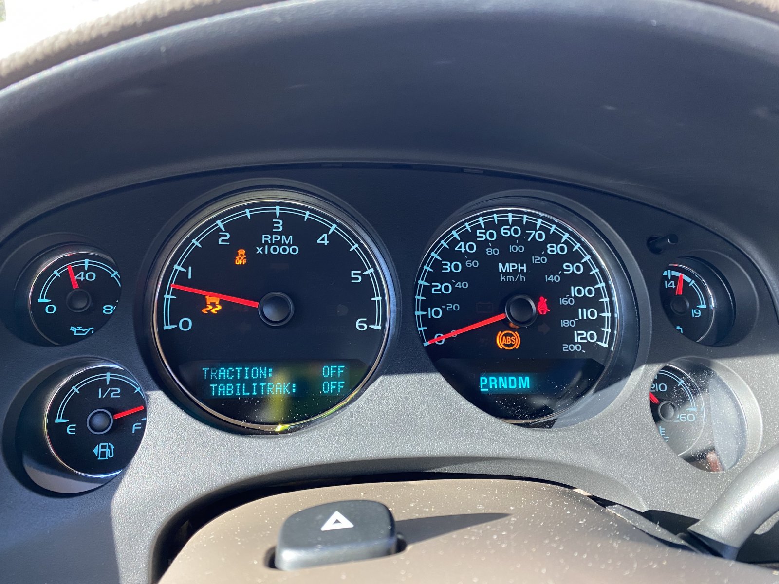

I got a call Monday morning from the wife saying the dash was lit up like a Christmas Tree. ABS light was on, Service Traction Control light was on, Traction Control was OFF, Stabilitrak was OFF and the brakes were squealing.
She's not a heavy foot driver, but I told her to watch it anyways and the squealing would go away once the paint wore off the rotors, which it did.
Called my mechanic buddy for some quick advice on the lights as I still don't have a code reader. He said come down anytime for a read. Stopped by Tuesday morning and the front wheel sensor code pops up. WTF? They just changed the bearings and I only took the wheels off and did some painting.

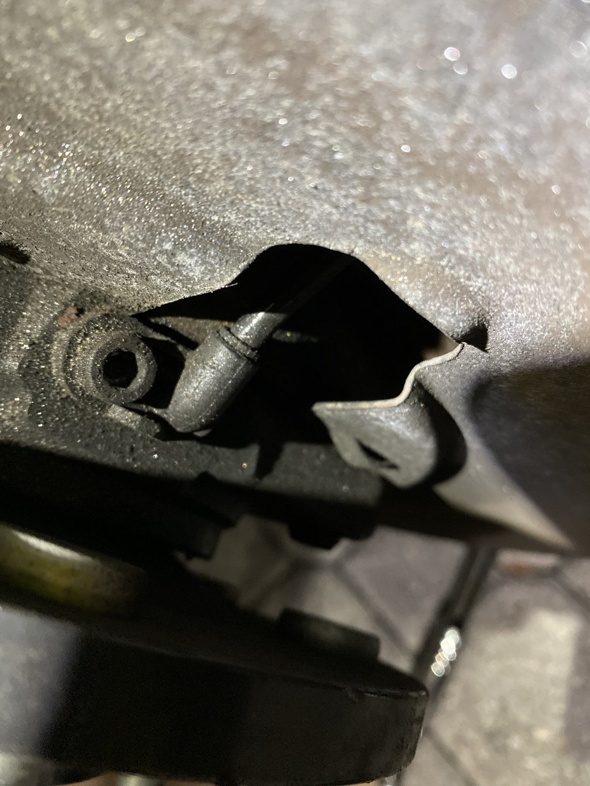

He reached in and followed the sensor wire down from the harness plug up at the top of control arm and right down by the clip on the bottom end of the control arm, before it heads down and through the brake dust shield. There was a very small crimp/slight cut in the cable. Just enough to trip the code. He joked, “That’s why you shouldn’t paint your brakes.” Lol
I have no idea how that got damaged as it is clipped in place by 3 different style clips. He couldn't find any spares in the shop right then, but found one in stock up the road at O'reillys.
I walked in the shop and there was nobody there. One guy walked down the parts aisle, said somebody would be right with me and never reappeared.
Waiting, waiting...I can hear voices in the back room....waiting. I ask out loudly, "Hello, anybody back there?" I hear one guy to another say, there is a customer here and that is more important.
Out he comes, looks up my part, grabs it and as I double check the part number for a Dorman replacement at $50, he has given me a $25 part by Standard. He and another employee that jus appeared??, both say it is a better part, with a lifetime warranty. I paid for it and left.

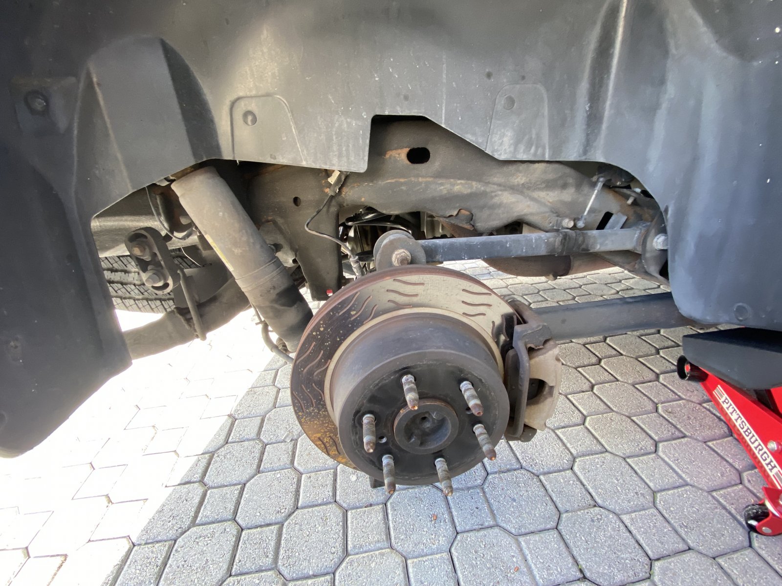

My mechanic asked if I kept the old bearings that they recently changed out because there are 2 working sensor cables right there.
I could not recall as so many boxes and moves but they are somewhere, I think?, but will go on a hunt for them.
I remembered that they were in a friend's storage unit way out west near the Everglades. I drove out there at the end of the day, 30 minutes each way, and YES! I had not tossed them. Sitting right next to the OEM front springs that the coilovers replaced.
Brought the shot Timken bearings back to the house and got the truck set up again to change the cable just as the sun was setting. Still no relief from the humid weather, but at least no sun. As you know, what should have been a quick wheel off, undo the sensor bolt on the hub, unplug and done, turned into a bit of a mission. Hence, why we get to write fun stories. And use some colorful language in the process..lol.
The mechanics obviously work on so many models and years of cars that they all blend together. Turned out that there was no way I was going to access that Allen key bolt to remove the sensor from the hub, without removing the caliper and rotor like they originally thought. Uggghh!!
Not ashamed to say, I was using my mechanic for guidance via text, just to make sure I was doing the right thing. We've been friends a long time and I was determined to not have to take it to his shop to sort out.
Once we figured out the caliper and rotors had to come off, I had to turn the wheels all the way to the left to access the caliper bolts with a cheater bar for the extra leverage. Oops didn't have a cheater bar. Wait, used the extension off the jack and found myself a 3 foot red cheater bar. Red = more leverage and speed.
Next problem was that my socket wrench decide to lose the steel ball and the flat head screw fell out the back. WTF!
So I put the 18mm long socket on the caliper bolt, and the jack extension cheater bar and broke both bolts free. I hung the caliper on the other jack stand. Now to remove the rotor and finally have access to the one screw holding up swapping out my part.
I could not break it free with an Allen key, a torx and I even tried the impact lightly. Nope head was rounding off. Shoot! Messaged my friend back and he said try tapping a torx right into the head of the screw. Sure enough took an S2 Torx 30 bit I had, hammered it into the screw head and lightly impacted it out and the rotor was loose. I left the torx in that screw head for the install. Pulled the rotor off and there was the Allen key screw I had been after.
It loosened up and removed without further hassle. Then to figure out the 3 different style clips up the control arm and the harness clip at the top (with separate pink insert to keep the plug together before it traveled up into the engine bay). Trying to be careful and not slip and break the clips or stab something else lol, I got it sorted and fit the new/old sensor wire in place.
I reassembled everything back the way it was supposed to be, put the wheel on, lowered the jack and fired it up. NO LIGHTS!!
Went for a spin, accelerated and hard braked a few times to make sure all was good. Hit the lug nuts one more time and called it a night.
Sweat equity and zero dollars spent for that repair.
