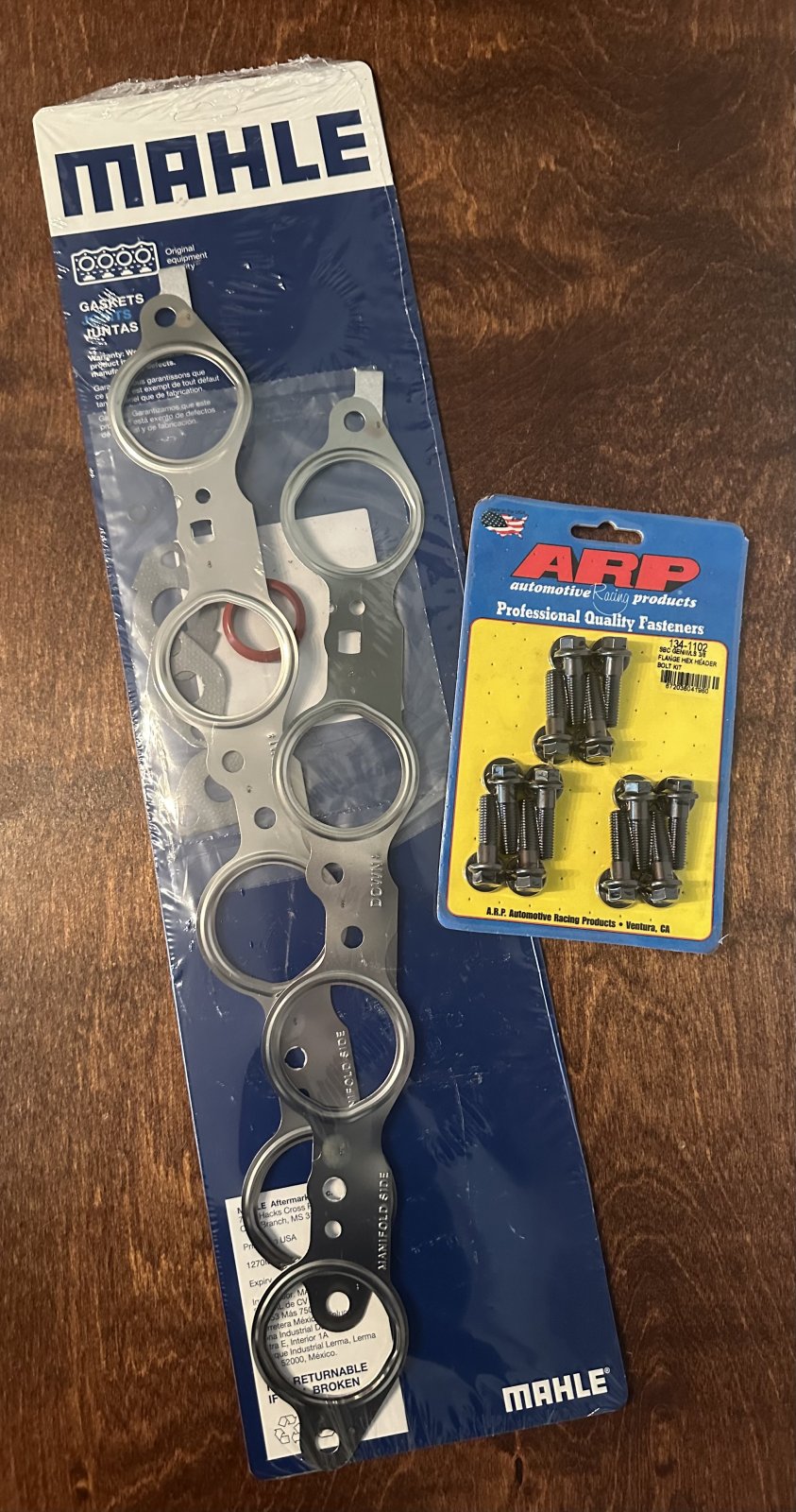

At this point, I have the manifold gaskets and bolts (see attached image). After double-checking what I thought I knew, it seemed the general consensus was NOT to use stainless steel bolts--with the potential exception of using ARP's recommended install lubricant/anti-seize. Aesthetics can play a role in my decisions sometimes, but my initial pull towards SS was for what I theorized to be better utility. How wrong I was. Anyway, I went with ARP's 134-1102, which is a 3/8" flange chromoly hex-head M8 bolt. Also, I could not find what looked like a reputable option for a genuine GM gasket online and I saw a few positive posts about Mahle (which apparently owns Victor Reinz--did not previously know this), so I went that route.

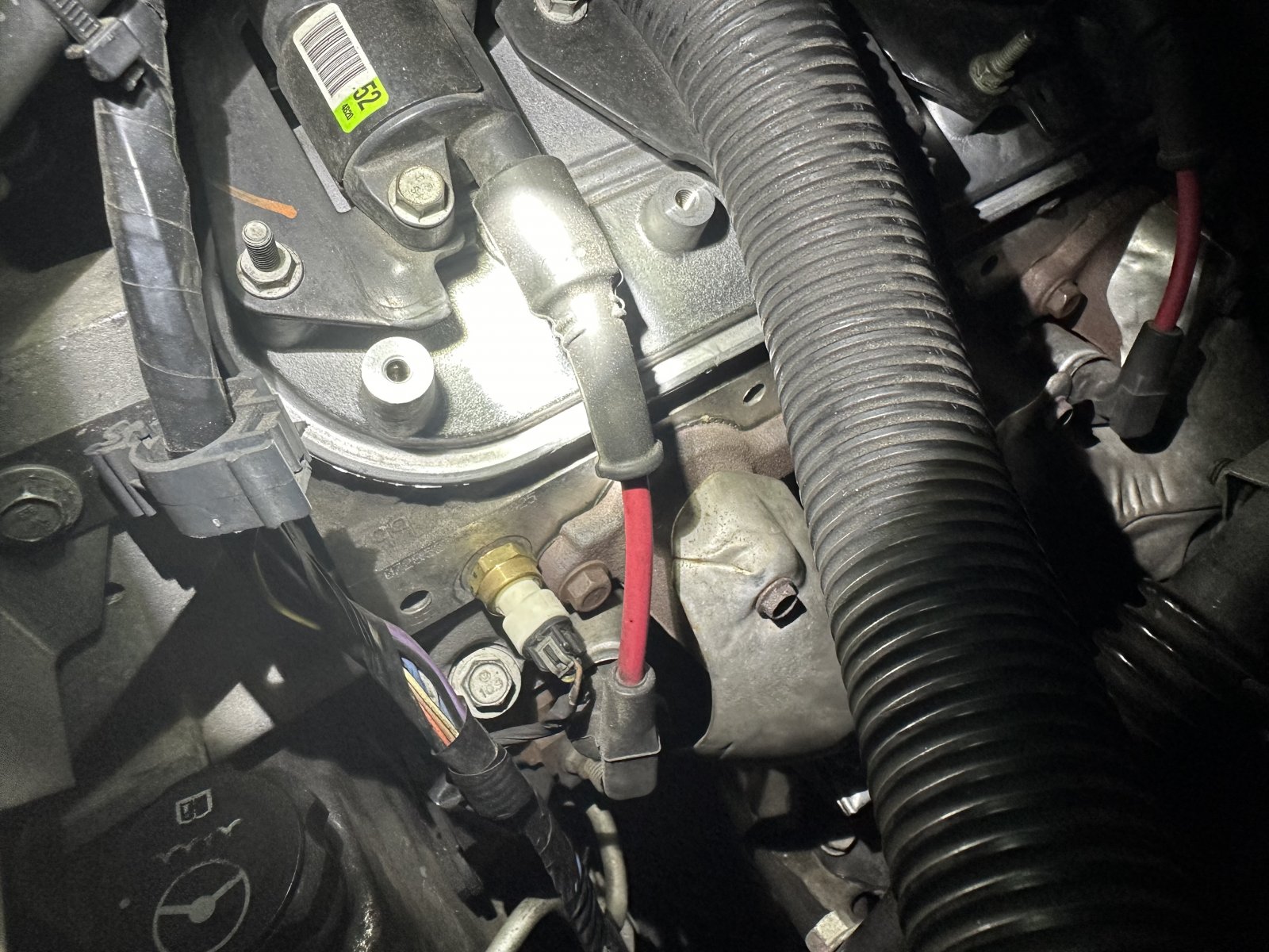

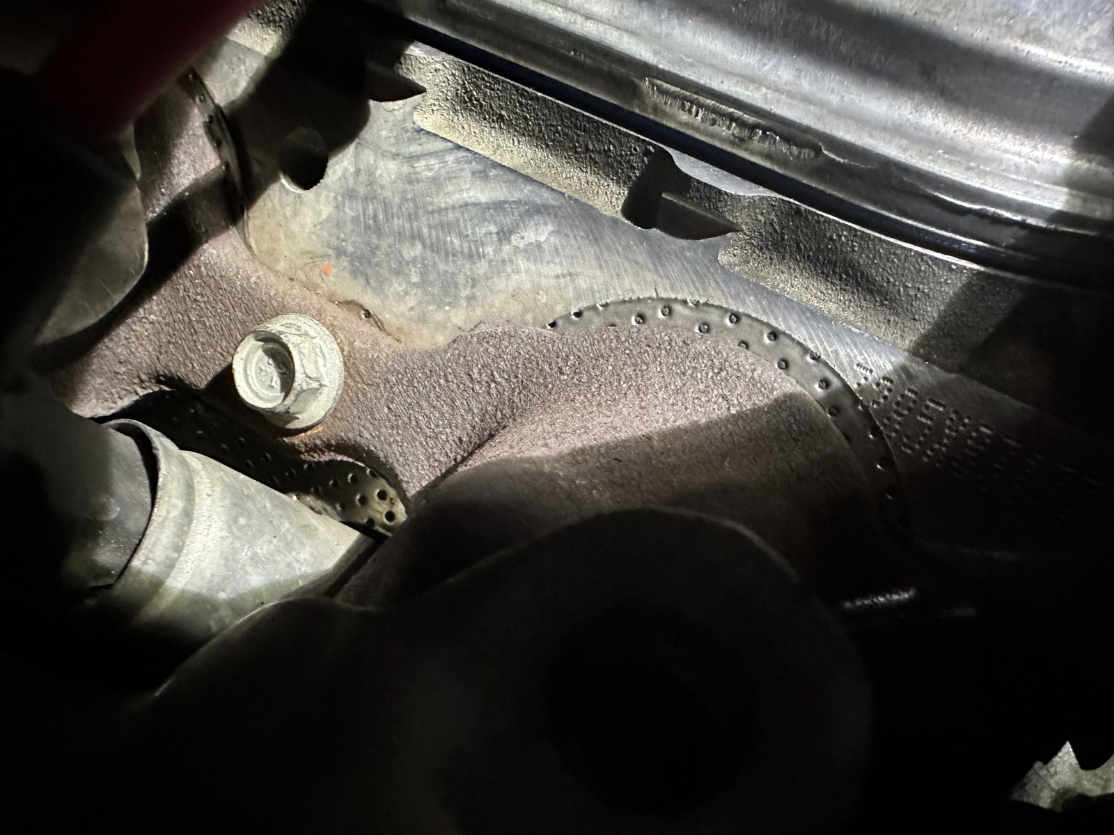

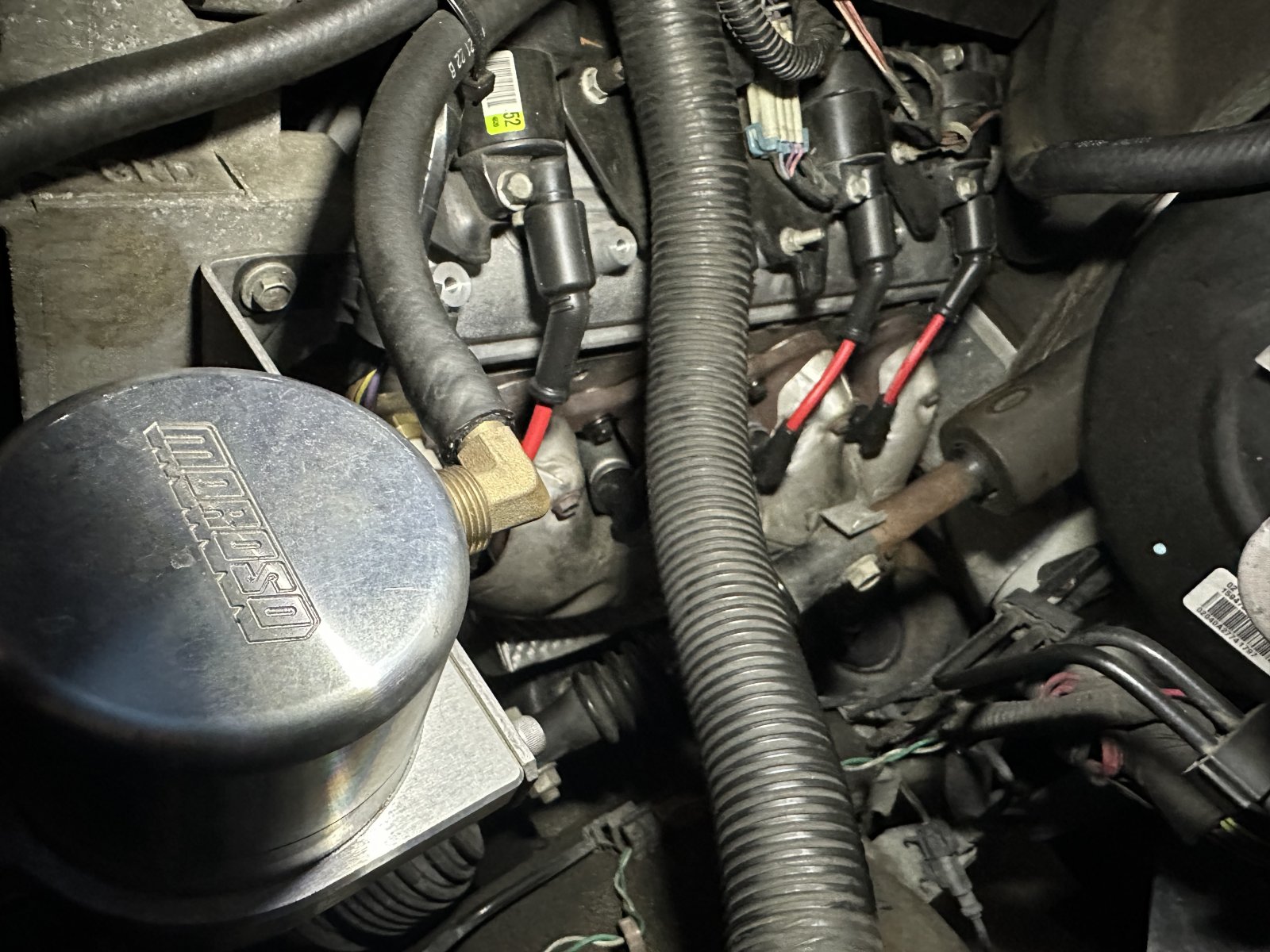

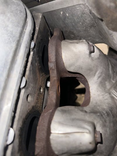

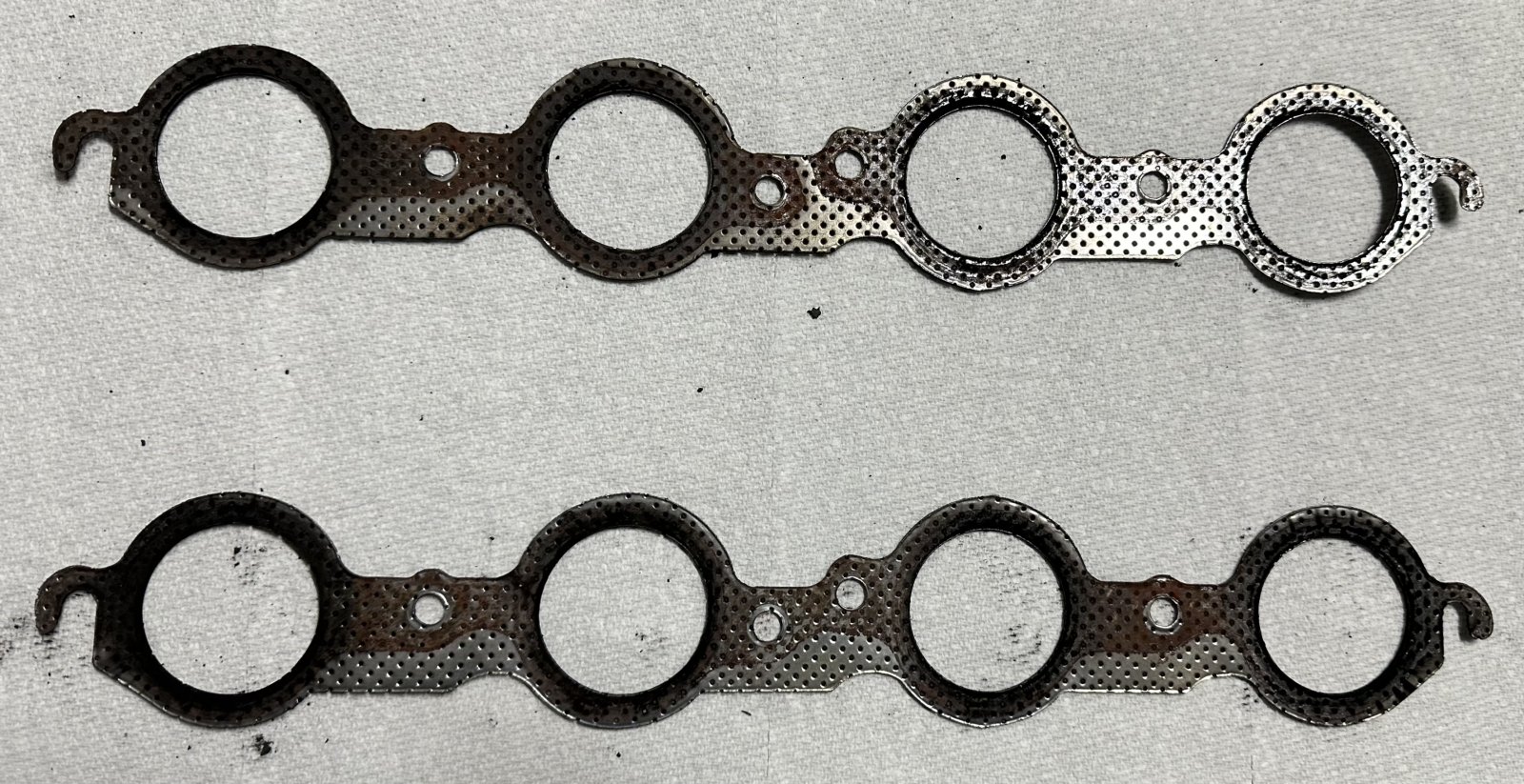

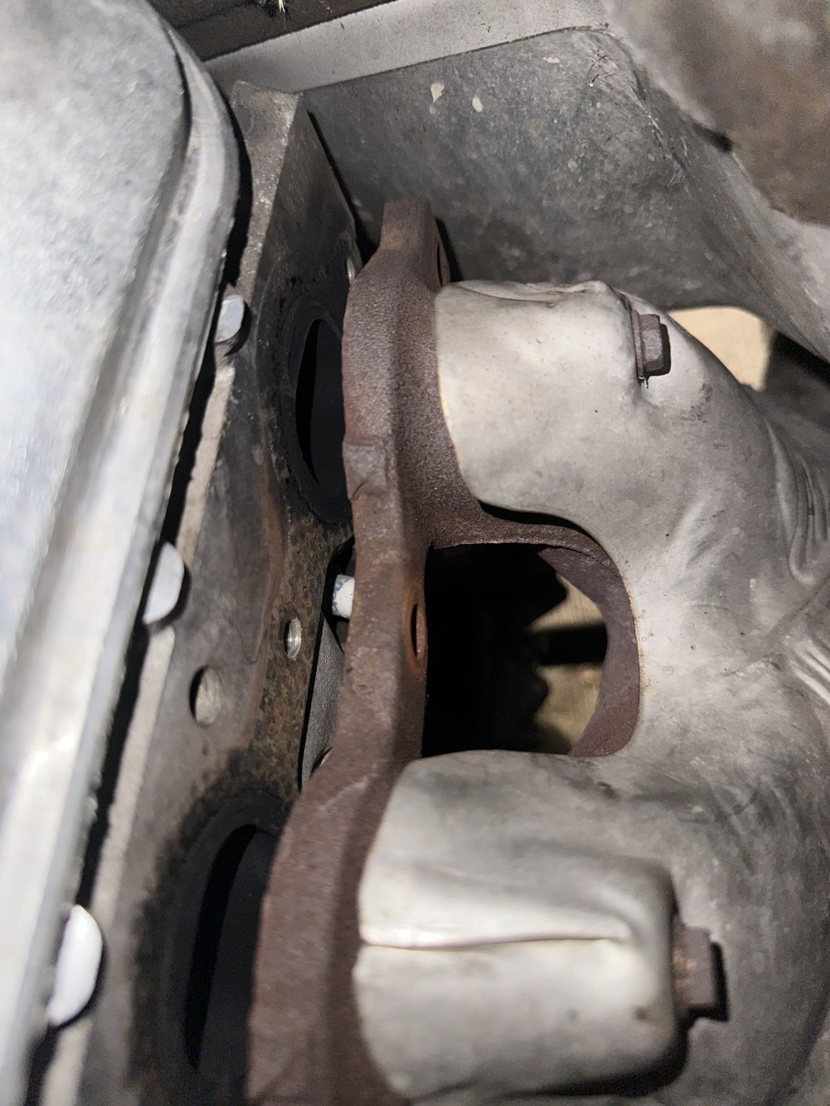

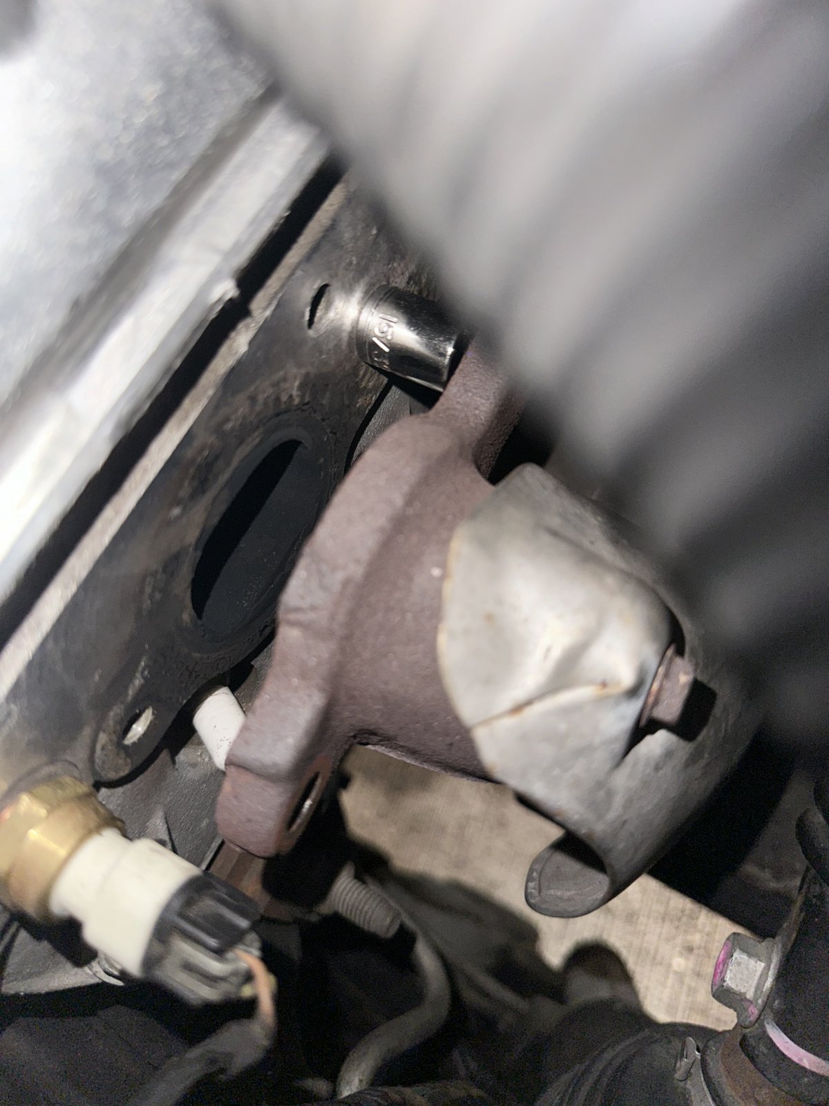

Thanks for all of your advice! I was able to complete the job in the October/November cusp and my engine sounds all the better for it.
Due to the manifold bolts having been removed already (circa 2020) there were zero issues getting them out. Similarly, the mating surfaces weren't as bad as they could have been, so cleaning them with the manifold still attached to the exhaust system was possible--I placed a small socket between the head/manifold to keep them spaced apart. Needless to say, I over-thought the gasket removal/replacement bolt work quite a bit. Everything old came off and everything new went on--no modifications to gaskets, either. The only mildly complicated aspect to putting the new gaskets and bolts in was that I needed someone underneath to push up on the exhaust (to line up the holes and keep pressure off of the bolt shafts) while I carefully threaded the last couple new bolts into the heads.
Also, the spark plug wires did not cooperate with me, so I earned a new set of those, too--AC Delco, of course. That's something that flew right over my head when planning this, but wasn't a big deal.
So, after replacing the gaskets and bolts (and spark plug wires), some of the noise persisted. I crawled underneath and tightened the collector (manifold-to-cat) junctions to torque spec--the driver side was under torque on 2 of 3 studs and the passenger side on 1. After that, the noise was gone.
I wouldn't be surprised if there isn't a perfect seal on the collector gaskets, since they were loose enough to make noise and probably have some soot on mating areas, but there is no audible indication of a leak anymore--I have been putting my ear to the wheel wells on cold starts and driving close to concrete walls with the windows down, to check.

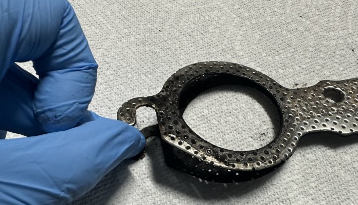

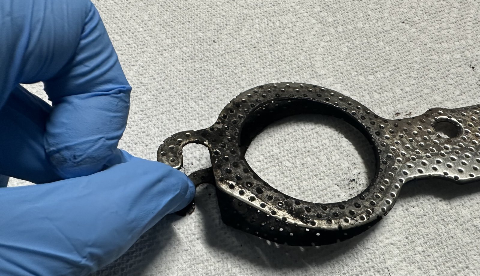

judging by the carbon around the ports those old gaskets were leaking really badly.
glad it all worked out. always nice when a repair actually fixed a problem. Hopefully it runs better. I gotta guess with that much of a leak your o2 sensor readings and stuff were off.
