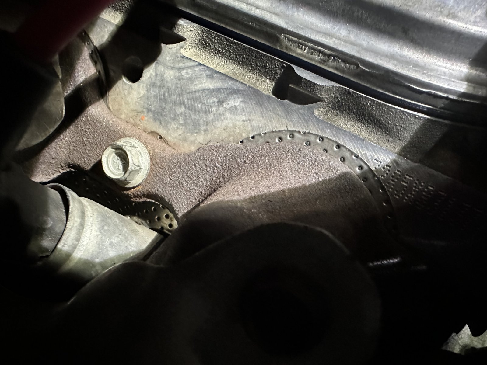

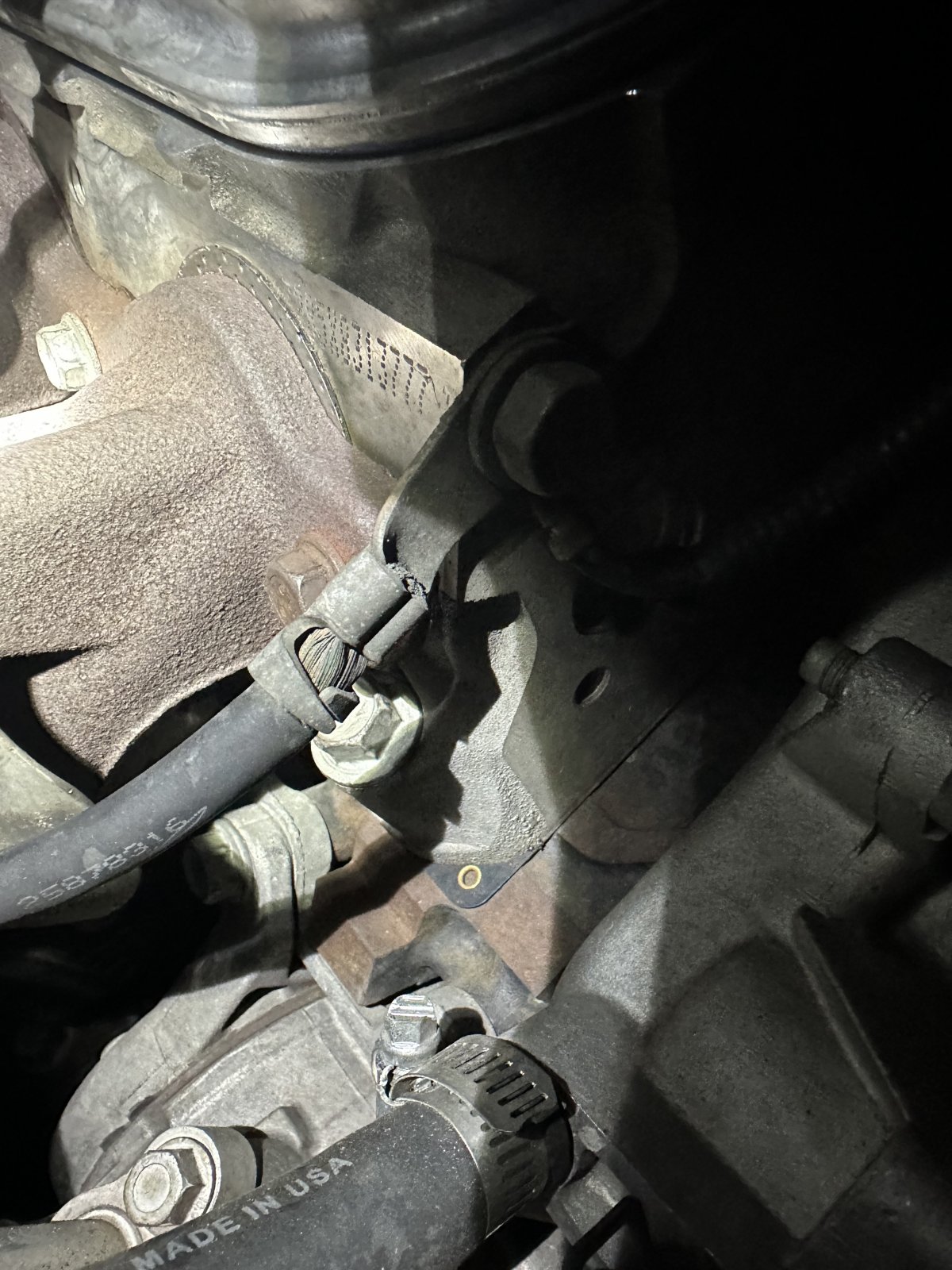

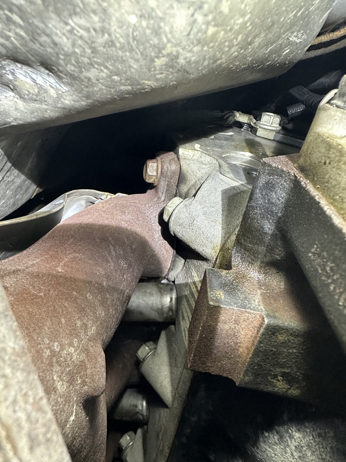

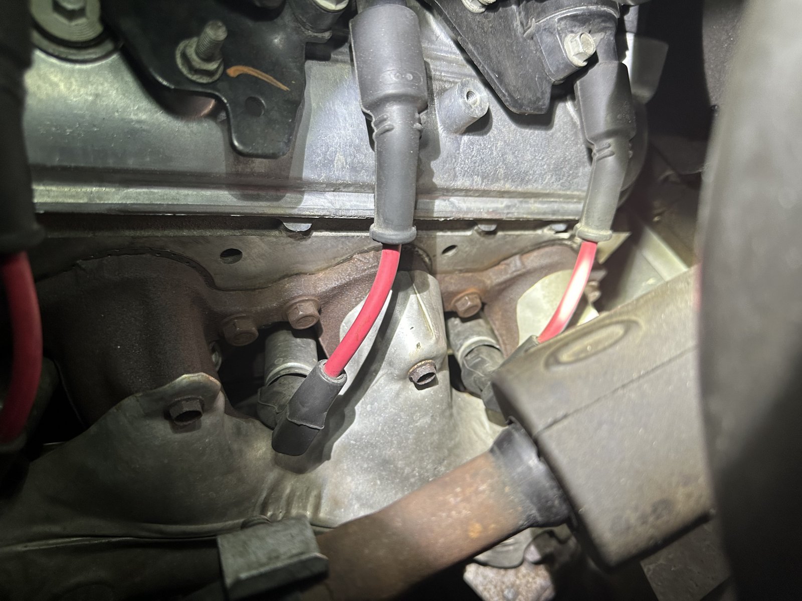

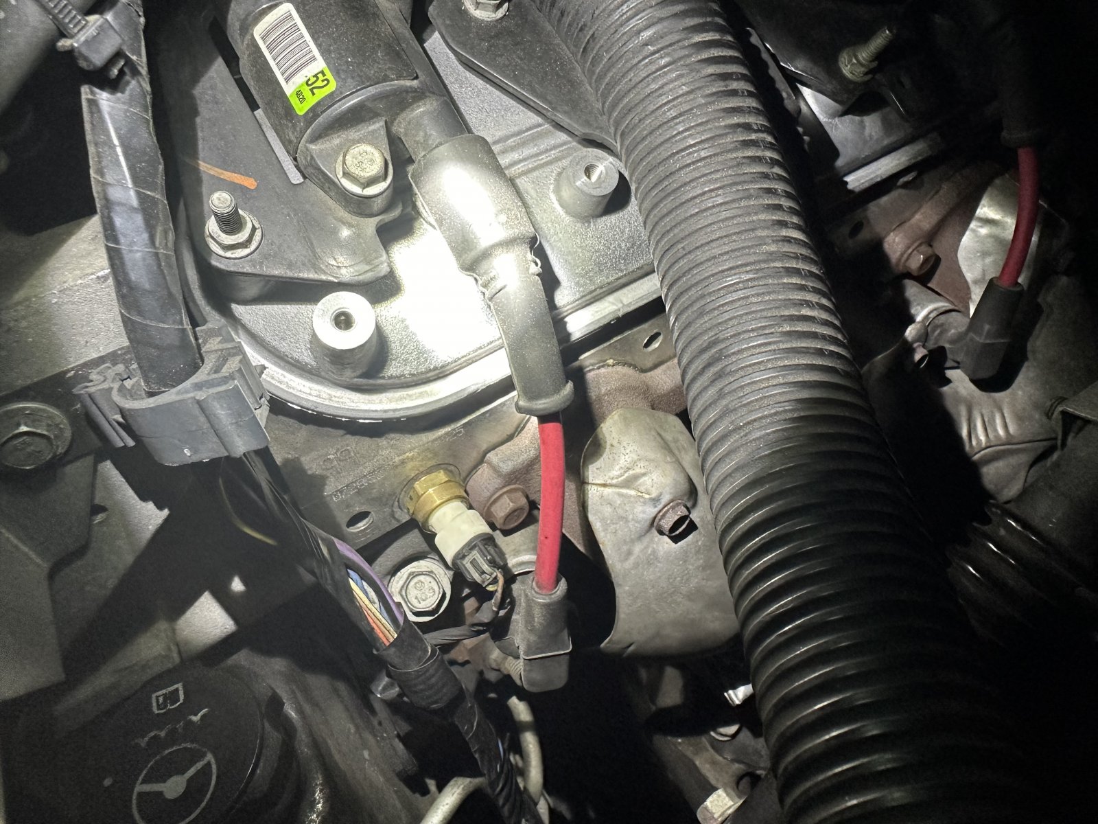

I have been driving my '08 Yukon XL for nearly four years now, and it has always made a 'ticking' noise on cold startup. This noise subsides within a minute or so, as the engine temperature rises. No CEL or codes. Over the past four years I have been gaining more automotive knowledge and competency, as well as developing a general obsession with this vehicle--how it runs, how it sounds, how my maintenance/repair choices will affect a trajectory towards supercharging one day...
So, I started chasing this 'ticking' noise a few months ago because I noticed an exaggerated form of it under load while driving with the window down. When looking for a busted exhaust manifold bolt, I found that the second-to-rearmost manifold bolt on the passenger side was loose enough to turn with my fingers. There was also soot visible in a few areas above and below the manifold flange. I torqued all 12 bolts to 18 ft. lbs.--noting that all but one bolt were under 11 ft. lbs.--and the result was less noise for less time when cold starting and still noise under load.
Having some free time, last week, I decided to revisit the manifold bolts again because the cold start 'tick' duration seemed to be increasing. Sure enough, the bolts were under the 18 ft. lb. torque spec again and--once re-torqued--the cold start noise level and duration were reduced.
Presuming that the sound (when cold and under load, but dissipating in idle from cold to operating temperature), visible soot, loose bolts (potentially walked out and damaged gasket seal?) point towards an exhaust leak, I am planning to do the following:
1. Replace the current, rusty hardware with ARP header bolts
a. Leaning towards ARP 434-1102 (SS, hex)
b. Considering ARP 434-1301 (SS, stud/nut)
2. In conjunction, replace the exhaust manifold gasket (without removing manifold entirely--i.e., not disconnecting from Y-pipe)
a. Leaning towards OEM (Genuine GM), AC Delco, or Mahle
b. Considering a Remflex gasket or double Remflex gasket to compensate for any warping of the manifold
3. See what happens
a. If the sound persists, I will try to tighten the studs (manifold to Y-pipe).
b. If sound STILL persists after "a.", then I will remove manifold entirely to inspect, replace manifold-to-Y-pipe gaskets, and potentially replace the manifold.
With all of that said, do any of you with experience have some advice for the materials, process, or--for that matter--diagnosis?

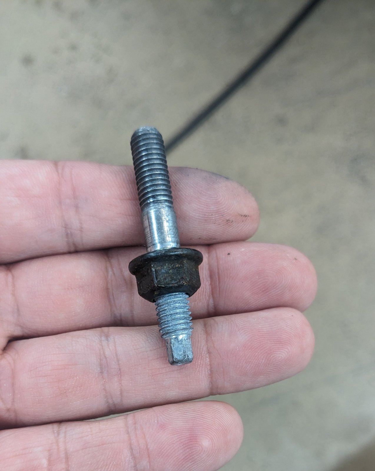

For what it is worth, I noticed two broken front exhaust manifold bolts on the driver side of my 11 Yukon Denali. This is a common problem. I had no symptoms, just noticed them while changing oil and doing a visual inspection while under them. It is easy to inspect because I have a lift.
I will do a bunch on a truck, but I am not about to tackle two broken bolts. Took them to a highly competent local auto repair facility and they got them quickly fixed. I do not remember what they charged, but I do remember I thought it reasonable. So reasonable it was the perfect executive decision to get them to do it rather than me reinvent broken bolt removal.
Use grade 8 bolts. I'm not sure what the rest of the ti and ss discussion is about. Grade 8 bolts have been used next to forever with unbelievable reliability to the point that no one ever has discussion unless there are looks involved. GM just ended up with a batch of bad bolts. There was nothing in that engine compartment that ever had looks.
Now I do consider looks are important in my wife. So I will consider ti and ss if I am forced to put her back together.
I would probably be thinking the same, regarding the breaking of bolts, but my engine was removed for a DOD/AFM delete in 2020. I may still soak the bolts before attempting removal, but I at least know they've had less than 17 years to conjure the strength for stopping me.

I took my stethoscope above, around, and under my idling vehicle--tracing the exhaust. Although my methodology might have been less than great, I did not gain any clarity on the sound. I did take some more images of soot I found, though, as well as the current bolts and gasket--quick side note on this: my AFM was deleted in 2020, so these bolts were taken out and two of them on the passenger side are different/newer than the rest. There's more to unpack about that delete, but I am thinking my current exhaust manifold gasket is some kind of composite (although with a metal layer on the manifold side?) that came with the delete kit, which I think might have been Texas Speed because I know it's a popular option and its kit images look to have a similar 'stamped' looking exhaust manifold gasket. Ultimately, though, I don't have a record of the product used and the job was wrapped up in my vehicle purchase back when I was almost entirely automotive-ignorant--didn't ask the questions when the information was available.
I got the bolts (ARP 134-1102, chromoly, hex) and the gasket (Mahle, MLS), but I will make another post in this thread about that with some questions about procedural options.
